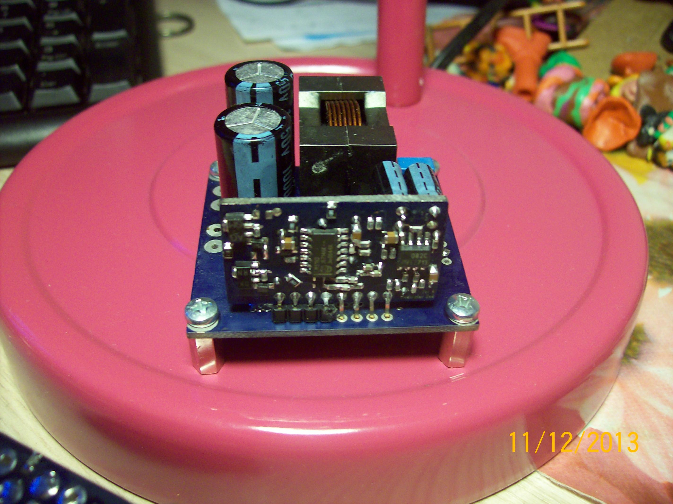

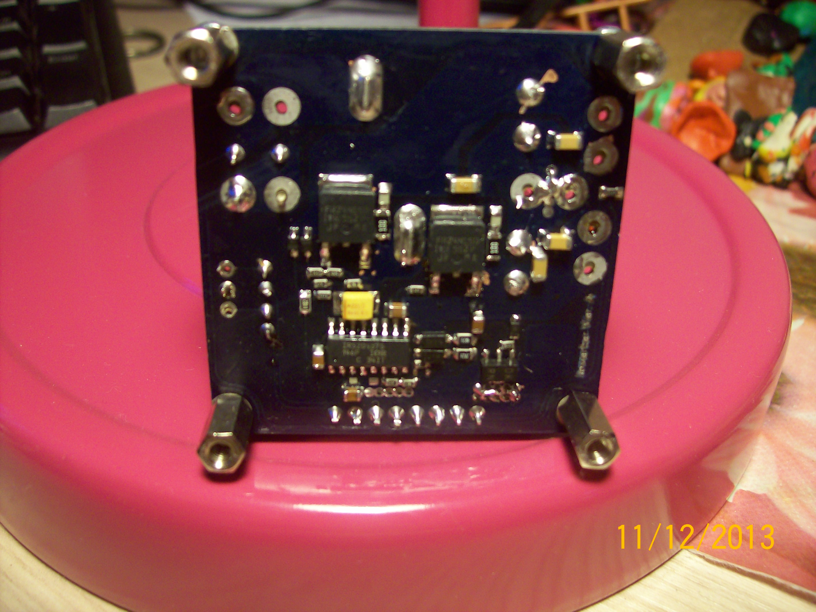

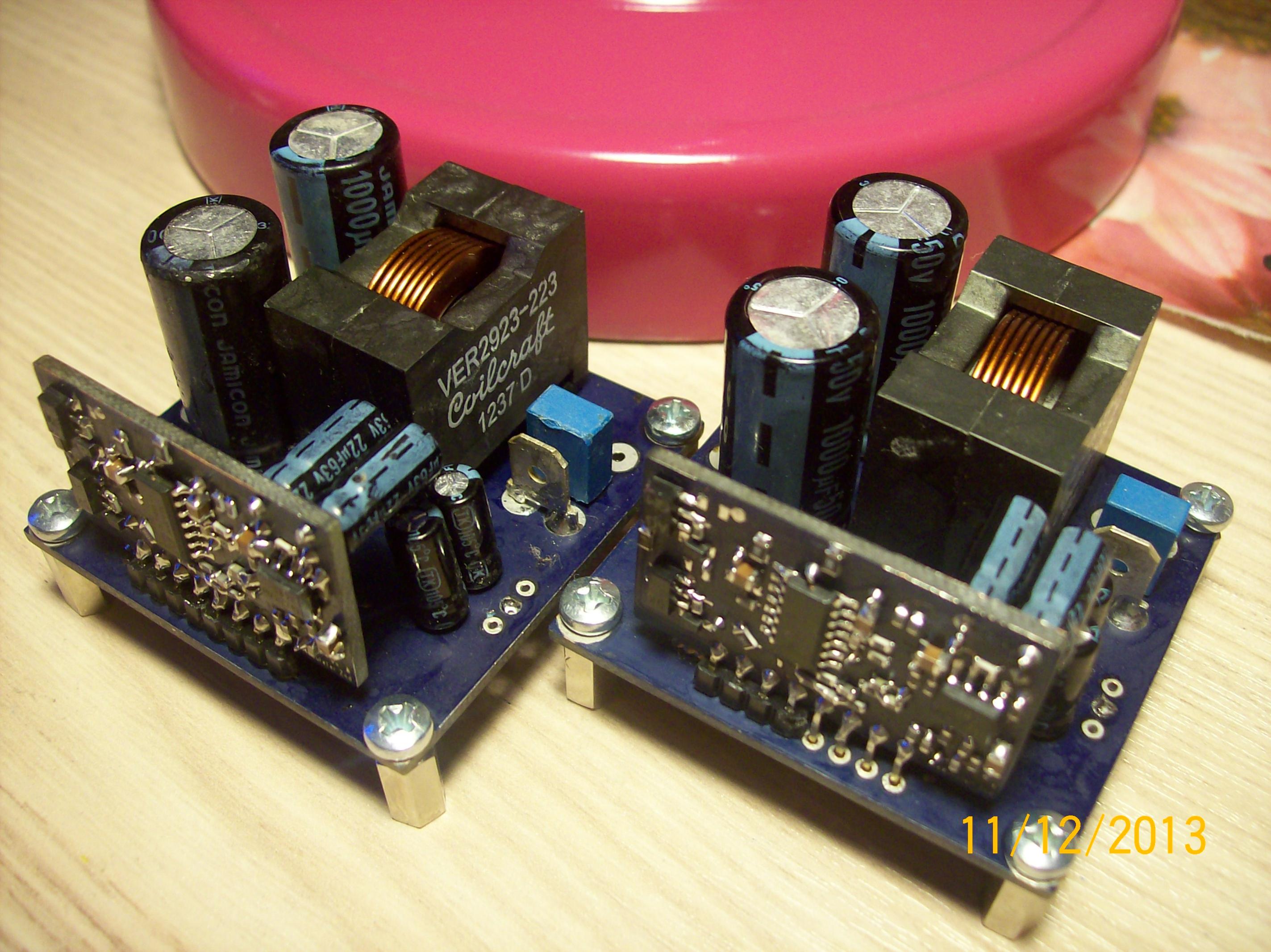

Hi Kvazi13,
I am so sorry to answer very late. I can do this but i did not actually. There is a way to synch. them from input via an external osc. and my all amps has synch inputs which are disconnected now. Instead i used 47nf caps between the outputs for each R+L channels to synch. However, it does not look very necessary. All the amps running at nearly same frequency 387-390kHz without synching. I just finished the auxiliary PS for input opamps (OPA1632)+ comparator (LM311) and output relay protection boards which are ordered from seed studio.
I will add some photos soon.
Best wishes,
FH
Ucd like amp
My UcD like amp.
irs20957+LM319+tl082

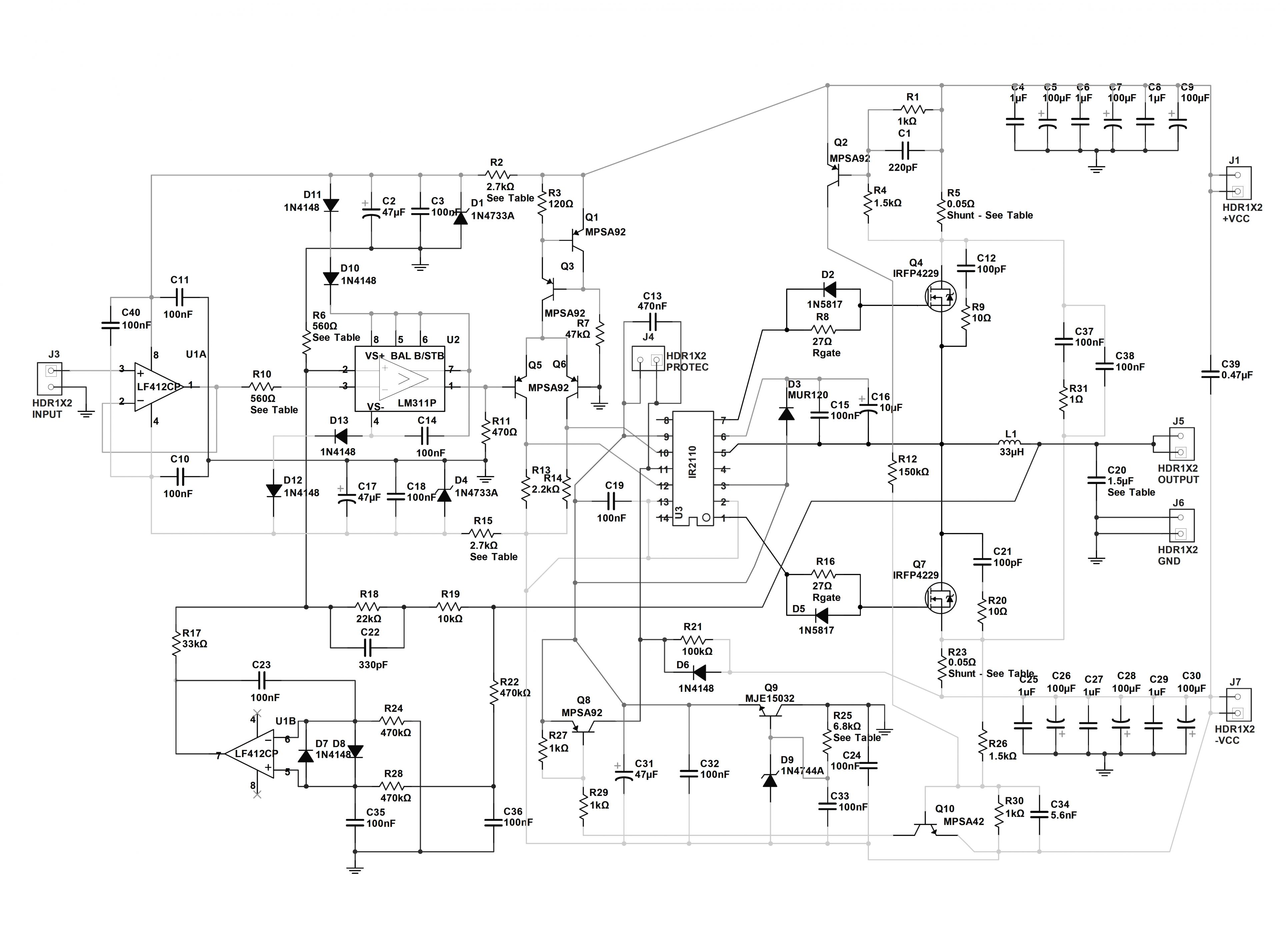

Hello
greetings can any one advice me on how to design pcb for this schematic
single sided or double sided
warm regards
andrew😉
Hi Andrew
Looks like an old design. Why go with IR2110, needing level shifter on the input and over current protection seperately ... go with a IRS20957 .... maybe even the cake amp in 3 posts earlier ...
But to your question ... yes go for 2 sided and smd components
BR Baldin 🙂
