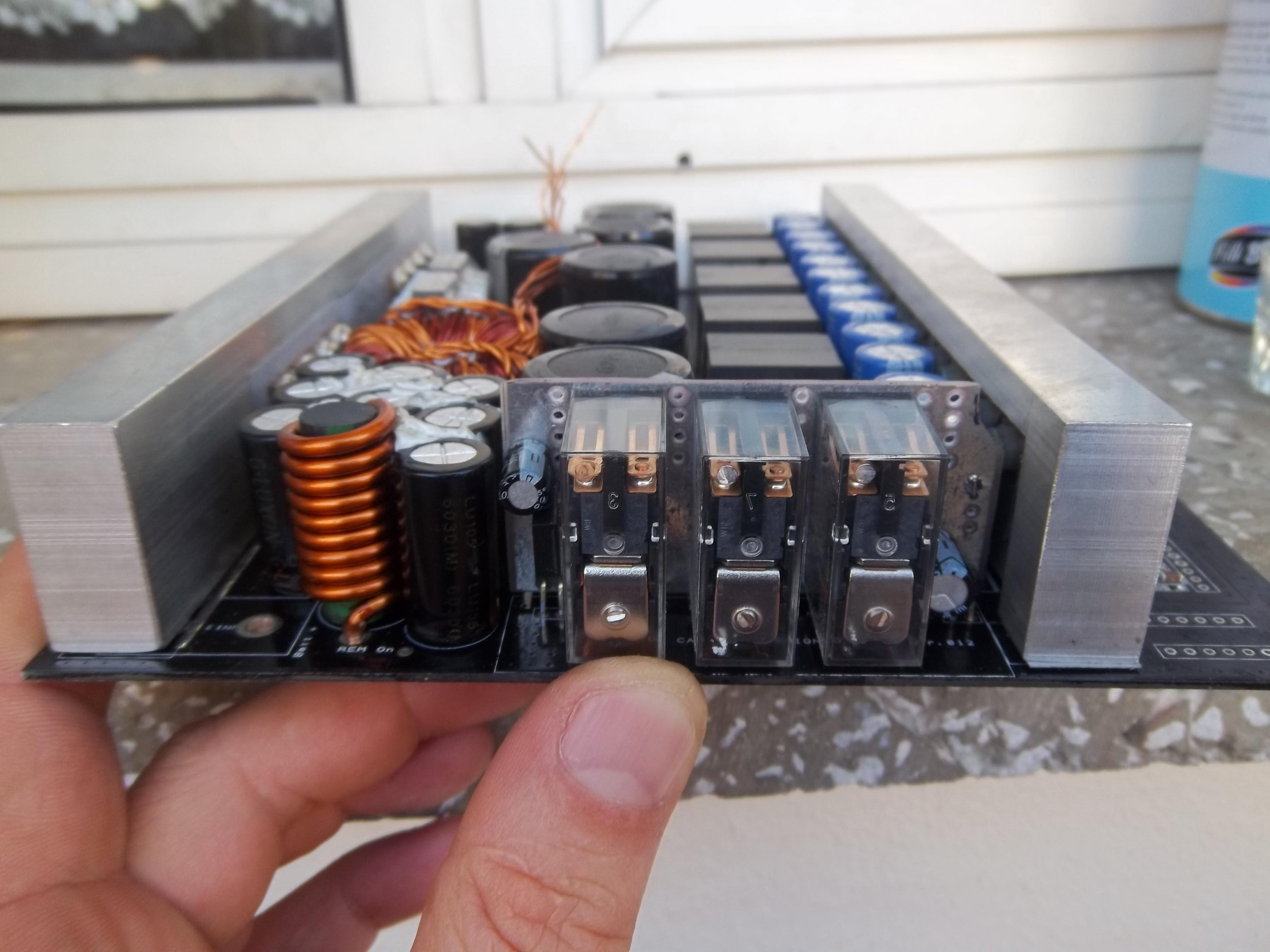

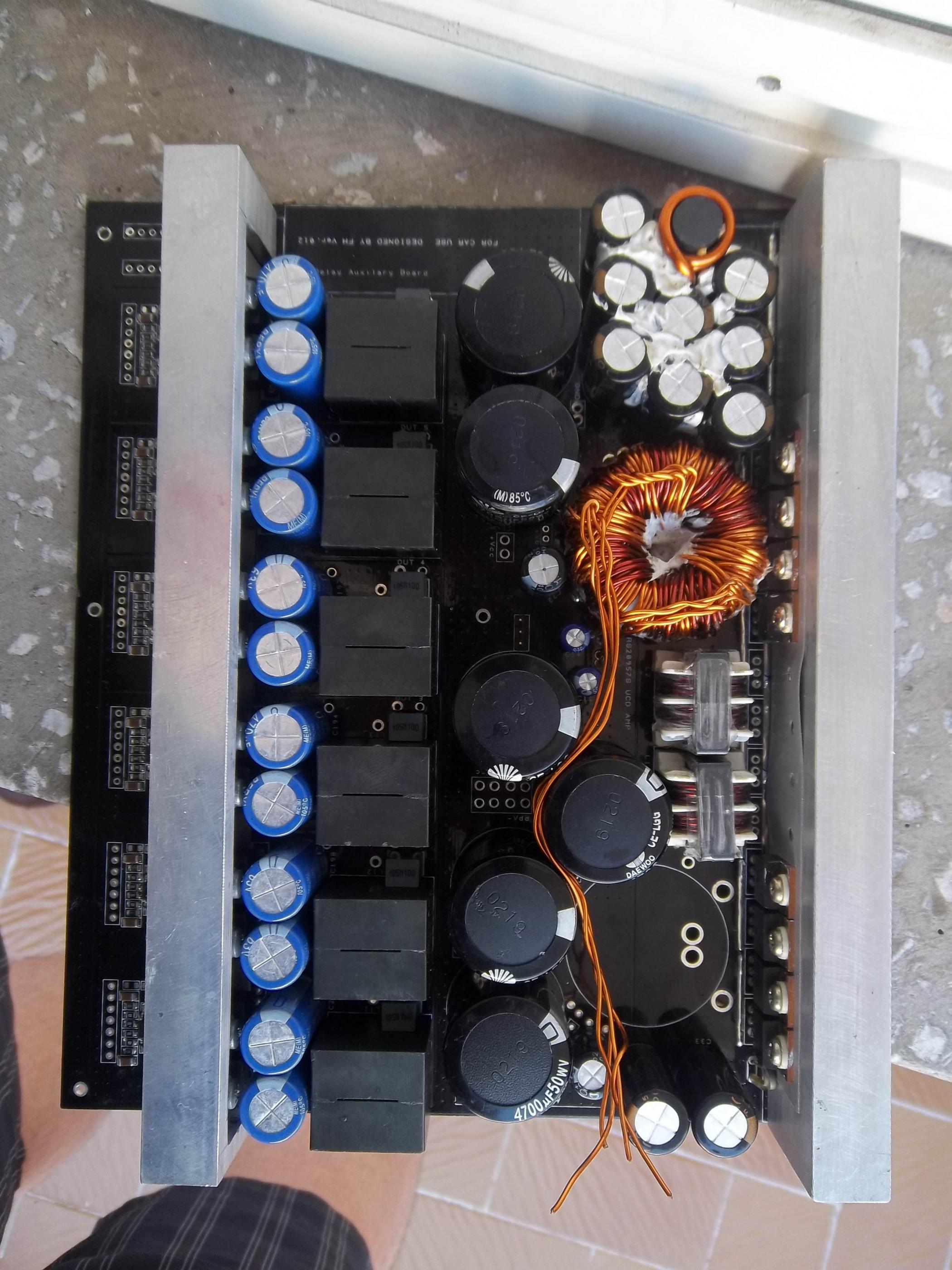

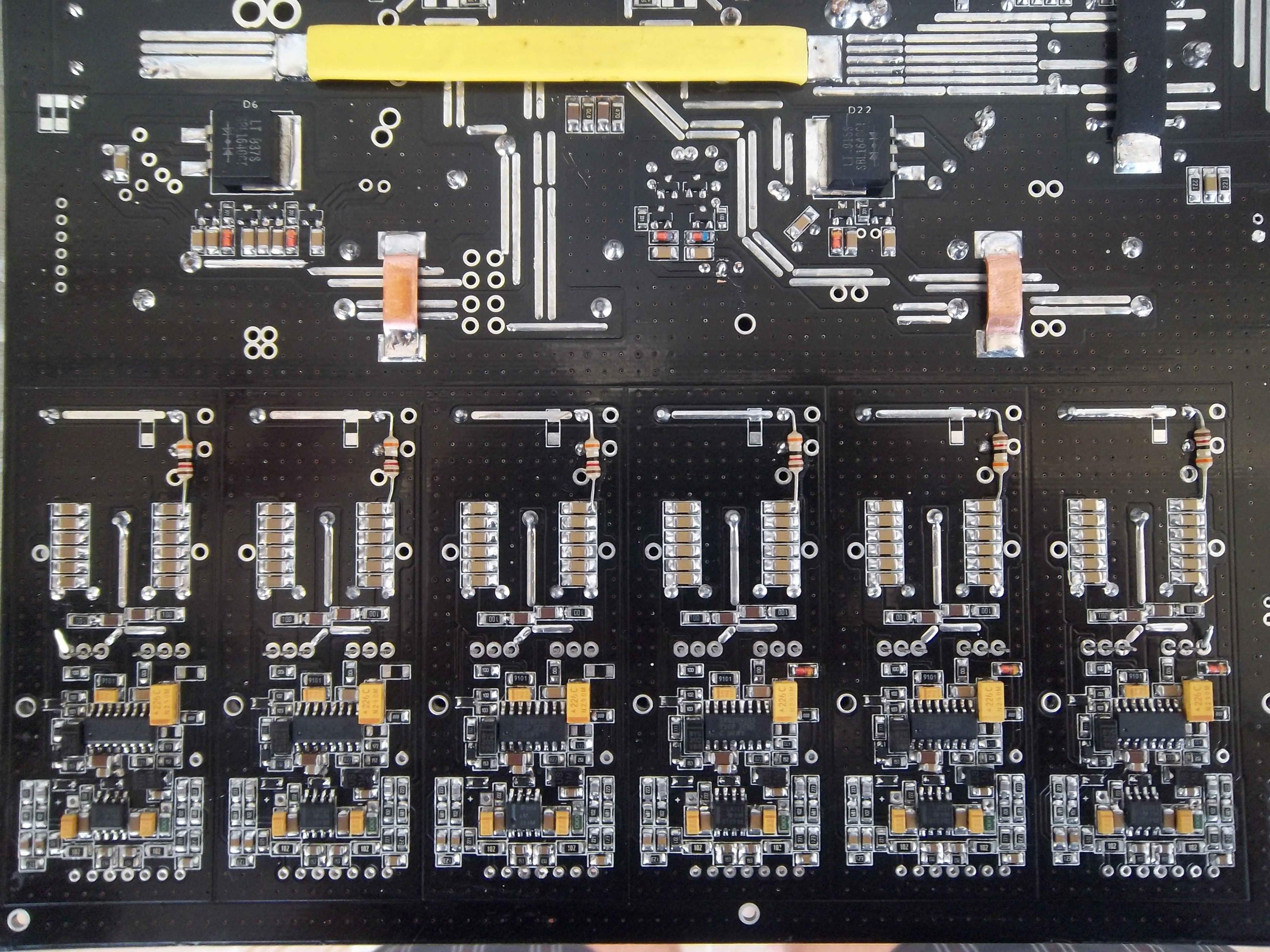

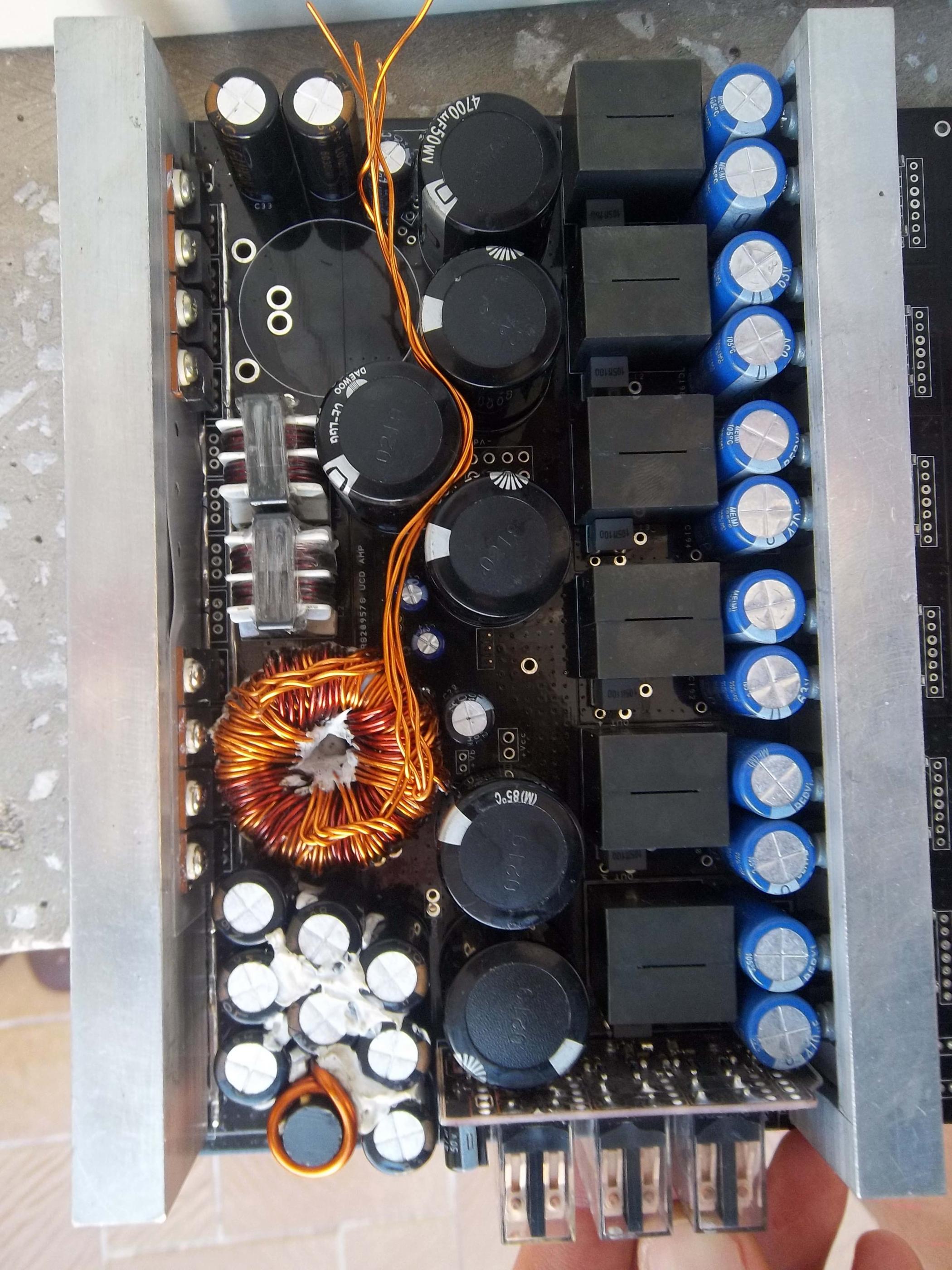

Last situation of my amp
Hi all,
I think there are several questions around and there are many others similar to the amp discussed here. Anyway, I started to do the amp below for a very long time ago. And now it went into a good PCB. The entire PCB is 105um Cu thickness and i had it made from a China manufacturer (hell, it was a difficult process to get them). The photos below are nearly completed amp but, still 3 auxiliary PCB are missing. They will be available soon.
I hope you all like it.
Best wishes
Hi all,
Best wishes
Sub channels playing! others need the xformer to be mounted! The transformer is nearly ready but need some additional windings.man, they came out very very good, is it playing yet?
Yes,sure it is!Looks really good. Is it an isolated smps on the board as well?
