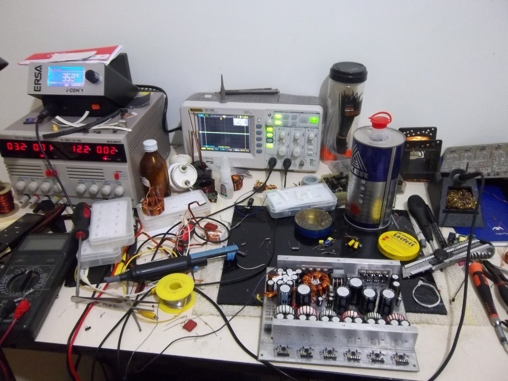

Hi All,
Finally, I have finished the multi channel car amp desing of the enclosed schematic. The amp is working fine and now only one channel tested with unregulated +/-42V bipolar power supply. The only thing that I dealt with the sw frequency. Normally amps oscillating at 277KHz with the 28uH ferroxcube gapped toroid and 0.68u. However, I swapt R9&R19 from 2K2 to 1K and the frequency increased to 309KHz. Then for test purpose, I put a 1uF 250V cap from output to GND with a cricodile cable and the sw increased to 430KHz as expected. It is normal up to here. But, when i removed the cricodile and paralleled directly 1u by soldering and really suprised. Becasue the sw frequency was 309KHz again. To test, the idea that it was due to the radiated EMI from the cricodile I removed 1u and put the cricodile cable and re measured the sw. It was again 309KHz. Then, I measured the resistance of the cable it was around 3ohms then I put a 2.2 Ohms resistor series to 1u. Then the sw was 430KHz again. All the measurements was same with or without load(8ohm speaker).
The question is this, how it is possible to get these different results? I could not give a meaning to this. Does anybody have an explanation?
Best wishes,
Hi All,
Best wishes,
I don't know anything about this circuit, but that reminds me of the zobel on the output of Tripath amps. The values varied depending on the Tripath IC used (0.1uf+33R, 0.22uF+16R5, 0.47uF+10R, etc).
Thanks for your reply. But I do not think it is due to the Zobel network. The sw frequency of the UCD amp does not depending on the load actually. There should be some explanation. Is there any idea?
Best wishes.
Here some photos are!

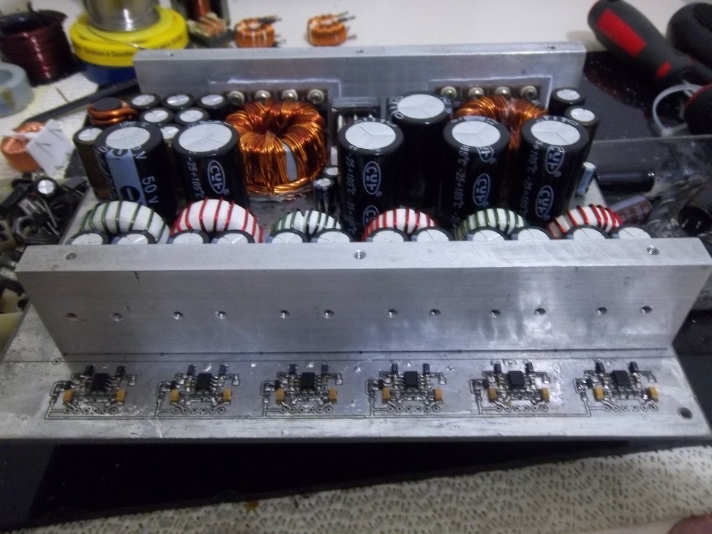

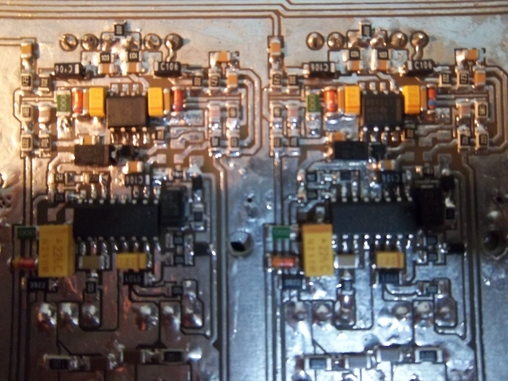

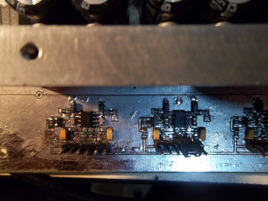

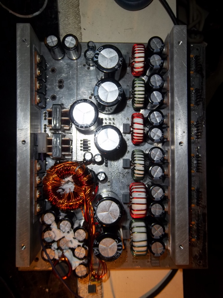

Hi all,
Perhaps some diyers would like to see what the board looks like. I enclosed some photos of the complete board. And I also enclosed the updated schematic of the amplifier. Still waiting for a logical explanation.
Hi all,
