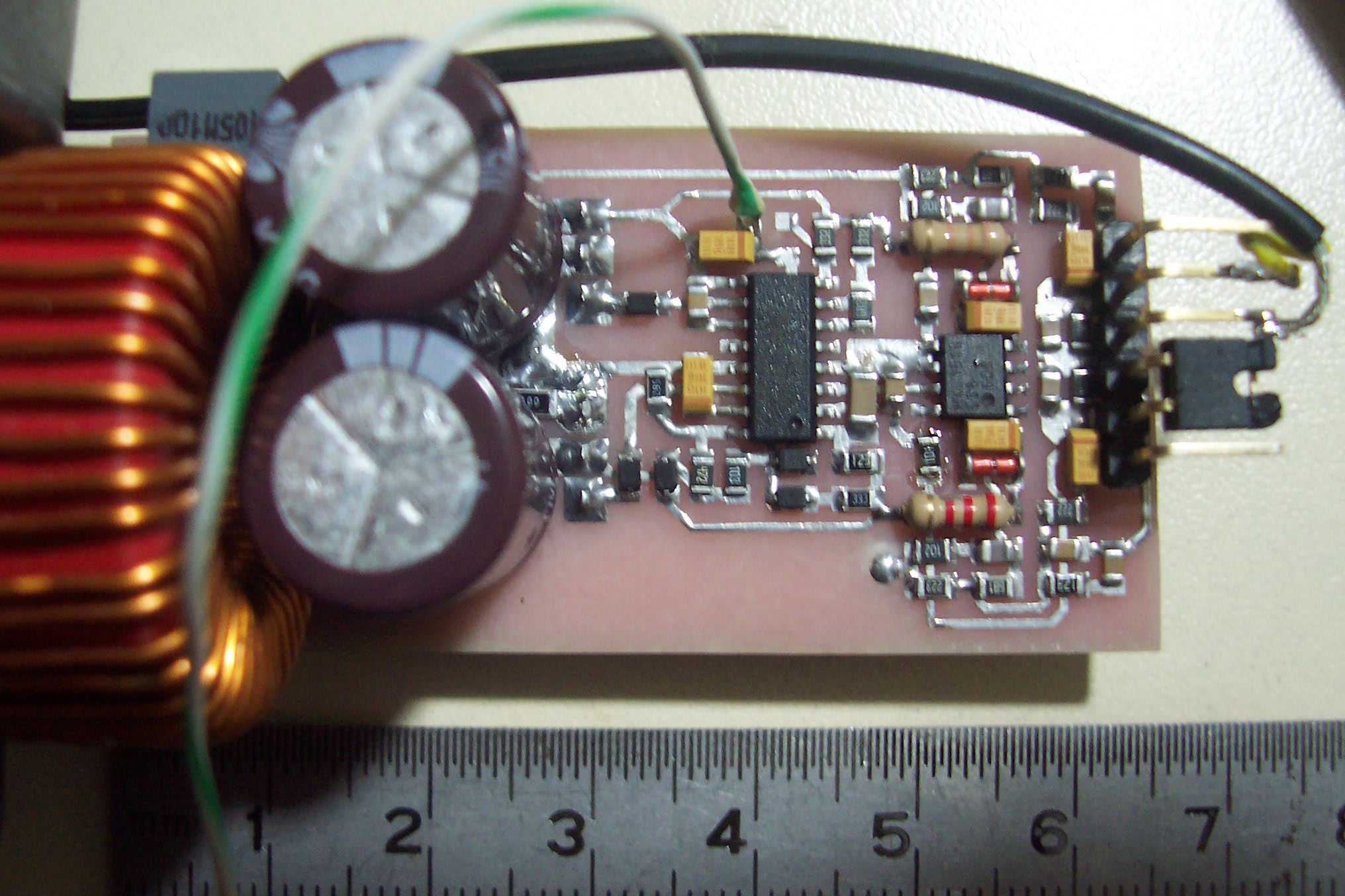

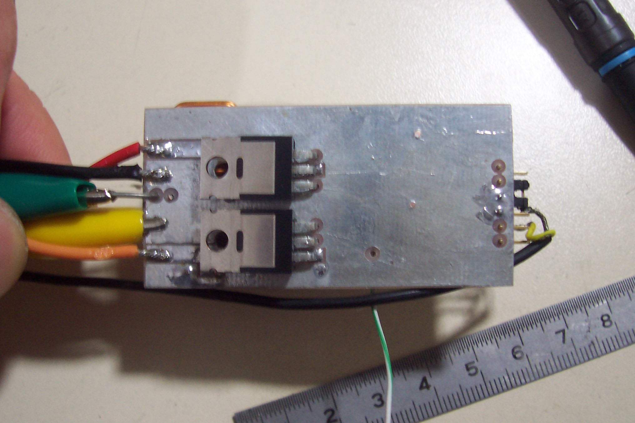

Dear Bender and all,
I realised that Bender and the others are not interested with the above questions. Anyway! Therefore I tried to make my own desing and get the smallest amp below. Bender, please excuse me if I get you bother by posting in your thread.

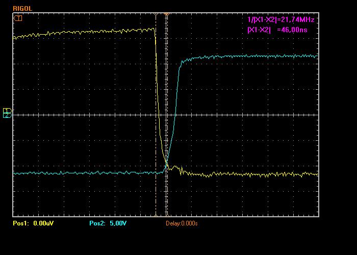

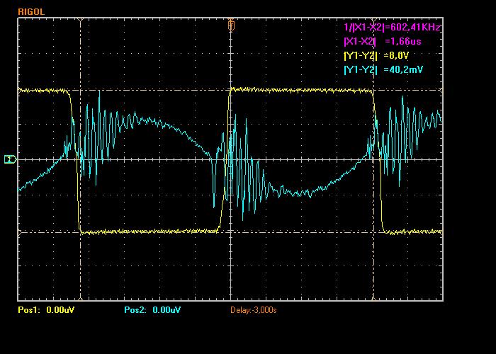

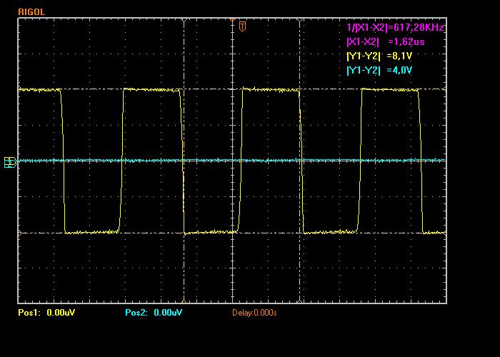

First of all simulate the shematic. I used the chip IRS20954S which is known as unsable( Make a diyaudio search) and old IC. I get it from Farnell, it is cheap for now. I did not faced a problem by implementing it. My output mosfets are IRFB5615PBF. SW frequency is 550-600kHz. Input comparator is MXL1016 from Maxim and sound is very good just for my firts testing. DT adj is max(45ns) for first test purpose. I think I have to decrase the sw frequency down to 400k and set the dead time into a suitible time(25ns?).
Regards
NB. If someone interested I can give the PCB toner file
