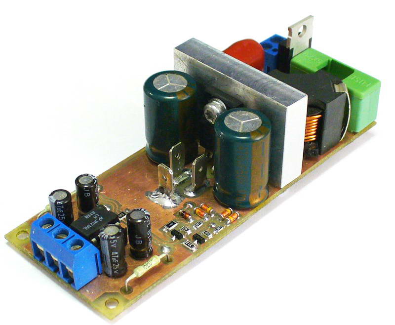

hi all,
I assembled Bender.ru's Cakeamp V1, works well and nice sound!!
😀 but now i need more power (Too Much Power? Never! 😎 )... I wonder, did anybody try to get more power from that module, or anybody try to bridgemode (without Bender.ru) and can share schematics?
p.s. Bender.ru, how much power you get in bridgemode? Maybe you can share bridgemode prototype schematics?
Thanks for any Help!

Hello AmplifiersMan,
what choke you are using?
Epcos N87?
Can you give me the order code for the Choke,
maybe from farnell.com ?

Kay: i used Epcos RM10 N87 choke, and the order page posted by theAnonymous1!
Bernder.ru: i need more than 400..500W @ 4Ohm (about 800wrms -1kWrms @ 8Ohm with reserve), for my twins (it's my another not finished project 🙂 ).

Thanks,i used Epcos RM10 N87 choke
excuse me my stupid question, but I get 1mm
Airgap with this part from farnell?
I'm confused. The datasheet shows 0,6mm
Airgap.
