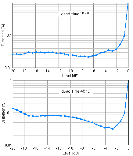

the sources of THD that you have found in conventional UcD topology?
Have he? Have I missed something?

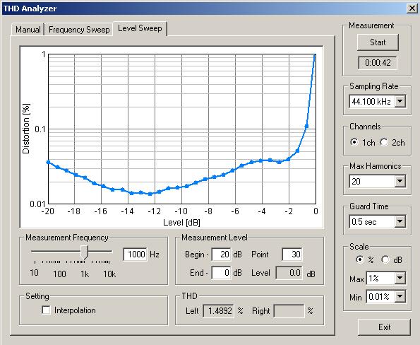

IE6 don't show your file .png 😡 (totally black picture)
For other forum members with the same problem:
I had to save the file and open it with a non-M$$$$soft image viewer
OT: It's time to change....
