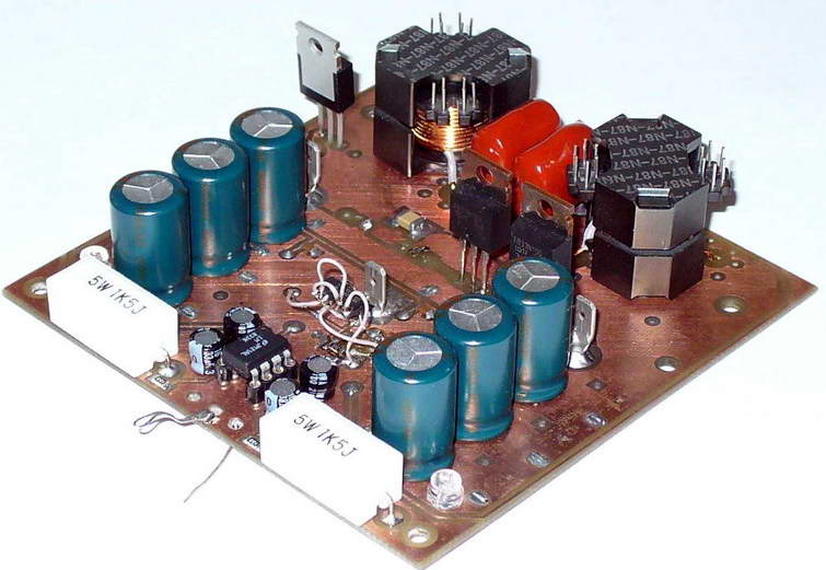

Very nice
Dear Bender,
very nice. Excatly, what i was looking for. And the documentations is perfect.
Do you think, i can replace the output coil by a ring-core? Any negative impact to fear?
Is the power limited by the Mosfets only? Can i get more power by bigger Mosfets, Caps and Coil?

Hi iwan_audio.
Using PS with 40-45V per rail you can obtain 200W @ 4Ohm using irfi42112 or irfi4019, there is no need in other changes (maybe reset OCP thresholds) and don't forget about proper heatsink 🙂. It's also possible to replace output inductor by ring core choke, you can find all necessary information in this forum.

Very nice work, Bender.ru!
I have a question, why is R21 referred to GND and not to
COM, as shown in the datasheet from IRF?
hmm, let's think together 🙂. What is going on if you connect R21 at drivers COM pin?
R21+VD5 act as power supply for low side driver.

Nice work Bender.ru
I will build a similar concept with IRS20955. Your schematic is
good input.
@Kay
If you connect R21 to Com you will have charging current for C12 and therefore no voltage at VCC.
Current through R21 can be calculated very easy
(40V-VD5)/R21=(40V-15V)/1500Ohm=16,6mA
Power loss in R21 Pv=416mW. So 500mW resistor is o.K.

thanks Bender.ru + Eljo
but in the datasheet we find a two resistors providing
"DT", one to VCC and one to the negative rail.
You fix DT to "DT1"? (Table1, page 15 on datasheet)
If I'm not completly stupid now, why do you do this?
If I use other Fets, I must change this?

of courseR21+VD5 act as power supply for low side driver

Bender, i am just finished your amp for sub. Its produce powerfull, perfect quality bass with very low loss and distrotion . The PCB ideal for sub use!!!
Best regards, Denis
