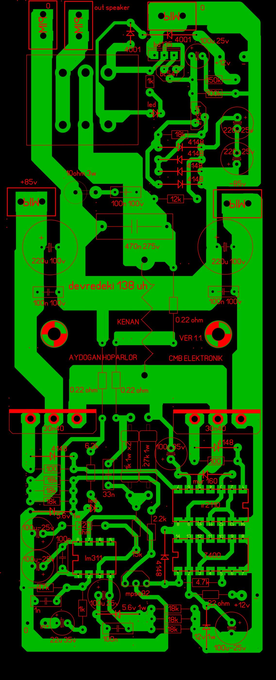

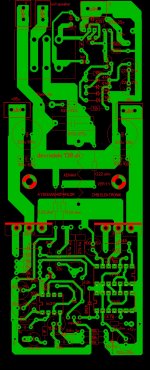

I get angry this week and design AUD600 PCB by myself !
I accept to share files for PCB supplier and schematics with other DIY
Only manojtm share AUD600 schematic with me....
Have design double Layer PCB for AUD600
- add DC protect Crowbar (thanks to APEX)
- add Led for Power - Signal and Clip (thanks to APEX)
AUD600 PCB IRFP4768 Mosfet with Crowbar and LED Power - Signal - CLIP
AUD600 PCB with 2 x IRFP4768 Mosfets with totem pole driver, Crowbar DC protect and LED Power - Signal - CLIP

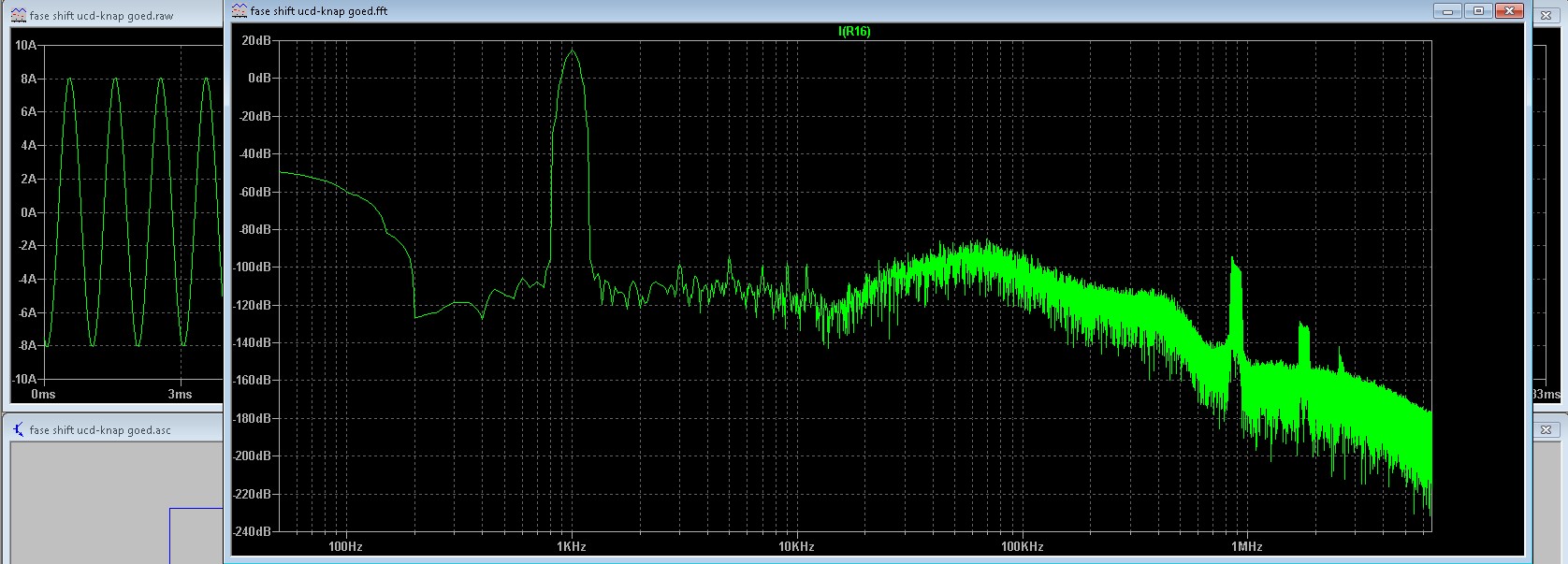

Some months ago I did finish a class D amp, a fase shift frequency doubling type, it give very low distortion in sim, with deadtime active, output is 8 amps in 8 ohms full bridge output,.
So with good parts and a very fast integrator, comparator and mosfets class D can be high end.
Do build it in future to see, now first the allfet circlotron, who is a lineair amp.
regards

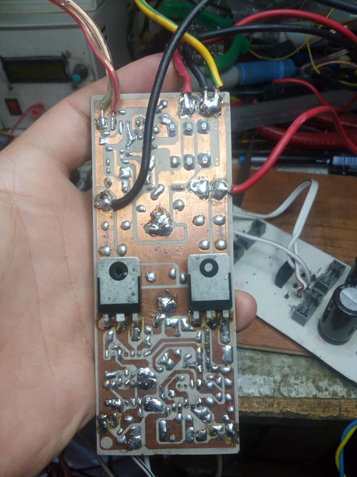

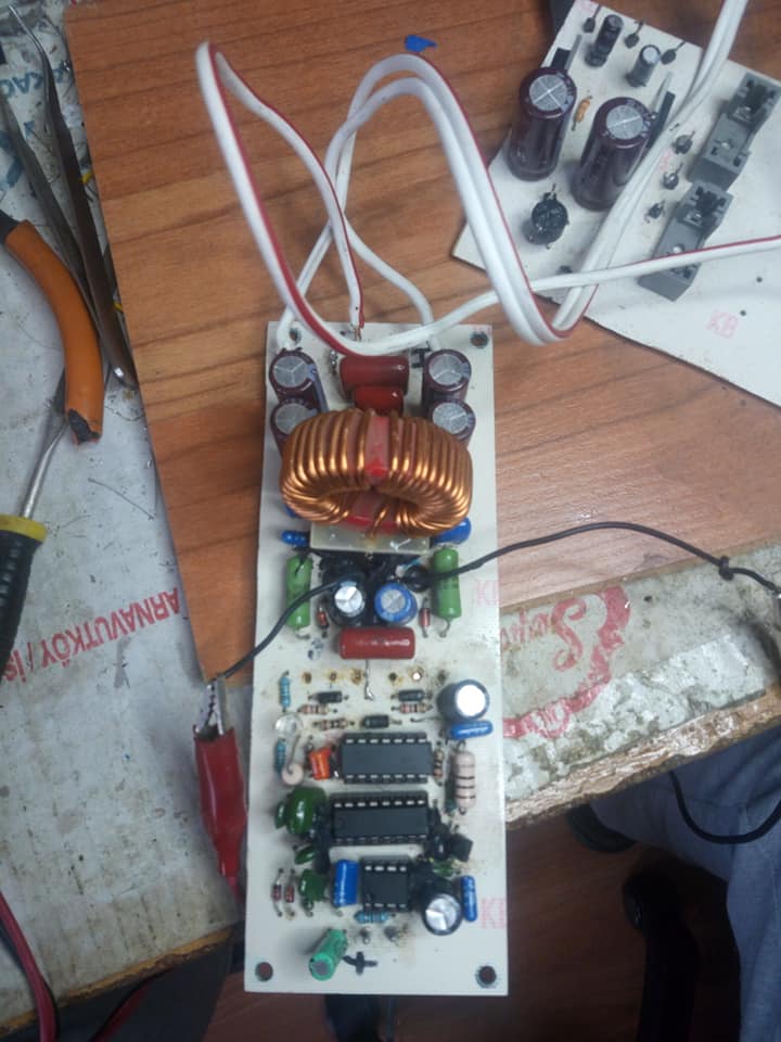

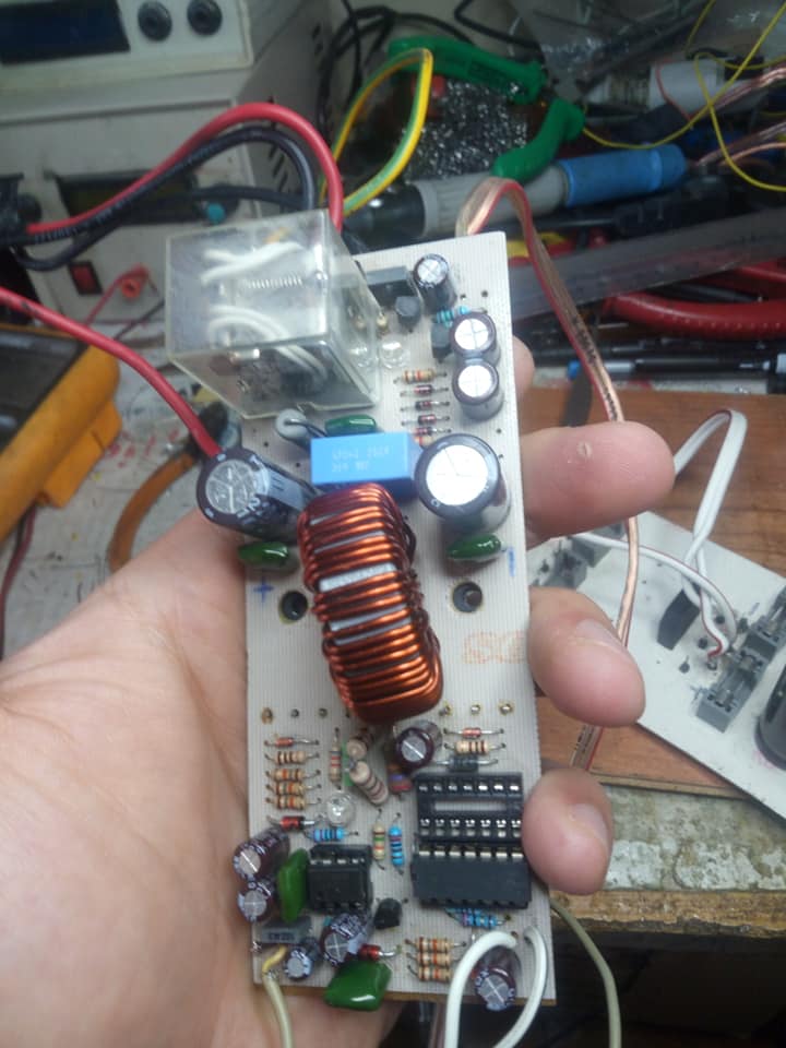

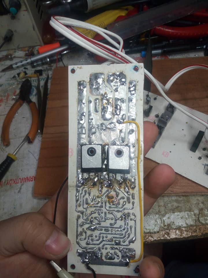

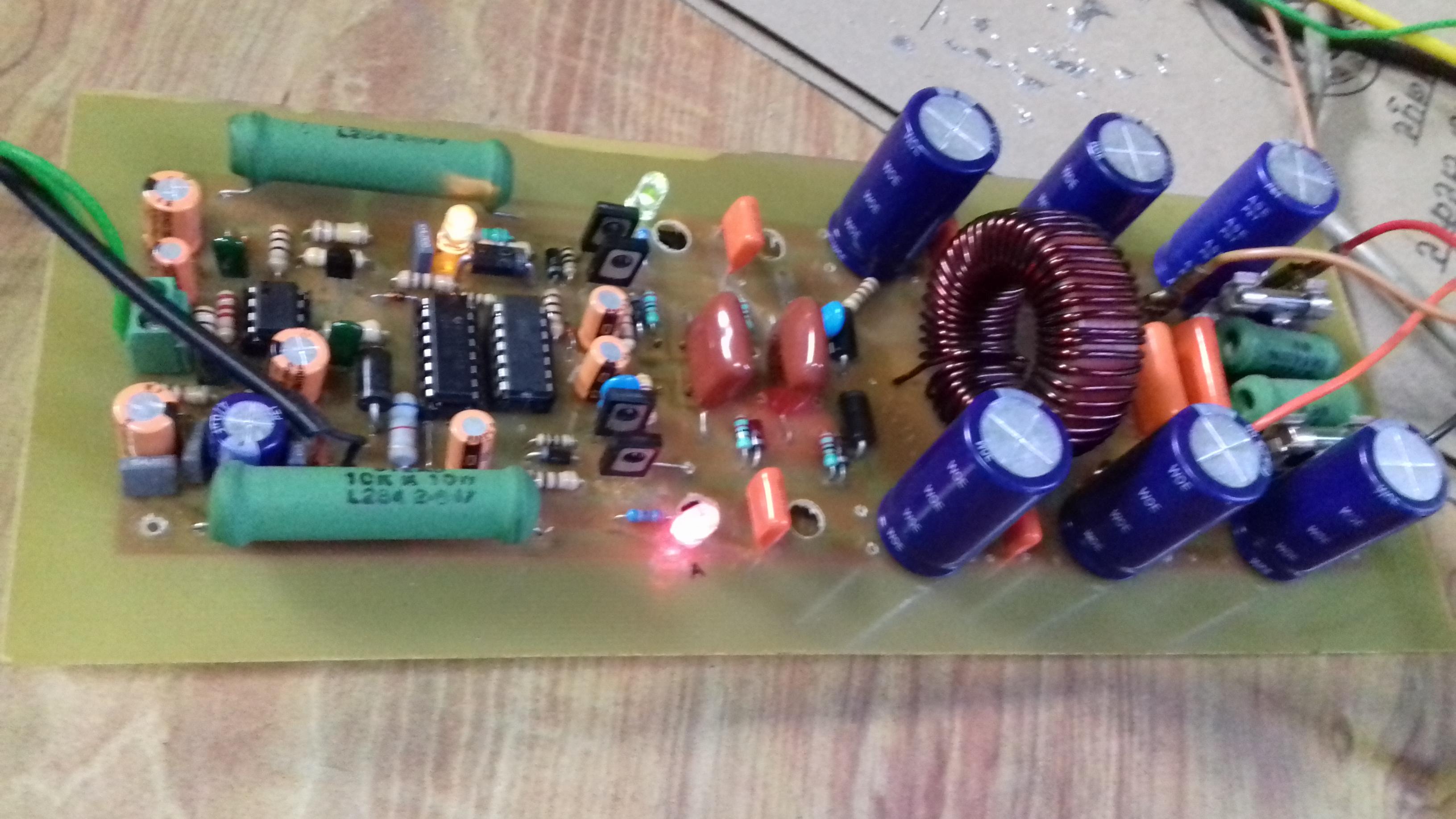

Two different 900w amplifier operation. Different circuits from each. I have copied the pcb to the other's scheme but I don't have both at the moment. No plugs. No current draw. Integrations are intact. I wonder what could be the problem? The material on the circuit without schema was deleted. I hope the cd4070 is right.
check signel input non inverted and inverted ,,,ok
,,,add 1k 3w for each amp speaker out and gnd0 .
