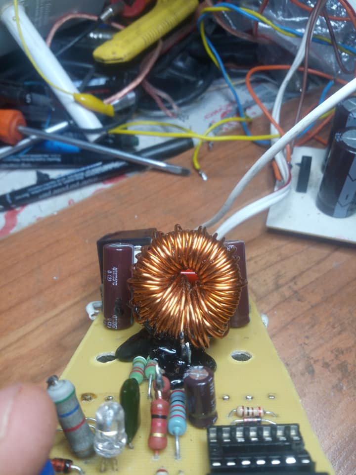

Since the output coil was so small that I had to wrap around such a small. Could it be that the IR2110 burn? 150uh

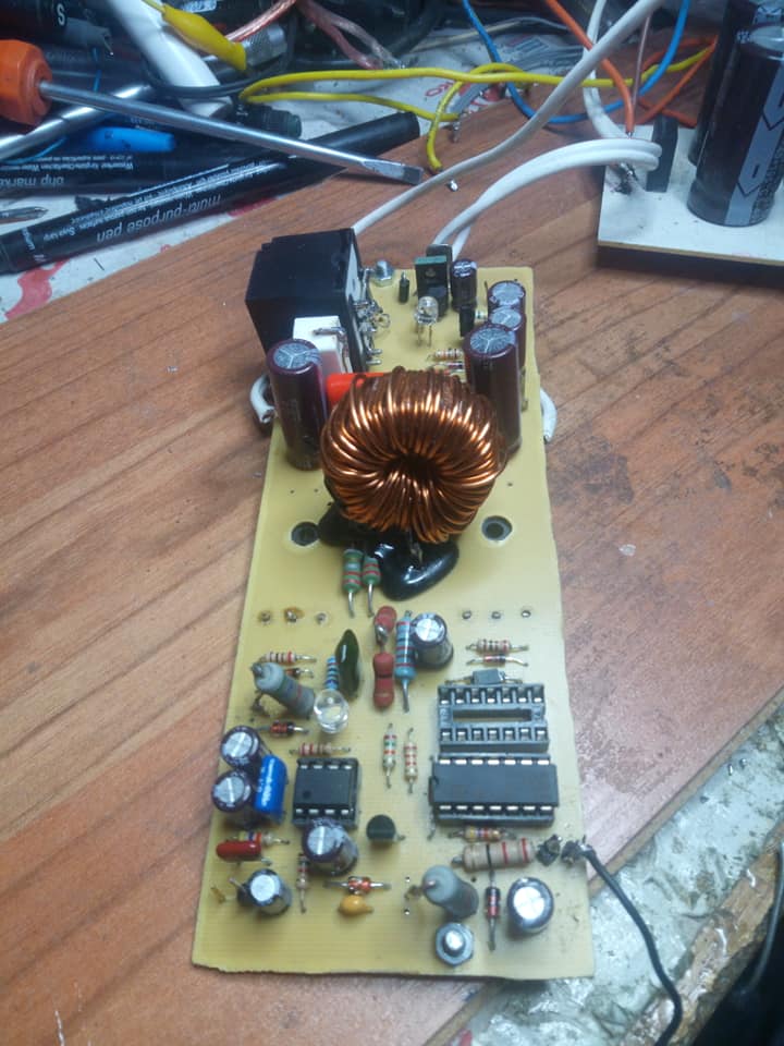

It's my first class D and it look a bit tricky 🙂 Im using IRF540Z, 22ohms+1n4148, mur120 at ir2110, t106-2 37turns with 1mm wire+ 0.47uf cap. +/- 27v 4ohms load. First try was good ,worked good, sound clear, mosfets maybe ~40-45C, no heatsink, ir2110 with small heatsink ~40-45C too,fsw ~280khz. But after week, on low volume ~5% mosfets overheated, i think got parasitic oscillation, couse input cable(not shielded) was crossed with output. After change to other pair of IRF540Z fsw dropped to ~220khz (according to multimeter), ir2110 cold, mosfets heating with heatsink ~80cm2 plate in a minute over 50C at idle. What changed? Any suggestion? Thanks 🙂

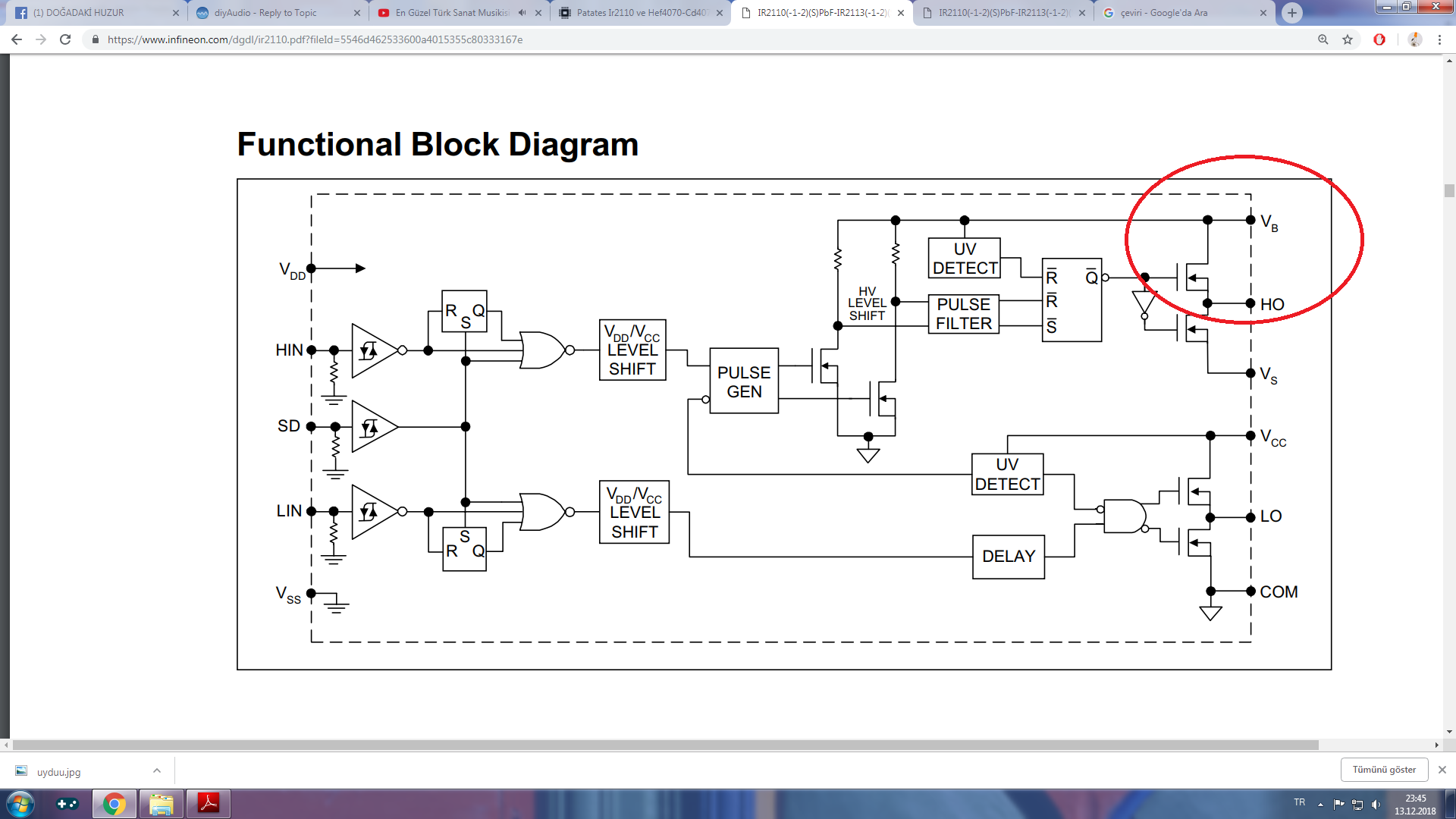

How much should be the voltage rating of 10uf capacitor between pins 5 & 6 of IR2110 if i'm going for +-90V rail voltages?
+/-90V gives a total of 180V so try 1800V just to be safe... Or you might notice that VB is derived via a diode from the IC supply, VCC, when the lower mosfet is on. Pick a capacitor with a voltage rating higher than VCC. Something like 25V. Make sure the VRRM of the diode is sufficient >180V. UF4003 or higher.

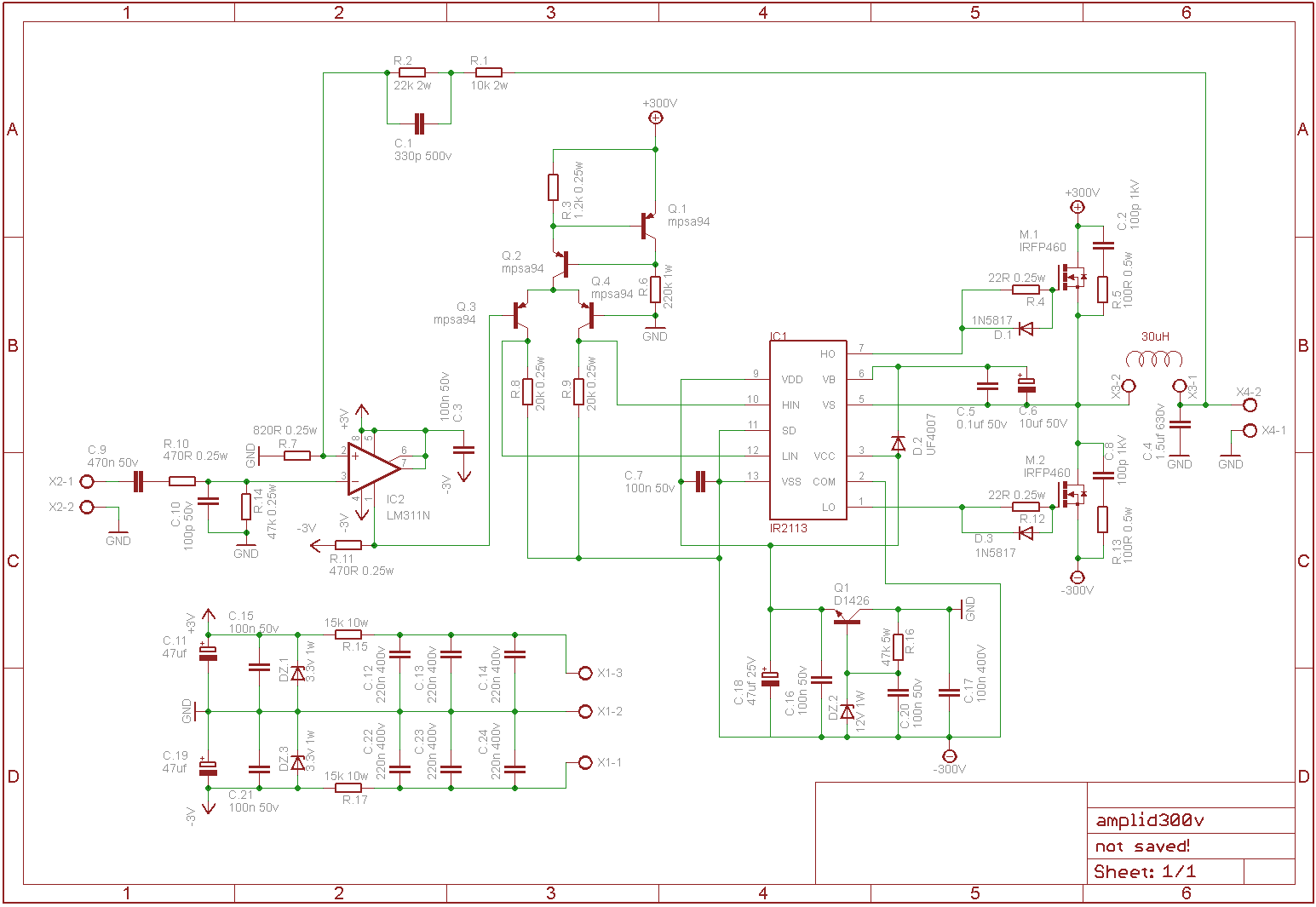

I've just found this thread and am sceptical of the basic circuit - there seems to be no provision for deadtime generation, and nothing to stop HIN/LIN going more positive than Vdd at powerup, which will blow the chip. My feeling is there's going to be a lot of very hot MOSFETs and sudden failures.
There are lots of MOSFET high low gate driver chips available, many with deadtime generation, some with programmable deadtime generation.
The differential pair circuit seems to be configured to generate about 11V across the output resistors to feed HIN/LIN, so as the current steers between the two devices there will be a crossover point with about 5.5V on HIN and LIN simultaneously.
LIN and HIN are 3.3V logic compatible inputs, so will register HIGH from about 2V up, so both MOSFETs are pretty much guaranteed to be hard on simultaneously, wasted lots of power heating the MOSFETs and generating lots of EMI and output distortion come to that.
Shoot-through can also cause sudden failure of the MOSFETs too.
(Assuming I've understood the function of the circuit of course.)
Substituting the FAN7380 for IR2113 might be worth considering, it has shoot-through prevention with 100ns deadtime and is also 600V rated.
The original circuit using 300+300 supply and a 600V absolute max driver chip is a complete face-palm, 600V absolute maximum is totally not the same as 600V working voltage!
