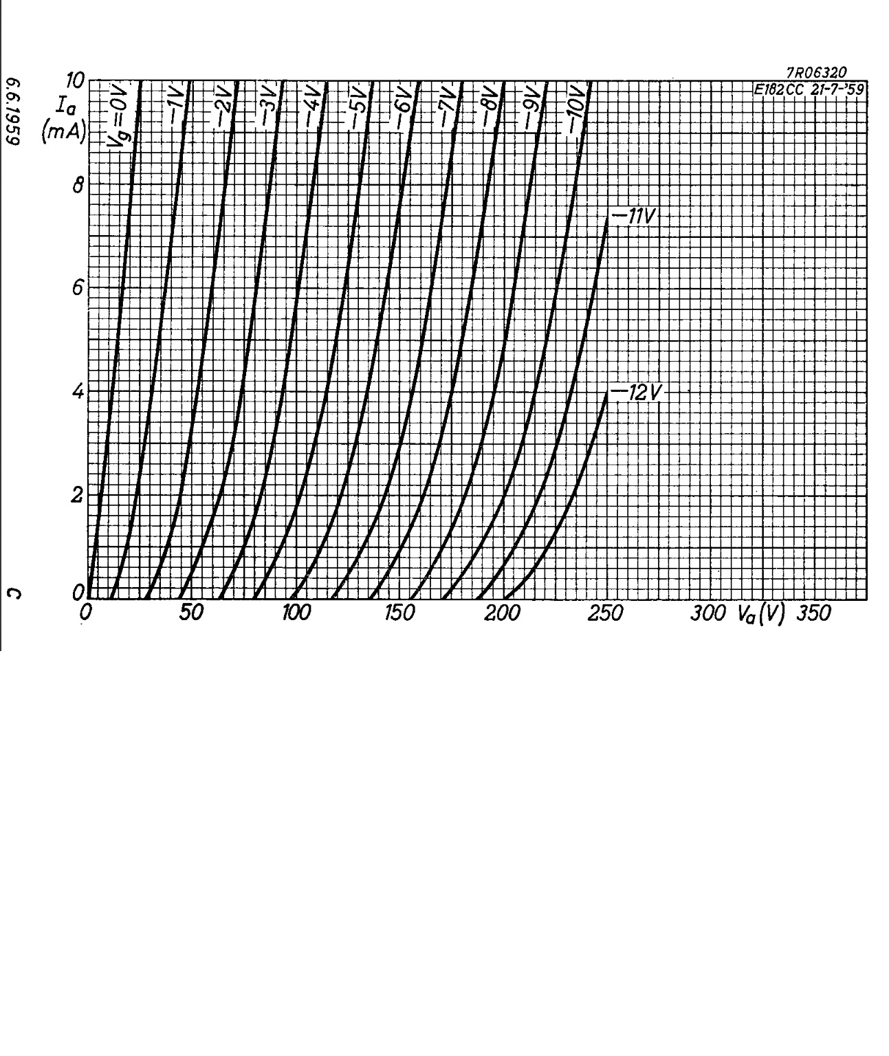

Let's say e182CC at 15mA and 200V at -8V ? Obviously only transformer-coupled to get a flat loadline.
The curves above 10mA look pretty good:

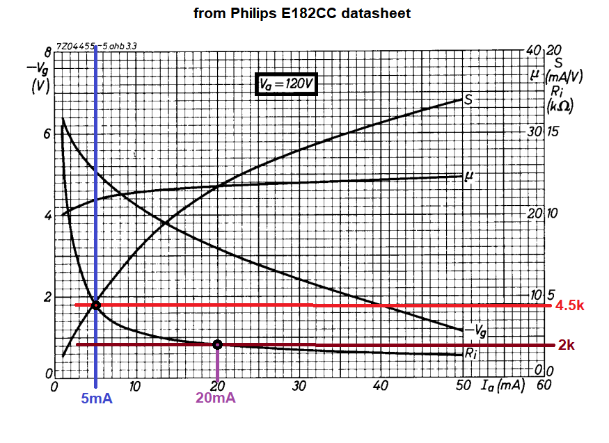

First, what do you define as 'low rp'? With plate voltage of 200V and plate current of 5mA, an E182CC is going to have rp up around 5k ohms -- not way down at 2k or lower. See the attached graphic of E182CC characteristics at 120V plate voltage from the Philips datasheet. With plate voltage = 200V, rp will be higher and gm lower than at 120V for the same plate current (Ip).
It's a common mistake to treat plate resistance as a 'constant.' Only mu is relatively constant at different operating conditions. rp and gm can vary quite a lot, even in very linear triodes.
Generally speaking, if you want to get that 2k ohm rp from a 5687, E182CC/7119, or 6N6P, you need to get the Ip up to 15mA or more, like the >20mA Lynn mentioned. That means lower plate voltage, which means less voltage swing available from the plate. Everything is a compromise.
For 5687 tubes, I like operating points around Vp = 150V, Vg = -4V, Ip = 20mA, Pdiss = 3W (that's near the max).

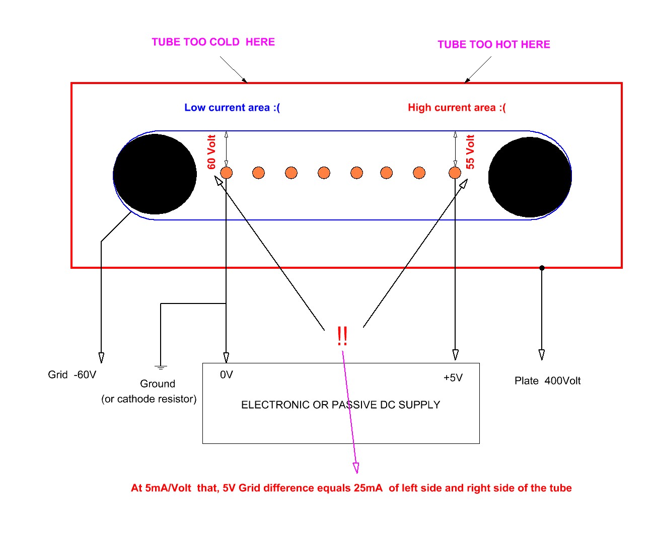

I was studying EML warranty conditions and came again to the part where they request to use artificial mid-taps (two 33 ohm resistors), even with DC-Heating.
Emission Labs - Introduction
"12. LAST BUT NOT LEAST, THIS ONE. Never use a filament with one end to ground and the other to the the DC module, UNLESS you do not run the tube very hot . This causes the one side of the tube to wear out faster that the other. Here is a drawing that hopefully is self explaining."
The drawing:
Ok, I get fully the point that for a 300B at 450V -100V this leads to 60mA emission. At -105V, this leads to 39mA and at -95mA this leads to 90mA emssion. So, Jac's picture is right: There is a difference of 30mA between the left and the right side of the plate/filament. So, a hot and a cold side as shown above.
The only thing I do not really get: Why would a mid-tap-setting change that ?The difference of 5V stays, only the ground potential is now between the taps...The hot and cold side remains, no ?
So, if you cant change the hot vs. cold side thing, than a switch would make some sense that yu could switch hot and cold side to consume the tube in a more balanced way, no ?
In fact it doesn't make any difference. Adding resistors + pots is only useful if you use AC heating for hum minimization in stationary conditions (i.e. without signal on the grid). If you have DC supply they only make things worse.

Anyway it is called thermionic emission for a reason. It's not the voltage from one end to the other respect to ground that controls the emission (or better electron evaporation to form the cloud around the cathode) but temperature which will be uniform all along the filament regardless of DC or AC supply. That picture of unbalanced emission from one side to other is simply wrong, IMHO.
Or better it also depends on what happens next to the emission (i.e. geometry of the tube , field etc....) It might true in some cases but not general. For what I have seen this is a problem for things like electron guns that operate with 50-60 KV accelerating voltage, no control grid and where likely there is no (or very little) cloud around the cathode/filament. In this case I can believe one has hot spot and cold spot using DC heating.
Hot and cold are referred to the plate. Tube life is 99% dependent of the filament life. I don't think you can change tube life by doing that.
The picture you posted with hot and cold spots is too simplistic, IMHO, because it depends on the real field the electrons will see which is not simply proportional to voltage differential....Therefore the first and very practical assessment is: if you can't see a red plate then it is fine. Performance wise you just go for the better routing....
As I said in the previous post the filament is fine, there is nothing you need to add once you decide to go for the DC (current and voltage) regulated supply because the electron emission depends on its temperature which is rather uniform regardless of AC and DC supply. The filament supply then has the only task of supporting the emission by filling the gaps and preventing electrons going back into the the filament from the cloud.
45, I do not want to hijack zigzagflux's thread, but if he allows this discussion: I follow your logic that the cathode temperature is highly likely to be the same across the cathode. Nevertheless the negative voltage between the grid and voltage defines, how many electrons are allowed to pass to the anode, no ? The more negative this voltage difference is, the more electrons are pushed back and cant pass the grid in their way to the anode. So, Jac's picture is right.
HOT and COLD are here meant more like making a comparison for higher or lower current flow in my opinion and not as a temperature thing. The real point is: If for instance the data sheet says: max Cathode current: 70mA (for a 300B as an example) AND you use this in fixed bias (as I do with Rod's bias regs) with 450V and DC heating (with Rod's filament regs), I should not go above 55mA as 30mA is the max difference, so probably one side will have 40ma emission and the other 70mA.
Well...not sure which case the fixed bias case means in the data shet as there is a second case which is defined as max current for manually adjusted grid bias ...(which is fixed bias, no?) and there the max. is 100mA.
Anyway, I believe Jac makes here the point for the case of not driving the tube towards max power dissipation I guess, so with 450V and 60mA, we are still with 27 Watt at 67,5% of the allowed 40 Watt in a safe area I guess.
I simply did not get his point that the two resistors would change the situation...maybe I give him a call.
Nevertheless the negative voltage between the grid and voltage defines, how many electrons are allowed to pass to the anode, no ? ]
No. It is the actual electric field that accelerates the electrons which is very likely not just proportional to the applied voltage differential.
Of course if one has a filament supply of just 1.5-2V instead of 4-5 and low mu triode it is a better choice! I am plyaing with the type 49 these days. This tube can only work with 2V DC filament supply with typical bias around -20V to -25V. Very linear device.
I can understand that. They simply don't have data to fix true maximum limits for their tubes as it was possible in the tubes golden era...
A few years back it was the same with positive grid drive. They could not say anything and for that reason I never bought their type 45.
You don't need my permission; deviations are good for any discussion, although hopefully we don't stray too far into capacitor flavors and wire insulation color. I am unashamedly a pragmatist.
Pursue your heating preferences as you see fit; when you get some measurements of the IT performance, bless us with some results🙂
