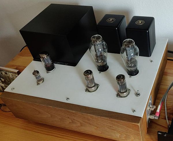

I don't know - based on your picture, I'm wondering 1 and 7 don't go to the grids, with 2 and 6 being the common connection to bias. I am sure if you contact MM, Ward or Yves would be more than happy to confirm to you which is most correct. In simplest terms, you want to ensure the instantaneous polarities are in phase between plate and following stage grid. You can get it to work with incorrect polarity, but the high frequency phase shift will likely get really wild, and it should be easy to see on the scope.
So give these IT's a chance; perhaps they aren't hooked up correctly at first try.
It would be PP to SE...and I would like to use the Monolith above instead of buying another pair...
Zigzagflux...yes, I send Ward a mail with the scan above...to be clear: The hand drawing with the definition where the bias has to go to came from him or Yves, it was part of the delivered documentation.
I am not sure you can do that with the bifilar Monolith. Ask the manufacturer...It would be PP to SE...and I would like to use the Monolith above instead of buying another pair...
I did...Yves told me that this is not possible...as well, his advise was to ignore the table, the drawing is the relevant piece of information. He told me to measure if phase is correct as this is a custom version, not documented. So I did...and yes, I have the right phase. Hmmm...now I need to re-think the idea of using one IT for both, PP...I have still a pair of LL1692A and LL1660AM...but not sure if those can ideally connected in a way in PP to SE that at least gain is staying the same, ideally a bit more. In the documentation I have found always only setups with reduced gain.
With the Lundahl you can do PP:SE. As as I said earlier they trade off performance at HF for flexibility. That's the only area you need to work on.
With the LL1692a you can certainly connect it as 1.75+1.75:1 (i.e. secondaries all in parallel) which is called ALT N connection or reverse the ALT V connection 1:75:2+2!

45, thanks for your ideas...I guess what I will do as a quick fix to test PP vs. SE: Use the IT as anode chokes and C-couple to the SE-Stage. The sound difference between Jupiter Caps and go full IT-Coupled is not dramatically IMHO...but I am using Silk-grid chokes in this setup, which might have as well an influence (to the better)...that way I should be able to use the Monolith ITs even for SE. The sound signature is a bit more clear, faster and tighter overall compared to the Lundahl...the Lundahl seem to have a more softer image overall, which might be what you want depending on your setup...their DC-resistance is as well double of the Monolith and the inductance four time more (LL1668Am anode choke PP).
The idea of PP driver for SE power stage has been used successfully in the past. Audio Tekne for example made a very compact (custom) 15W 845 SE using this kind of driver. This way they could also use their own typical permalloy transformers. The PP driver for the 845 was a 6350. A.T. amplifiers, despite the usual mystic presentation, are very solid and well performing amplifiers in all departments.

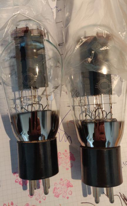

Zigzagflux/ Lynn, I have a quick question on the original Karna heating solution for the 300B...
Backround: I lost from the 10 Svetlana 300B I got, 3-4 in the last couple of months. Now I learned, that the Svetlana do not like DC-heating.
So, I would like to test this hypothesis and heat them with AC instead. I like the simplicity of Lynn's approach: No additional resistors (Which are in the signal path) for the electrical Centre Tap, just use the CT of the heater transformer.

Backround: I lost from the 10 Svetlana 300B I got, 3-4 in the last couple of...
Nonsense !!!
For the last 16 years I have used only 2 pairs of = C = (not "S") Svetlana 300B with DC heating. DC heating is designed as a simple CVS for f + and ring-of-two CCS for f-.
I have never had any of the issues mentioned in the post above. But I ALWAYS used a Siemens medical power transformer for a very slow-turn-on.
I've written about this before in this forum, but I have to do it again. Sorry!
Nonsense !!!
It is true that some early Svetlana 300B tubes had a problem with DC on the filaments.
There can be uneven spacing from the filament wires to the two sides of the plate.
1.25 Amps DC makes each filament wire an electromagnet. And if the DC power supply is not soft start, or is not current limited, the cold filament has more than 1.25 Amps DC at start up.
There can also be an uneven spacing from the filament wires, to one side of the grid wires than to the other side of the grid wires.
With the above conditions, the failure mode is that one or more of the filament wires is attracted toward one side of the plate. As the filament wire moves, it then contacts the grid wire (now we have Zero bias).
That is what I, and others I know have had happen to us.
