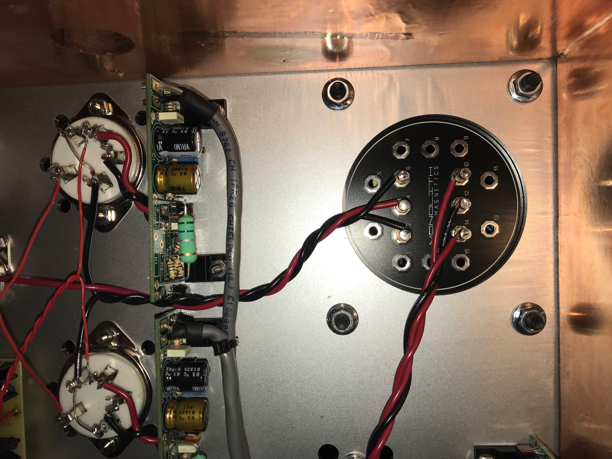

Zigzagflux,
May I ask how you connected your Monolith IT in detail ?
This came with them:
So, when in your schematic the triodes at the top of the push pull are "1" and the triodes at the bottom are "2": Did you connect the anode of your 46(1-upper system) to 14 and the grid of the 300B (1-upper system) to 2 ? Is this the way ? This is how I would read the text, but the drawing from the colleagues of Monolith next to the table is confusing me a little bit.
Looks like we have different transformers. I am using the IT-02. For my setup, 2 and 6 go to each respective 46 plate, and the driver stage B+ to terminal 4.
On the secondary, 14 and 10 go to each respective 300B grid, with 12 going to the circuit common of the output stage.
Based on your hand sketch, it looks like the primary is described correctly (12 to driver B+, 10 and 14 to 46 plates). On the output stage, I would connect 1 and 7 to the 300B grids, and tie 2-6 together to circuit common.
Would be easy enough to test, to verify polarities are correct. You could run lissajous test to make sure you have the right bifilar windings identified; it will either be completely right or completely wrong, I would guess, not much room for interpretation.
Strange...I got the ITA-02...it is defined as (1+1): (1+1), so I was not surprised to see two separate secondaries...by the way: Connection 4 in the table is a tab between the two secondaries actually...not sure how the drawing shall look like with tab 4, but I guess it is needed to be conncted, even when fixed bias with two secondaries are used ?
Don't think I follow you. Are you saying with 1+1:1+1 you have three primary terminals and 4 secondary terminals? Can you take a picture of the transformer terminals?

By the way: If I want to drive a SE-Outputstage with this transformer...? Paralleling the secondaries or just use one ?
2 and 6 are the terminals for the grids and you should follow that. Capacitances might not be the same if you use 1-7 and so FR. You can try....
Anyway, following instructions for 2 and 6 to the grids, 1-7 can be tied together with self bias or common neg. bias or stay independent if individual neg. bias.
Because the transformer is 1+1: 1+1 and fully symmetric one can reverse primary with secondary as in the case of zigzagflux...
For SE operation both primaries and secondaries would be better off in series, with the right phases. That's the IT-01 (with air-gap for 25 mA anode current) basically. Otherwise you will get 62.5H only which is less than the IT-01/25mA.
