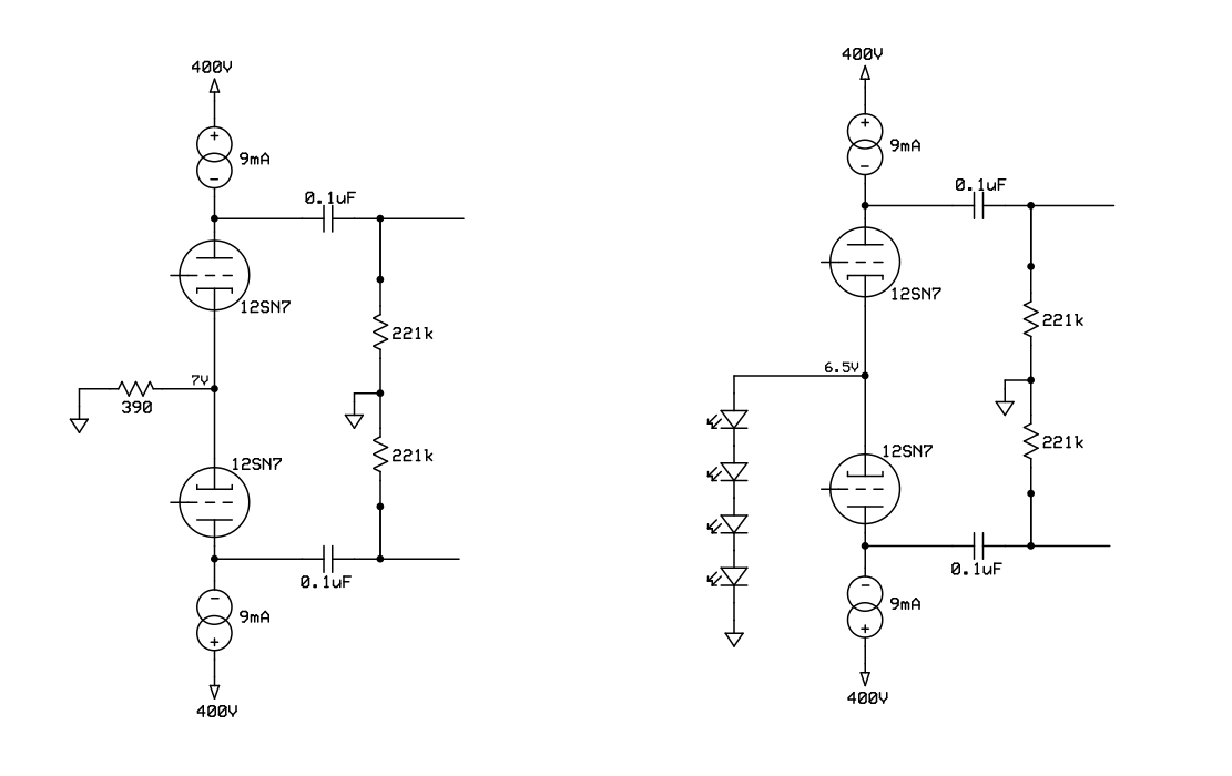

So I have nearly finalized the design. I can share a schematic and FFT shortly, but I wanted to resolve one last issue.
Attached are two options for the first stage, one with resistor and one with LED. I wasn't finding a significant difference in the measurements, so I am wondering on a theoretical basis what is the fundamental difference between these two topologies? If I have differential in, differential out, does it really matter if I have a lower AC impedance in the tail?
Ignore any small differences in grid/plate voltage.

The way you are using them, there is very little difference between the two.
If you had a bit of a mismatch in gain between the two triodes in the tube, you would have a (tiny) difference in behavior between the two circuits, but not much. The load you are driving is pretty straightforward. The way you are driving it is straightforward as well.
The difference between the two circuits will become more apparent if you try to drive a load that requires more than twice the idle current at its peaks or if you had gross mismatch between tubes. You could play with a simulator if you want to see this in action.
A voltage source at the cathodes isolates the two sides to that they function independently and form a push-pull circuit. The defining feature of a push-pull circuit being that you can deliver more than twice the idle current to the load if necessary. This circuit is most sensitive to gain mismatch between the two triodes.
A current source at the cathodes makes a differential circuit. Balance is strictly enforced. One side is the exact compliment of the other at all times as long as loads are equal. You can only deliver twice the idle current to the load at most at any instant. If you try to do more, things tend to get ugly.
A resistor is somewhere in between a voltage and current source so you get a mix of the two effects.

Yes, that makes sense and intuitively I was thinking the LED's would get me closer to a push pull rather than differential. Since grid current of the next stage is effectively an impossibility, I have no concerns about drive capability.
I will stick with the resistor to K.I.S.S.

I built an amp for my brother and I gave him the choice of resistor or LED. He chose LED because he just likes glowing lights.
I would have put a resistor myself.

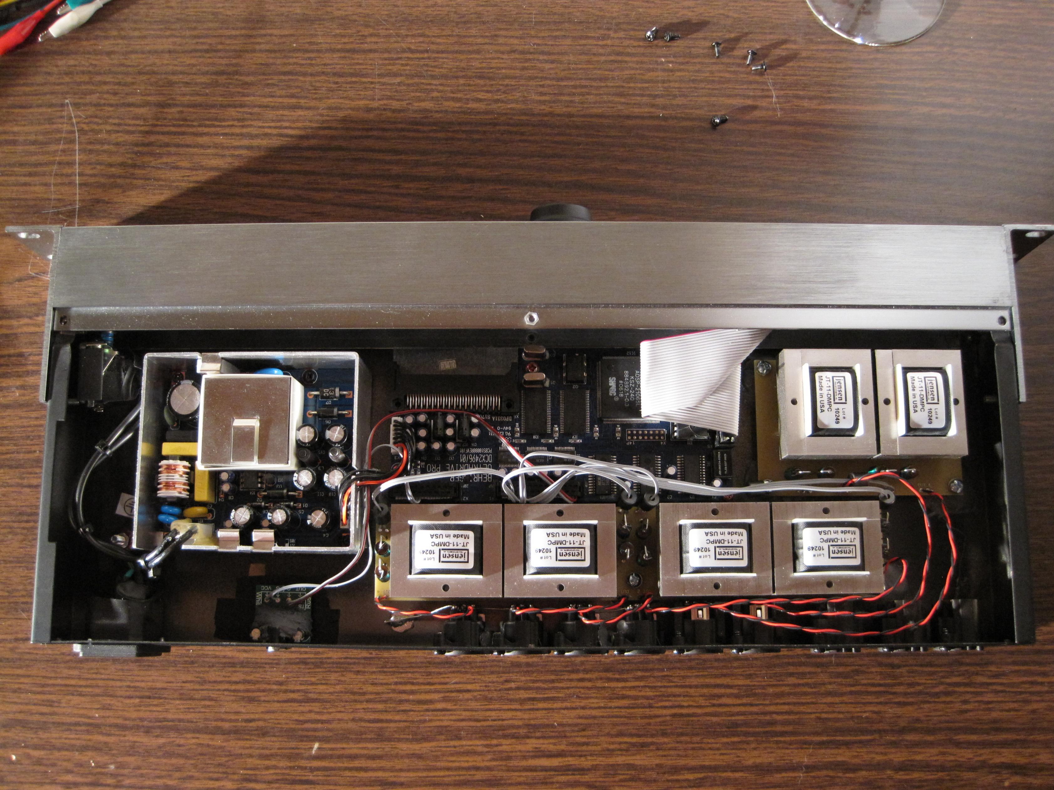

Attached. The Behringer is gutted of the output stage, and the transformers are nickel core. Direct from the DAC output pins to the transformer primary (NO resistors are needed!) and the the secondary is left floating to the XLR output jacks. As balanced as it gets.
The input is USB to SPDIF into the Behringer. Some day I might pursue i2s, but that isn't my biggest concern at this time. Benefit is I get customized EQ and crossover, without having to go A/D then back to D/A. All processing in the digital domain, and the source material is digital. No LP's for me, I had enough of that in my teens.

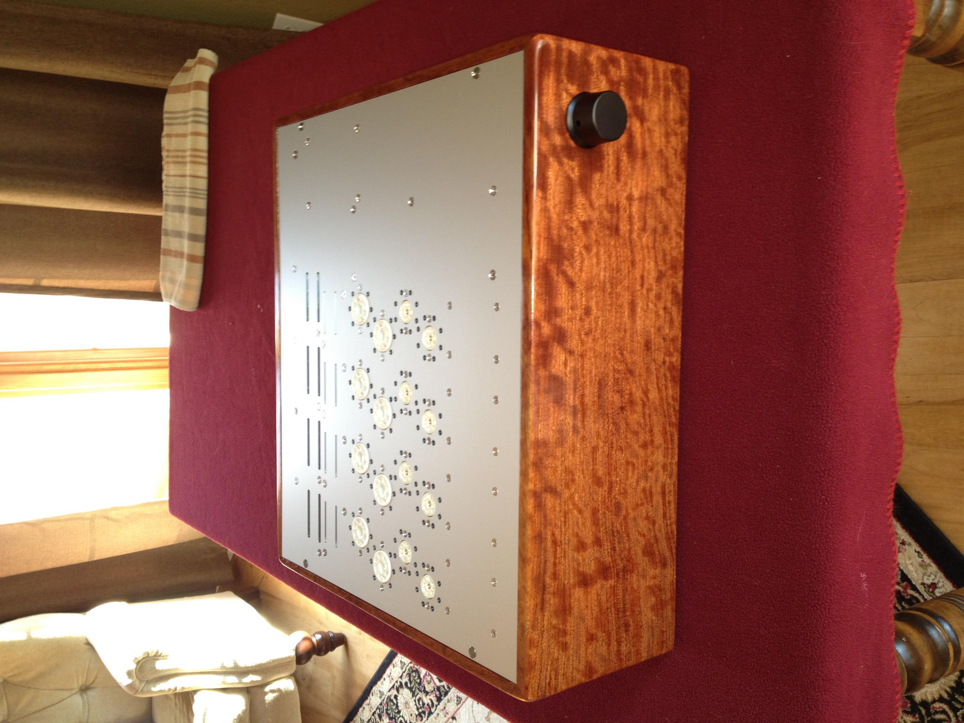

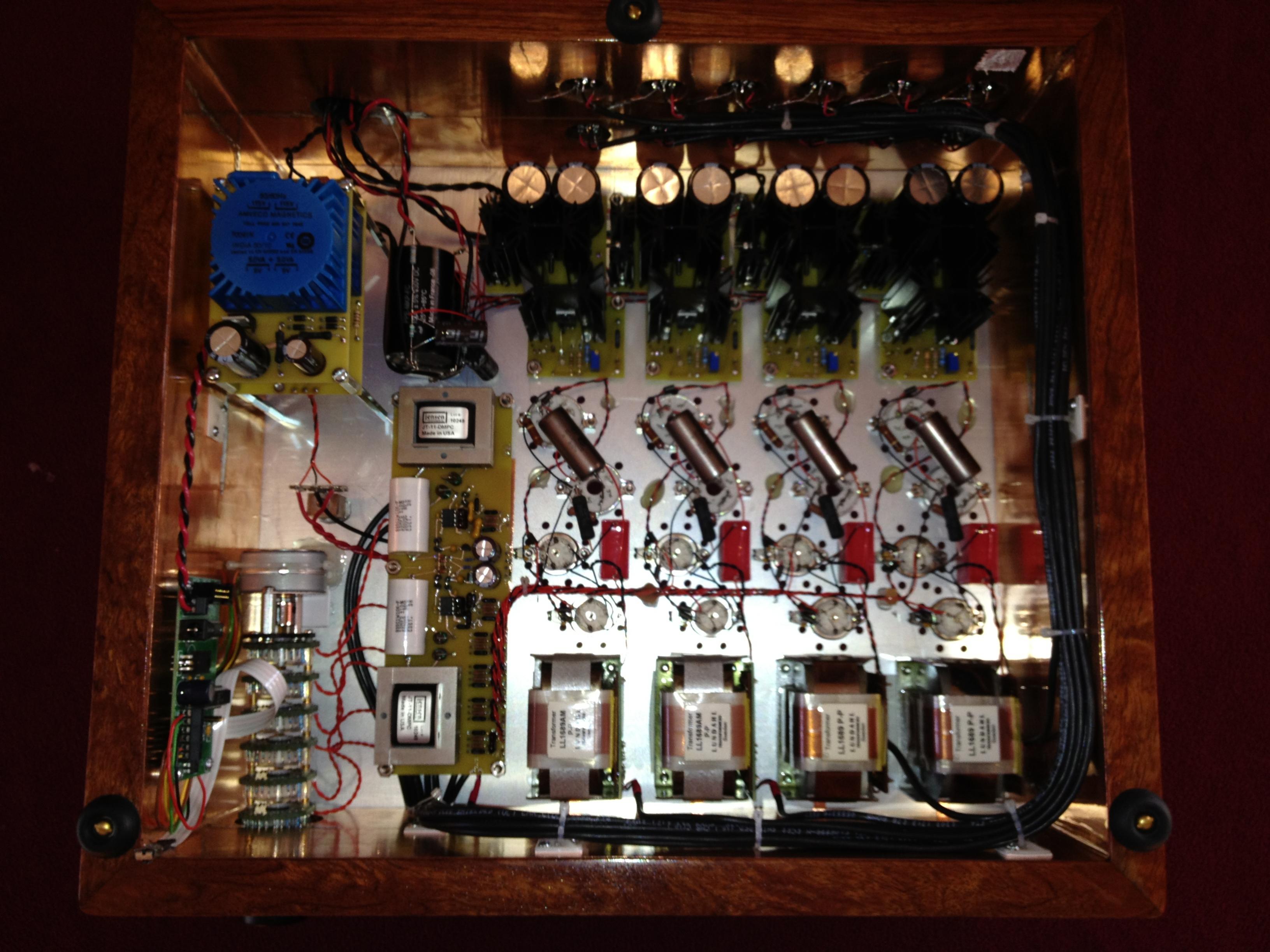

The preamp has a 6-channel ganged Goldpoint attenuator, which is the '50k' flags in the preamp schematic. So I get 6 channels of audio, 4 are tube for stereo mids/highs, and the 5th and 6th channels are for subwoofer using the SSM2019. Good application for bass IMO. Don't need tube there; my subwoofer amp is AB transistor anyway. With the volume control in this location, the burden on the Behringer DACs is reasonable, and they also run full scale output 100% of the time. Analog volume control is the way to go unless you have a whole lotta bits to spare.
That 4.7 uF cap in the output stage is a Wima film/foil, which does really well there. Also, I have an amorphous LL1689 stereo pair and a silicon steel LL1689 stereo pair, so can compare the differences in running the tweeters vs the midrange with amorphous. TBH I haven't played around with that yet; my Ariels are using passive crossovers per Lynn Olson design.

I have a Behringer DE!2496 EQ that has been modified to use transformers straight from the DAC chip. I used O-Netics transformers. It makes it into a really nice sounding unit, surprise as that may be.
