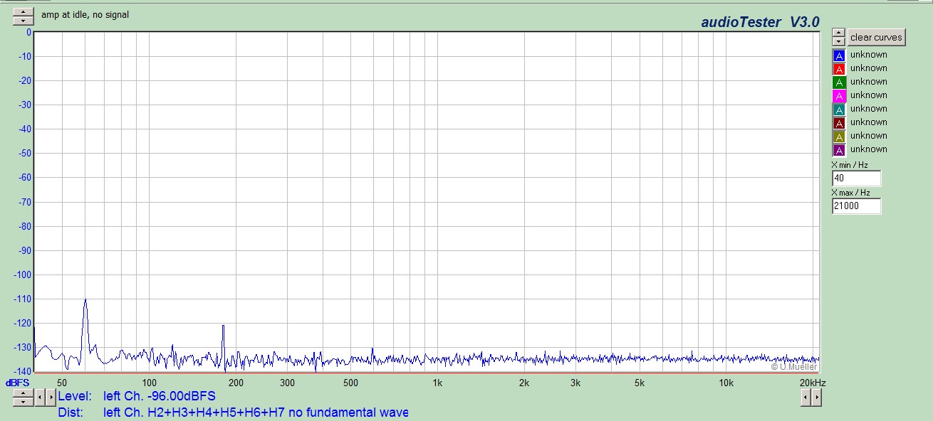

The only comparison that I was able to discriminate was measurement based. If I compared with my ears, there was not any discernible difference. The amount of hum at the speakers was very small without the regulator, such that it would not have been a problem. But when the regulator was in place, the measured noise floor was just so small, it was a beautiful thing.
There is the slight benefit of having a predictable idle condition when you know exactly what the B+ will be for that stage.
The 60/120 Hz you see in this is strictly due to the unregulated output stage; if I look at the driver stage output I am unable to measure any hum at all.
