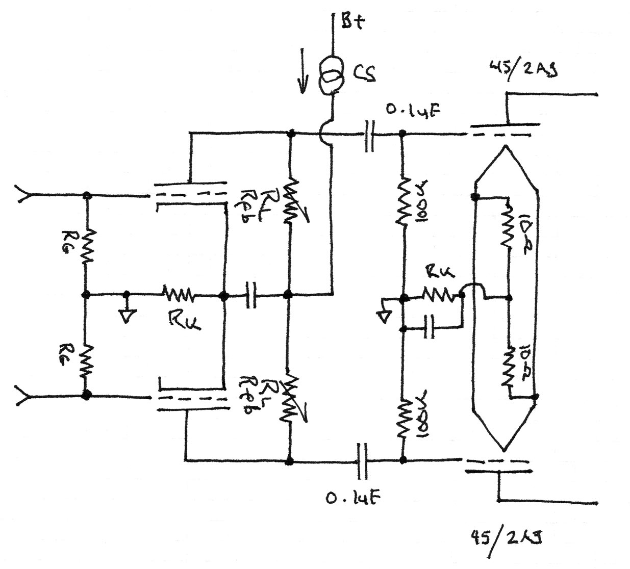

This thread has me thinking of common-mode feedback, or what Western Electric called the "Harmonic Balancer". I find it interesting that WE didn't use global feedback on their PP 300B amplifiers; they used common-mode feedback instead. Global feedback was reserved for their single-ended amplifier. And this was the research group that invented feedback only five years earlier.
A subtle advantage of common-mode feedback is that doesn't affect overall loop stability, although you still have to be careful that no common-mode oscillations are induced. More usefully, it reduces the most prominent and hard-to-remove distortion of Class A PP triode amplifiers: odd-order distortion. As is well-known, an all-triode balanced amplifier operating in Class A (not Class B) will, in principle, only have odd-order distortion (if perfectly balanced). Global feedback will reduce this, of course, but at the potential expense of loop stability.
Common-mode feedback is a different animal. It only affects common-mode gain and distortion, and has little to no effect on even-order distortion. It can, however, reduce odd-order distortion by 20 dB or more.
I have a particular interest in this since Gary Pimm and I found that nearly all the high-order (5th and higher) distortion in the Karna amplifier is coming from the input tube. Both the 45 and 300B have vanishingly low 5th-and-higher distortion terms, which I feel is a large part of their transparency. This was not true of any indirect-heated tube we tested; more seriously, there were 20 dB differences between vendors in the levels of 5th-and-up harmonics, and the harmonic profile only changed slightly (3 dB) with changes in operating current. We both felt the differences we saw were the result of subtle differences in internal construction, and not visible from the outside of the tube.

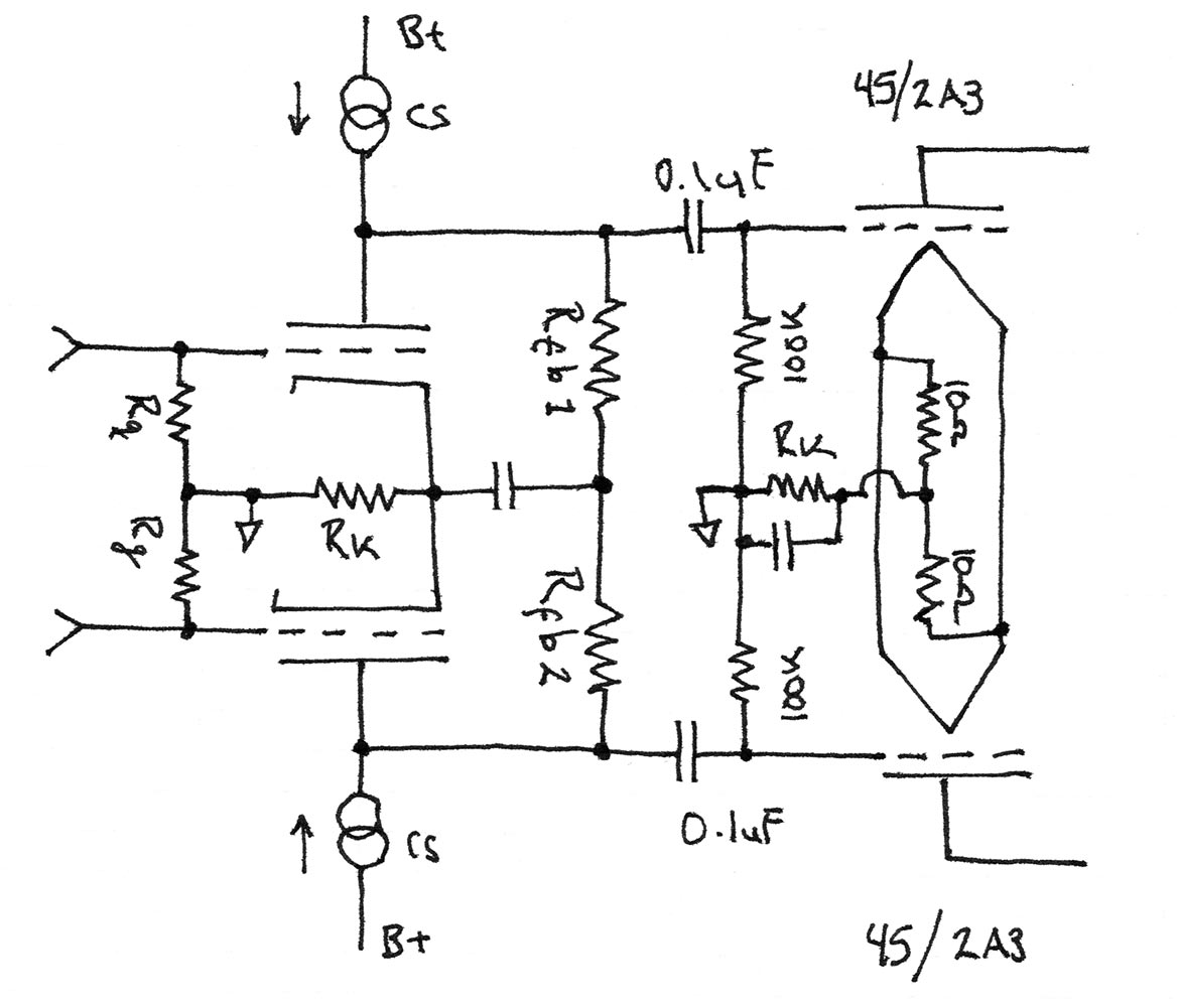

Looking at the schematic posted at the beginning of this thread, I noted the cathode bias setup for the input tube. In the current version of the Karna amplifier, I have an Ultrapath-style bypass cap between the center-tap of the interstage primary and the paired common cathode of the 5687/7044/7119 input tube.
If I adopted the RC-coupling shown in the previous schematic, common-mode feedback becomes an interesting option. Adjusting the Rfb resistors should alter the harmonic profile of the first stage, which after all is delivering 20V peaks to the 45/2A3 driver, so there's real voltage swing there.
Two options came to mind: two current sources, one for each plate, with independent feedback-sensing resistors. This is the lowest-distortion option, although there is a possibility of coloration from the current sources (we have different levels of obsession on this topic).
The other option is a more conventional RC-loaded input section, but with the paired Rload/Rfeedback resistors setting both AC balance and the overall level of common-mode feedback. Although overall distortion is somewhat higher (and headroom a bit lower), the harmonic profile could be different. If there are concerns about current-source coloration, it only appears in the common-mode output, which is mostly rejected in the following driver stage.
If Pieter is following this thread, I have a quick question ... are the interstage transformers you designed for Gary Dahl and myself suitable for use between the 45 drivers and 300B output section? That demands 80V peaks for each 300B grid, since the Karna is designed for A2 and AB2 operation, as well as the more ordinary A1 and AB1 modes. I expect the Zout of the paired 45's to be around 3k or so, and about half that is 2A3's are used (which I don't plan to do).
Suitable...hmm maybe but certainly sub-optimal.
The 6SN7 interstage transformers were optimized for the needed primary load impedance (high inductance!) while maintaining optimal HF bandwidth given the high Rp.
For a 45 interstage transformer the parameters are quite different.
What you're saying makes a lot of sense, Pieter. I can't begin to understand the extraordinary lengths you went in order to design and build a wide-bandwidth transformer that also operates with high impedances. Usually high impedances severely limit the bandwidth the transformer can provide ... and a source impedance of 15 k plate-to-plate is as high is things can get. The only other example I can think of are the old line-driver transformers that drove 600-ohm studio circuits.
Returning to the previous post about common-mode feedback, an offbeat variant of both circuits is replacing the two fixed Rfb resistors with a single pot (Rfb pot), the Rk resistor with a pot (Rk pot), and then cross-connecting the two wipers with a high-value capacitor (in the 40uF to 100uF range).
The Rk pot sets the overall common-mode feedback level, and the Rfb pot sets AC balance (gain ratio between the paired input+driver tubes). You'd need a spectrum analyzer to set the pots: Rfb would control the level of even harmonics (AC balance, in other words), while Rk controls the odd-order harmonics (common-mode feedback ratio). It goes without saying the transformer will pass zero common-mode signal ... that's the whole point of balanced, transformer connections used for studio mike-feeds with long cables between the mikes and input console.
I was wondering if this strange little circuit could be applied to interstage transformers, but at first glance, the transformer pretty much shorts out any common-mode signal that the input tubes might create. Sure, there's a little, but the primary windings are only a few hundred ohms compared to the 6SN7 plate impedance of 7 k ohms. The common-mode signal appearing at each end of the primary should be pretty small ... at a guess, maybe less than a volt of AC signal, compared to 40V of differential signal.
Hmm ... food for thought there. Both RC-coupled circuits shown above, as well as the circuits at the beginning of this thread, generate a moderate amount of common-mode signal, thanks to various mismatches in the input and driver tubes. The common-mode signal is finally extinguished at the 45 -> 300B interstage transformer. If each stage is full differential, with current sources on the cathode end (which prohibits current sources at the plates), there's no common mode signal, due to the very high impedance presented to the paired cathodes.
