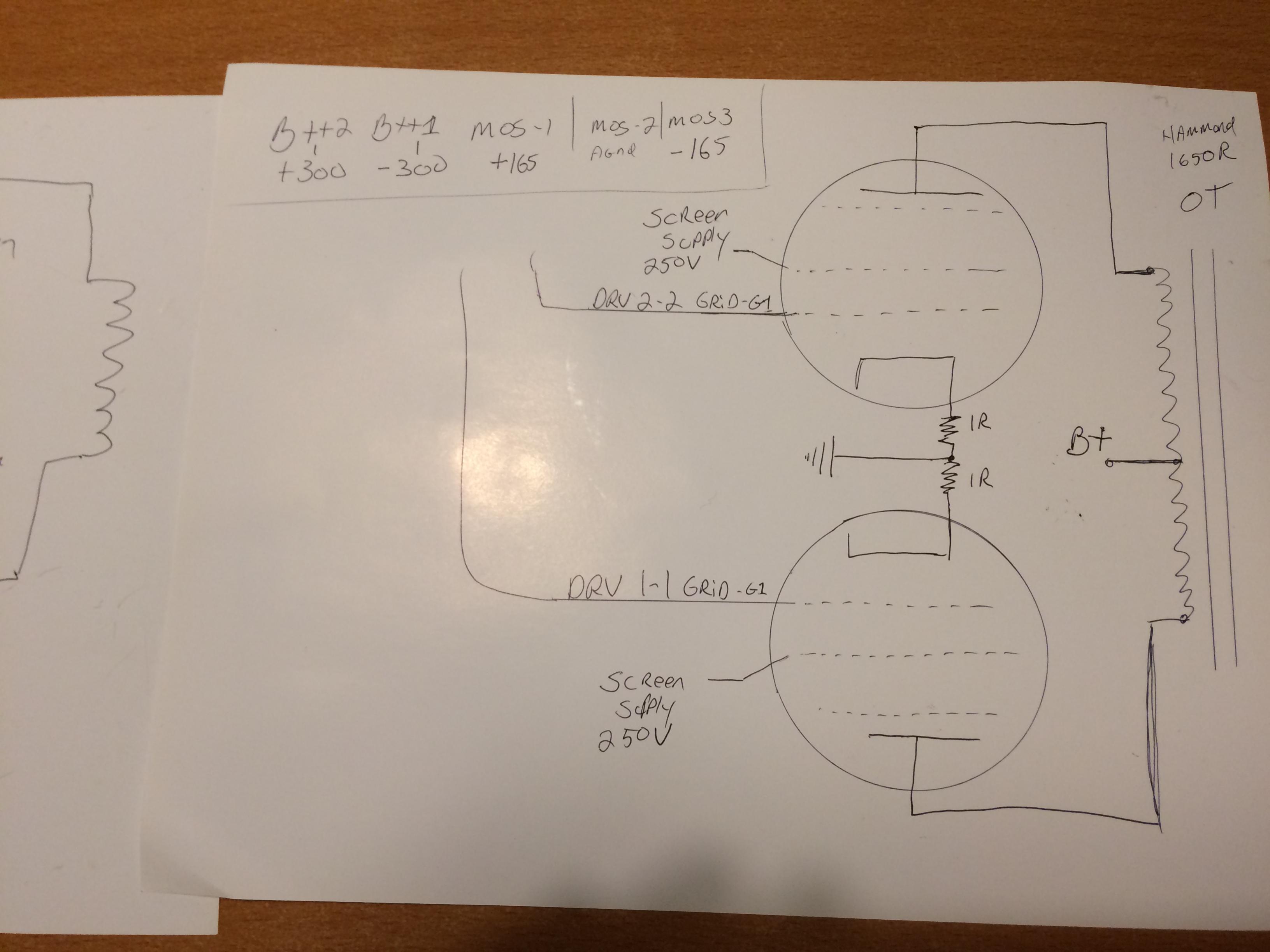

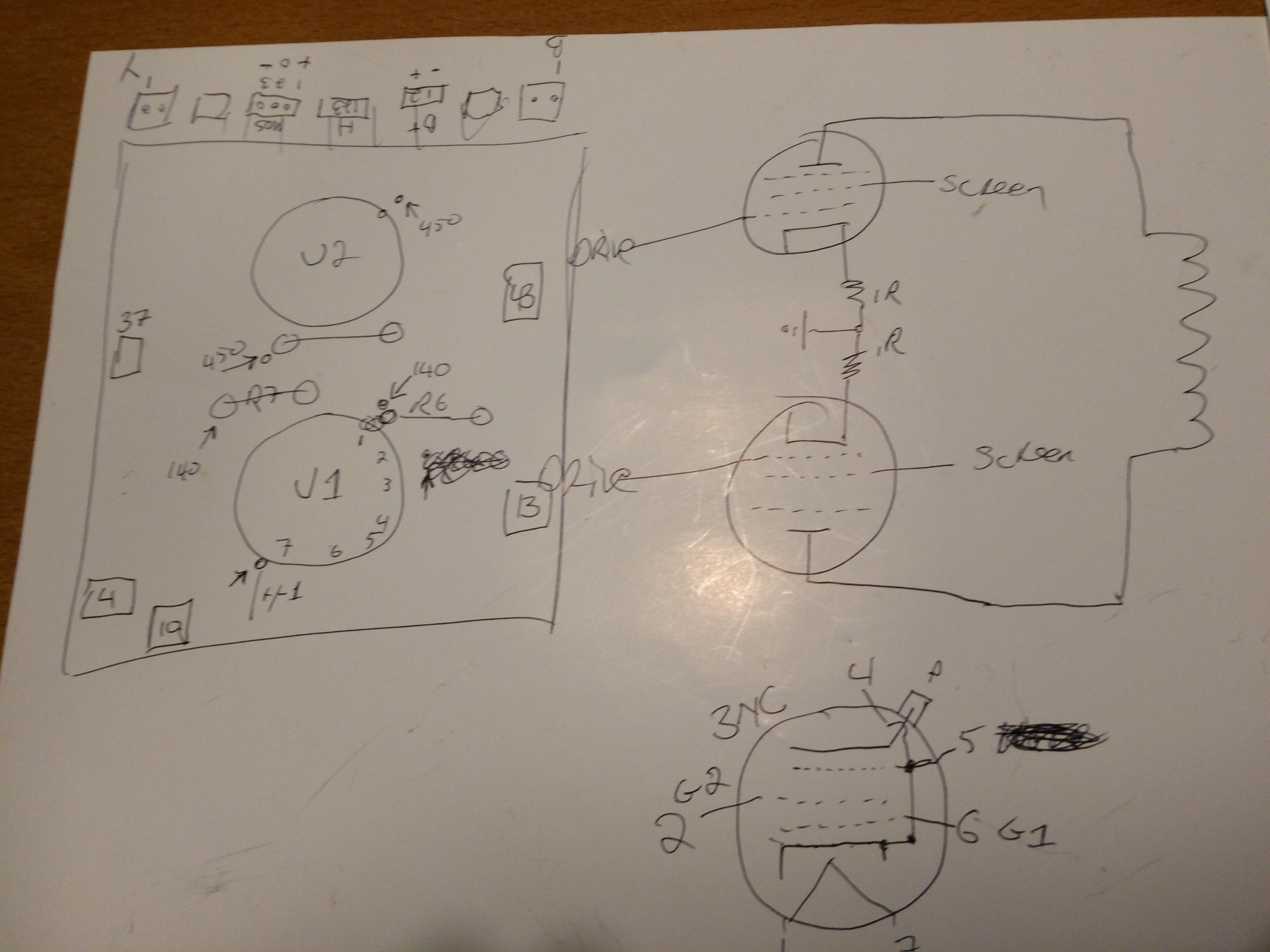

Jacques Here are a few drawings I made to help me at the workbench. The pinout of my tubes is different then yours. Also a photo of the UDB hooked up. The board is viewed from the bottom. Maybe they will be of help

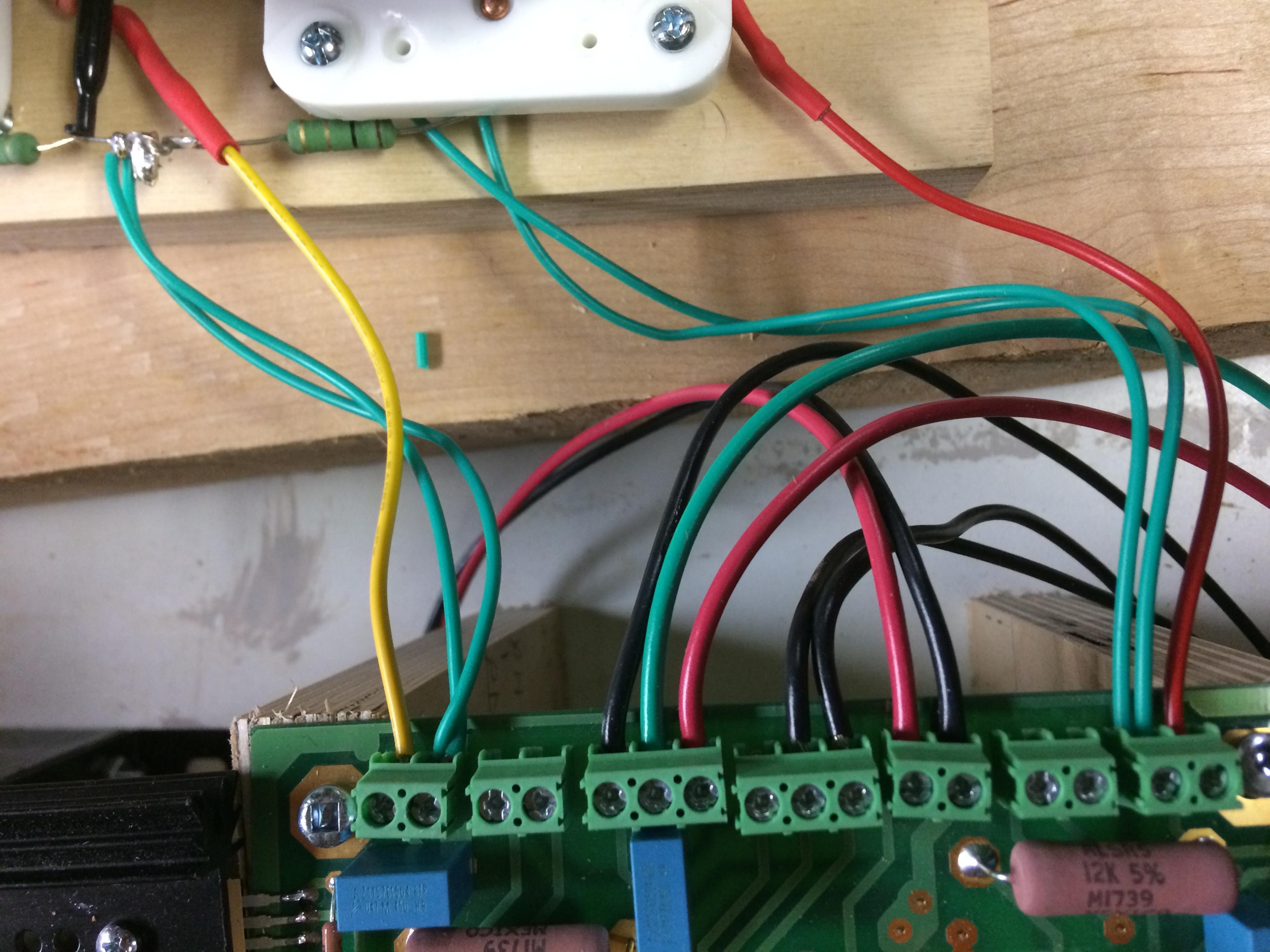

Do I need to hook anything up to H3 on the UDC board?
H3 is wired to pin 9 on the tubes. It is normally used when running 12 volt tubes like 12AX7's and 12AU7's from a 6.3 volt transformer. The data sheet shows pin 9 unused on a 6CG7 and connected to a shield that runs between the plates on a 6FQ7. I have however seen more violations of this convention that adherence, and plenty of tubes wearing both numbers, with or without the shield. I would say leave it disconnected unless there is hum or oscillation, then ground it. I leave it open and have never seen any issues, but it could create a feedback path if both tubes have shields (a silver piece of metal between the plates).
DRV2-2 and DRV1-1 will connect to pin 5 of the power tubes.
Yes.
DRV2-1 and DRV1-2 will connect to pins 8 and 1 of the power tubes.
You need a way to measure the current through each tube so that you can set the bias. I put a 1 ohm 2 watt resistor between the DRV2-1 and DRV1-2(ground) terminals on the board and pins 1 and 8. Connect a voltmeter set to the 200 mV scale across this resistor when adjusting the bias. With a 1 ohm resistor mV = mA, set it to about 40 mA for a starting point.
Pin 3 of the power tubes will connect to the output transformer.
Yes.
Pins 2 and 7 to the heater circuits.
Yes.
If I’m running in triode mode I don’t need to hook up the screen?
The screen (pin 4) must always be connected to something, or unpredictable results will happen (usually no power output and no tube current. As with the SSE, I connect the screen to the plate with a 100 ohm 2 watt resistor. One end of the resistor to pin 3, the other end to pin 4.
