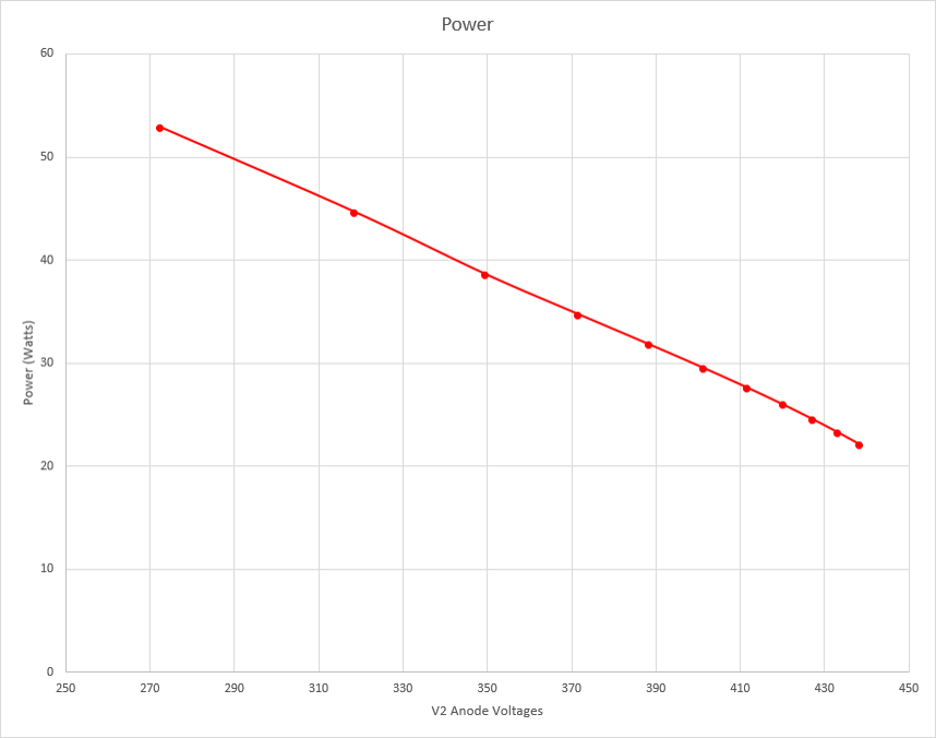

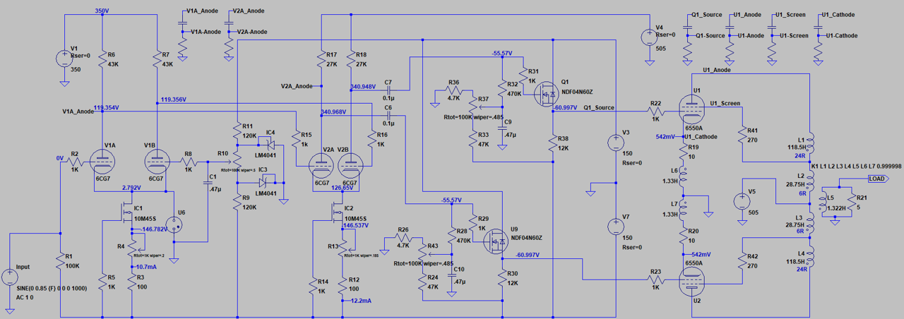

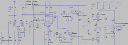

It turns out that I've been able to duplicate in my sim exactly what you measured and I'm not completely sure why.
My LTSpice schematic is shown below with my current preferred cathode feedback output stage.

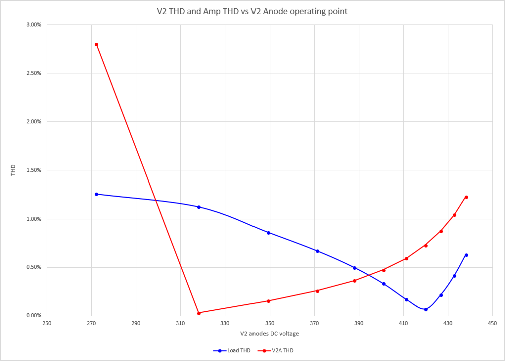

I set up the operating points for the LTPs by minimizing the THDs they generated on the assumption that the lower the THD arriving at the output stage the better.
I started wondering what would happen if I raised the operating point of the second LTP towards the voltage you'd recommended.
Sure enough, the THD from the second LTP was much higher (I put the 2 operating points on the 6CG7 plate curves and it's easy to see why). Gain was also reduced and again, easy to see why.
But what was really weird was that as the distortion produced by the second LTP increased, THD at the output decreased!!
Part of the reason has to be that the output stage cancels odd order harmonics but there has to be more to it.
I wondered if there was a sweet spot and plotted V2 Anode THD and Load THD vs V2 Anode Voltage (second screenshot for an input that gave me 40W out for a V2 Anode voltage of 342V).
Sure enough there was! At a V2 anode voltage of 420V.
As I said gain decreases as you increase the V2 Anode voltages and consequently the power out decreases. This is shown in the third image.

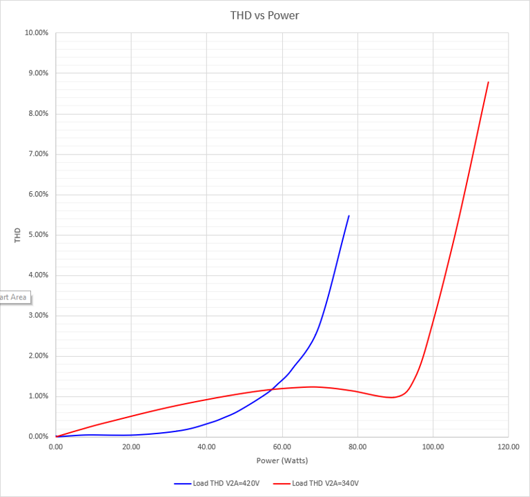

The final image shows the THD vs Power out for V2 Anode voltages of 340V and 420V. The 420V operating point provides a far lower THD up to 50W or so but is limited to 60W if you want < 1% THD. If you're prepared to put up with higher distortion there's good power out to 90W with the lower V2 Anode operating points.
Part of the reason lies in the fact that this is a class AB push pull amp. Each output tube contributes an equal share to the total output averaged over time, but not at the same time. The tube that is entering conduction begins to contribute some to the total output, as both tubes are conducting equally they contribute equally to the total output, and as that output tube reaches peak conduction it is contributing 100% of the output power because the other tube is cutoff.
Note that this is less true on a class A push pull amp since both output tubes are always conduction, but the share of total work is constantly changing.
The driver's contribution to total distortion is also not equally split between the two tubes. The tube that is driving a particular output tube into conduction contributes the most to the total amplifier power output and distortion at that moment.
As the driver's plates go lower in voltage the corresponding output tube is contributing less and less to the amps total power output and therefore distortion. I have seen drive signals with severe clipping on the bottom due to the mosfets hitting the negative rail but the amp's distortion doesn't change much.
I avoid clipped or severely distorted bottom halves due to limited negative rail voltage for another reason. The mosfets tend to emit a burst of high frequency energy when is goes into cutoff or comes out of cutoff, so I like to keep ample headroom across them. You can see this in a scope, hear it, and severe cases fry a tweeter with ultrasonic energy.
The THD of the driver stage can be higher than the amps total THD even without feedback. This baffled me for several years since I would always test and optimize the driver circuit before building the output stage, then wonder why the driver worked better with a different tune up once the output tubes were added. The top half of the driver's output is far more critical than the bottom half. This makes optimizing the driver board alone with distortion measurements rather pointless.
Thanks for the explanation. It certainly is counter-intuitive that increasing earlier stage THD should decrease output THD.
What you're saying is that the positive half of the waveform is amplified with less distortion than the negative half and as you raise the operating point of the second LTP the distortion introduced to the positive half reduces.
Pity about the associated loss of gain.
I'll play around with global negative feedback for the 341V and 420V 2nd LTP anode operating points.
As I said it confused me for a couple of years.
I was also quite baffled by the effects of feedback, especially feedback from the output tube plates to the driver or pre driver plates. You can connect distortion measurement equipment up to the driver board output and connect a second set of measurement equipment up to the speaker terminals. Then apply some sort of feedback to the amp that reduces it's total distortion. The distortion at the output of driver stage almost always increases.
I didn't understand this and spent considerable time trying to fix it until my day job of designing RF power amplifiers took me down a path called adaptive pre-distortion. Here we purposely add distortion to the baseband LTE signal in the DSP such that it "bends" the signal in a manner opposite to the "bending" occurring in the RF power amp.
I use the term "bending" to describe the nonlinear transfer function of a "linear" RF power amp. This distortion in an RF amp is not constant and varies with the power level, modulation, temperature, and load impedance. This bending occurs in both amplitude and phase.
We can guess, and apply some correction based on testing a bunch of power amps and gain some improvement, or we can build a closed loop Cartesian Feedback system and change the pre-distortion algorithm on the fly for considerably more improvement. Both techniques are currently used in cell phone and cell tower systems.

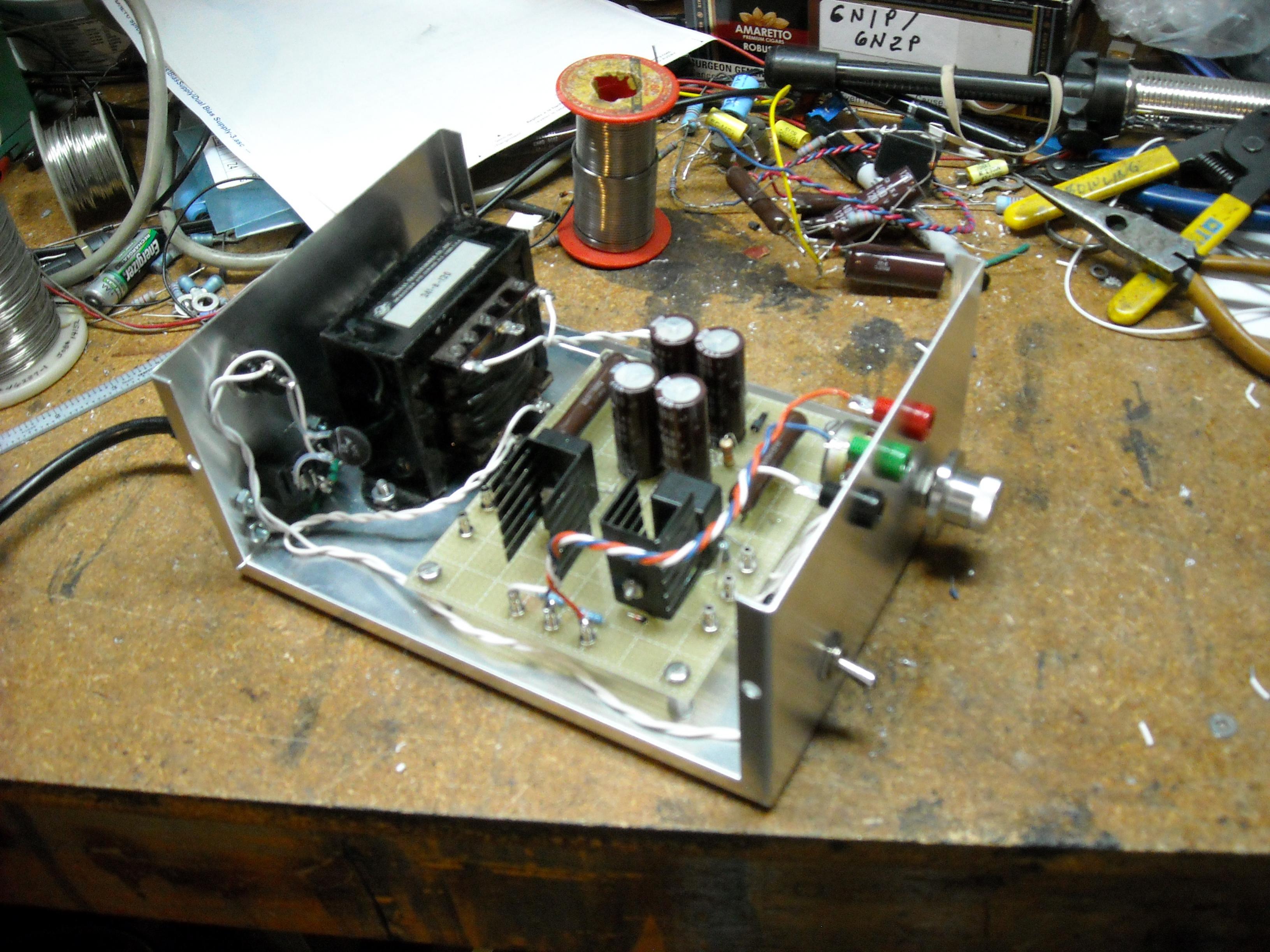

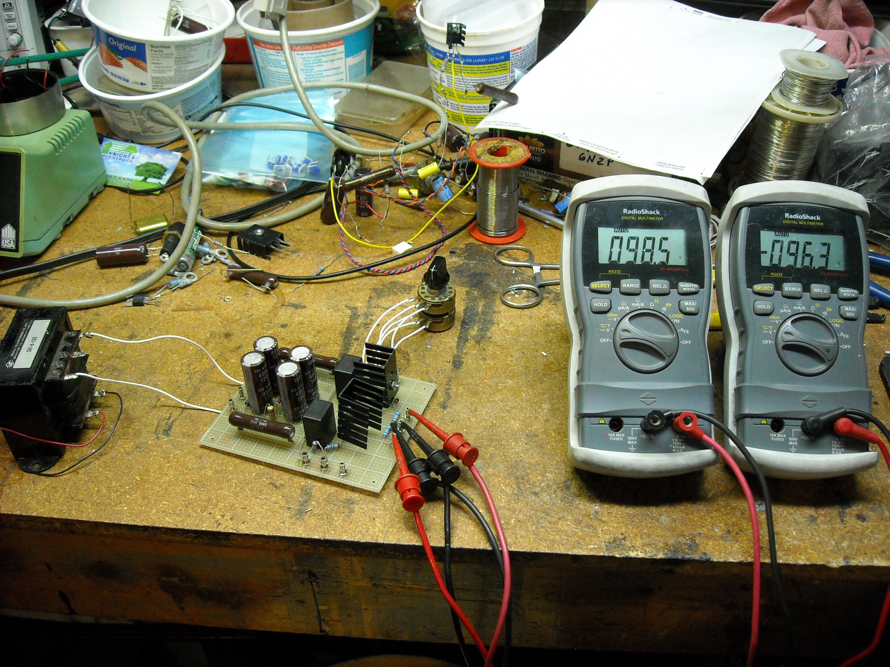

I finally got around to building the dual tracking power supply for biasing the source followers, so I should be able to get back to testing before too long.
It looks like it is good for 60mA and I can adjust the negetave supply down to about -95V. Tracking isn't great, but it shouldn't be critical since the actual bias adjustment is separate. Hopefully it will be good enough for the universal driver board. I can reduce the R in the CRC to increase the output under load, but would need to change the 100V reference Zeners to a greater value to get more compliance.
I still need to box it up.

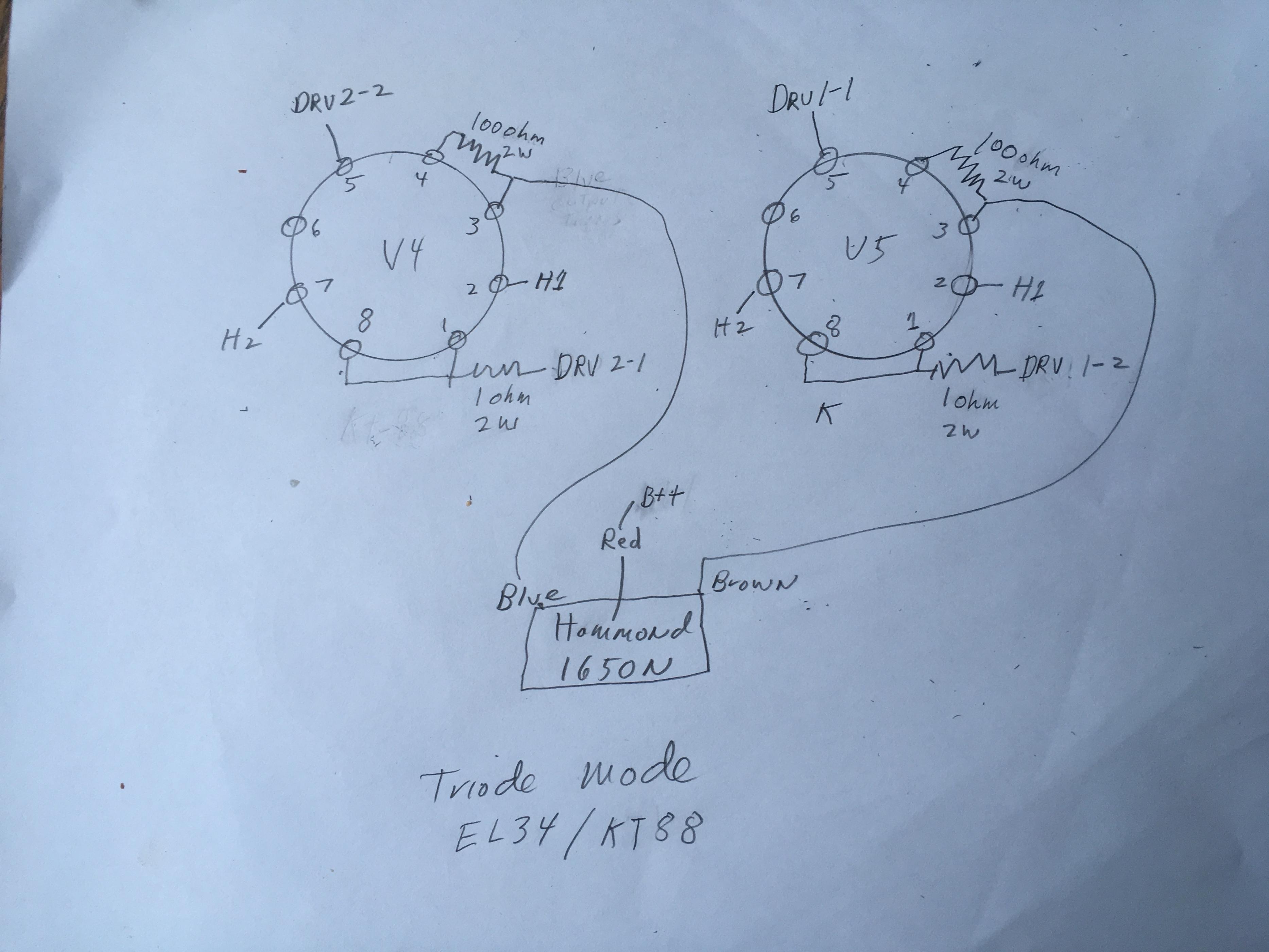

Jacques,
You should be able to get the amp working with cheap meters unless there is a problem. You say that "the sound cuts out if I raise the bias above 15 mA." Does this happen abruptly, and does the current change abruptly at this point? If so the amp may be oscillating, which may require a scope to find. Try cleaning up the wiring to see if the point at which this happens changes.
If the amp begins to distort and then cuts off as 15 mA is approached, then I would try turning the voltage dowwn via R13 to see if a happy point can be found. How much B+ do you have, and does it drop significantly as the bias is turned up?

George, if I want to run GNFB from the output of the OPT do I go to pin 7 of V1B and swap DRV2=2 and DRV 1-1 as necessary to get phasing correct?
Any recommended change to C1 if I do? Looks like it may affect LF response.

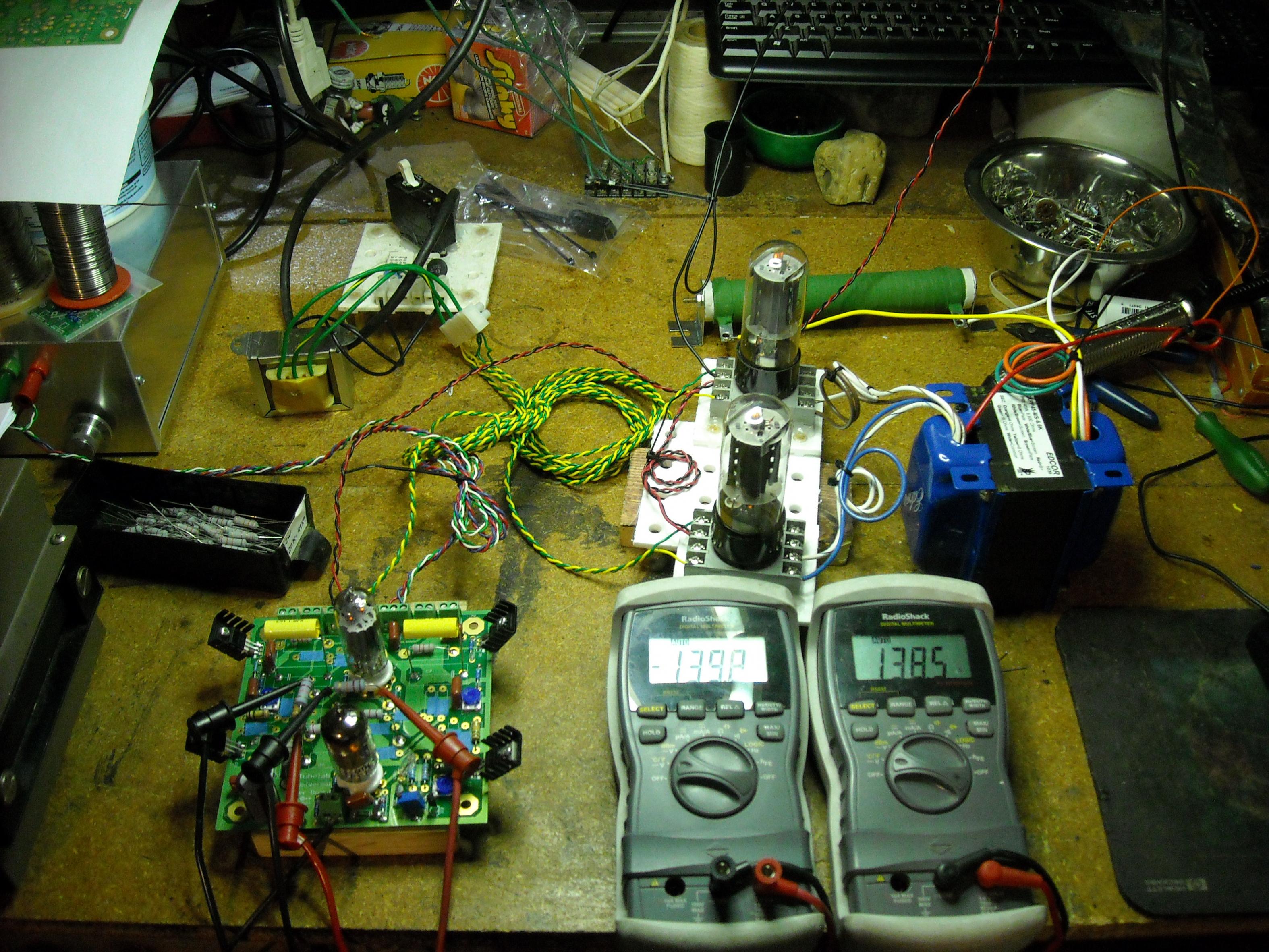

Initial setup has been going well. Although somehow I smoked the 10K resistor at R23. Voltage drop is 110V for a power dissipation of 1.3W in a 2W resistor, so I'm befuddled.
Plate of the input 6N1P-EV came in around 110V, where I want them.
6CG7 plates are around 210V at 11.7mA, cathodes are at 101V for a Vak of 109V.
