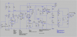

Simulation of Feedback options
I’ve been simulating various feedback options for the UDB with 6550 outputs.
The open loop schematic is shown below.

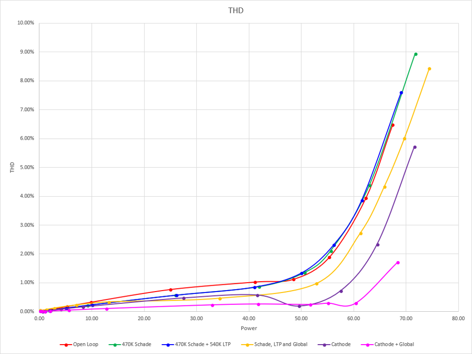

I’ve run simulations of the following feedback options:
· 470K output anode to driver anode (1dB),
· output anode to driver anode plus second LTP anode to first LTP anode 540K (lowest recommended), additional 1.5dB,
· output anode to driver anode plus second LTP anode to first LTP anode plus global (100R/2K7, additional 9.3dB)
· cathode ( 0.5H, 4dB) and
· cathode plus global (100R/2K7, additional 10dB).
The Universal Driver Board is easily capable of swinging the voltage required for cathode feedback.
Output power for these options into 8Ω is shown below:
and for less than 10W
Observations:
The lowest recommended resistor (470K) from the output anode to driver anode only provides 1dB of feedback. This provides some improvement in THD up to about 45W but provides no improvement over open loop above that.
540K between the LTP anodes only adds a further 1.5dB but no improvement in THD.
The addition of 9dB global negative feedback is worse than open loop below 6W but provides significant improvement above that.
Just adding 4dB of cathode feedback provides comparable performance to the output anode to driver anode plus LTP anode and global feedback below 40W and significantly better performance above that.
Adding 10dB of global feedback to the cathode feedback reduces THD to less than 0.1% below 10W and below 0.3% all the way to 60W.
Conclusion:
I'll try, measure and listen to all the options, but cathode feedback looks to be the way to go.

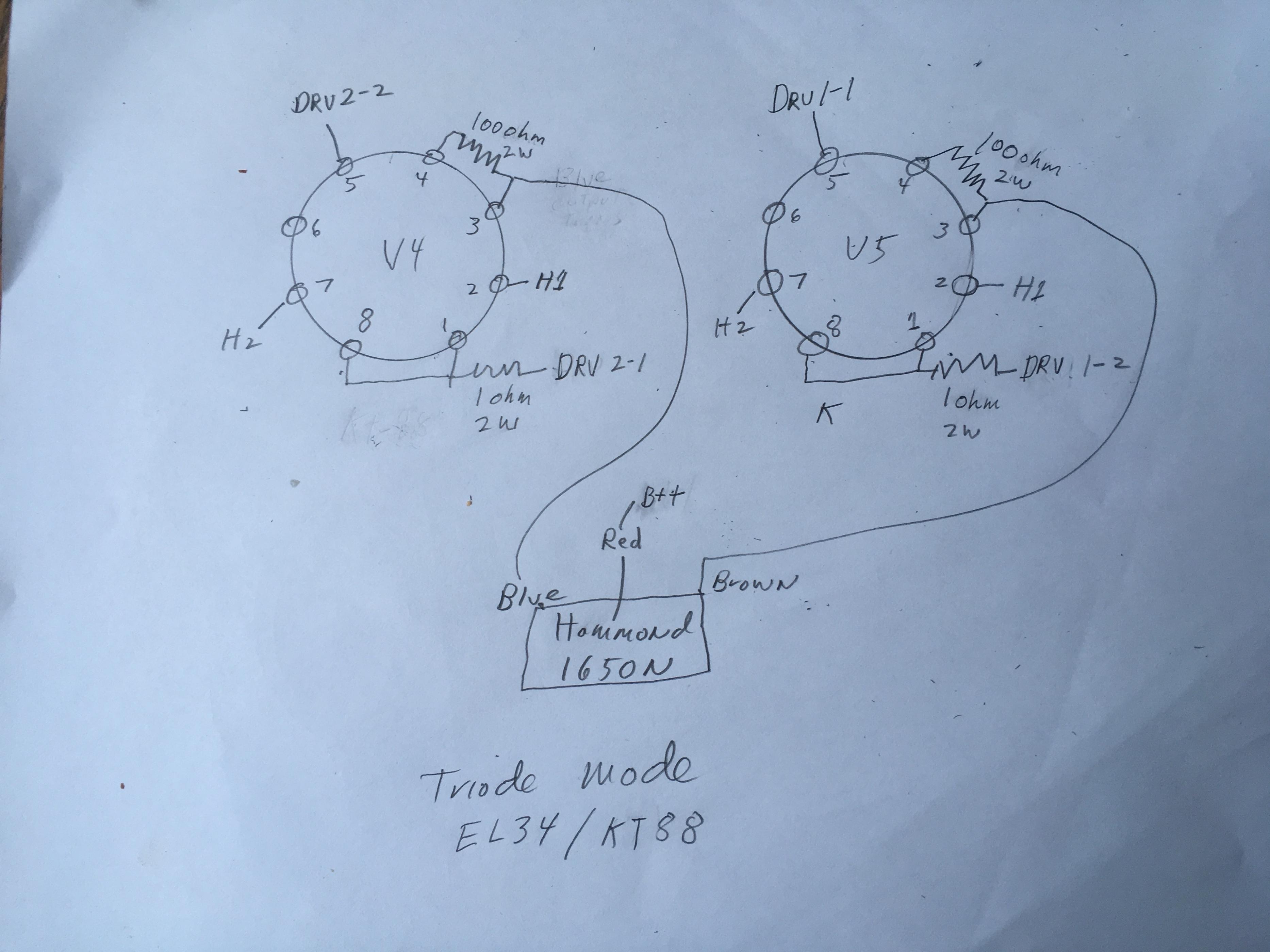

I finished two KT-88/Hammond 1650-RA mono-blocks. They’ve been up and running, generally without incident, for several weeks. However, I did lose one 5AR4 and had a close call with a second. In reading about possible causes for rectifier tube failure, it was mentioned that too much high voltage filter capacitance could be a cause.

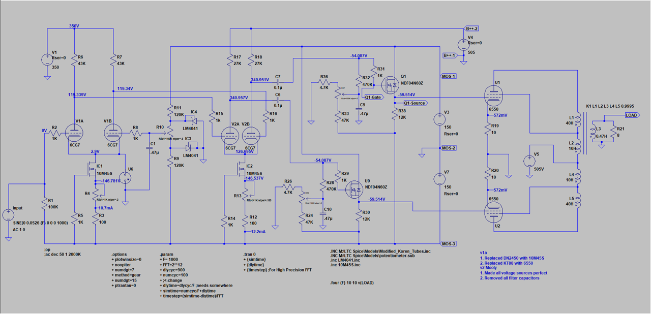

V2 setup and PP signal swing
I'm puzzled by the 450V recommendation for the plates of V2. Even assuming a 500V supply this leaves very little room for signal swing.
Worst case you'd want the MOSFET sources to swing 150Vpp. This would mean the same for the V2 anodes.
It seems to me that 350V on the V2 anodes would be more appropriate.
Am I missing something here?
