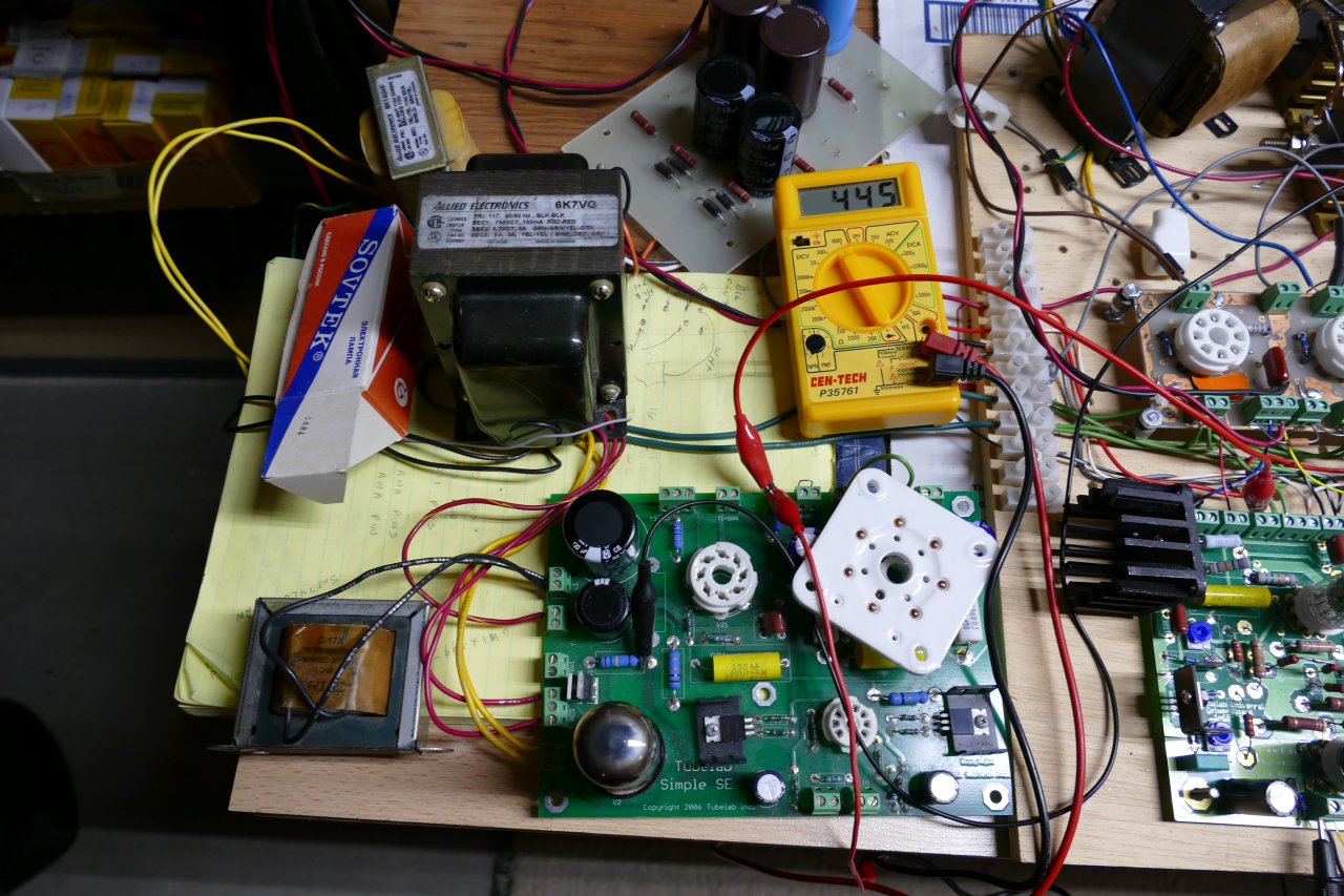

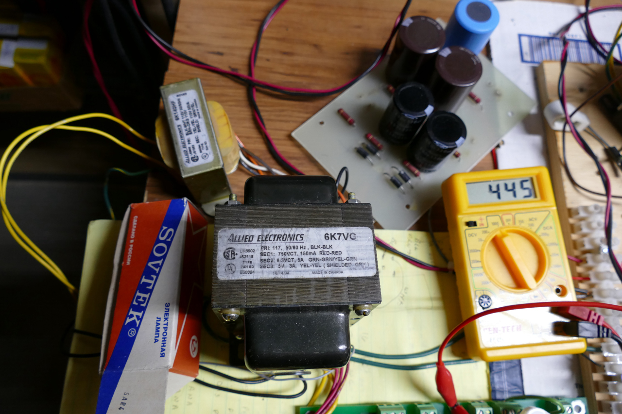

OK, I'm a bit behind on this so I grabbed a hacked up SSE board and wired it's power supply section to the test amp breadboard. I used the same mos power supply that I have been using. I measured +142 volts and - 141 volts on the mos supply, 502 volts at idle on the main B+ and 445 while putting out 65 watts. The tubes in the amp are older Chinese KT88's and the SSE has a Sovtek 5AR4. My line voltage is usually in the 122 to 127 volt range but I didn't measure it today.
The Allied 6K140HF is Hammond's version of the Triad N-68X, either will work fine. I couldn't find a Triad.
I drew a schematic of what I have here, took a picture of it, and scanned it to PDF.
Note, I really did stick a 4D32 into an SSE......it didn't work well enough to add the second one. I keep this old board around for experiments that might end badly. It has been blown up and rebuilt more times than I can remember.

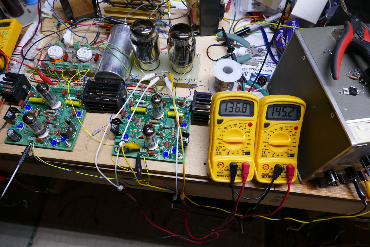

I'm moving ahead with the build. Finished the driver board; working on the power supply. I built the MOSFET p/s first - using the Tirad N-68X in place of the 6K140HF. Except for the color of the wires, they appear identical.
The p/s works, but I hit a snag. Line voltage = 115 vac; into trans = 115 vac; output from trans = 105 vac; output from p/s = 145vdc. When started up, it is very slow to achieve full power. What do do you think?

output from trans = 105 vac; output from p/s = 145vdc. What do do you think?
Does this happen when there is no load on the power supply? If so make sure that all the electrolytics are wired correctly. A backwards cap can cause this, and vent or explode with no notice. Remember tha positive end goes to ground on the negative supply.

Thanks for getting back. The readings were with no load and the caps are oriented properly. I’ll go through and check the wiring again - possibly something wrong there. I took the trans-out readings - 105 vac - at the input terminal block, but I’ll pull those wires out and check the trans output directly. Think that should be 115 vac. Be a couple of days before I get to that. (Mother’s Day, et al.)Thanks again.

We are intentionally using the transformer backwards in this application. These transformers were designed to make an isolated 120 volt line from a 120 or 240 volt input. We are using it backwards to make 240 volts center tapped for our application. As explained, the transformer will incur higher losses this way, but it is far larger than the application requires, and will work just fine.
This statement is the one that initially got my attention. With no load this supply should INSTANTLY jump to full voltage output upon power up. If it does not do this there could be a backwards part, cap or diode that will cause problems, which is why I asked that they be checked. It is however normal for a power supply with no load or bleeder resistors to jump to full output, then slowly creep upward from there, as the noise and spikes on the power line slowly charges the caps that have no way to drain.
unless n-68x is different than 6k140.
An isolation transformer is not 1:1, it has some step up ratio such that it will deliver 120 volts when fed by 120 volts after the usual transformer losses. This small step up ratio becomes a step down when the transformer is reversed. It is normal for a transformer that is used in reverse to have less than 120 volts output when fed with 120 volts. The N68-X appears to have higher losses that the Allied / Hammond 6K140. I get 150 volts with my Allied on a 125 volt line, but 144 volts with a N68-X in an old guitar amp I built several years ago on the same line voltage.
Your 145 volt output is fine, anything over 120 volts will work in this amp. Just make sure that you have a positive 145 volt supply, and a negative 145 volt supply measured with the black meter lead on the ground terminal. You should get about 290 volts measuring from the -145 source to the +145 volt source.
I'm a little behind in my build, but the discussion prompted me to build and test my Mos supply. I am using a Triad N68-X as well. My negative and positive supplies come up right away and are steady at -143 and + 143. I am using the red wires as my primaries and have tied the yellow/black and red/black together to ground. That leaves the black and green/black for the other connections.
This was without any load.
