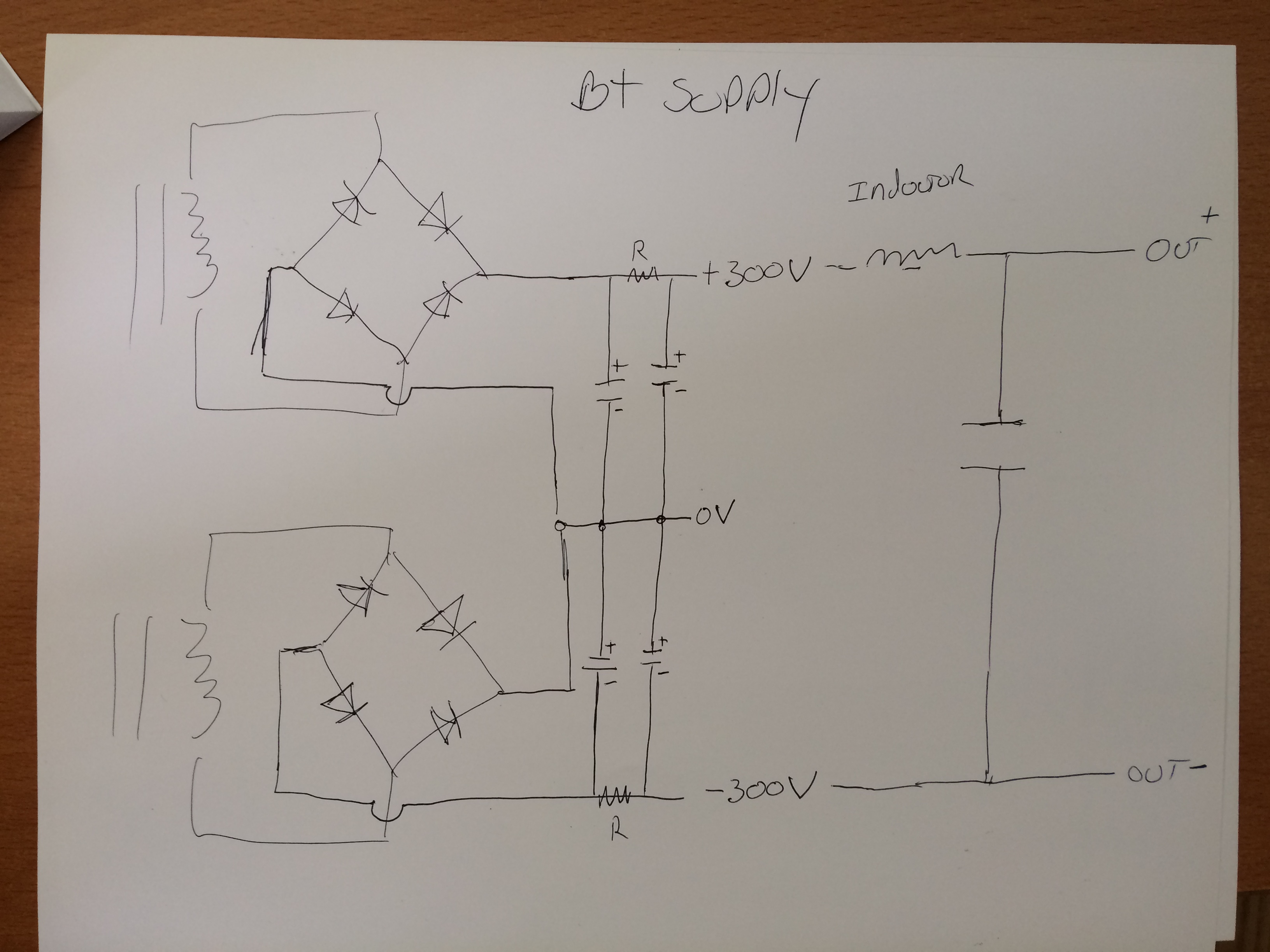

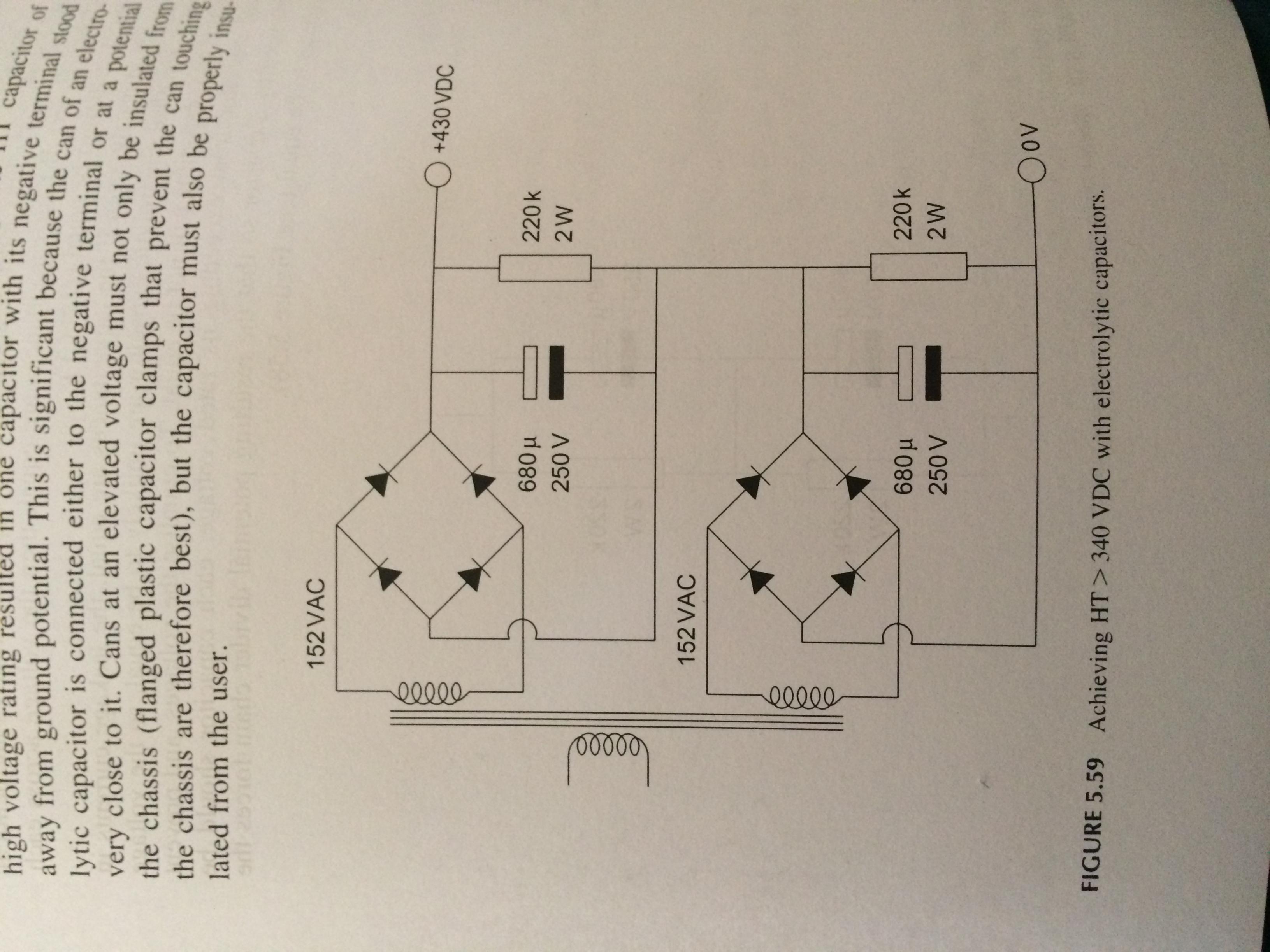

I've settled on the mono blocks with tube rectification. Would I be correct in assuming that the power supply designed for the SSE could work or are the requirements completely different?

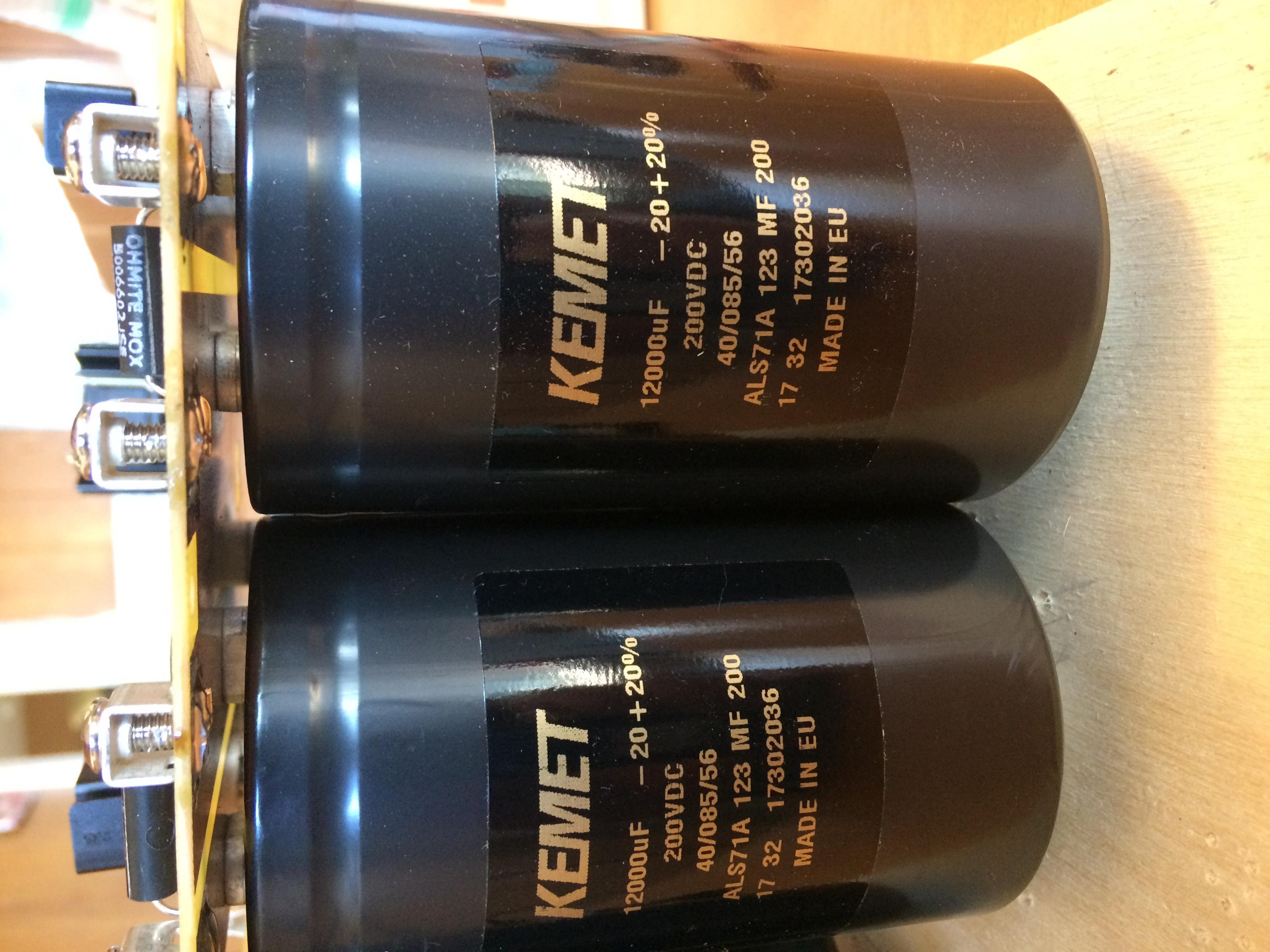

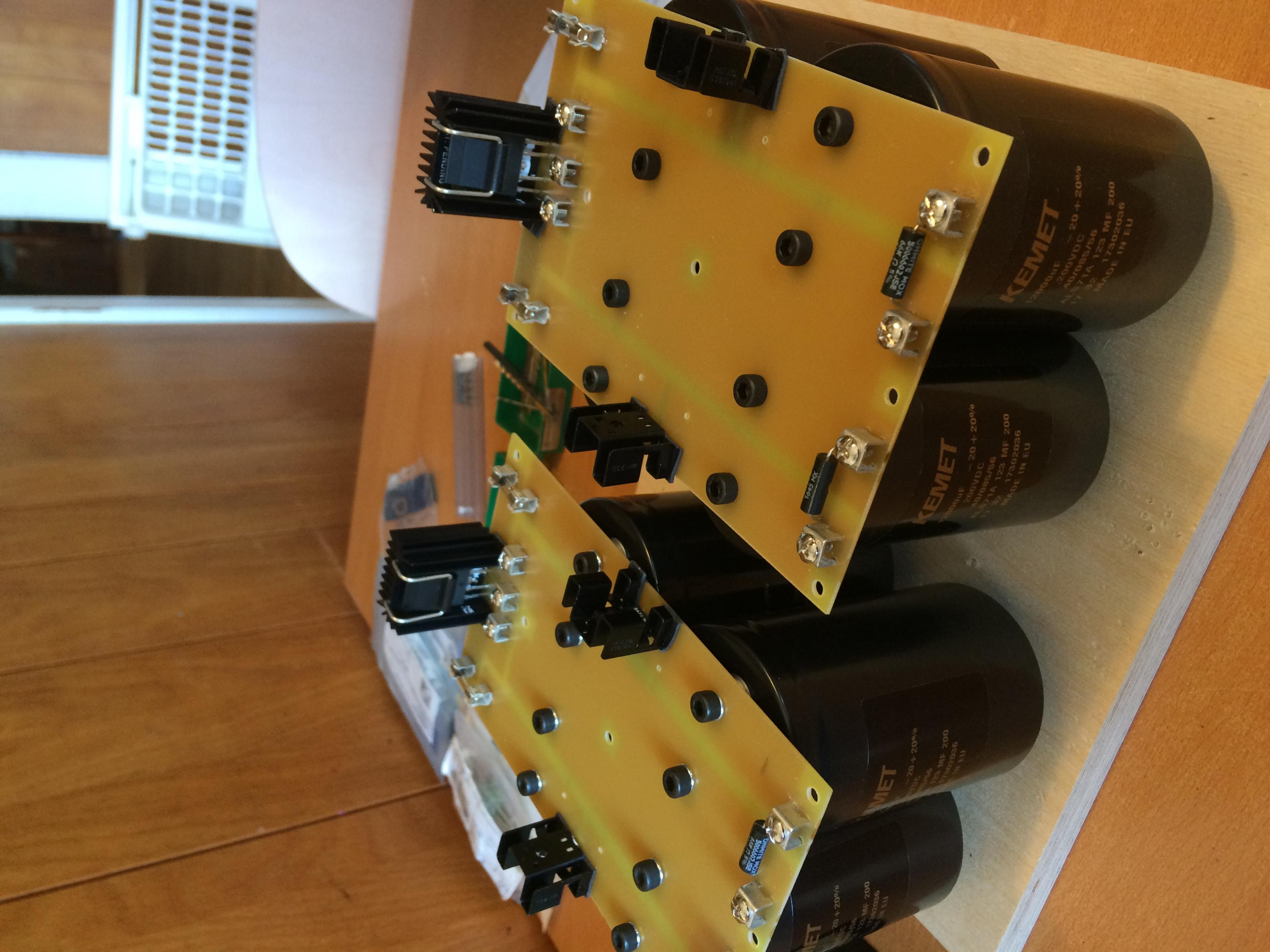

I had some time. Pictured are +/-150 volt supplies for Mosfets. I’m Getting closer. I have 600vdc for the output tube B+. Regulated screen supply. +/-150vdc for the mosfets. I can take the B+ for the driver board from either half the output B+ or maybe better rail to rail of the mosfet supply. I hope to be able to try out a complete bread board amp soon

The power supply from the SSE should run the driver board and a pair of output tubes up to about 50 watts. You will still need the bipolar mosfet supply.
The driver board needs about 400 volts or more to drive big tubes to fill power. It will eat 600 volts but I haven't tried much more.

I hope everyone had a nice holiday weekend. Mostly I spent time with family but I did take a few hours for myself.
I tested all the power supplies into loads that should be close to the actual draw. Yes there was smoke from the load resistors.
B+ holds at 600VDC this is using two antek 2t230 transformers in parallel.
For the mosfet supply I get 330volts rail to rail.
I tried my screen regulators and no problem regulating the 330 VDC mosfet supply.

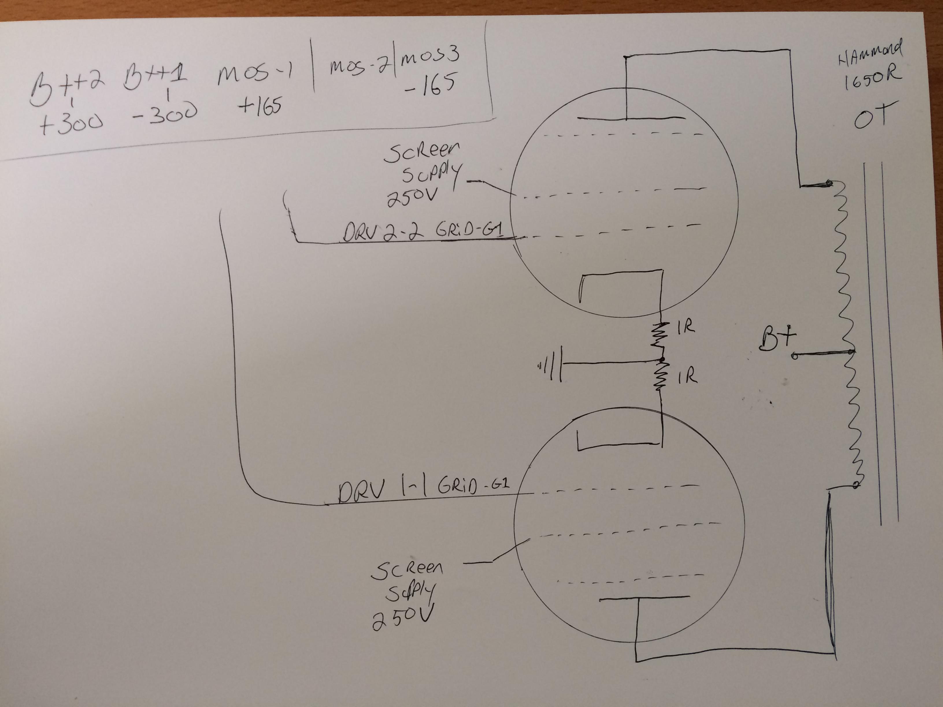

Happy Friday. I hope everyone had a good week. I am getting one channel wired and would feel much better if I could get confirmation that I have things hooked up correctly. Plus I have a couple questions.
First, and this is a broad one, I’m not sure about the adjustments on the driver board.... I assume r4 and 13 adjust current in first and second tubes. R37 and 43 adjust output bias. No guess for r10
This one may be simple but is a bit confusing to me. Since my B+ is really a +/- supply do I call the -300vdc “ground” or are the 0 volt of the B+ and the mosfet supplies ground? My concern is where to reference the cathodes of the output tubes.

At this stage of the game ALL questions are valid and will be used when it's time to write the final assembly instructions for the board. Chances are foe every question, there is someone else out there with exactly the same thoughts. Since I have been tinkering with this design for 10 years, I probably figured some of this out years ago and don't even think about it any more.
It makes no difference what you call something as long as it's wired up right. For the sake of everybody, we will adopt the same convention used by most every tube amp design on the planet.
Note that the solid state world usually calls the connection between the two supplies ZERO, and the extremes PLUS something, and MINUS something. They have P type silicon, and N type silicon, so this makes sense. We only have N type tubes, so we use only positive voltages except for the bias supply. This would make the most negative of your stacked supplies 0 VOLTS and also called GROUND, the center connection +300 VOLTS, and the top of the stack +600 volts. The cathodes of the output tubes would be connected to the 0 VOLT terminal, the screen grid regulator could be fed by the +300 VOLT supply, and the OPT CT is wired to the +600 VOLT terminal. This way all voltage readings would be referenced to GROUND. The input to the screen regulator would be at +300 volts, with 250 volts on its output, and the plates would be at 600 volts.
The mosfets are silicon life forms, and we follow the solid state convention with them. The center of the stacked mosfet supplies is connected to ground, the same ground called zero volts in the main B+ supply. The bottom of the stack will be called -165 VOLTS and will be connected to MOS 3. MOS 2 is the GROUND which is the center of the stacked supply. MOS 1 is +165 VOLTS and is connected to the top of the stacked mosfet supply.
I start with a board containing no tubes, but wired up, no output tubes in place either. Power everything up and check that you have your screen voltage at the output tube sockets. Measure the voltage at each output tube grid and turn R37 and R43 to verify the the voltage can be adjusted over a range of negative voltages with the most negative voltage being enough to cut off your chosen output tube.
Pot R10 is an offset adjustment. it compensates for imbalance between the sections in the tubes. Probe pin 7 of the empty V1 socket. R10 should cause pin 7 to swing from about 1 volt negative to 1 volt positive depending on your meter's internal resistance. The exact voltage is not important as long as it swings on either side of zero. Set it somewhere close to zero volts.
R4 and R13 do adjust the current through the tubes, however it's easiest to set them by adjusting for plate voltage.
Power down, install V1 only, then power back up. Allow for some warm up time and probe the plate voltages. These are easiest to probe on the right hand ends (viewed from the top with silkscreen writing correctly oriented) of R6 and R7. I set these with R4 for about 100 - 110 volts with a 450 volt supply, around 120 volts for 500 volts, so I'm guessing you are looking at 140 to 140 volts. Readjust R10 so that both voltages are equal.
Power down, install V2, power up, wait for warm up, then adjust R13 for about 450 volts on the plates of V2. (ends of coupling caps closest to V2). Readjust R10 for equal voltages on V2's plates.
Install the output tubes, set the bias by measuring the voltage across the 1 ohm cathode resistors.
This should get you operational. These pots can be tweaked for minimum distortion if measurement equipment is available. All adjustments interact somewhat, and the distortion should be optimized at where your average listening level is, not max power since you rarely hit max power. I aim for about 5 watts with 87 dB speakers.
