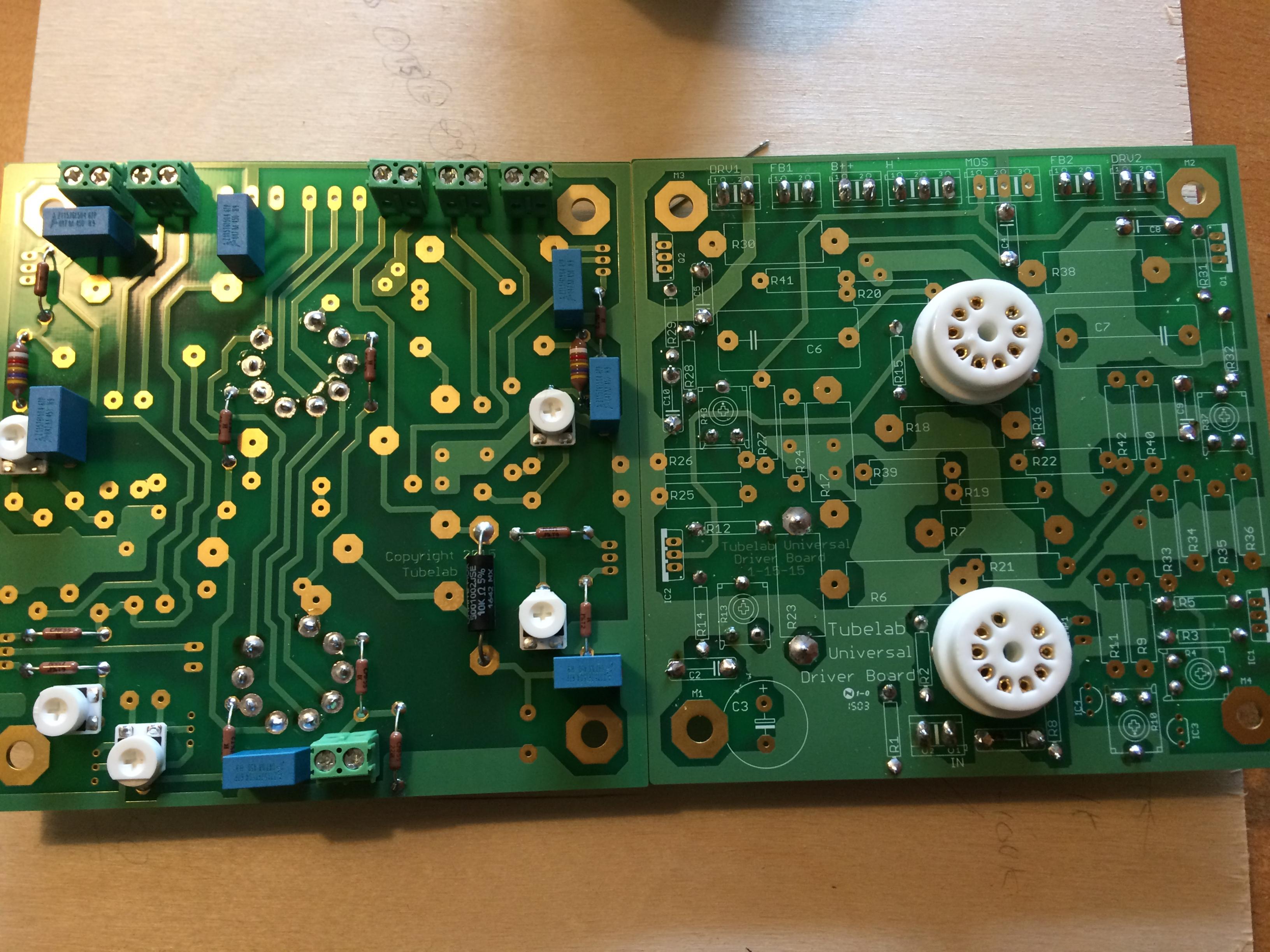

I made some progress collecting parts and soldering on the driver boards. I am thinking about the resistors that are optional based on voltage/tube choice. It looks like I’ll be feeding the Mosfets +\- 150Vdc and the B+ to the driver board will be around 300volts. Any advice would be great. I don’t mind testing measuring and changing resistors but I don’t want to unsolder more parts then necessary

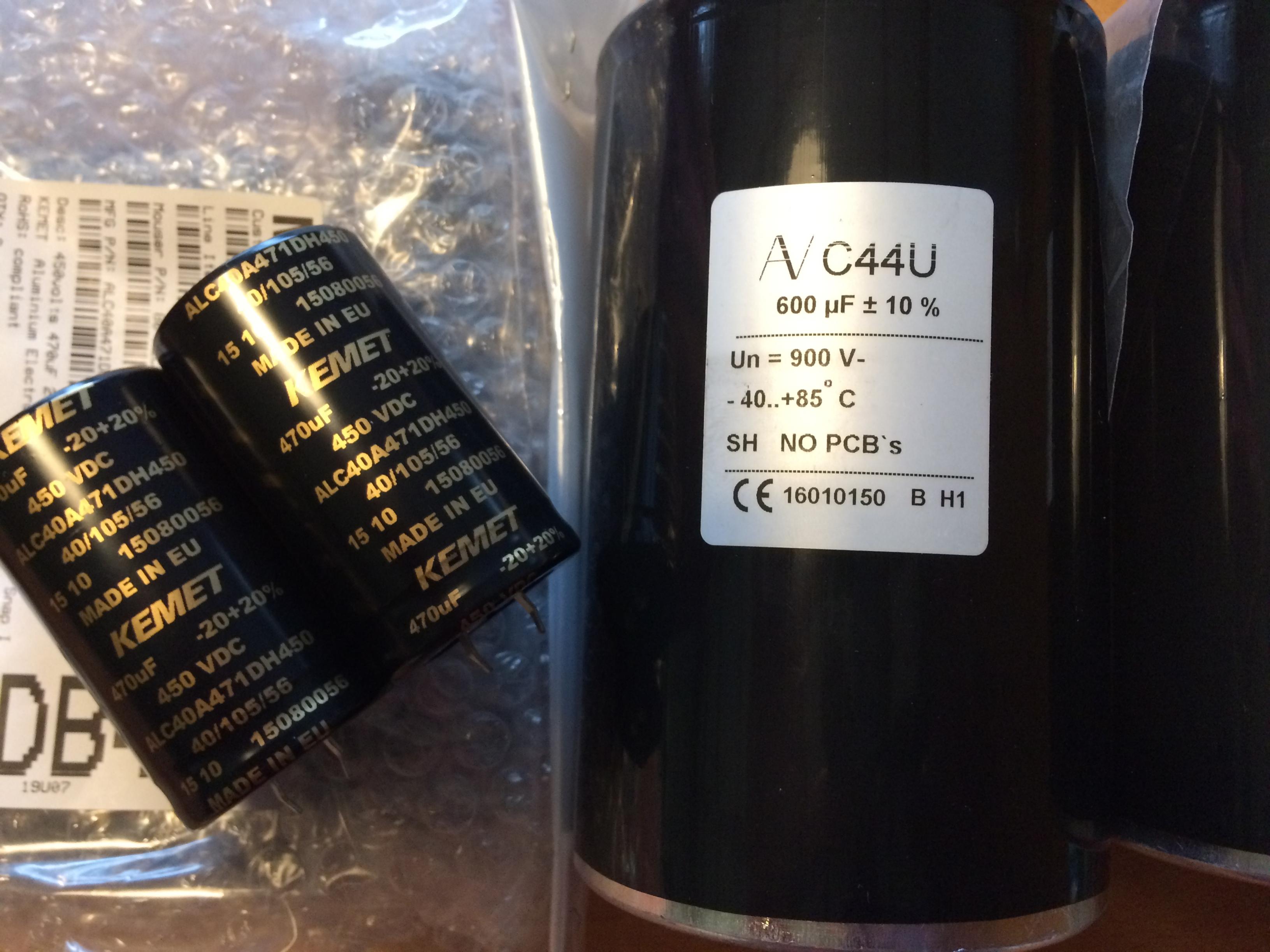

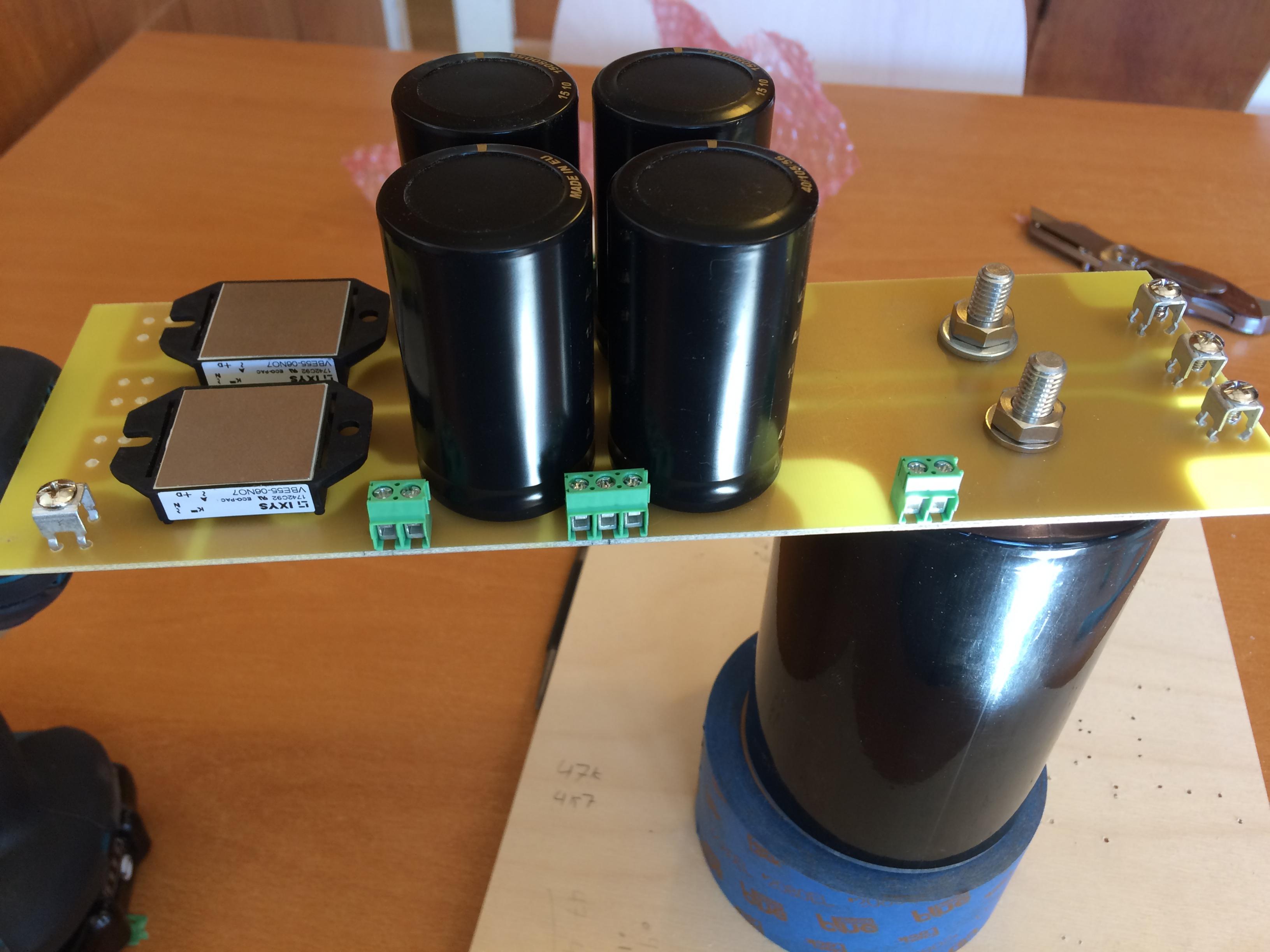

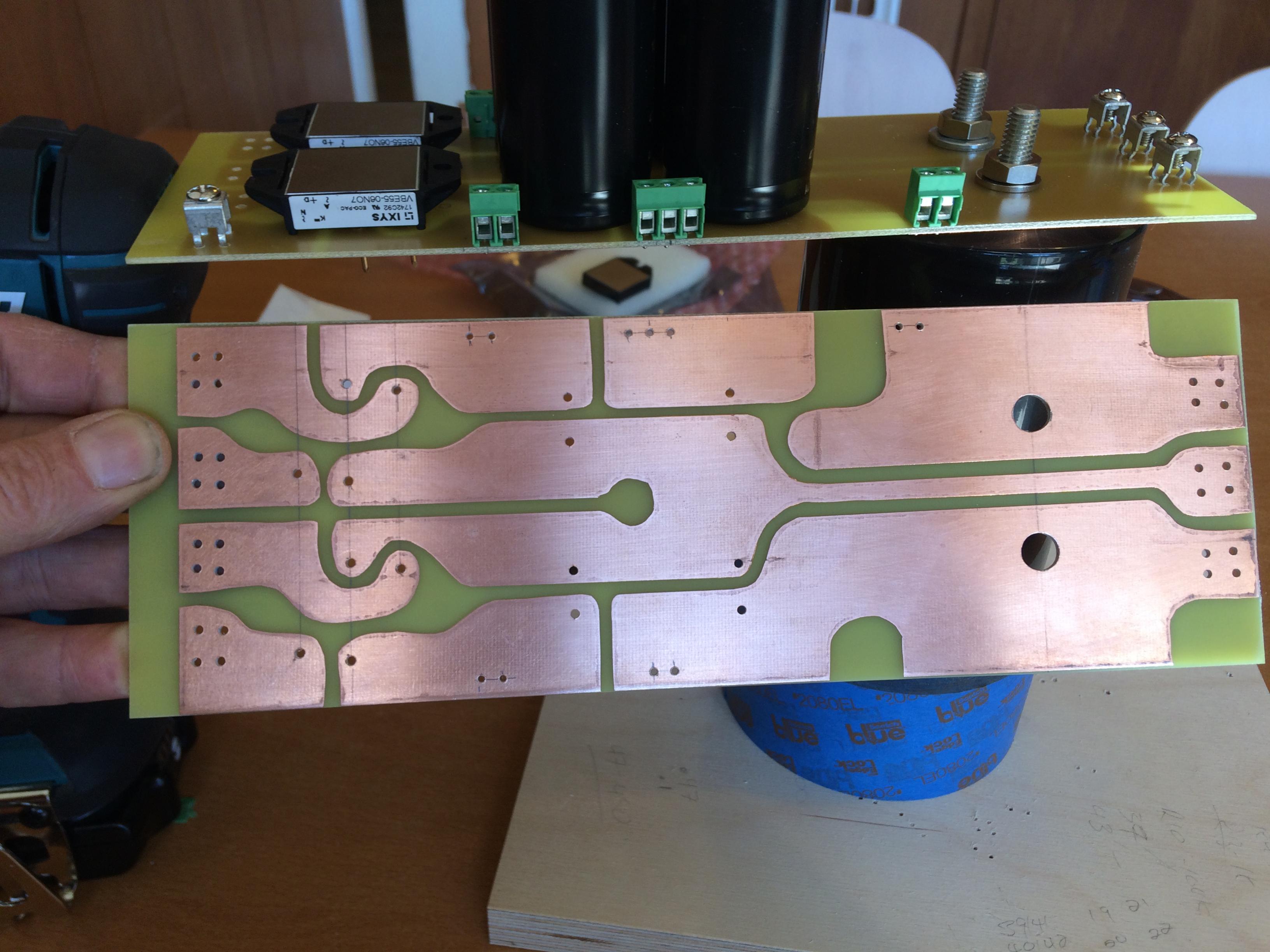

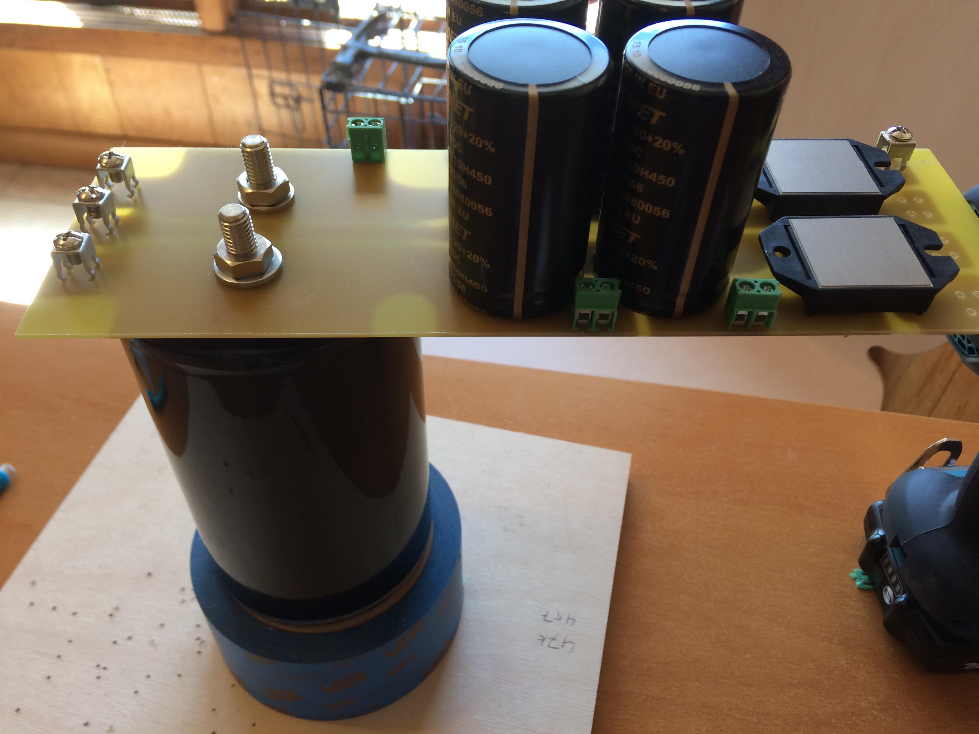

Got a bit of work done on a power supply board. CRCLC. I will feed it with two 230 volt transformers. I plan to have the large capacitor stick through the top with the rest of the components inside the chassis.
I am wondering hom much heatsink the ss rectifier bridges will need.
B+ should be around 600vdc. I’m using terminal blocks for the resistors in the crc filter so I can fine tune the voltage once the circuit is running.
My thinking is that by using a supply that produces +\- 300vdc I can get 600 volts for b+ as well as 300 volts for the screen supply. I’m still not sure about how to manipulate the screen voltage. Simple resistor to drop voltage or a full blown regulator.
