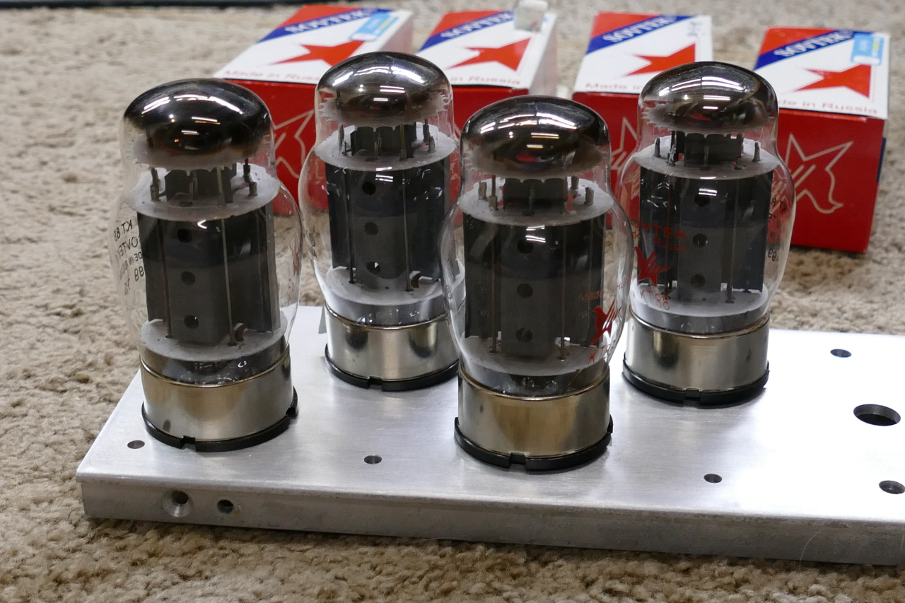

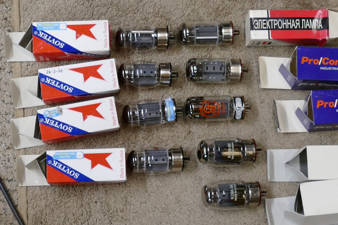

I did some more digging through my tube collection and found two more boxes of "audio tubes." One box contained mostly every sort of 6L6 variant imaginable, even some cute blue ones called "blues tubes." I wonder what would happen if you fed them country music?
The other box? A matched quad of Sovtek KT88's, a pair of Chinese KT88's, matched quad of Valve Art EL34's, and several singles of different kinds of KT88's and 6550's.
With this many tubes, and almost unanimous requests for a KT88 amp, I guess that's what I will make. The TV tube amp is now on the back burner, slightly over cooked. OK, the fat tubes are almost touching, but I have several that have been on a diet, and enough spares to replace a set or two if they don't outlive me. I can always roast some 6L6 types in it if I get bored.

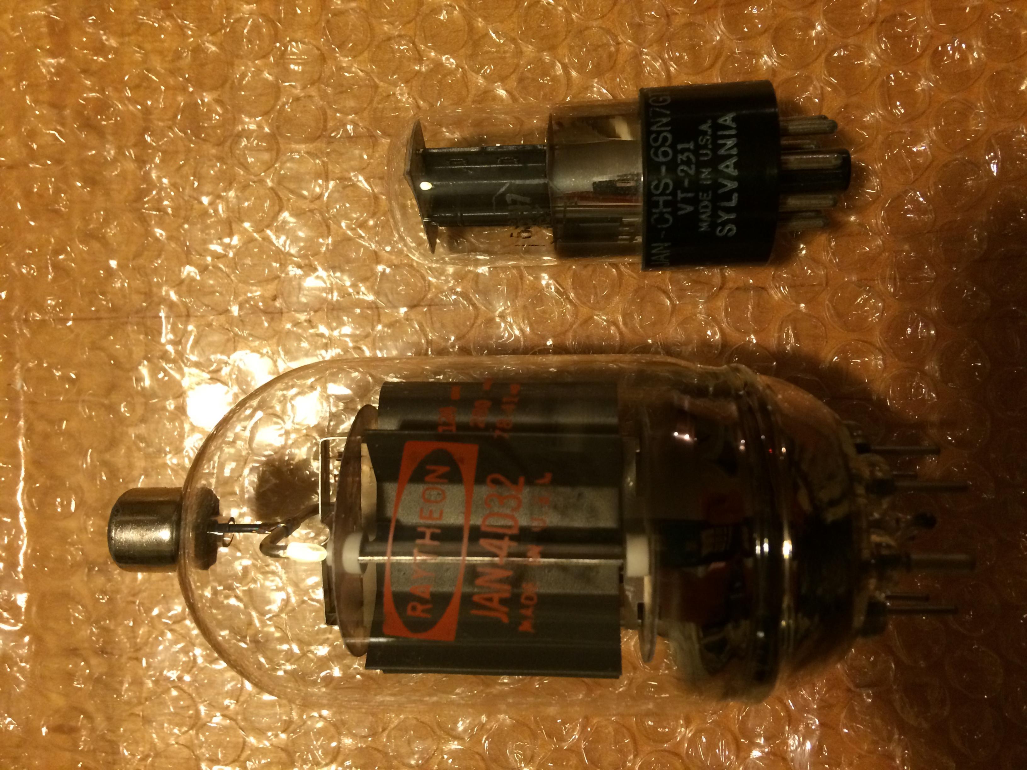

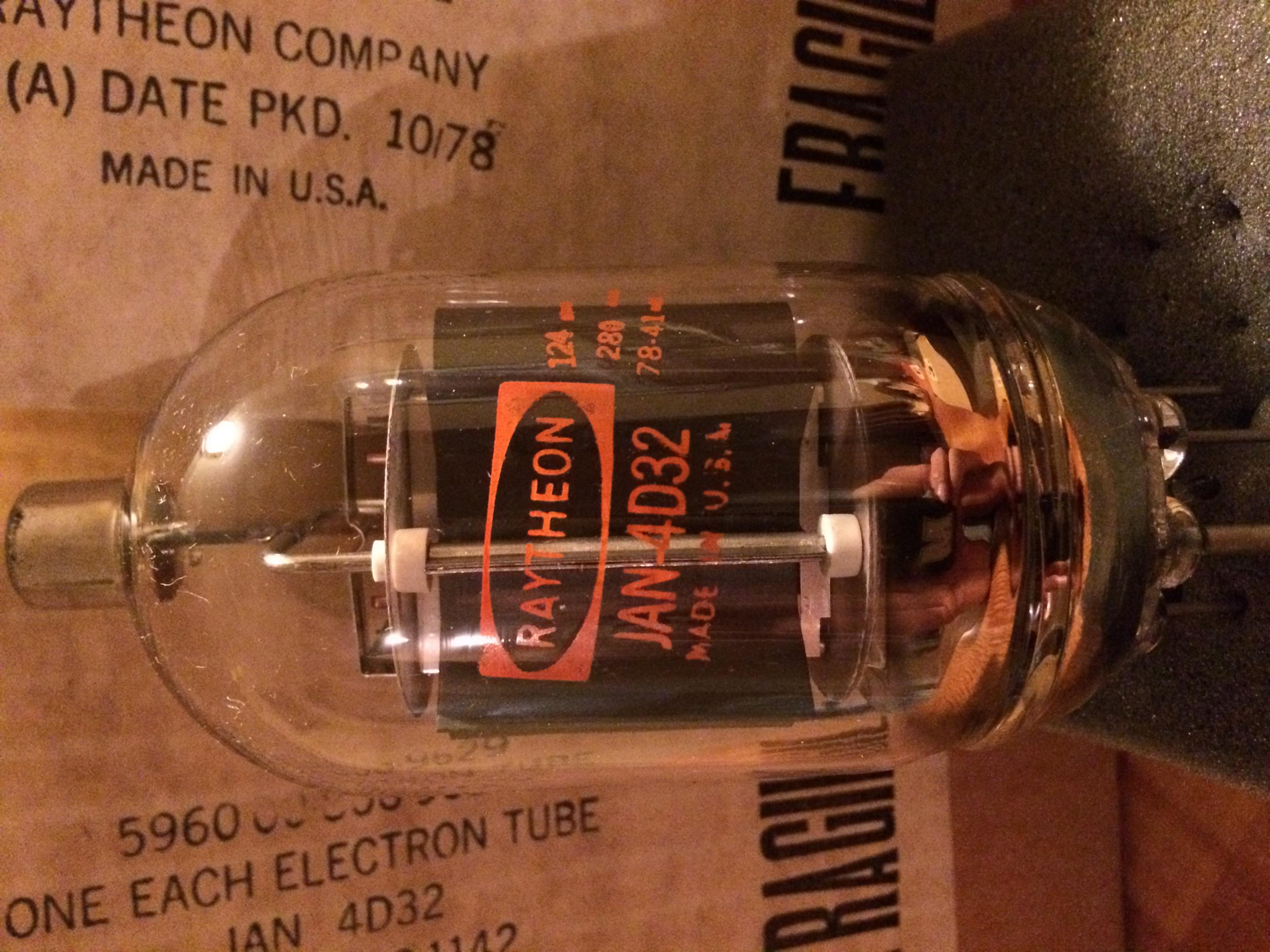

Those late production Raytheon 4D32 do not have a good reputation in the ham radio community.
Gassy.
Win W5JAG
Gassy.
Win W5JAG
I have 8 and they all look to have their getter. If in the future I decide to use a different tube I can adjust a few voltages and change the output tube socket if needed.
My thought is to build an AB2 output stage following Raytheons recommended operating points. I am looking at the data sheet and have a question. This will be the first of many I'm sure.
Jack at Electra-print asks what is the desired current through each primary. The data sheep lists plate current at 365mA. This looks to be for two tubes. Do I ask for 365mA or half of this per side?
Here is a link to the data sheet. I can't attach it. Too big.
https://frank.pocnet.net/sheets/138/4/4D22.pdf

I bought six, two were so bad that the getter spot was completely gone on one tube, and white on the other. I emailed the Ebay seller who replied that they were OK, just try them. I fired the white one up on a power supply and took a picture of the purple glow, which I sent to the vendor, and asked,"would you put this in YOUR Collins?" He replaced both tubes. I tested all six at the time, several years ago, but I will test each tube with a power supply again before connecting them to a good OPT.
The tube in Evan's picture looks good, but only powering up will tell.

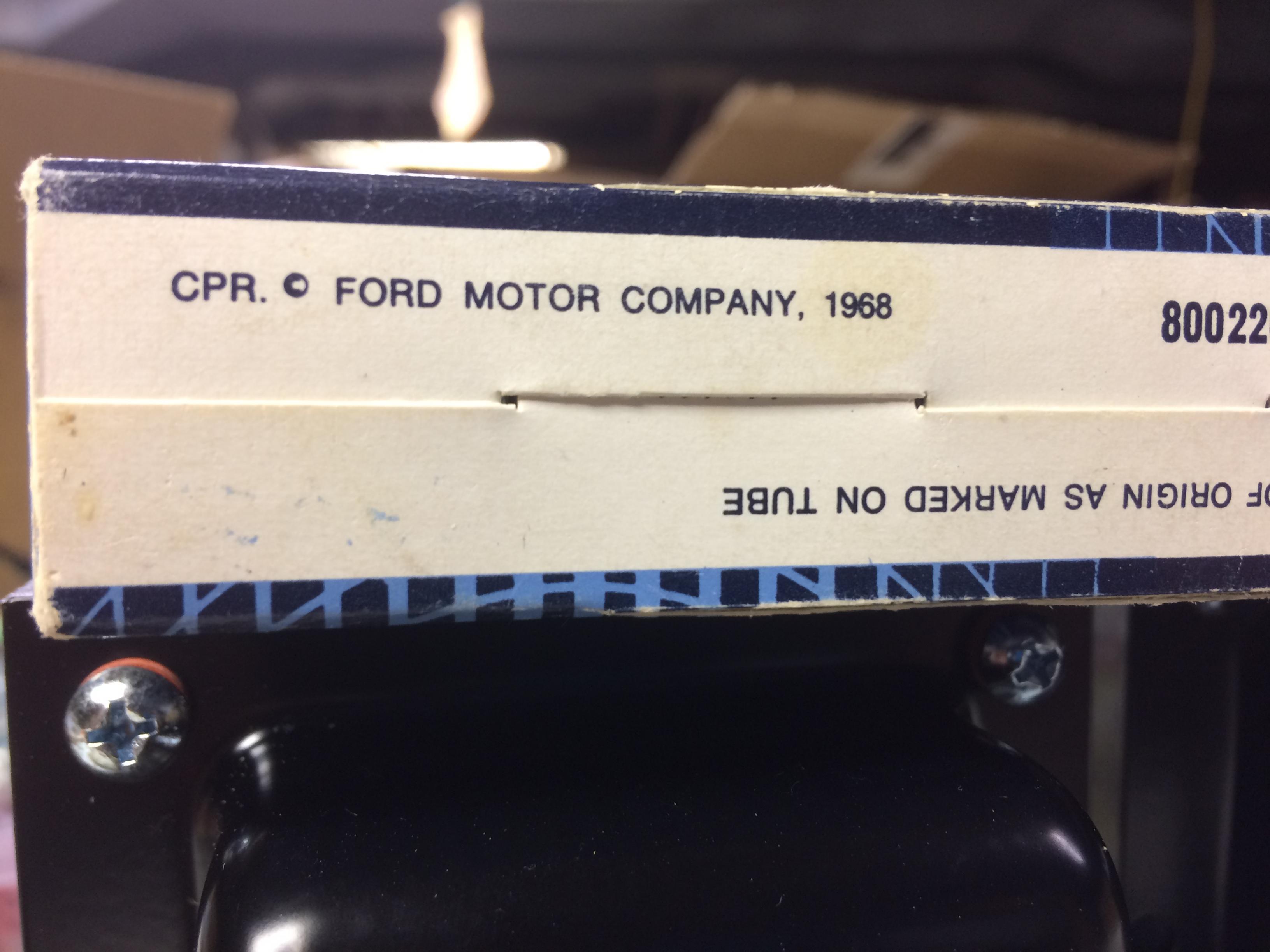

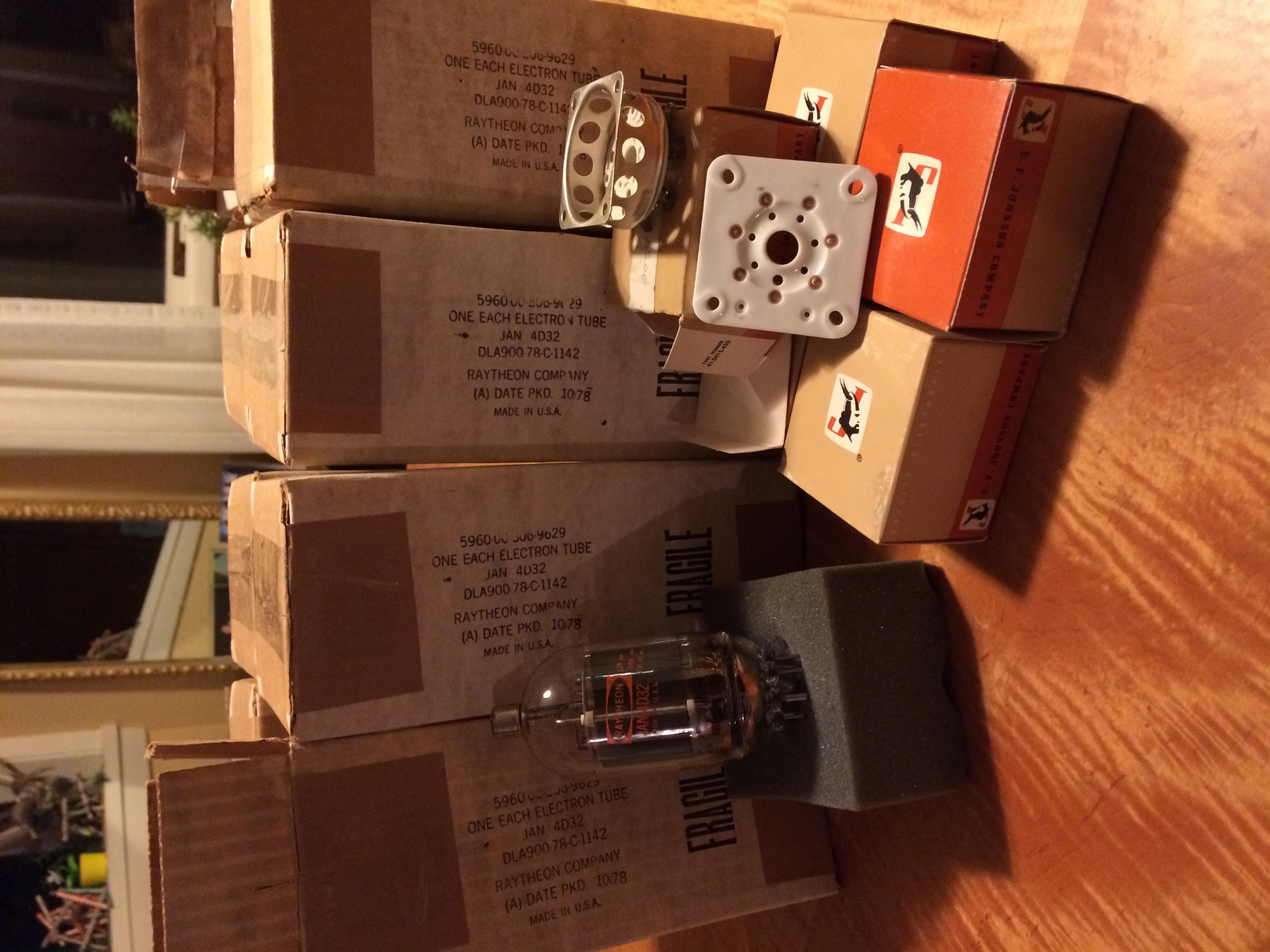

I found two boxes of tubes that were purchased long ago. I walked into the warehouse of a popular tube seller 10 or 12 years ago. He asked if I was interested in any "pre-auditioned" Russian audio tubes. They all had the Tube Store matching stickers on them, and had been "used at a show." Considering the time frame, and the fact that most were 6L6 variants, it was likely NAMM. For $10 each, I took them ALL. I have stuck them in all sorts of amps, and never found a bad one, so these shapely Sovteks are going into the amp. The dates on the boxes are all from 2005.

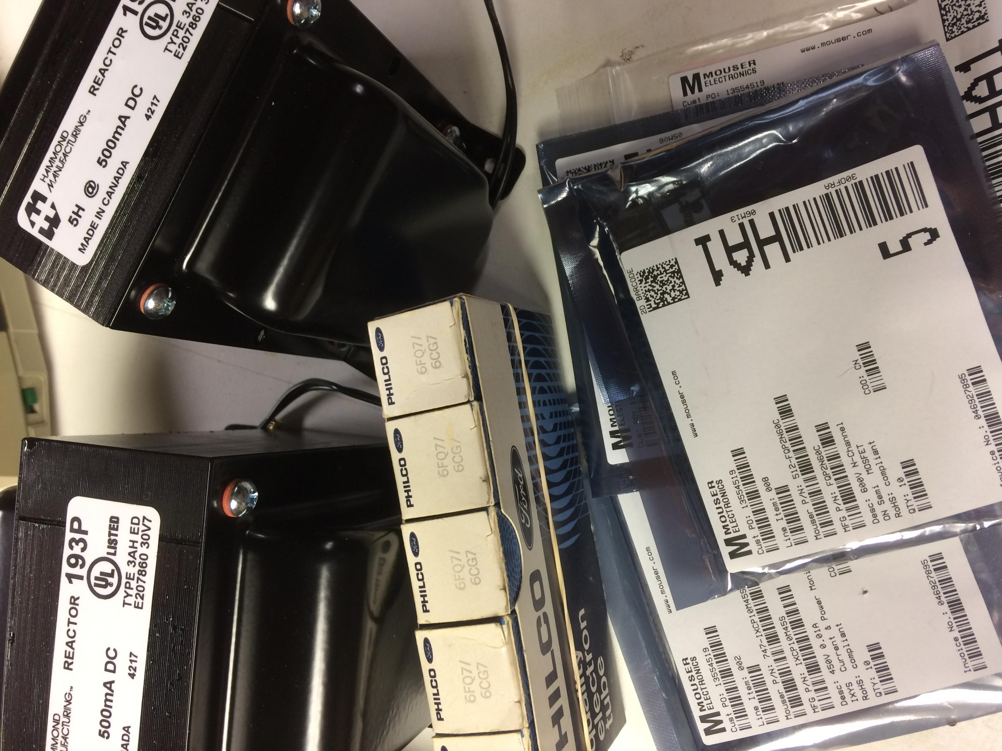

Continuing along and looking at parts on hand for 9 pin miniatures I have a bunch of 12au7 tubes. To my novice eye it looks like an OK fit.

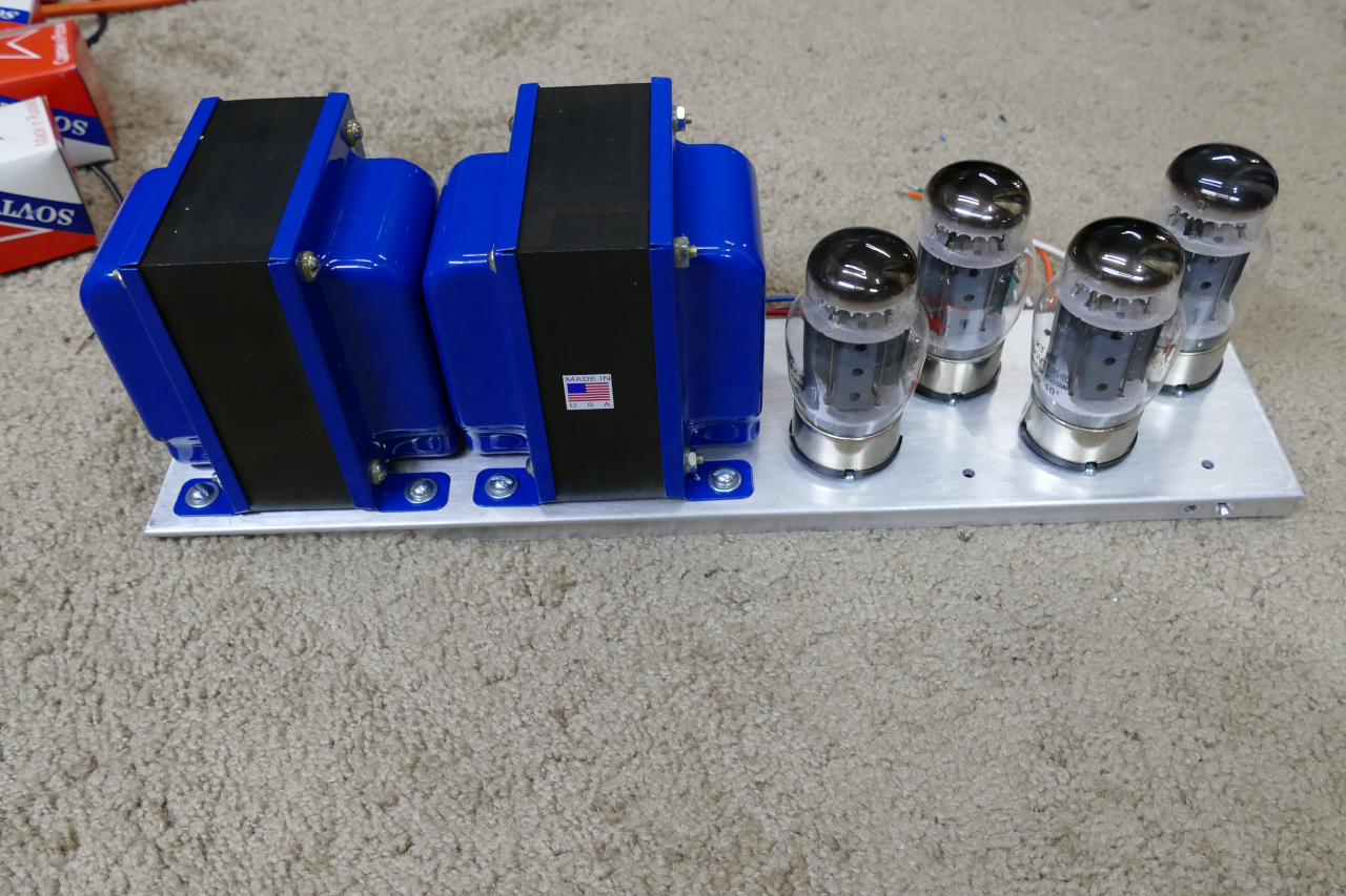

I got the tube sockets and OPT's mounted. No wiring yet. This the divider that runs through the center of the chassis.

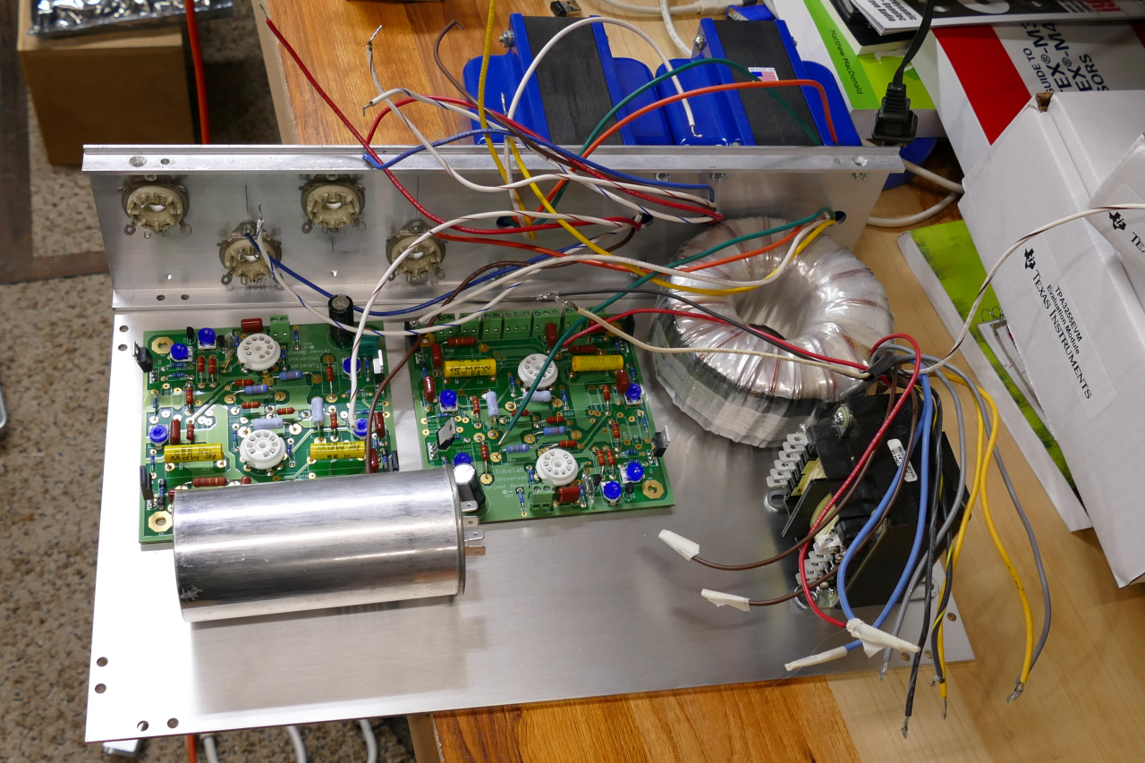

Not much activity in the past week, except for some test fitting. The OPT's and power toroid were stolen from the breadboard for mocking up the chassis for the final amp build. It's my usual case of too much stuff for too small of a box.
