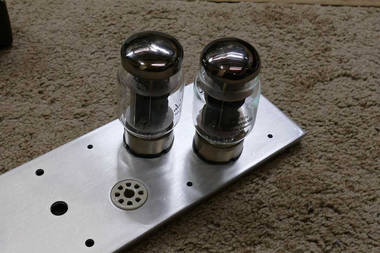

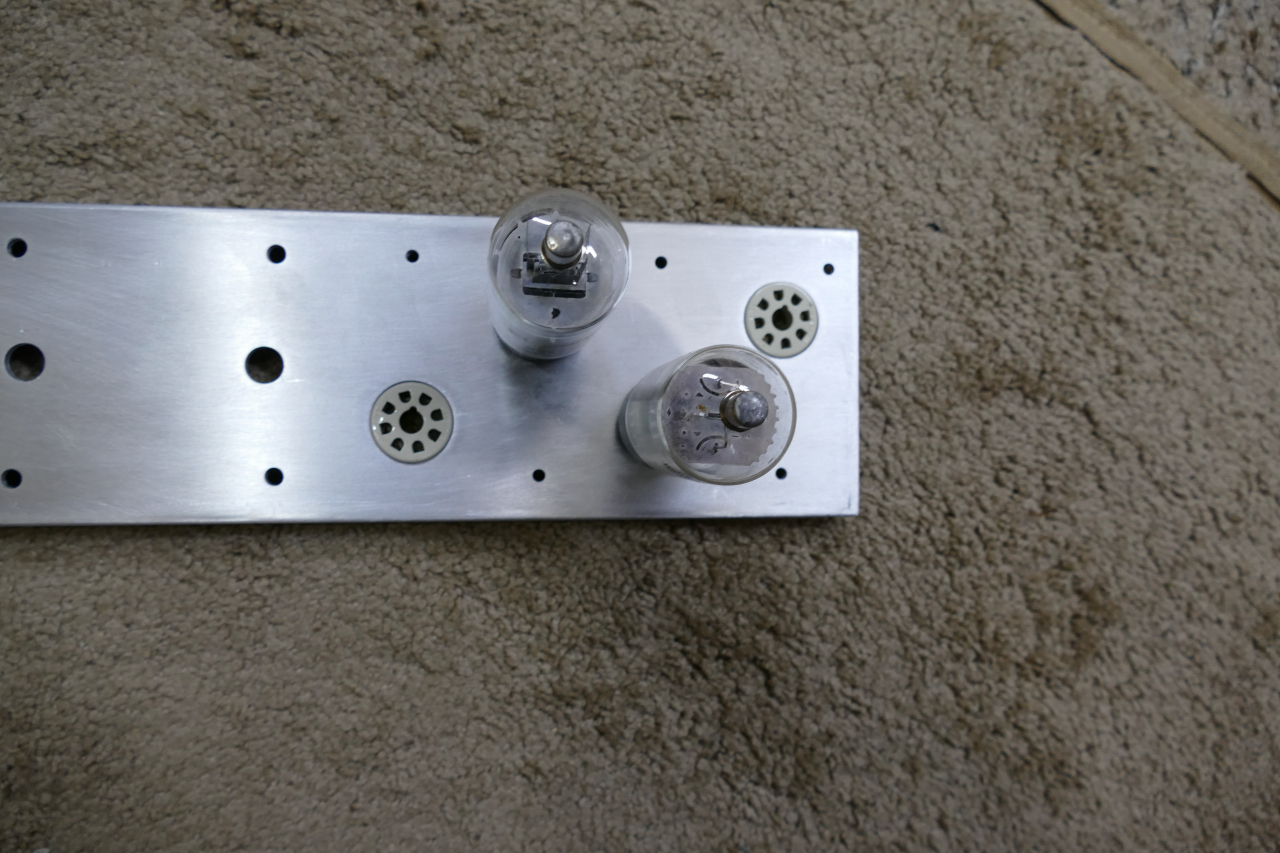

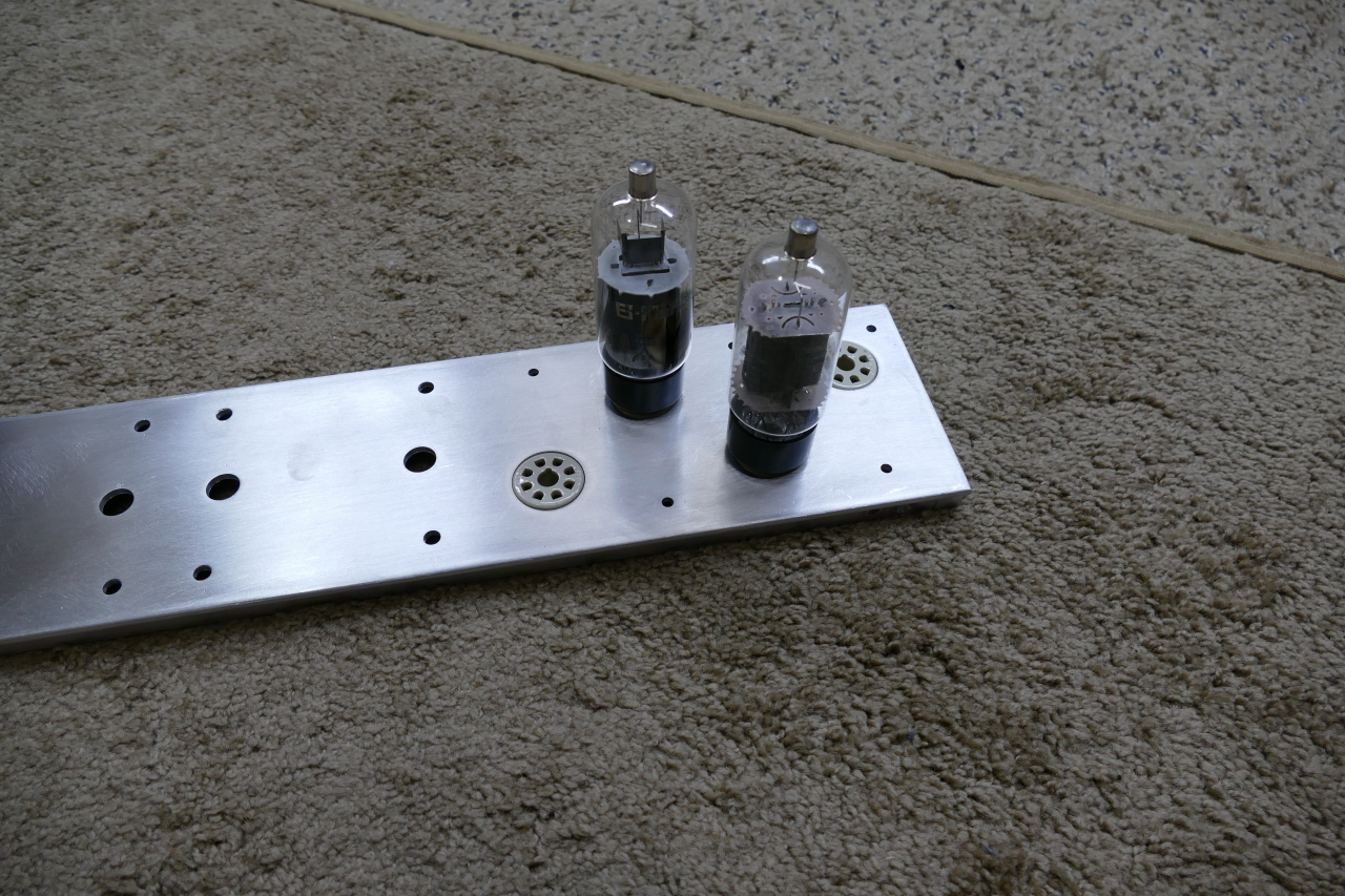

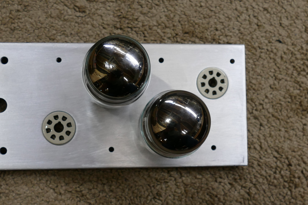

The first two pictures show the output sub-chassis with a pair of EH KT88's in it. The 3rd and 4th pictures show the same chassis with 6CB5's.
Are you concerned that the KT88's on your chassis are too close and won't have enough ventilation? Is there are rule of thumb for that.
The 300B's that I put on my TSE look a lot closer than that. Should I be concerned?
I guess EL34's are skinny enough, but don't have the power you are looking for.
I have seen several "rules of thumb" regarding tube spacing, and yes the TSE with 300B's does violate most of them. The TSE was originally designed for 45's, I never thought of sticking 300B's in it, but one of the guys I sold one of the early amps to did it and ten years later the 300B is the norm. WE 300B's, the early Russian and Chinese clones ran at 360 volts. Today there are "300B's" that eat over 400 volts.
The most common "rule" that I have seen is to space the tubes from each other, the transformers, or any other solid object a distance equal to their diameter. It is also a rule that's commonly violated by even the big name tube amp makers of the past.
I imagine the real spacing requirement would depend on how hard the tubes were run, how much ventilation they receive and how many tubes and other heat radiating objects are nearby. Even the color of the surroundings matter, shiny silver will reflect the heat back into the tubes, while black will absorb it. A tube does not usually radiate heat evenly. Beam tubes like the KT88 shed their heat off two opposing sides, where the electron beam hits the plate. The Electro Harmonix KT88's have heat radiating fins to more evenly distribute the heat. The others do not.
The chassis that I am committed to using puts 4 output tubes inside a rack mount cabinet with a side wall on one side of the tubes, and the OPT's on the other side. The KT88's that I have are rather short and fat, with all the heat being radiated from a 1.5 inch tall plate. The tube to tube spacing is just 3/8 of an inch and that is maintained for 1/2 inch past either end of the plate. The 300B's on the other hand are only close at one point.
I am now looking at some TV sweep tubes that are 1 7/16 inches in diameter with a 2 inch tall plate. They would open the tube to tube spacing up to just over 3/4 inch. The heat radiating area (the plate) is 1/2 an inch taller, so for the same dissipation the heat is more spread out. That's two small steps in the right direction. TV sweep tubes have been more efficient than typical audio tubes in my past experience, so this could mean less overall heat generation for the same power output.
I really should have opened up the chassis box earlier.....it's a bit smaller than I remembered. I still want to squeeze a 60 to 100 WPC amp inside it if possible.

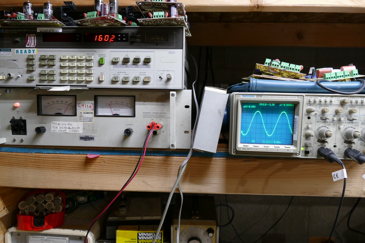

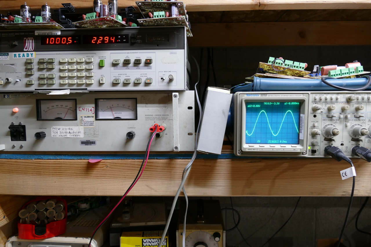

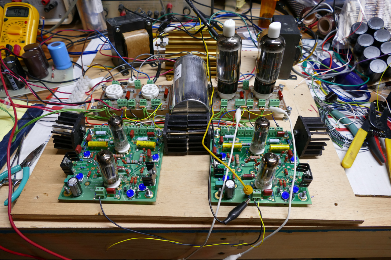

Today didn't exactly go as planned. Smoke and flames happened! On a good note, sweep tubes ROCK!
I swapped out the output tube boards for a pair of prototype universal octal output boards that were configured for one of my favorite sweep tubes, the 36LW6. These tubes come in two flavors, big (Sylvania made) and bigger (GE made). I chose the smaller of the two based on my expected output requirements, and physical size. I also have a pair of proto compactron output boards and some 35LR6's for future testing.
Fortunately I had the foresight to replace the $100 each Edcor OPT's with some cheap OPT's left over from my guitar amp making days. These were designed for budget guitar amp use, but have the same 3300 ohm impedance as the Edcors. I bought 200 of them about 20 years ago for $16 each! I have stuck these OPT's into everything from guitar amps to my 300B push pull amp. I use them for testing when I'm not sure of the outcome. In 2o years of abusing these, I have fried exactly one of them, and it was with this exact tube / OPT combination. The OPT instantaneously burst into flames when I was attempting to extract maximum power with a 750 volt supply and the load resistor blew open.
The KT88 amp drew my intended power supply down to 485 volts at full power. I would be using a bench supply for todays testing because the bid toroid and the Edcors are being test fit into the chassis. I set the power supply on 485 volts and let it rip. The KT88's started to soft clip at 65 watts and hit 5% distortion at 71 watts. The 36LW6's started to clip at 108 watts and hit 5% at 114 watts. These numbers were recorded just by changing the tubes and setting the bias.
Seeing this prompted me to turn the power supply UP! I got to 585 volts, 100 more volts than where I started when I realized that I was now pulling more power through a 50 watt OPT than I should, so I quit while I was ahead. I was reading 160 watts at 2.3% distortion, and my load resistors are rated for 120 watts.
I put tubes in the second channel, set the power supply back to 485 volts and fired it up. After setting the bias and cranking it up I noticed that the distortion was a bit higher than the previous channel, so I began to tweak. As I was adjusting the bias I noticed a jumpiness to one tube, and I saw a hint of oscillation on the scope........then a fireball erupted on one of the driver boards. Two resistors were reduced to dust and charcoal instantly and there is a burnt spot on the PCB itself.......
I had taken a shortcut, and it didn't pay off. Resistors have a voltage rating, and abusing it by a factor of three causes a stinky pile of burnt parts. I have implemented a local feedback method on these boards, and called it "experimental." The intention is to put half the resistance on the output board, and half on the driver board, for a total of 4 resistors in series. These are wired between the plates of the output tubes and the plates of the driver tubes, which are out of phase with each other. This means that they could potentially see about 3 X the B+ voltage, hence 4 resistors in series.
The KT88 test amp had 2 resistors on the driver board, and two in the air between the driver and output boards. This test had only two resistors, all on the driver boards. One of those sets ceases to exist!
I cut out all of the feedback resistors, and that channel still has issues. I will be out of town all day tomorrow, so a full autopsy will wait until at least Tuesday. The possibility of snow tomorrow night may delay that further. I have to clear my 82 year old neighbors driveway as well as my own if it snows enough.
I snapped three pictures as I cranked the first channel up to 160 watts.
