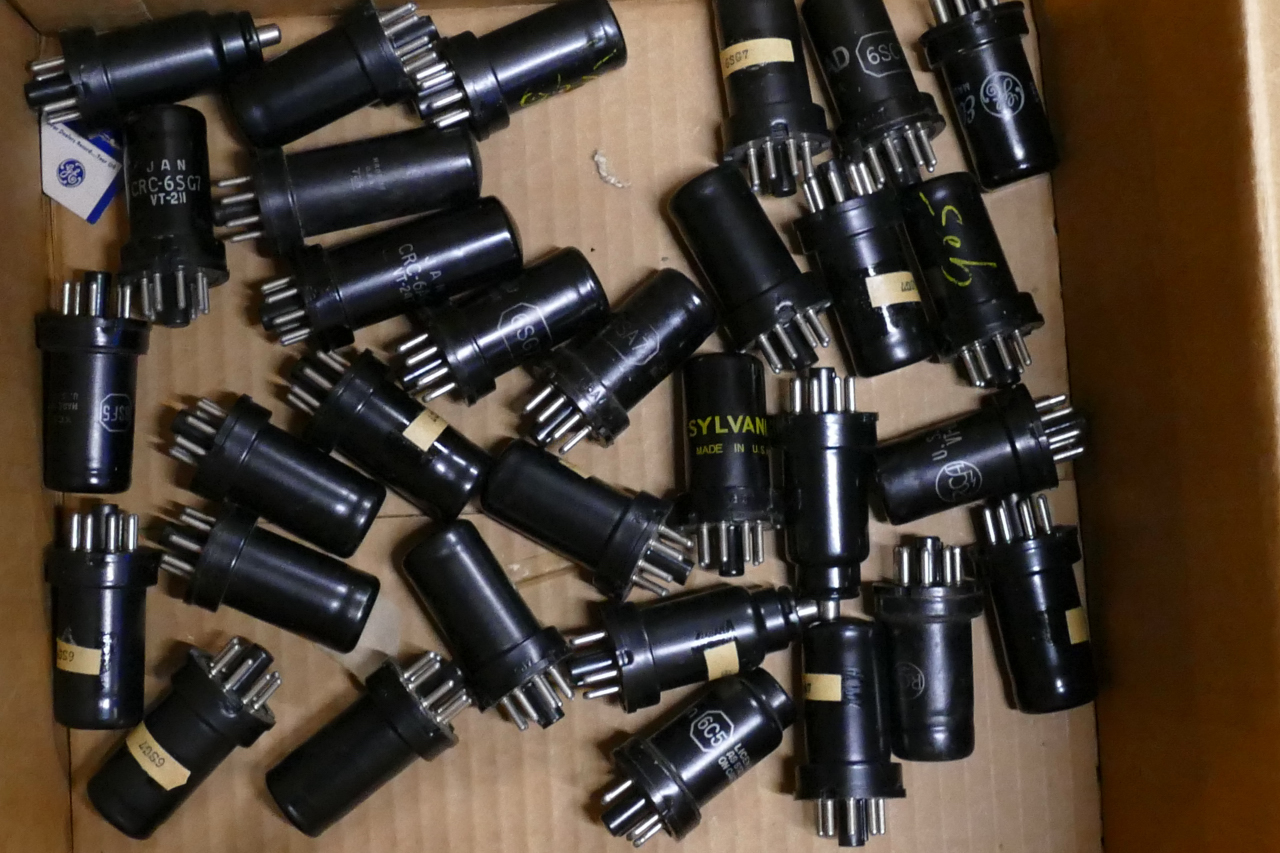

I'm reorganizing the mess to make space for building 4 more boards, with pictures and maybe video when I find a box with a few metal tubes in it. I remembered that someone gave me a couple boxes of loose tubes at the Dayton hamfest 2 years ago, I took out the stuff I wanted, then gave away the rest, but these few metal tubes got forgotten until today. I had already pulled the pair of metal 6L6's and put them with the other 6L6 types, but haven't tried them. There were some tubes that were taller than the others. I picked one up and it was a 6AG7 which is a pentode, useful as a driver, but I didn't look much further.

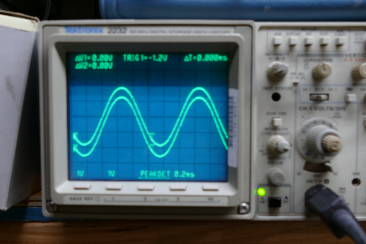

Today I looked. Out of the 10 tall tubes, 8 were metal 6V6's, all were shiny black with no rust......what do I do with these???????
Stick them in the amp, and twist some knobs.....what do you get from some old metal 6V6's? How about 30 watts at clip, 25 watts at 1.1% distortion. The problem with the metal tubes is that you can't tell if they are melting inside, but there is an easy test.....pop some glass tubes into the sockets and watch them.
I want to play these guys on speakers tomorrow, and dig up some glass 6V6GT's to find out what's going on behind that steel curtain.

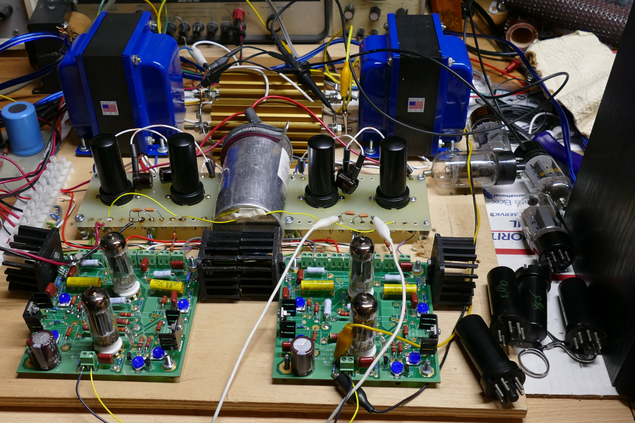

I did get to stick some glass 6V6GT's in the amp and test them at 30 watts. Nothing was glowing once I found 4 good tubes. Plate dissipation at 30 watts output is 15 watts per tube, a bit beyond the 12 watts spec, but in normal operation you are only going to hit this on loud peaks. I hooked up the speakers and let it play some streaming music from my iPAD for most of Wednesday. No issues, and it did sound nice.

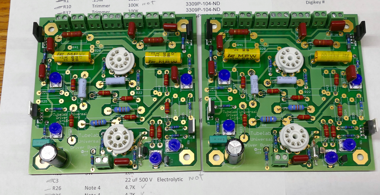

The mail girl brought me my Mouser order yesterday, so I cleared the workbench and set up the cameras. I was planning to spend today stuffing boards, but stink happened.

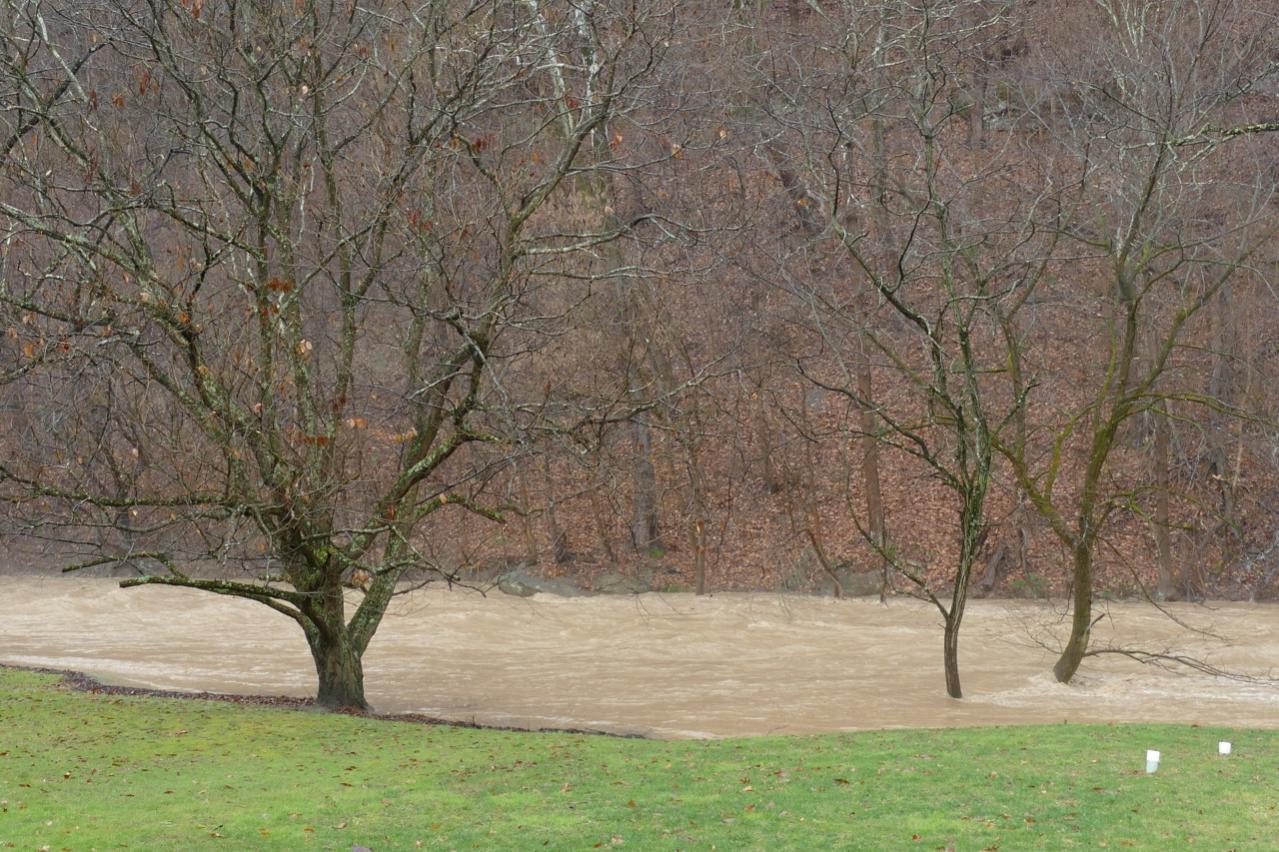

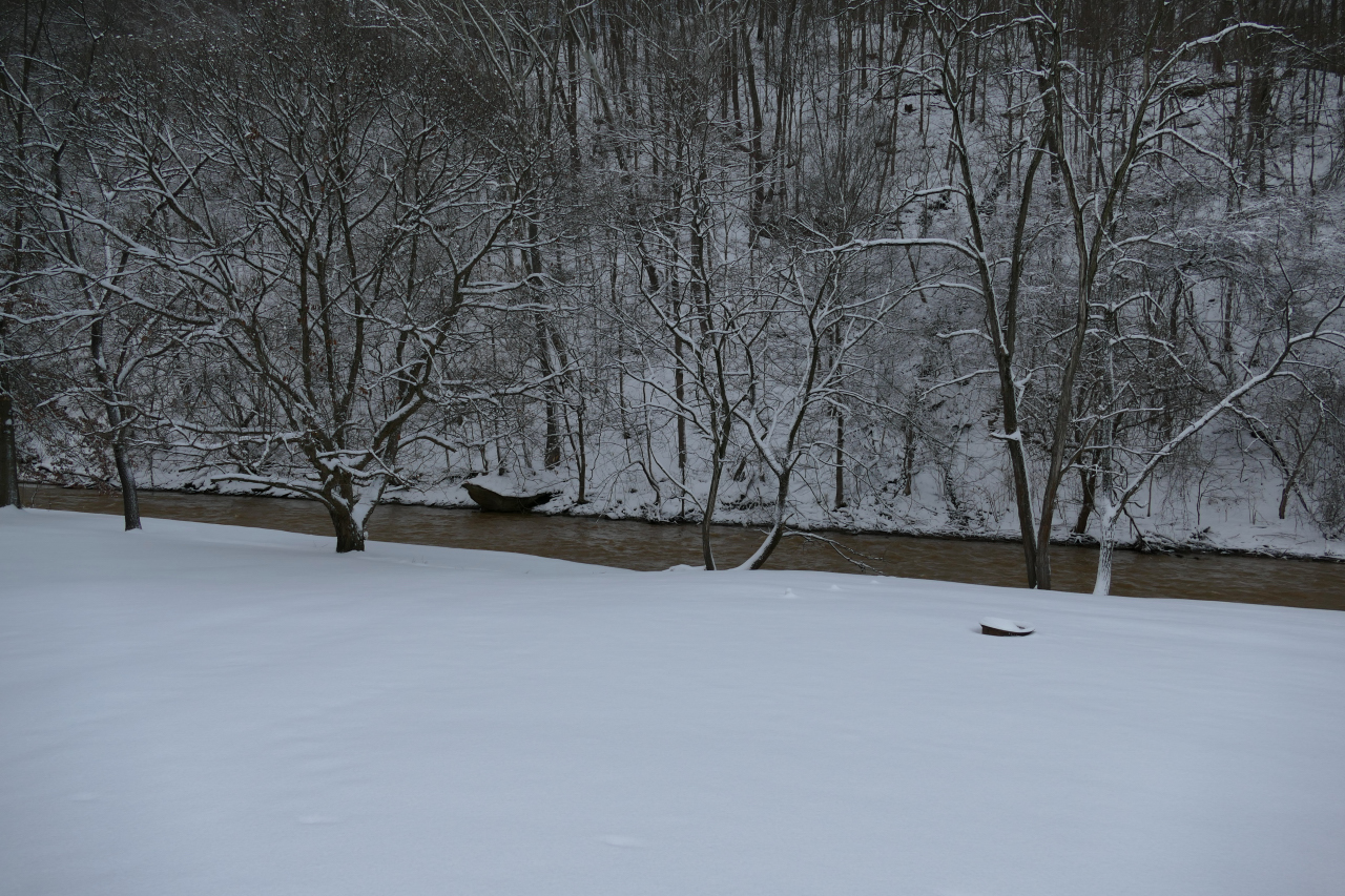

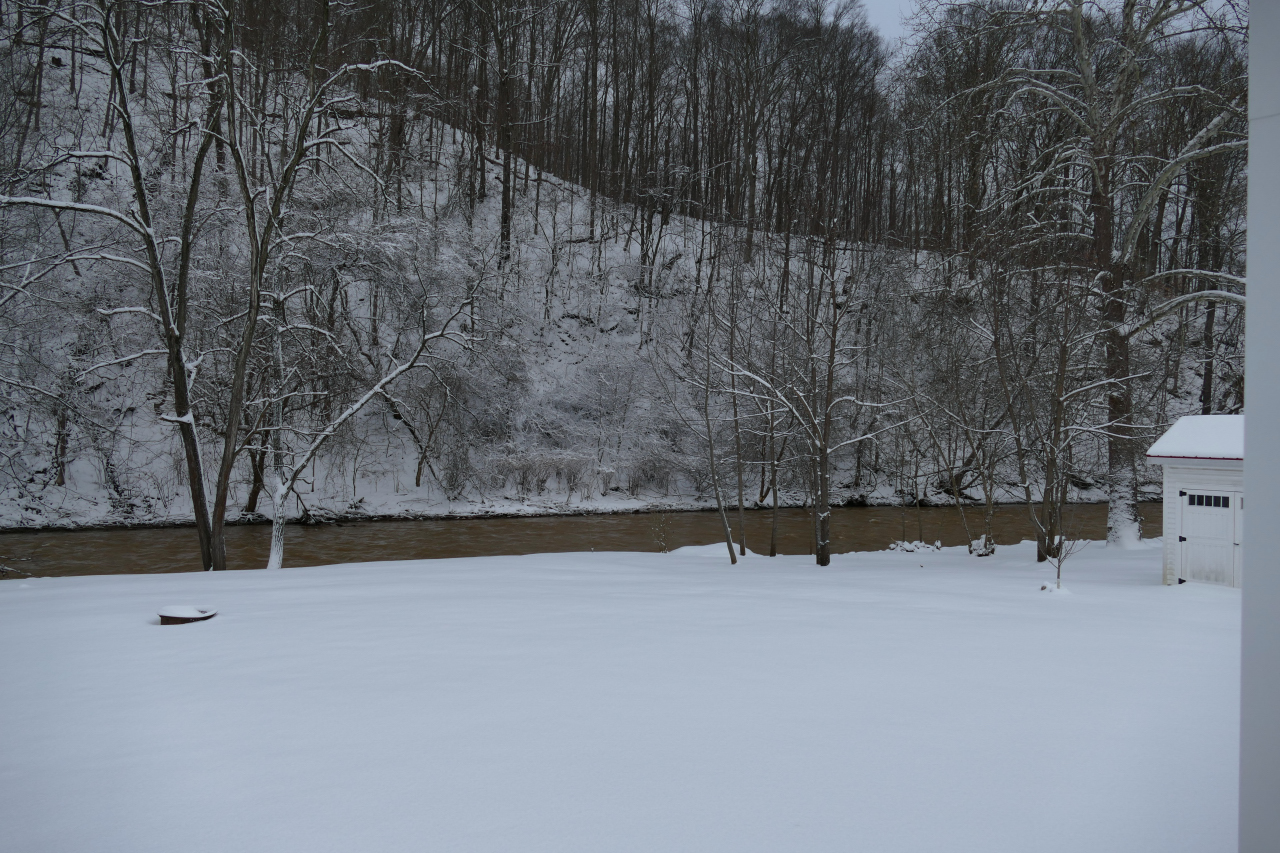

With about 3 inches of packed snow on the ground, the rain started yesterday.....and hasn't stopped yet. It will rain until late tonight when the rain turns to mush and then snow. 5 to 8 inches, 10 in isolated areas are expected by mid day tomorrow.
This morning I looked outside to see that the previously frozen creek had thawed and overflowed its banks. Water had risen about halfway up the back yard, and the pressure started pushing the water in the saturated ground toward the house. My lab, workroom, and music studio are in the basement which is well below the level of the water.
The neighbor told me that she has standing water in her basement, so I spent the morning dragging expensive electronics the cameras and a lot of other stuff upstairs. The workbench in now piled full of things I didn't want wet.
So far there has been no water intrusion, but the creek is still rising. Flooding has pushed some of the septic tank drain field water into the sump system, stinking up the entire house.
We will have 2 to 4 days of cold and wet before I can get things back to normal. I may set the soldering iron up on a folding table and stuff two boards just so I have 4 to play with. That depends on how today (flood warnings until tomorrow) and tomorrow (maybe snow shovel / blower day) goes.
The first two pictures were taken this morning. The 3rd a couple of days ago.

I removed the two boards from the test amp. They are being updated to match the latest parts list. Two new boards are being populated to match. After all 4 boards are tested and working, the parts list and schematic will be updated, and posted. The old boards will be returned to the test amp, and the new ones will be used to make a complete amp.

Nice new boards George! Maybe in a few years I can afford to buy some more parts & your PCB's. I posted a link to this site over at AK when you announced the new boards, and hopefully that will help you sell more!

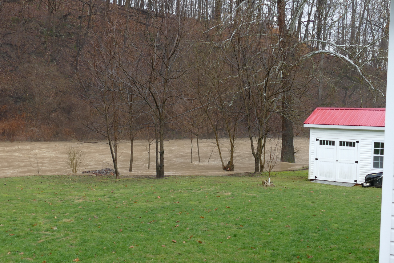

It has been below freezing for over 2 weeks. The creek in our backyard was frozen over several inches thick. There was about 5 inches of snow covering the yard and the frozen creek when the rain started. The ice melted enough to jam up the creek and flood our back yard. My unfinished lab is in the basement, so I dragged most of the movable expensive things like cameras, computers and other electronics upstairs or piled it up on all the workbenches.
The rain left, and the snow returned. Yesterday the snow left and the cold returned, near zero for two days. There is a layer of ice covering the creek, and 6 inches of snow on the ground. The creek empties into the Ohio river which is 7 inches below flood stage. The stuff stays where it is for now.

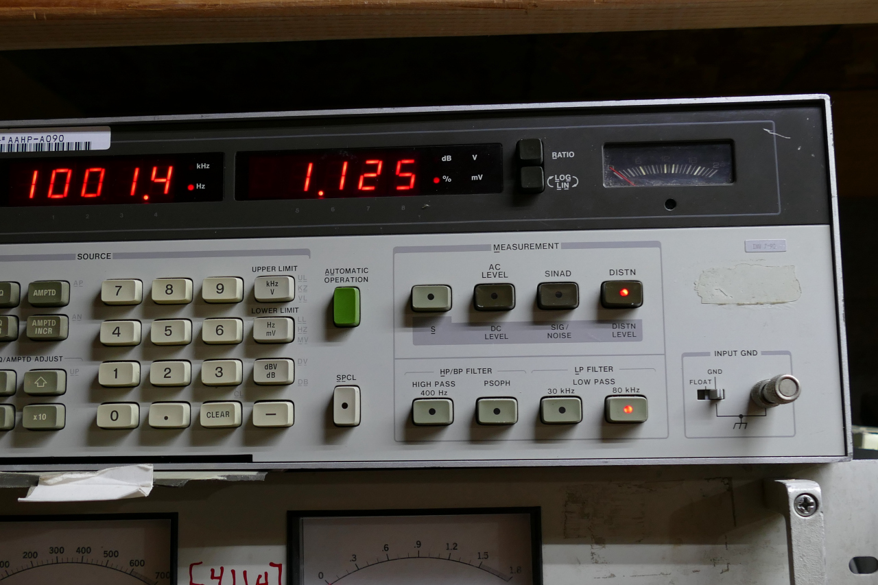

I cleared a small corner of the workbench today for a day of soldering. There are two new boards that will see power tomorrow, and the existing pair now have exactly the same parts as the new pair. The old boards get tested first.

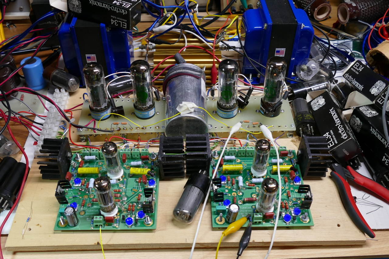

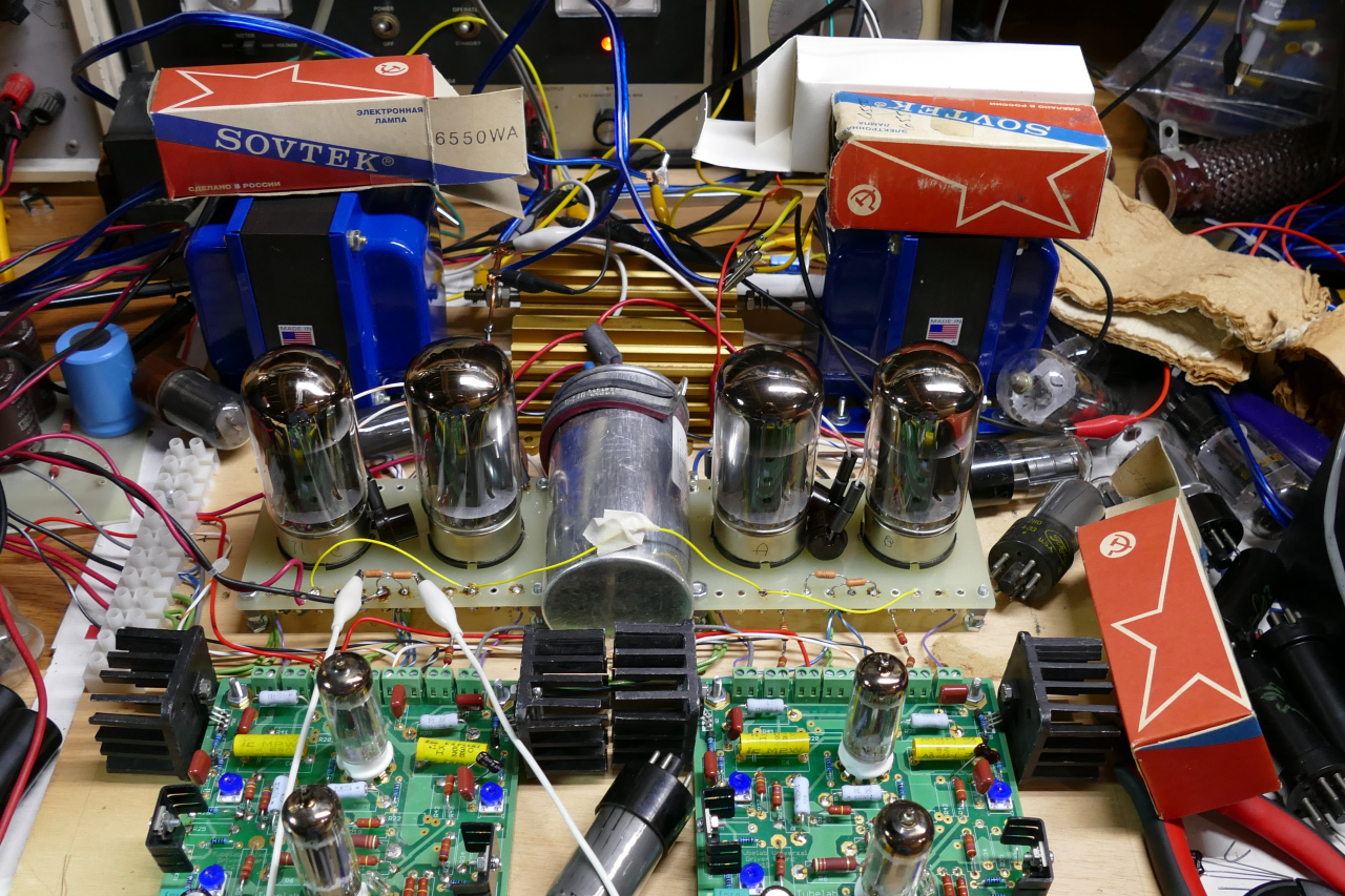

I got sidetracked today when I opened a box that's been packed for several years. It was full of Russians....tubes that is. There were a lot of "one of a kind's" and unmatched pairs like a wafer base Sovtek 5881 and a regular base Sovtek 5881, but some good stuff.
There were 4 Electro-Harmonix EL34's with TubeStore matching stickers. 3 number 42's and a 27. Not quite a matched quartet, but I wired up the old driver boards and plugged them in. They sounded nice with 450 volts on the plates, and 350 on the screens. I listened to them for about 20 minutes because something far more interesting had caught my eye.

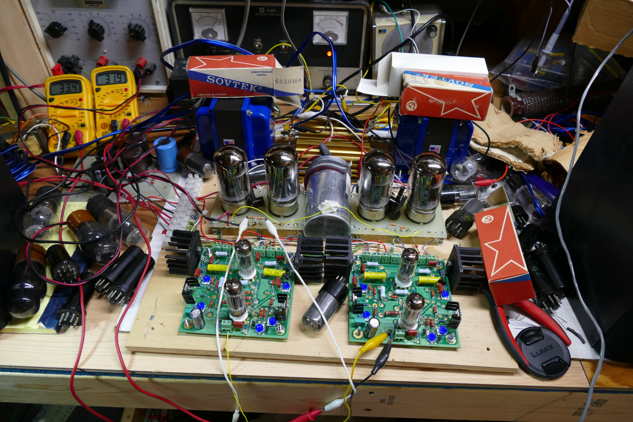

There were 6 total Sovtek 6550WA's from the late 90's. There were two matched pairs with matching stickers dated 1998. I was buying these from the original Triode Electronics to build guitar amps back then. These things would eat everything I threw at them without blowing up. So how would four 20 year old Sovteks take some fresh abuse?

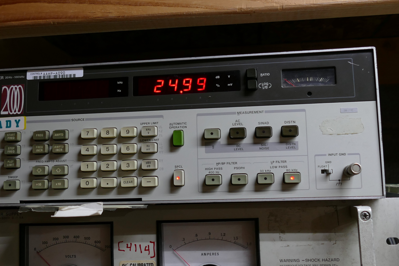

I stuck them into the amp, set the plate supply on 525 volts, the screen supply on 400 volts cranked it up and fed it everything from Norah Jones to Metallica. They laughed it off. I noticed the screen supply current meter bouncing north of 100 mA (all 4 tubes) on loud music when the EL34's were installed. I never saw the screen supply bounce above 50 mA when the 6550's were fed loud Metallica at full tilt.
I have been hesitant to use the GE 6550's in an amp since they are rather pricey today. I could sell them for enough $$$$ to build a whole amp! The old Sovteks are a different story, especially when I have 2 spares. I may test them in triode mode and do a side by side test against the GE's when I get a chance.
