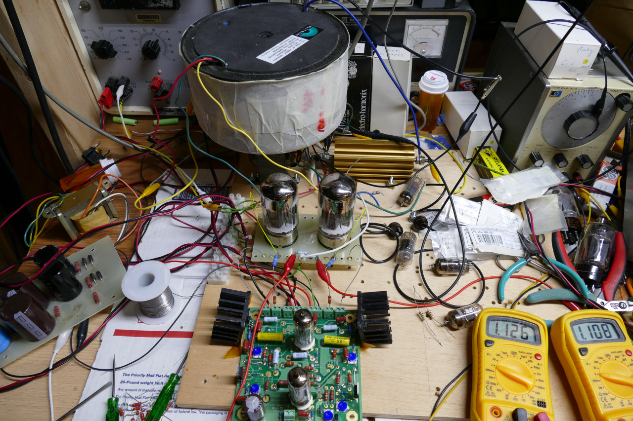

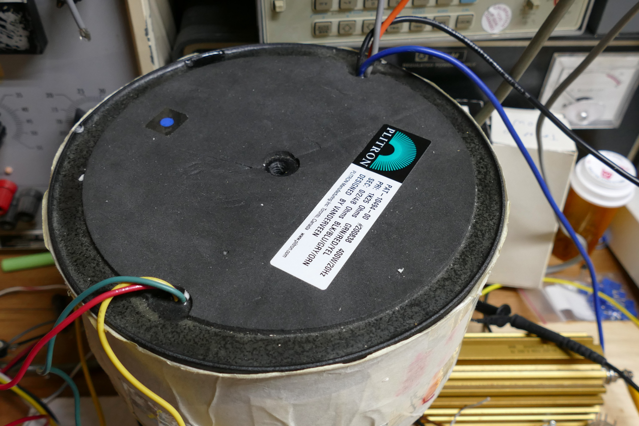

I have a pair of Lundahl LL1663/PP OPT's that are 5K but are rated for "40 watts at 30Hz." I think I can get more than that from these tubes, so......
I have two different pair of Plitron OPT's that are 1.25K and are rated for "400 watts at 20 Hz." I have previously used one set of them at 5K ohms by connecting the 8 ohm load to the 2 ohm output tap. Maybe I won't get 400 watt capability this way, but I have seen 100+ watts. One pair of the Plitrons are seen in post #5 connected to a pair of transmitting tubes and wired for 2500 ohms (8 ohm load on 4 ohm tap). 250 watts flowed forth from this combination, but I didn't run a frequency response test. I decided to use their bigger brothers for this test! Everything else is as ran in the last test with the GE 6550A's. I just swapped the OPT's.
The first two pictures show the huge OPT. These things cost about $900 per pair when Plitron took them out of their catalog. I paid far less for a used pair. We found out last time that expensive tubes produced better MEASUREMENTS than the budget stuff, now does a $400 OPT do better than a $16 OPT........it better:
The results for a 5000 ohm OPT:
power THD B+ current output stage efficiency
0.1 W 0.086% 90 mA 0.2 %
0.5 W 0.074% 93 mA 1.2 %
1.0 W 0.083% 95mA 2.3 %
2.0 W 0.126% 98 mA 4.5 %
5.0 W 0.273% 111 mA 10.0 %
10 W 0.520 % 130 mA 17.1 %
20 W 0.855 % 160 mA 27.7 %
50 W 1.73 % 220 mA 50.5 %
Maximum tube dissipation is reached somewhere between 20 and 50 watts output, and is about 26 watts. It drops to 24.5 watts at 50 watts output. Maximum tube current is reached at maximum power (50 watts) and is 110 mA. Both of these are conservative for KT88 and 6550.
Conclusions.....Unless you need 70 watts, the 5K load is the optimum spot for triode wired KT88's on 450 volts. The distortion numbers can not be directly compared since the better OPT's obviously made better numbers. The power and efficiency numbers are about right.

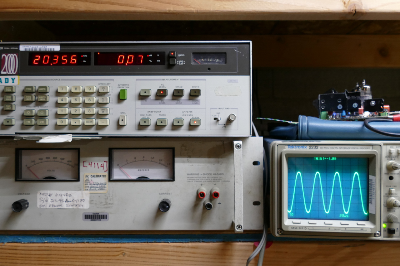

So if I had frequency response numbers on the 3300 and 6600 cases, I would have been measuring the OPT's and not the amplifier circuitry. This may still be the case with the Plitrons, but I like the numbers. the distortion numbers put that "first watt" the squeaky clean zone below 1/10th of a percent.
Many amps measure the frequency response at something like 1 watt, but those numbers were beyond the range of my test equipment, so I decided to measure the frequency response at FULL POWER, 50 watts.
The low frequency -3db point was somewhere below 10 Hz, the 8903 is not accurate below 20 Hz. OPT saturation effects became visible on the scope around 8 Hz at 50 watts. The distortion at 20 Hz and 50 watts is 1.83% (picture #3). The frequency response at 20 Hz is 0.16 dB down at 20 Hz compared to 1KHz. (picture #4)
The high frequency -3db point is 78,568 Hz. The distortion at 20 KHz and 50 watts is 2.464% (picture #5). The frequency response at 20 KHz is up 0.07 dB compared to 1KHz. (picture #6)

Wow! With careful measurements to boot! George, do you take all those distortion readings manually by nulling, etc each and every time?
If you look at the pictures in post #23 and many of my other posts for the last 10 years you can see a HP8903A Audio Analyzer (on top of the power supply to the left of the scope). It replaced the old HP33X series in the 1980's (I still have an HP331A). It does the same thing, except for having a better notch filter for a lower distortion floor, and it's somewhat automated. The automation is primitive by today's standards, but tuning and nulling the notch filter is automated.
Those distortion readings were made by simply pushing the distortion button on the front panel. It is only a basic THD + noise measurement, but good for comparisons on things like tubes and OPT's. It will do an automated frequency response sweep and send the output to an analog HP plotter, but you can't recover the data any other way. More automated results require an external computer and some programming.
I worked in the test equipment calibration lab at Motorola when these things came out, and I spent quite a bit of time playing with them. The measurements that make are accurate, and better than the old HP33X series due to the deeper notch filter. The HP8903B series is a bit better, and a lot more reliable. I have repaired this one 4 times in 20 years.
The instrument I have actually came from Motorola when the first large Florida plant closed down and all the stuff was scrapped, auctioned, or donated to the local college.
I use a PC with a 24/192 sound card for FFT measurements (individual harmonics), but I haven't made it work right since I moved 3 years ago. I lost the license dongle for WinMLS, so I will try some free software soon.

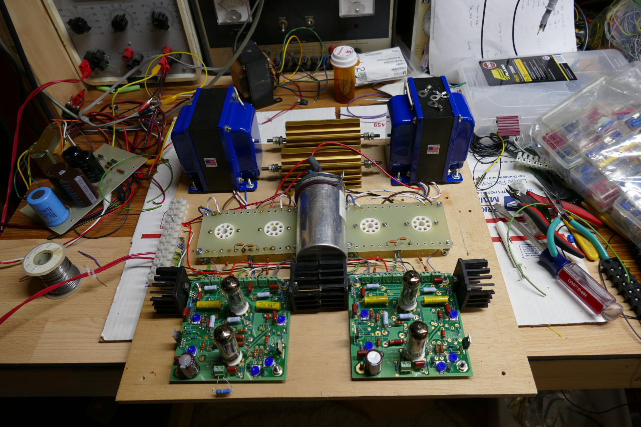

The second channel PC board is now stuffed with the same parts that is in the board seen throughout this thread. All this stuff will not fit on the plywood base I have, and I'm not about to head out to Lowes today, so I'm repacking it all to fit the available space. The OPT's will have to move to another piece of wood. I have a pair of 100 watt Edcors that need to be tested too!

I have finished populating the second board. It works great stand alone. Assembly of a stereo test amp is underway, but likely stalled for a few days.....4 grandkids, and 2 parents are scheduled to invade this house tomorrow morning. All objects that could be considered hazardous to 3 and 5 year old kids who think that they are Ninja' in training must be hidden!
