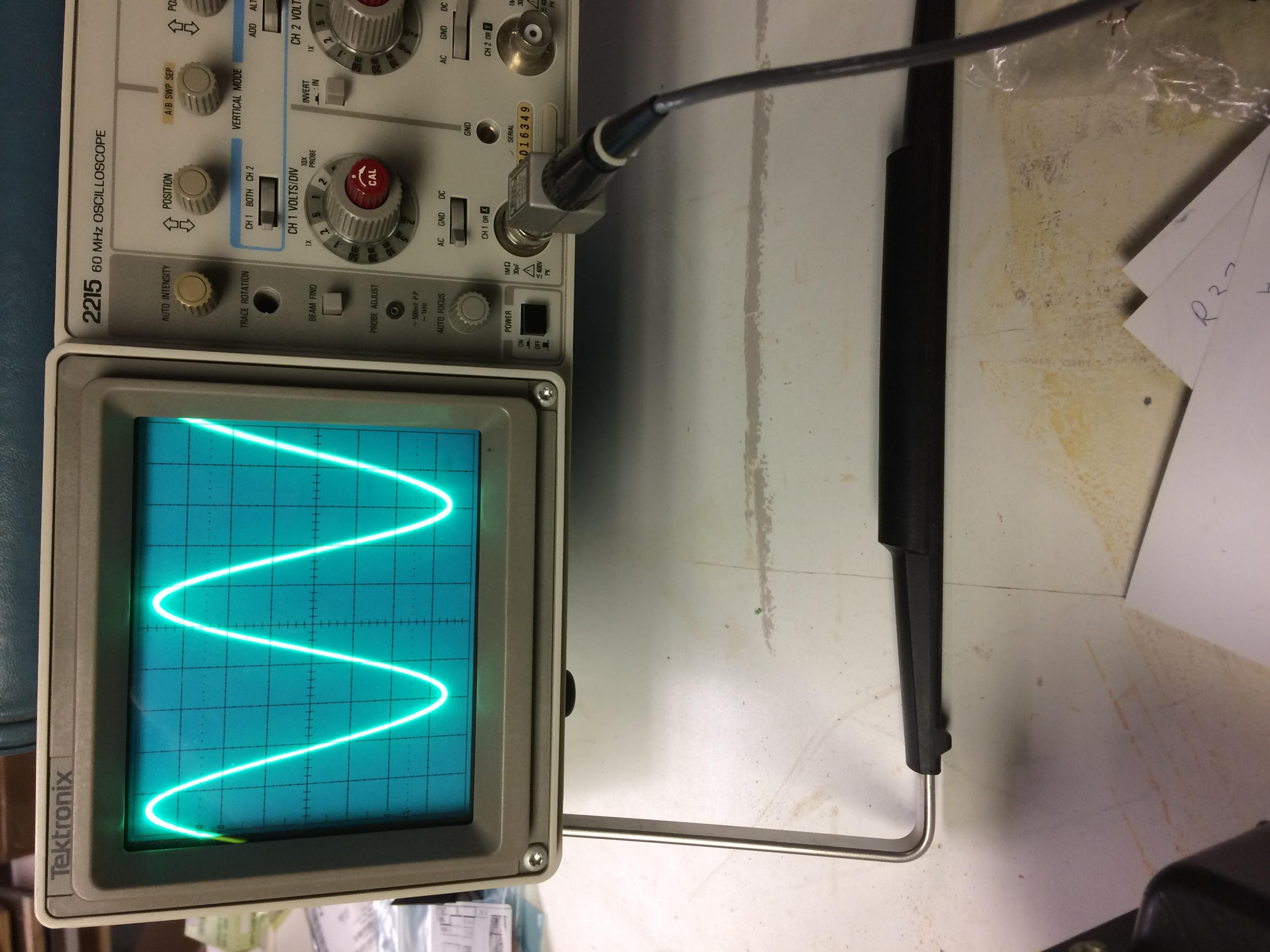

Well it was short lived. When I turned the unit back on nothing. DRV 1 and 2 now sit at the full negative supply voltage. R37 and 43 make a small difference. Maybe the mosfets are toast. I was checking the temperature when the amp was running and they were not getting too hot.
Mosfets usually fail to a short. This would put the full positive supply on the outputs. Check that your +165 supply is still alive. The mosfets do dissipate about 2 watts each and should have a heat sink of some type on them. I plan on just screwing them to the chassis.
It may also be wise to pull the output tubes while messing around with the board. I have a fried KT88 because I knocked the plate supply plug out with the screen still powered. The grid wires lit up the room for about 2 seconds.
All the supplies seem to be working. I have a few household things to attend to and then I can try troubleshooting
Got a pass on housework. Off to the basement to try and figure this out
My plan is to put the last few parts into my second driver board so I have something to compare to
The second board works and I believe I see the problem with the first board and I feel kind of clumsy. I hadn't trimmed the leads of IC 3 and 4 and they had been bent over and were shorting out. I'll check if this was really the problem tomorrow.
That would explain loss of sound, but shouldn't affect the mosfet bias circuit. Check to see if the voltage at the wiper of the bias pots are actually changing. If not, it could be bad mosfets. The mosfets contain internal zener diodes to protect the gates from ESD or other excessive voltages. I have seen these short out which will cause your symptoms.
The bias adjustment is very touchy. Perhaps the amp is oscillating.
If the bias suddenly "snaps" or jumps from one current level to another it is possibly oscillation. It was an oscillation that caused the shorted zeners in the mosfets in amp built with these driver boards too.
I have not seen oscillation in amps built using these boards except when using high Gm TV sweep tubes. I don't remember any unusual effects when testing the 4D32's but I typically employ all sorts of oscillation suppression stuff that I have learned over the years. The 4D32 IS a transmitting tube, optimized for RF, so it will go there if conditions exist.

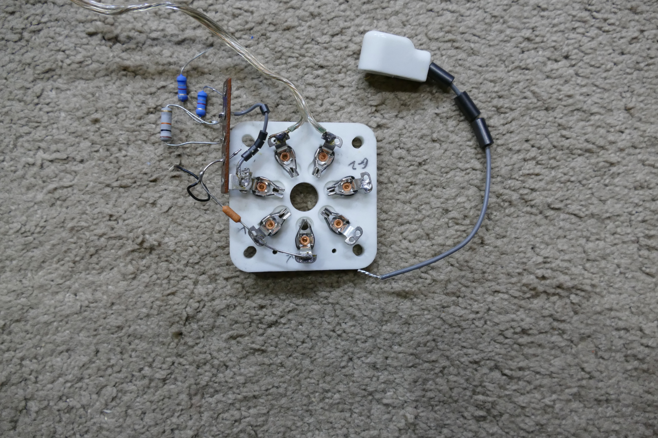

The wire connections from the driver board to the tubes should be as short as possible. There should be a short heavy wire from the 4D32 cathode directly to one of the ground pins on the driver board. This may be the 1 ohm sense resistor leads. I typically run it to the B++ or MOS ground pin. The wires from the driver board to the 4D32 grid pins should also be short. I typically use a low value (10 to 100 ohm) resistor with ferrite beads on it's leads.
A tube can oscillate if its grid and plate connections have enough inductance to cause an RF resonance. It WILL oscillate if either grid (G1 or G2) leads and the plate or cathode leads resonate at similar frequencies, or related harmonic frequencies. Short fat wires have lower inductance moving these resonances up out of the tubes operating frequency range. Added resistance lowers the resonant peak ("Q") and helps prevent oscillation. Some tubes like the 807 and 6146 require a plate damper to kill oscillation. These were made by winding 10 or so turns of wire around a 100 ohm carbon composition resistor, connected in parallel with the resistor. This is inserted in series with the plate lead right at the plate cap. I have gotten by by slipping a few large ferrite beads over the plate cap wire.
Here is the picture of my 4D32 socket and plate cap as wired for a temporary experiment. That short black wire went directly to the driver board. The terminal strip was added later for a dual drive experiment where the board fed G1 and G2. It didn't work out. I probably had beads on the G2 wiring as well.
Thanks for the pointers. As it stands now the wires from the driver board to the output sockets are quite long. I’ll spend some time and neaten things up. I had the amp playing this morning with 1k grid stoppers and it seems to be working. I have my oscope and a signal generator set up as well as an 8 ohm dummy load. I’ll snap a few pictures of it running

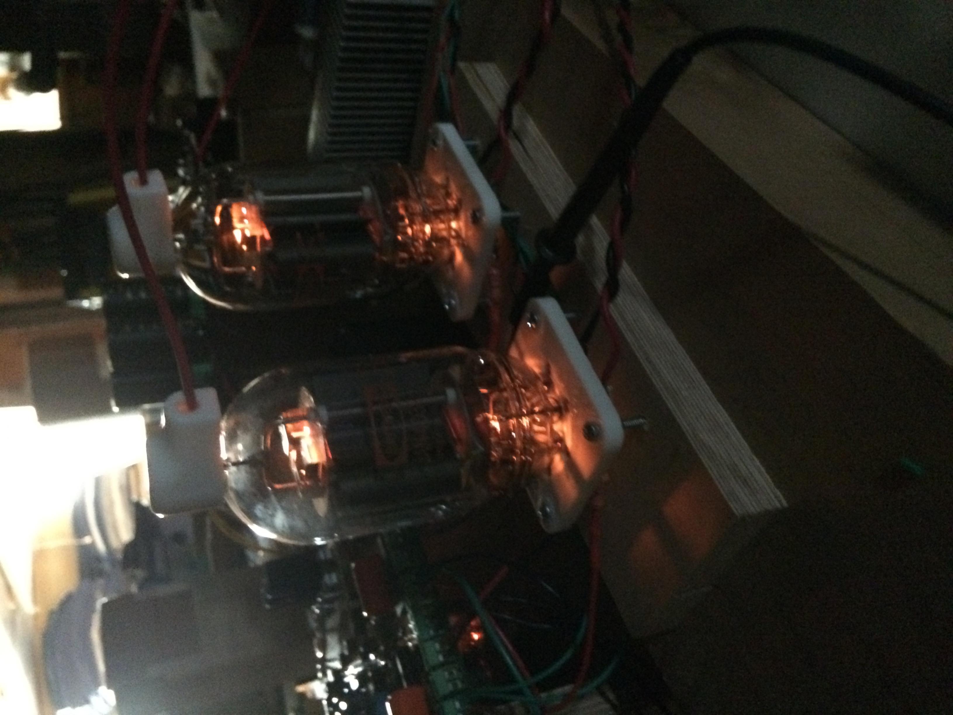

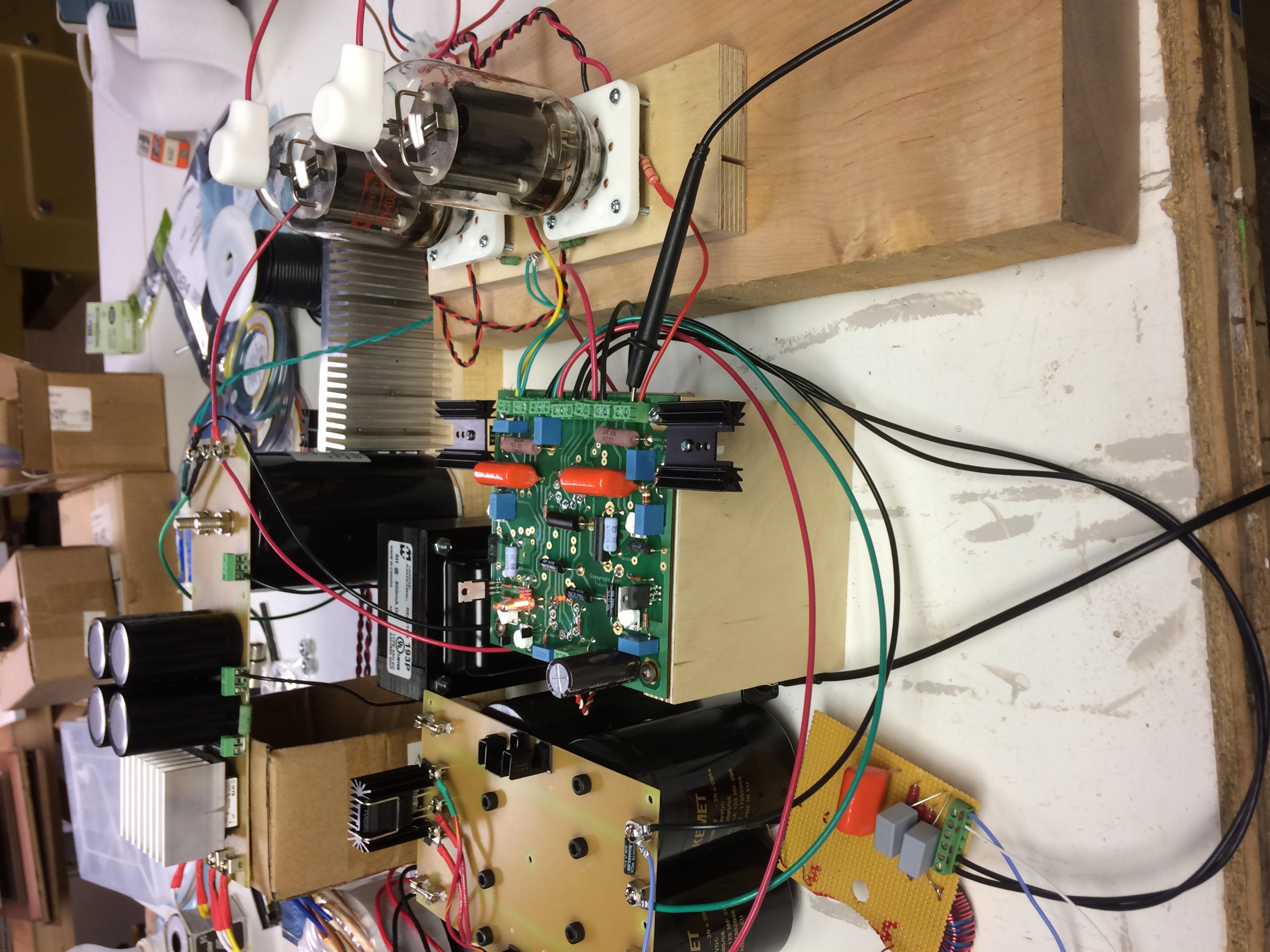

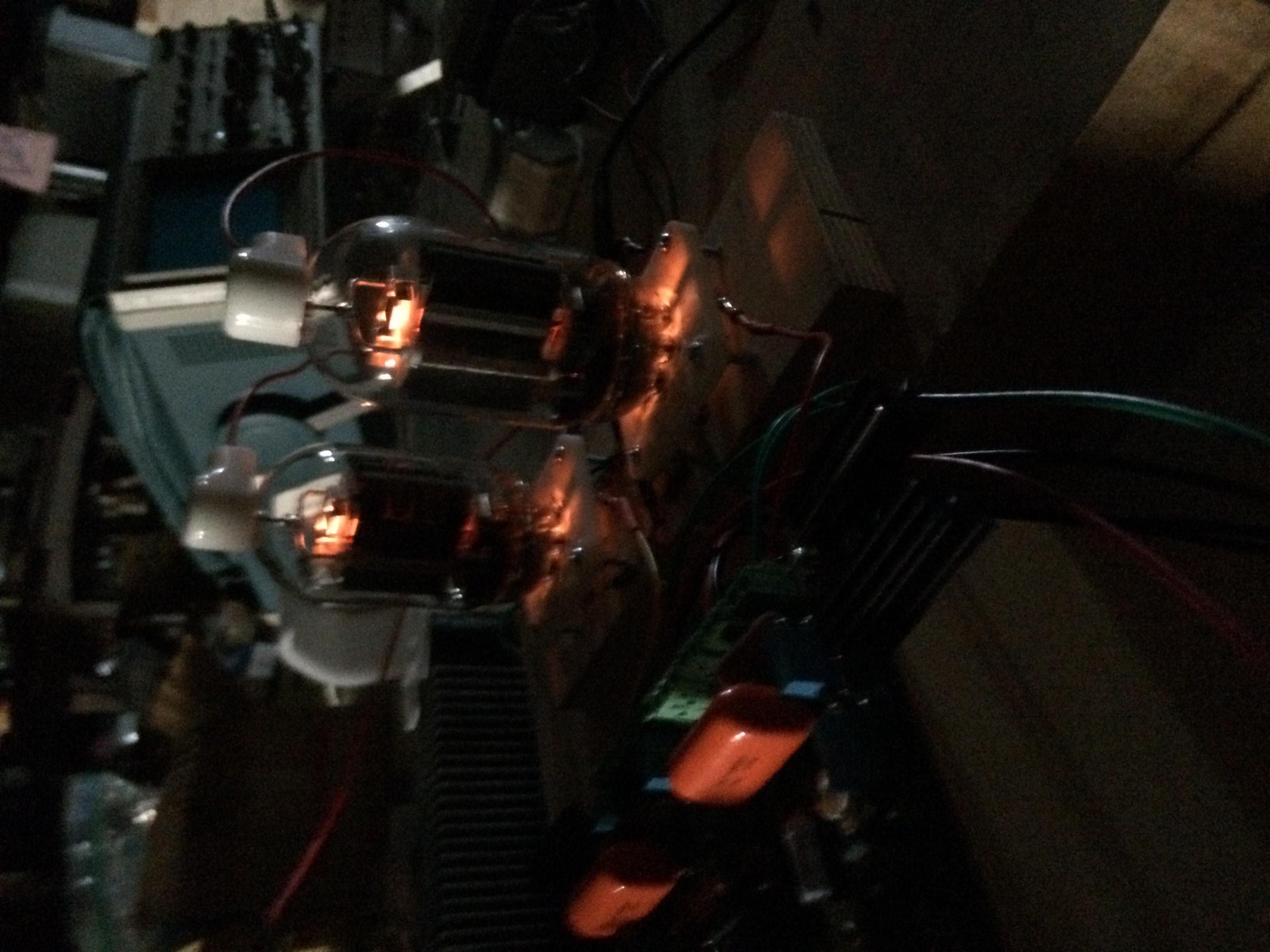

Ok. Neatened up / shortened the wiring. Used 11 ohm grid stoppers and the amp seems to work great. I let it play for about an hour and then took these photos. 10:1 probe 8 ohm load. Note volts/division in the second photo. Oh my...

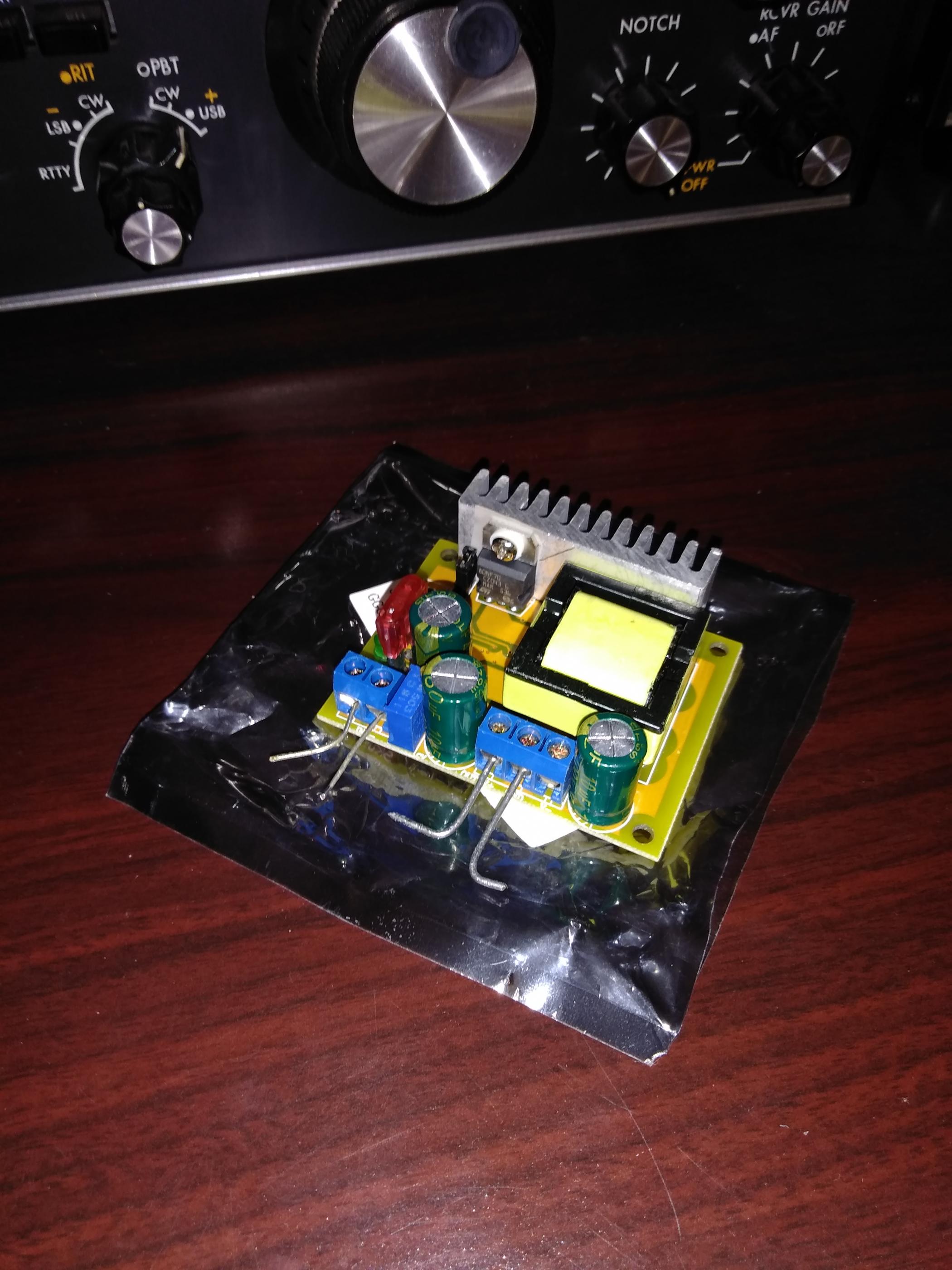

Tubelab_com said:.... To get +/-150 volts, you need two windings. A simple half wave rectifier with one end of the single winding grounded will indeed make +/- 150 volts, but the currents drawn must be equal or the transformer will not be happy. This is especially true with a toroid. The negative supply has about 20 mA extra drawn from it. .....
Could the DC-DC converters that are ubiquitous these days be useful here?
Some have only a positive output, some have positive and negative output, the cost difference is insignificant. I used the one in the picture to supply the entire B+ to the push pull mule. I haven't used the negative output, and don't know if unbalanced current would be a disaster or not. If they work, as cheap as they are, a second module could be used for the negative rail. These are ( were? ) about $6 delivered.
The one in the picture is sensitive to the quality of the low voltage DC input, in a way that I am so far unable to define. It works fine with some low voltage transformers, won't work at all with others for no apparent reason.
I planned on ( edit: trying to ) make a power supply with these, but it's several projects down.

In theory they could be useful, but they would be used to supply the negative bias that keeps things from melting. I would be hesitant to trust expensive tubes and transformers to a cheap module when the isolation transformer is $15 and the associated caps, resistors, and diodes are under $10.
I have already blown up two of these little modules, but neither were the same ones that you show in the picture.

Got both channels working. My klutzy move had taken out the mosfets. Even with the spaghetti madness wiring on my bench the amps are very quiet.
I used one of these modules for the screen supply in a curve tracer and found I had to put a 47uF capacitor on its output.
