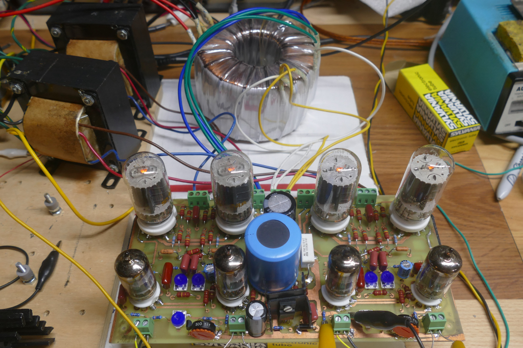

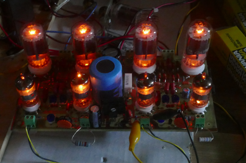

I'm fine. Tubelab has barely paid its bills for the last couple of years, so I took on the paid contract job mentioned above to pay the bills and fund some new stuff that could happen next year. This means that tubes will stay cold for a while, and I may not be here as often as usual. There are two or three amps that are partially completed using these boards, and something new that will develop into some new SE and P-P amp designs.......

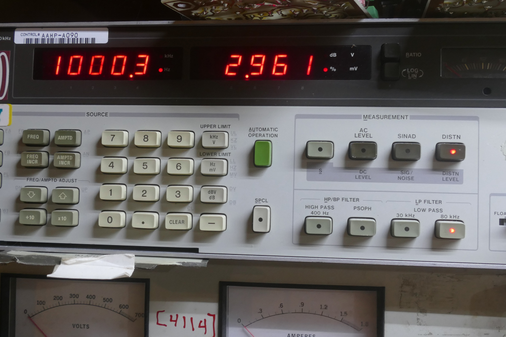

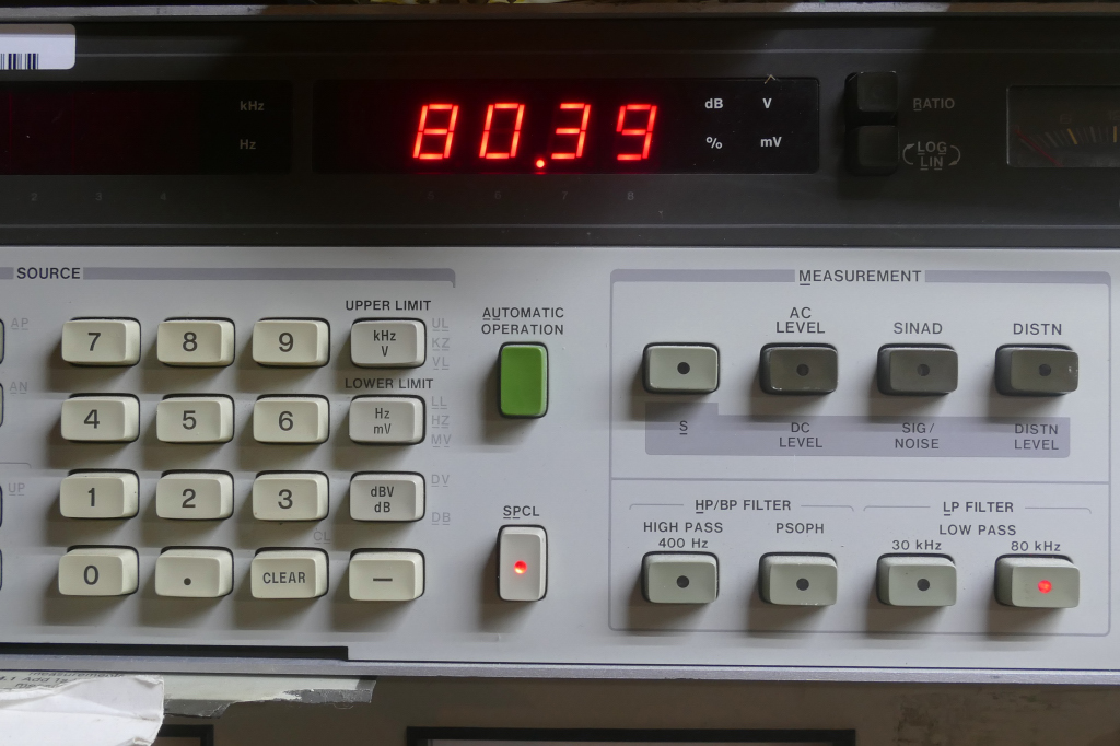

Meanwhile this prototype sits dark on the bench. It makes 50 WPC on that Antek Toroid, and 80 WPC on a regulated power supply. It will likely be a new Tubalab board next year. There is an SE flavor that is in the early perf board proto stage. So far it only exists in simulation.

I ended up buying a set of 60 watt output transformers from Dynakitparts.com and a pair of Classic Tone 40-18069 power transformers. The power transformers can be wired for a good number of B+ configurations and has plenty of current available.
I finally got a chance to play with the driver board again as I'm home taking care of my ex while she goes through Chemo.
I have a 6N23P in the first position and a 6CG7 in the driver position.
I'm not running any feedback
Output is a pair of 6S3P with an Edcor CXPP30-MS-5K opt with a B+ of 350V.
The 6P3S are biased around 25mA for class AB1 because I can't get more out of one position. I think I need to diagnose the bias supply in that channel before I go on.
Best I can do so far is 10Vrms out before clipping with the lowest bias set of tubes I have.
I swapped to a hotter set of tubes (32mA at -37V bias) and got 21W out which is probably getting close to expected.
I can't get Audio Tester to run any more, so I've switched to ARTA.
Changed R26 and R36 from 150K to 60K and got the bias range I think will work for most of the tubes I want to experiment with.
Bias is set at 44mA with 360V B+.
One of my 6N23P has a bad section which was causing distortion problems.
I now get glitches at about a 6.28ms interval that I have to trace down. It is not line rectification related, so I guess it's shotgun time.
I reworked my system ground and think the noise was coming in on mains.
I'm having a bit of trouble getting the bias set on the input stage.
I'm using a 6N1P biased around 115Vak, and Ia about 4.5mA.
I see a considerable difference between the gain of the two stages.
As I adjust R10 to shift the bias balance between the two tube sections, I see the total bias shift in addition to the bias split between the two tubes.
Also I see a shift in the AC voltage on the anodes starting with the higher output shifting down and clipping (plate voltage does not go near saturation), and eventually almost looking like a frequency doubler.
Continuing adjusting the balance R10, results in the reverse sequence with the channels swapping amplitudes.

Well, I don't know why, but attaching the probes and meter clips to the anode resistors of V1A and V1B seem to cause this issue.
If I hook the probes to the anodes of V2A and V2B, I can adjust the setup without the funky frequency doubling.
I am now getting about 1W out of the 6P3S with 0.66%thd. Nice waterfall drop off with frequency.
I still am not running any feedback.
Typical distortion with a 6DJ8 driving a 6CG7.
I get pretty much the same distortion profile with either 6DJ8, 6N1P or 6N23P as the input tube.
The only adjustment I need to make is the balance to get the output tubes close. If they are out by more than +/-2V (typical 220V at anode) distortion goes up rapidly.
The garbage at the bottom is power line related, this is spread out on a bench with a lot of leads to pick up radiated noise.
I guess my next work will be with feedback.
