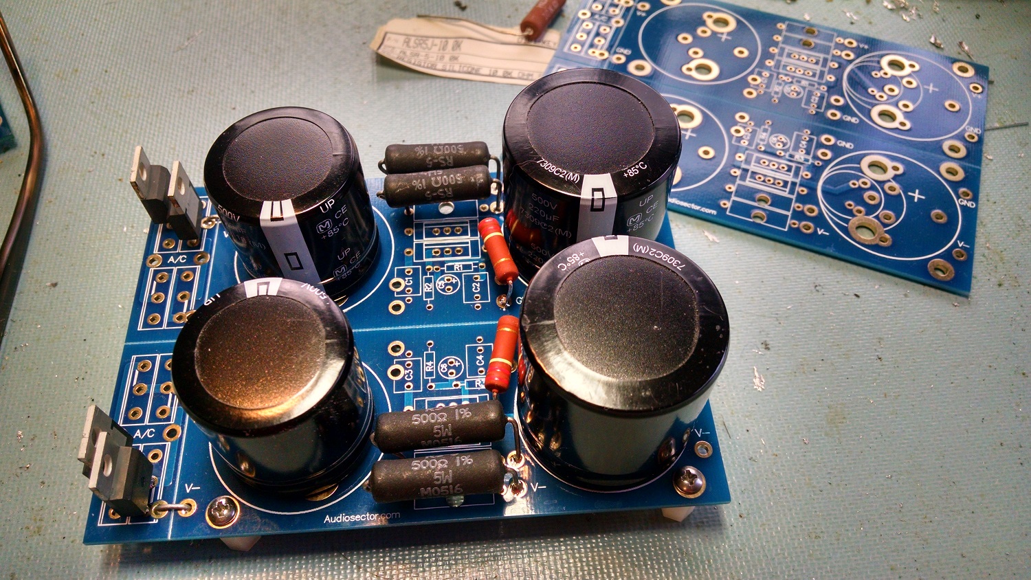

So I've got the various boards built and tested....
For the B+ and MOSFET +/- supplies I used some Peter Daniels (audiosector) power supply PCBs I had stashed. The boards and mirror imaged and set up for bridge rectification for SS amp supplies. These works great for the MOSFET supplies.
For the B+ supplies they are both wired for B+ and full wave rectification...and the creepage clearances look reasonable. The present plan is to make mono blocks and snap these apart..one in each amp.
I have a pair of the power transformers shown below and a pair of Triode PA060 transformers. I also have a pair of 4A Hammond 6.3V CT filament transformers. I would prefer to use these power transformers but unfortunately these power transformers only have a 12VCT filament supply....can I successfully use this to power the 6CG7 filaments? ......say by grounding (or biasing up to 75 volts or so with a B+ voltage divider) the CT and connecting the ends of the winding to H1 and H2 and not connecting anything to H3?..not quite clear on the filament windings.....
I'm also assuming that I need to ground MOS-2, DRV1-2, DRV2-1 and B++-1 to a signal ground along with the ground side of the inputs.
If you mean pins 12 and 14 when you say "ends." NO, don't do that you will feed 12.8 volts to the 6CG7's making them very unhappy.
The transformers you have are fine for powering up one mono block each. I can think of a few ways to do this, but let's go for the easiest. We are going to power up driver heaters with one half of the winding, and the output tube's heaters with the other half.
Each half supplies 6.4 volts at 4 amps. The driver board needs 1.2 amps (2 X 600 mA) and the output tubes need 3.2 amps (2 X 1.6 A), so there is enough power for all the heaters. Look at this as two separate 6.4 volt 4 amp windings. They just happen to be connected together which is not a problem here.
Connect one end of the winding, pin 12 to H1.
Then connect the CT, pin 13 to H2. That will supply 6.4 volts to the board to light the 6CG7's. Now connect the CT (pin 13) also to either pin 2 or 7 on BOTH output tubes. Also connect the CT to the resistive divider that elevates the heaters to about 70 volts. It is usually good to put a capacitor across the resistor in the divider that goes to ground. It helps cut hum. I use .33 uF 250 volts because I have a big bag full of them but anything over .1 uF and 100 volts is good.
Connect the other end, pin 14 to the other heater pin (2 or 7) on BOTH output tubes.
It is usually best to run a separate pair of lightly twisted wires from the transformer to the driver board, and to each output tube. You can chain the output tubes if your wire is good for 4 amps.
All of them are connected together on the PC board. Electrically only one of them needs to be connected, but I find that this method eliminated ground loops and hum:
Run a piece of shielded cable, or a twisted pair of wires from the input connector on the board to the input connector of the amp. Make sure that the ground side of the input connector (IN 2) goes to the ground side of the input connector.
Run a wire from MOS 2 to your +/- 160 volt board's ground connection. This
Run a wire from B++ 1 to your B+ board's ground (negative) connection.
You will need a method to measure the current in each output tube for setting the bias. I put a 1 ohm 2 or 3 watt 1% resostor in series with each cathode. Measure the DC VOLTAGE across this resistor, them 1 mV is equal to 1mA. Set the tubes to the desired idle current by adjusting the corresponding bias pot on the board. Somewhere between 40 and 80 mA (mV).
Connect one end of the 1 ohm resistor to pin 8 of the KT88. Run a wire from DRV1-2 to the other end of this 1 ohm resistor.
Repeat with DRV 2-1 and the other KT88.
