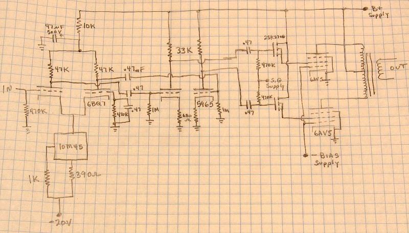

UD build questions (1j KT-88s uL & (2) 6AV5 Drive
I have a handful of Universla Driver (UD) Boards coming from George.

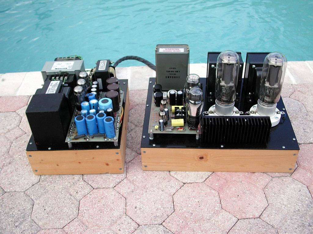

Won’t be starting in them for a little bit, as I have one TSE-II monoblock on Final Approach, and the other one kitted. Oh, yeah, and an 80% finished Pete Millett monster power supply.....
Damned ADD.
HOWEVER, wanted to ask some UD questions EARLY, while I’m still checking inventory for a Mouser order, and to give y’all some time to COGITATE.
(1) Suggested operating points for a UD KT-88 running in Ultralinear?
I don’t need earth shattering wattage as (a) I am a pensioner who startles easily, and (b) all my speakers are well north of 90dB/W (and a couple pairs would have to get new tweeters over 12 watts). 30-40 watts, clear as a bell, with “did the earth move for you too Little Rabbit” bass would be fine.
(2) Operating points for SCREEN DRIVE 6AV5s, plus OPT suggestions?
See ancient George schematic sketch attached (which is remarkably close to how the “2015” UD looks, BTW)
I have been haunted by this sketch for better part of a decade, so want to do something about it while I still can. Any suggestions/advice/words of warning (e.g. where to put the FUSES) would be welcome.
BTW, I have Two Sets of unused HANDWOUND push-pull OPTs; I believe I was one of the “lucky” ones that actually received what I ordered from David Lucas, Prince of Darkness (no, wait, that was JOSEPH Lucas, sorry), but of course only after filing a Mail Fraud complain with the USPS...
One set is nominally 60W 6600 ohms, which I suppose could be 3300 ohms if I put 8 ohm speakers on the 16 ohm tap (I think I remember that right...)
It would be nice to use the damned things after all these years, assuming they don’t make big sparks and disappear in a cloud of smoke. The Handwound SE OPTs I’ve used have been quite good, so fingers crossed.

Title should say 6AV5 SCREEN DRIVE, but I fumbled.
At one point, the 6AV5 was The Tube We Dare Not Speak Its Name; Judging from the still-moderate prices on FleaBay, I assume that that caution has abated. If not, mea maxima culpa.
So your requirements went from 1 MILLION WATTS, to 30-40? Well that's a bit easier. At power levels below 50 WPC I would use conventional control grid drive pentode operation on a 6AV5 to avoid blasting the screen grid, or triode wired KT88's. Some feedback will be needed on pentode mode operation, and a bit more feedback is needed for screen grid drive to keep the output impedance of the tubes down. This is important with less than stellar OPT's.
75 watt per channel triode mode tube amp prototype - YouTube
Fuses should be placed in the cathode lead of the output tube, unless you have fuses rated for use on 600 volts DC. An ordinary 250 VAC glass or ceramic fuse will explode when it sees a short on DC current. I learned this the hard way. A fuse in the cathode should cutoff the tube before the voltage gets high enough to explode the fuse.....except in a tube arc.

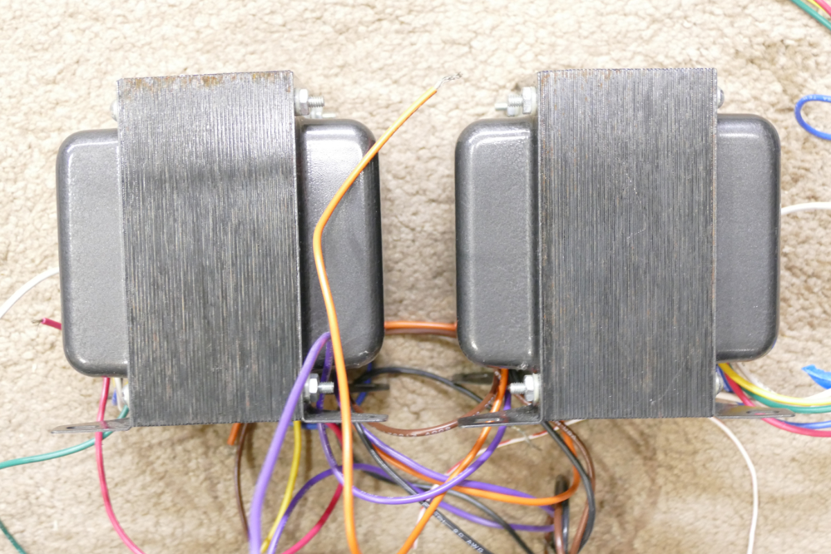

I got two sets of OPT's from that con artist before he blocked me from bidding on his Ebay auctions because "I loose moiney on you."
I threw minimum bids on several of his auctions, won a pair of "10 K ohm SE OPT's for 211 or 845 tube." These are actually better than Hammonds 1628SE (not SEA) were at the time. They are in my 845 SE amp which is still in storage. The other win was a pair of 60W 6600 ohm P-P OPT's, probably like yours. I tried them in a SPP amp, and in the push pull KT88 amps that I was making at the time and they were no better than the smaller cheap Shumaker guitar amp OPT's that I have lots of.
I did drag them out of the box of dead projects for some torture testing recently, but haven't fired them up yet. 3300 ohms with an 8 ohm load on the 16 ohm tap works great on the Schumakers. Don't think I tried it on the Lucas bombs. I have two sets of 3300 ohm 100W Edcors, so that's what I'll put in my amps.

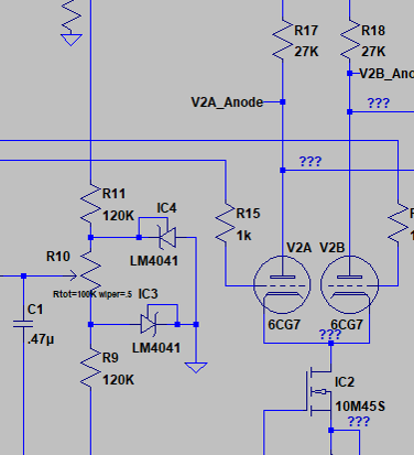

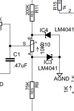

UD Board Questions: Feedback Wiring, LM4041, etc
I'm fixin' to build-out one UD board, and breadboard it with 6L6s in Ultralinear to wring it out before I cut wood & steel.
Not that I'm particularly fond of the 6L6 family, but
(a) I have a good number,
(b) I have a wide variety , from Sovteks and Shuggies to NIB OEM USA 5881s and 6L6GCs,
(c) they work pretty well in UL, which I like & which obviates need for a screen supply, and
(d) I have a good sampling of 6L6 OPT iron, including ONE hulking OPT from a Heathkit 4AM amp. Which is to say, several SETS of OPTs, albeit nothing capital-A Audiophile.
I'm making a Mouser order for the bits I don't have.
Questions:
(1) LM4041 Shunt Voltage Reference
The schematic shows a Zener-like symbol for the two LM4041s (ie TWO leads and a cathode indicated) but the data sheet reveals that the LM40401 is a TO-92-3, ie THREE leads including anode, cathode, and a feedback lead.
Do I assume correctly that we're using the anode & cathode, but NOT the feedback (FB) lead?
Is there a Zener which would substitute? Oops, Output Voltage = 1.225 volts; don't know if there's a discrete Zener with that rating, and if there is, I don't have one anyway. Never Mind.

Addendum: just noticed that in 2015
(in the related 6L6GC AB2 thread; 6L6GC AB2 Amp)
that George mentioned eliminating the LEDs in the offset adjustment circuit and substituting a TI voltage Reference IC (presumably the LM4041); the 1.225V Output Voltage makes good sense in the LED context.
SO, can somebody please confirm that I use only the (+) and (-) pins, and NOT the FB pin on the LM4041?

My schematic, which is actually an LTSpice simulation, has the LM4041 as a 3-terminal device.

1) The LM4041 devices have three pins, and should be inserted in the board according to the silkscreen. The feedback pin has no connection in this application. These have a well defined temperature characteristic, which cancels in this application, keeping the offset voltage constant over temperature. The previous LED's wandered a bit when warmed up.

The pots are used to set the gate voltage on a mosfet. This becomes the bias voltage for the output tubes.
The resistor values shown on the schematic were chosen when I was using the UD board for a screen drive experiment. The bias voltage was always POSITIVE, and not what you would use on a typical UL amp.
In the typical G1 driven triode / UL / pentode mode amp the bias voltage would be adjustable over a range of negative voltages. The values of the resistors connected to the pots determine this bias range and are tube dependent. In any case the resistor values are chosen such that about 1 mA or less of current flows through the pot, given a bias adjustment range of less than 100 volts. This would subject the pot to less than 100 mW of power making even a 1/4 watt pot suitable.
