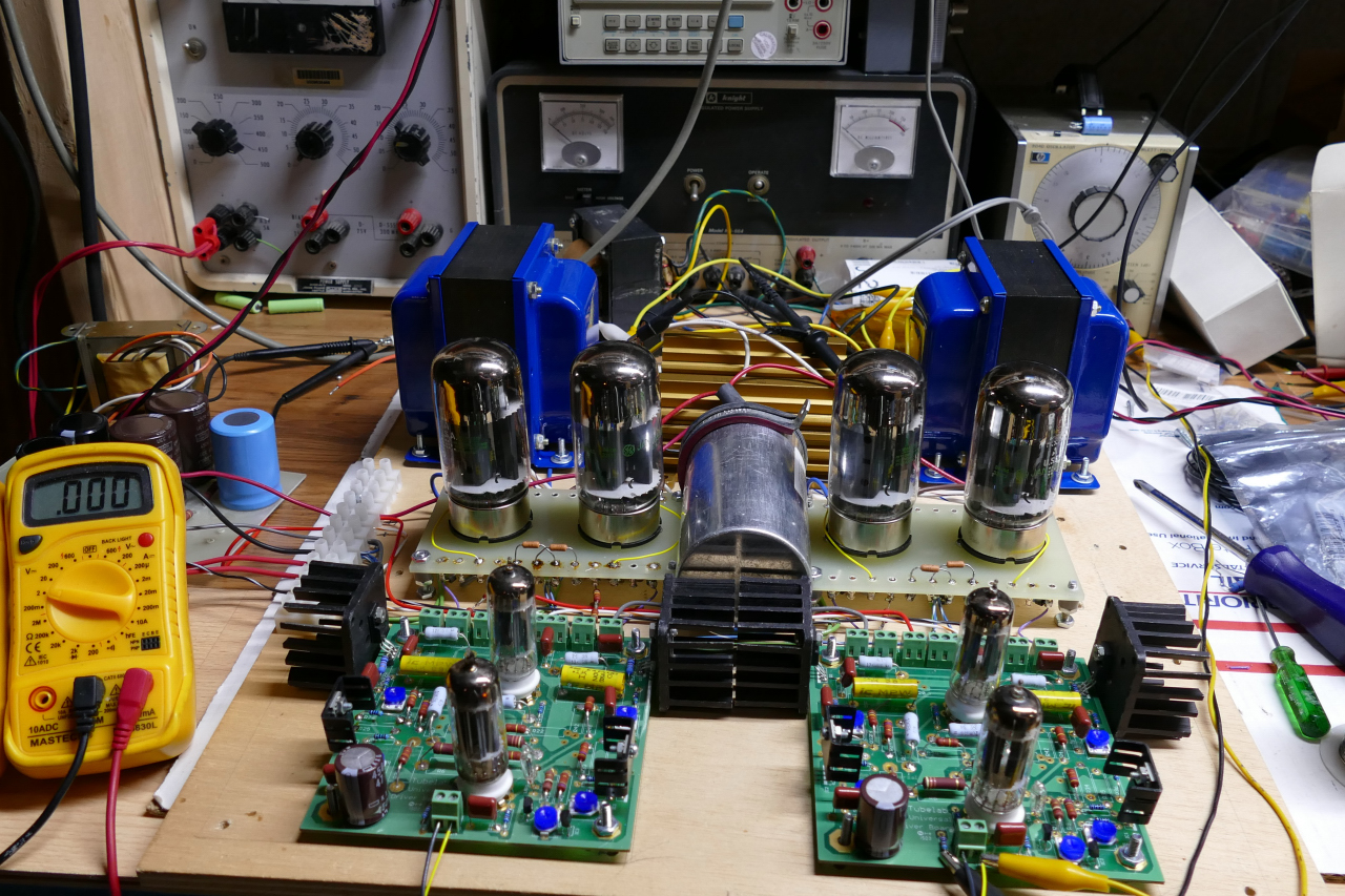

The board pictured throughout this thread is available as stated in post #29. I got them made in 2015 and moved before ever opening the box.
I fired one pair up in late 2016 when I was building my new lab, but got derailed and never got back to them until late 2017. That post caused all 32 remaining boards to disappear, so I got another batch made. There are about 55 of them left, and they are available for order.
What's not available is a full detailed set of build instructions. I have some other commitments that will keep me busy for the next couple of months, so not much new info will be coming from me. If you feel that you can build something from the info in this thread, then order them.
I will get a set of full instructions for this board and the new TSE-II up on the web site as soon as I get free to make them.

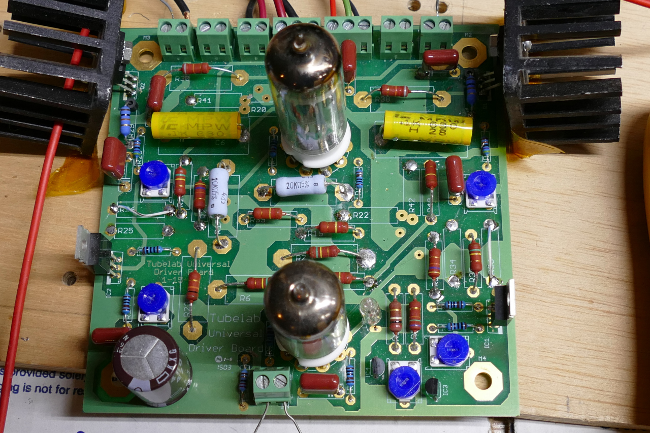

MOSFET source resistors
After a couple of years of working on other people's projects I've finally got around to my search for an output stage for my Universal Driver Boards.
WRT the MOSFET source resistors, R30 and R38, the original BOM, which I've attached for ease of access, stated:
"Sets the idle current through the MOSFET. You want 10mA to 20mA at idle, less if there is a secondary current path like a screen grid"
Given a secondary current path, like a screen grid, how do I work out the value of the resistors?
I'm currently running ±150V MOSFET supplies with 12k resistors which gives me a current of 12.5mA with ~2W dissipation in both the MOSFETs and the source resistors.
In my simulation at least, reducing the MOSFET idle currents doesn't have much impact on the load distortion. I haven't played around with the source resistor values in my test board yet because I don't maintain a large stock of 2+W resistors.
Interestingly, the original schematic (also attached) showed 82k source resistors. Assembled PCB picture too.

The Gm in a mosfet will change with the current through the fet. Some mosfets can emit a burst of high frequency oscillation at turn on or turn off if they transition through cutoff during an audio cycle. This can also occur if the load on the mosfet goes through a rapid change in impedance, such as a control grid transitioning through zero in an AB2 situation. It is desirable to keep some current flowing through the mosfet at all times, even if the tube it's driving is cutoff.

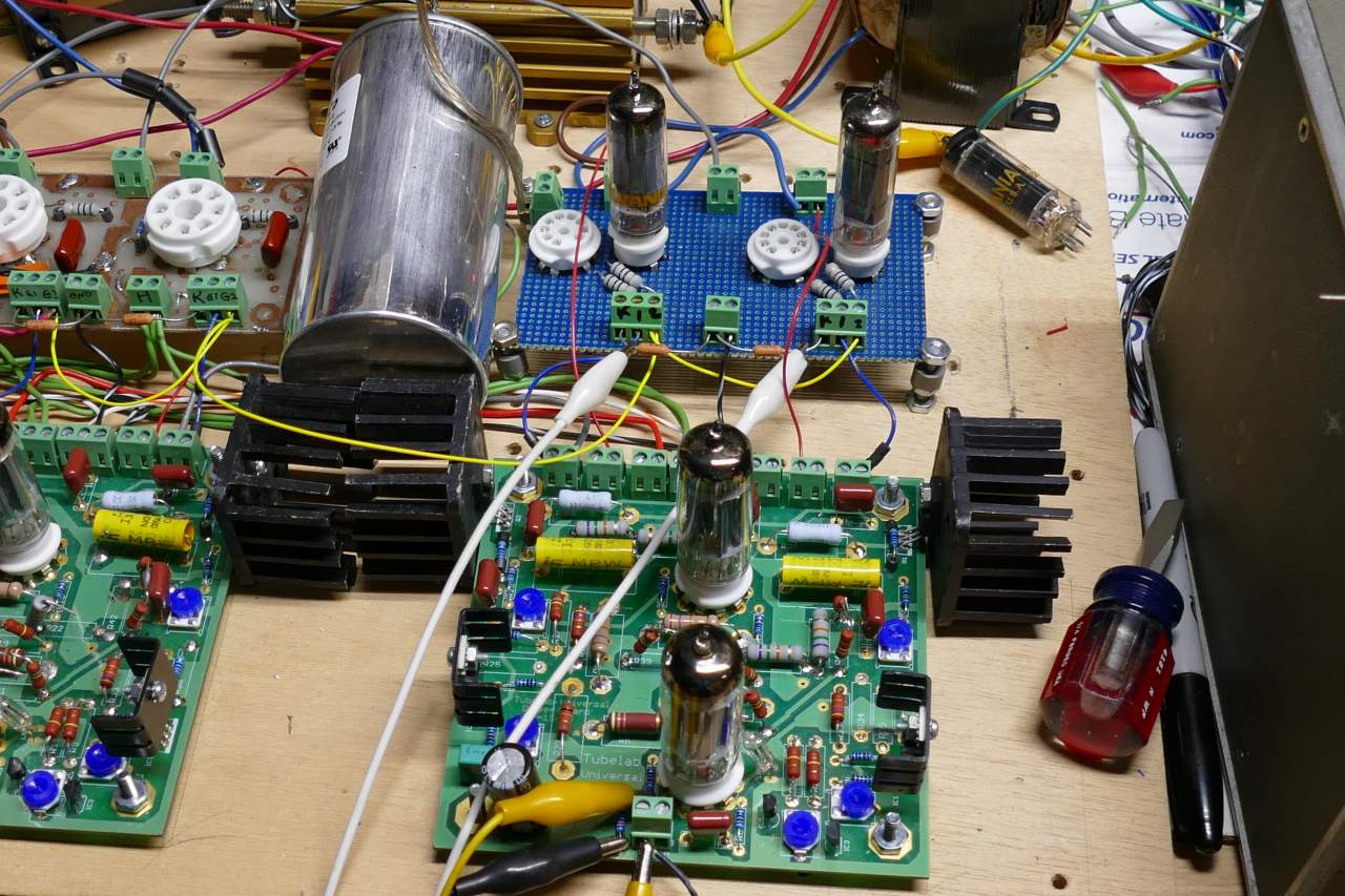

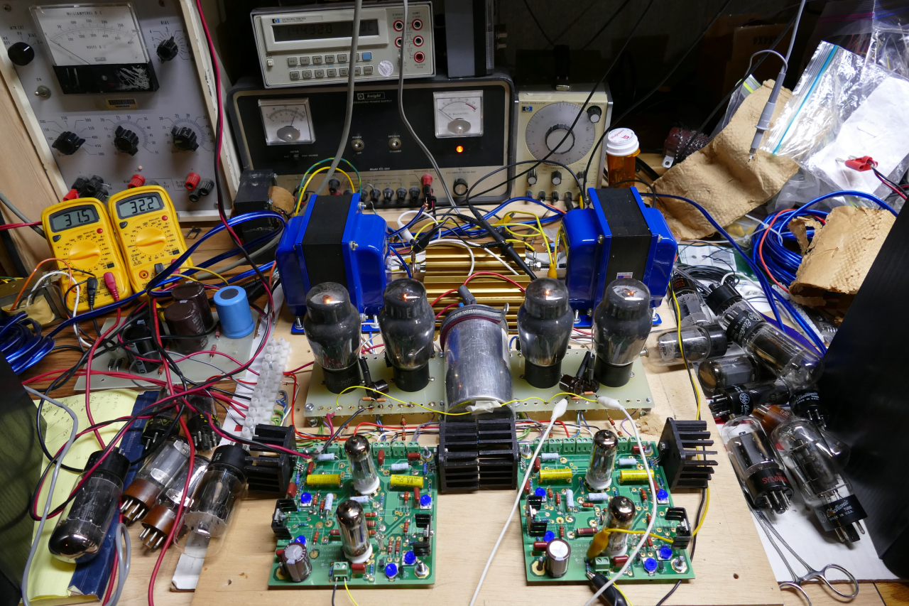

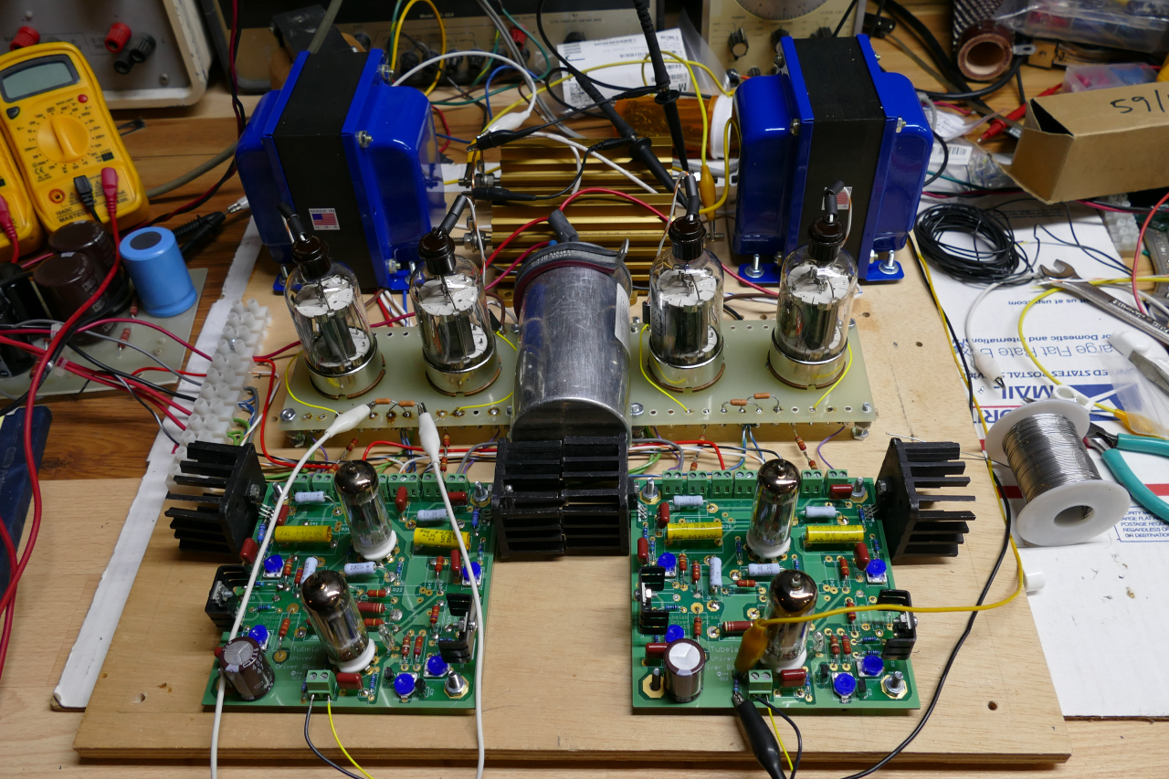

I was doing a lot of high power screen drive experiments with this board and it's predecessors. Here the screen voltage is driven highly positive (+250 to 300 volts) during peak current on the driven half cycle. It will swing almost as far negative when the other output tube is at full conduction. To avoid the condition of mosfets switching on and off, I tied that source resistor to a negative 400 volt supply, hence the 82K resistor. Note all the unusual jumpers in the first picture. The bias was adjustable from zero to a POSITIVE volt age in the 100 volt range for screen drive.
When I transitioned from screen drive experiments to conventional G1 drive the 82K resistors came out, and 12K 3 watt Panasonics went in. They were carefully chosen for the criteria of "I have a big bag full of them." Many other parts were changed for a negative bias voltage at idle.

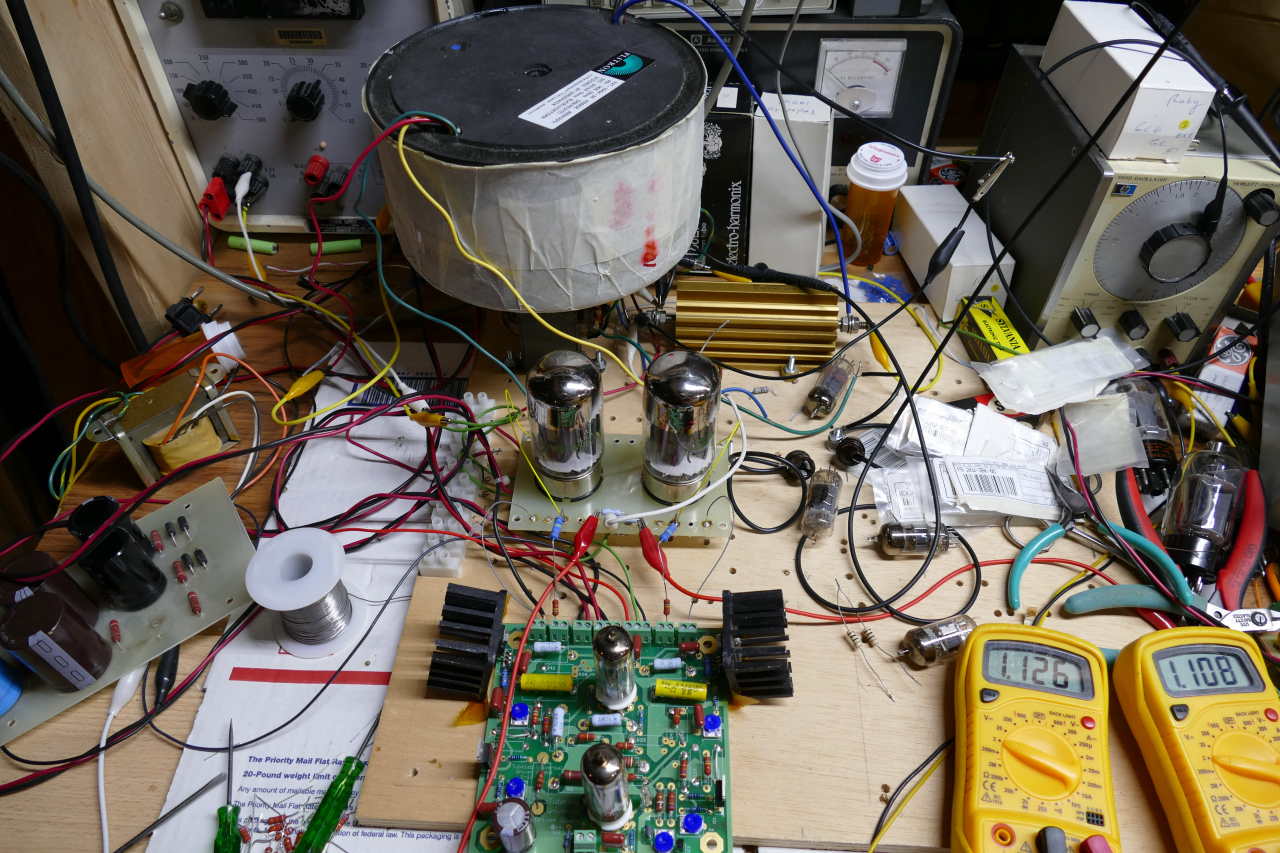

This test setup is the one that I have been using to test lots of different tubes in ordinary G1 driven AB1 and AB2 push pull. It uses a +/- 150 volt supply made with an isolation transformer. The source resistors seen in three years worth of pictures are those blue 3 watt 12K Panasonics. I have found no reason to change them despite feeding everything from tiny 50C5 radio tubes to big fat transmitting tubes. If I needed to deviate from the +/- 150 volt mosfet supply, I would change the resistor accordingly.

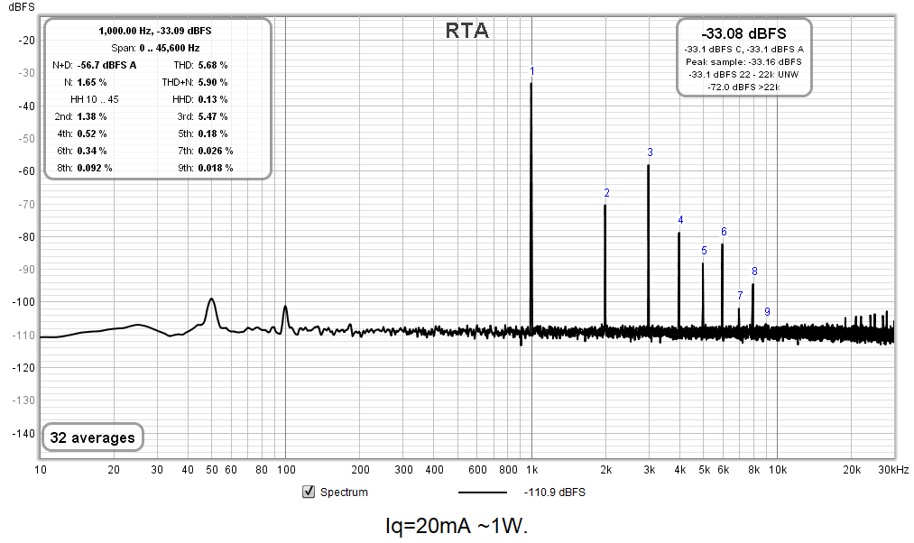

I'm doing some THD vs power measurements on a pair of 6HJ5s in crazy drive configuration with 500V HT and ±150V.
With 12k source resistors in the simulation at least the driver tubes start to clip long before the MOSFET current gets below 7mA. I can offset that by changing the operating point of the driver tubes.
I have to say that even at 1W, the simulation suggests THD for this configuration of ~7% and that's about what I'm measuring.
I'll play around with the Rg2g1 and Rg1 to see if I can improve the situation before moving on to evaluating other output stage configurations.
I'm not keen on going to 600V+ HT as others have suggested for screen drive.
