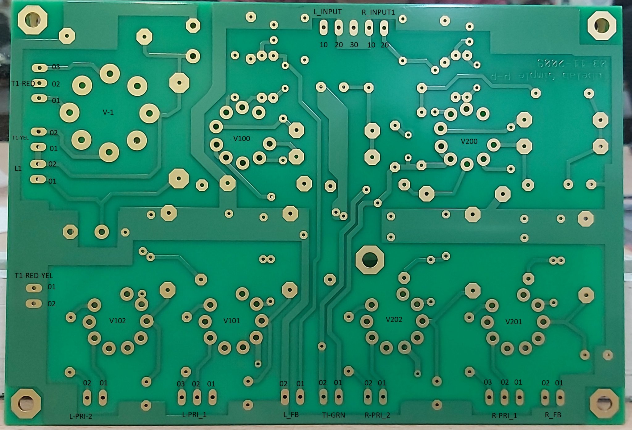

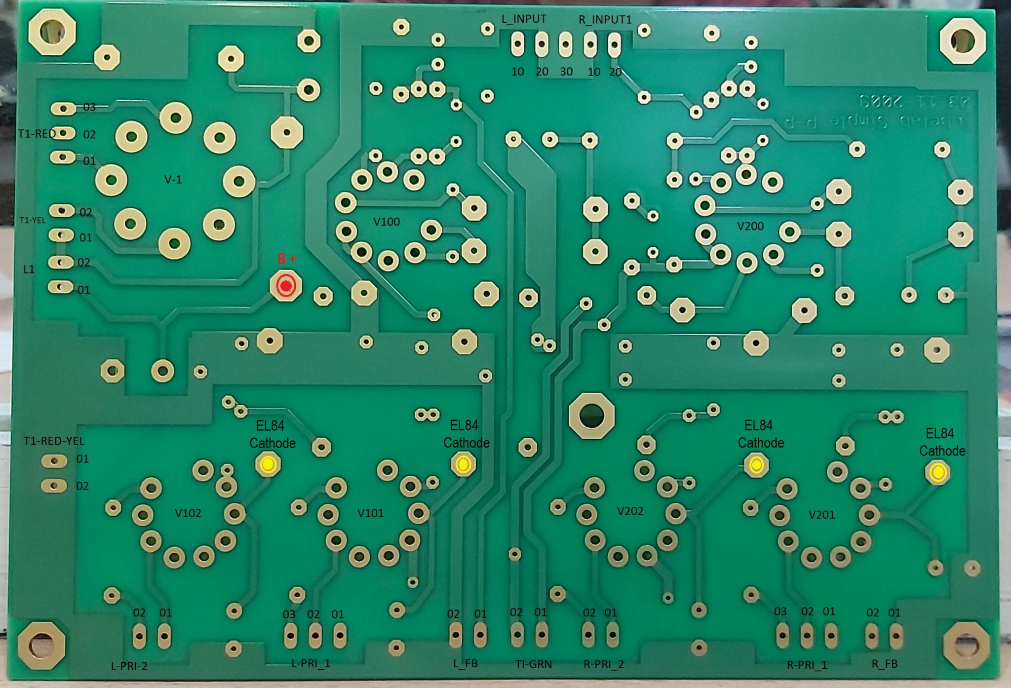

Maybe of help to some.
All connectors labelled as per Tubelab build.
B+ measuring point labelled & coloured Red.
Also the EL84 Cathode measuring points coloured Yellow when checking the bias calculations in http://wallofsound.ca/wp-content/uploads/2020/02/Part-5-Attachment-2.pdf

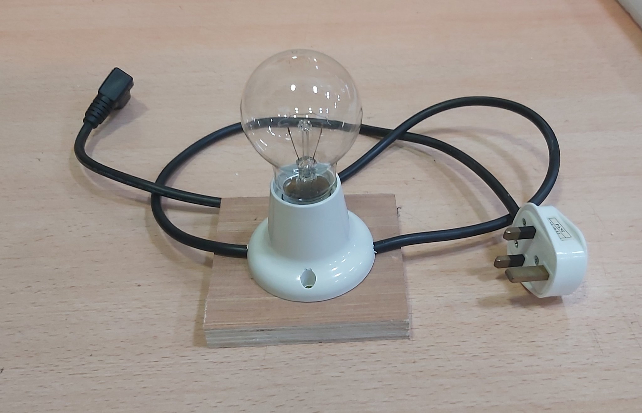

Again thanks Steve for your support and valuable replies. I've actually fitted 300 ohm's. I think i'll be using the in-series light bulb when i get around to the First Power Up.Calpe,

Sorting out my in-line 100w bulb instead of a variac...

A good description for powering up.

Before that I always check for short circuits, both heater and B+ circuits. After that I always do a power up without tubes (electrolytic caps must handle the full peak B+), and measure heater voltage on tube pins, B+ rail, plates etc. At no load everything should be close to B+ peak.
