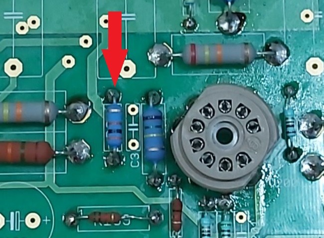

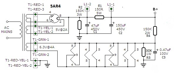

Of course this should be gospel http://tubelab.com/designs/tubelab-spp/parts-list/
C1 47uF 450v
C2 150uF 450v
R2 150K 3W
R3 10K 1W
R4 150K 2W
C1 47uF 450v
C2 150uF 450v
R2 150K 3W
R3 10K 1W
R4 150K 2W
For R3 30K should be used instead of 10K.
This picture also seems to have 30K installed.
How was the CL installed? Photos?

R3 has a 30K fitted.
Post #393/394/395 - Thank you.
I needed for self satisfaction to double check components just to reassure myself that the power supply components were all correct.
These included: -
R1 (actually now a choke), R2 - 150K, R3 - 30K, R4 - 150K
C1 - 47uF 450v, C2 - 150uF 450v, C3 - 0.47uF 100v

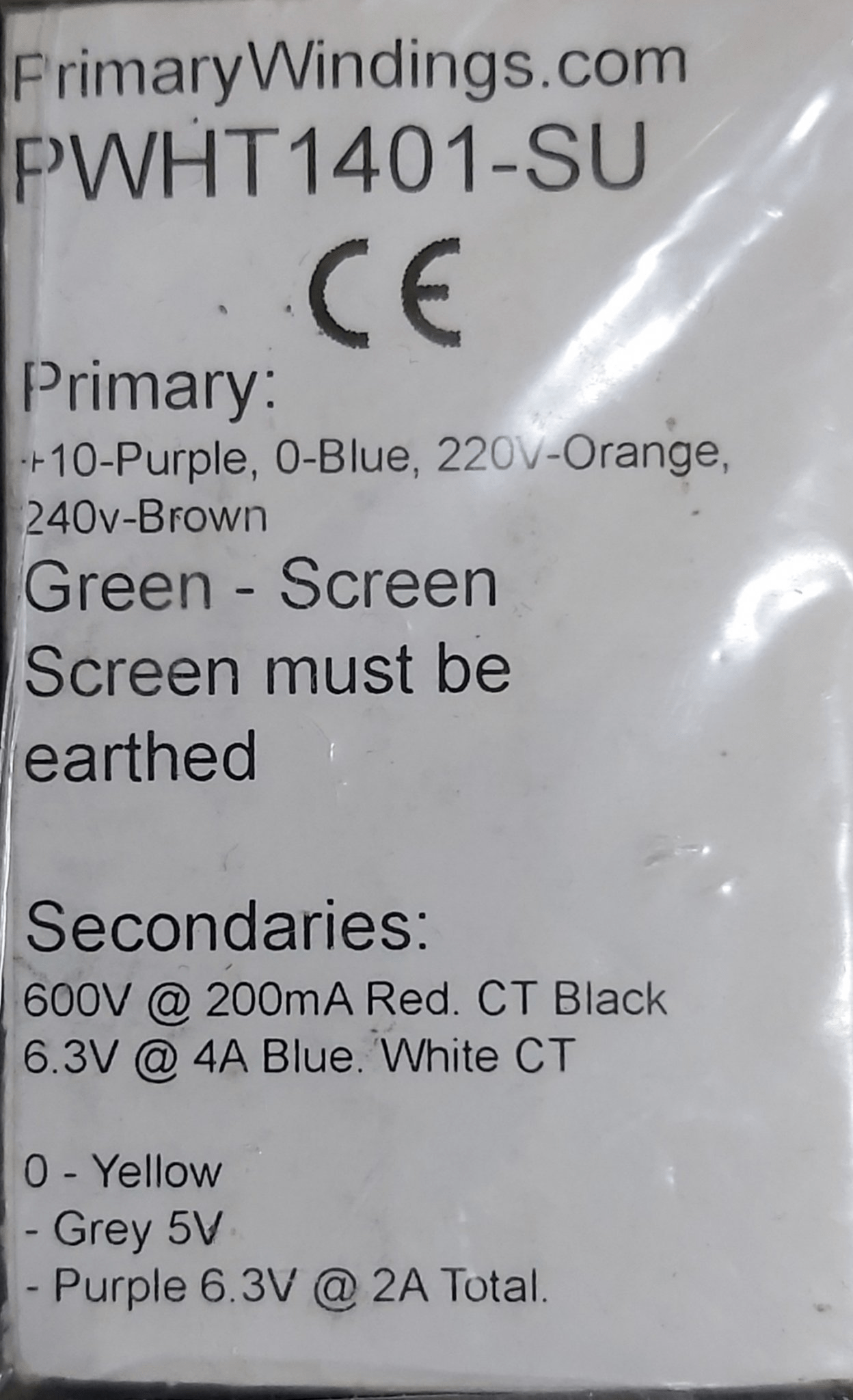

My Mains Transformer, if wired for 240v, is shown below.
But as the 240 is never that, but closer to 250 (actually measured yesterday with a Fluke), the measurement i got was 248V. 😡
I assumed pushing 248 into a 240 winding would give me slightly higher secondary voltages, something i didn't need.😒
So i wanted to play safe and wire it for 250v.
What connections should be used?😕
Clearly somewhere out there will know.😉
Anyway i contacted Primary Windings U.K. and it appears that they have had numerous people asking about the wiring for either 220, 240 or 250.
I leave this open for the clever people..........
I now know.......😎
Code:
Power Transformer Primary
220V - Blue / Orange
230V - Purple / Orange
240V - Blue / Brown
250V - Purple / Brown
