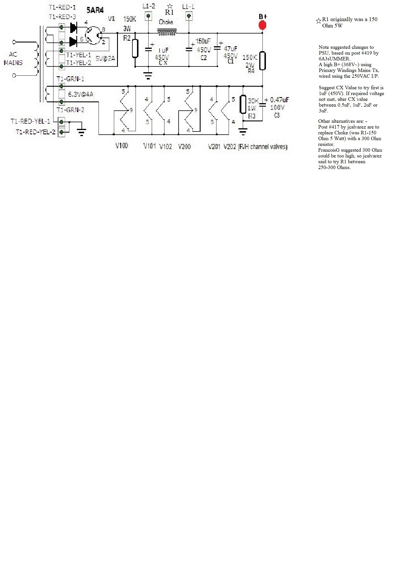

Ive been uploading schematic, but of course i've never specified the exact components fitted, but yes they are 300 ohms.
I've been thinking (strange for me!) that R1 (150 Ohm 5 Watt) was suggested to be changed in order to 'remove' any remaining PSU noise.
Perhaps wiring in circuit a 150 Ohm 5 Watt, to begin with, check the B+ and if needed increase the value closer to what jcalvarez has suggested?
If in the original design R1 is only a 5 watt, increasing the wattage to a 25 Watt seems a bit high?

How does the circuit of R2-150K, R4-150K and R3-30K effect the B+?
Could these values be altered to lower the B+ ?

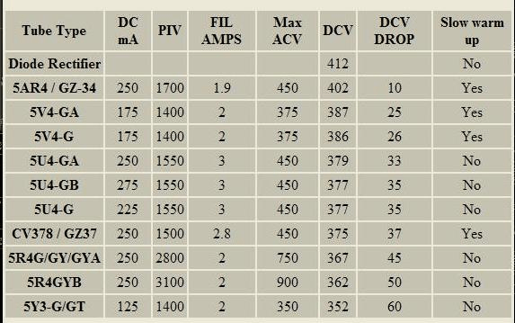

The rectifier and the choke both have internal resistance, therefore some voltage is lost (dropped) across them:Bad news to read. Would you kindly enlighten me about "low voltage drop rectifier (5AR4) and a choke with probably low DCR"
Different rectifier tubes have different internal resistance, therefore the voltage lost in the rectifier varies. It happens that the 5AR4 has a very small internal resistance, therefore the voltage lost is very small.
It is a similar situation with the choke. DCR is Direct Current Resistance, basically resistance due to the fact that a choke is a long wire. That resistance means there will be a voltage drop across the chole when you apply DC current. Chokes with relatively small inductance like yours tend to have a low DCR, less voltage drop. But I do not have details for the choke you got.
Back to the 5AR4, there are tables around the net, not sure how accurate they are:

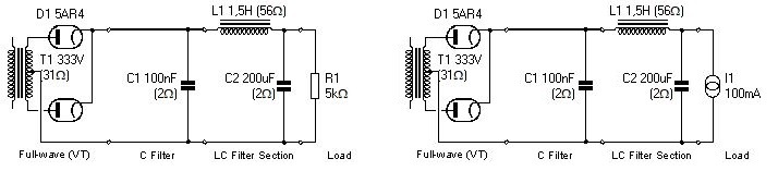

I tried the suggestion of 6A3sUMMER in PSU Designer II with different values.
I got the biggest voltage drop at C1 with a capacity of 1.5µF.
A change from C2 to 150µF did not produce any significant values.
Code:
PT sec. 333V / L1 = 1.5H 56 Ohm / C2 = 200µF / R1 = 5K Ohm

PT sec. 333V / L1 = 1.5H 56 Ohm / C2 = 200µF / I1 = 100mA

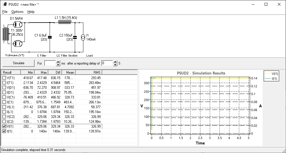

Thank you jcalvarez. From your tests C1 would need to be changed to 6.8uF (450V) and C2 to change to a 150uF (450v) to obtain a B+ of 327v ?Load of 140mA assuming 35mA per tube, 327V B+ with a 6.8u cap
u View attachment 1148772

C1 is still mounted before the choke. So this i will need to fit after the choke in parallel with C2 150uF 450V?
Or will i need to change the value of C2 to a 200uF 450V (C1 + C2=200uF) ?
ex-R1 needs to be a 5H 200mA choke? A Hammond 193H.
C1 will need to be tested using values between 0.5uF and 4uF?
With many thanks
