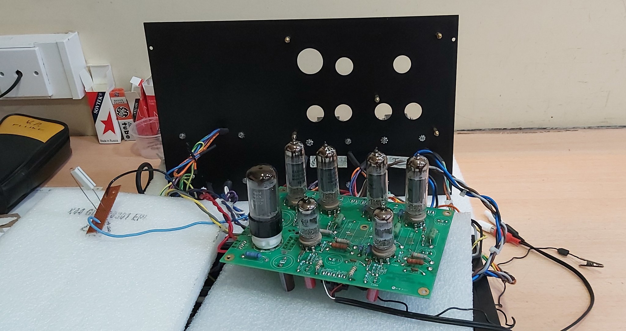

I've already ordered a range of spares including a CL-80....@OldHector and @6A3sUMMER

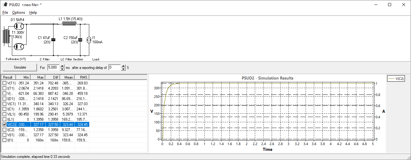

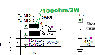

@calpe,
Based on the PSUDII simulation you will need a 100 ohms (3 watts) in each secondary leg of the the power transformer. A NTC Thermistor in series with the primary will likely knock off the 1-3% excess voltage on the heater supplies, which are already very close. This should bring you B+ to within the acceptable range around 330Vdc.
I would try this first and expect all will be well. If the B+ is still too high we will look at further measures, like increasing the resistor pair to 110 or 120 Ohm (save shipping and order with 100 Ohm pair), or a resistor in series with the choke as previously discussed. Additionally you may consider another Thermistor (CL-140) in series with the power transformer center tap to earth, as George discussed in the linked post. Note the sizing of the Thermistors. George recommends CL-90 for ~240Vac service.

More seriously, the Amperex data sheet shows specifically that a resistor in each diode lead is required to make up the “minimum resistance”. The only reason I could think of is that there is slightly better load sharing between the two diodes, compared to one resistor in the centertap. Or is there?A pair of 100 Ohm 3 Watt resistors, one in each plate lead . . .

Stupid mistake, here is with the 5AR4. You were right there with the 100 ohm value:
I was pondering why @calpe was actually measuring a B+ of 369Vdc, while the simulation above, with the addition of only the parallel pair of 100 Ohm resistors, shows a reduced B+ of 324Vdc. As was pointed out before there could be differences between what PSUDII predicts and the actual measurements, but this difference seemed more than I expected.
I’m afraid there is another mistake in this PSUDII simulation that went unnoticed. The transformer secondary voltage used in the simulation was 300Vac, but we know @calpe’s transformer gives 310Vac. Contrary to what the simulation says I expect the pair of 100 Ohm resistors will most likely not lower the B+ enough. Additional work might be needed to drop it further. The simplest is probably as 6A3sUMMER suggested - put more resistance between the centertap in the secondary and ground. Initially the 150 Ohm, 5 watt R1 could be tried in this location to determine a better final value, without much rework. In calculating the dissipation in R1 I noticed that its dissipation is rather high, so we may need a bigger resistor here for the final one.
Sorry we did not notice the possible error in the simulation before you ordered the additional resistors.
Just done a quick test with a 150 Ohm (3W) from secondary winding centre tap in series to the 0v input (ground) on the Tubelab PCB - T1-RED-YEL 02.
A.C. input measures 615VAC
B+ = 314V D.C.
Do i need to increase slightly the resistor value to obtain the B+ to be within 320-340V D.C. ?
I would appreciate a brief explanation of how adding this resistor effects the lowering of the voltage?

Did you measure B+ = 314Vdc with all tubes functioning in steady-state and speakers (or load resistor) connected? Eager to see the cathode voltages.
You have not installed the two 100 Ohm resistors when you made this measurement, correct? Hold off on the 100 ohm if the SPP seems to be working fine now. I suggest that you wrap things up and play/listen to the amp for several days before trying to raise and further tweak the B+. With the B+ around 320 V and 300 ohm cathode resistors it should work safely and sound good already.
The CT to ground resistor (R1 in a different location but serving the original purpose) will need to be of lower value (drop less voltage across the resistor) if you want to increase B+ voltage. Before ordering the “final” resistor you need to calculate the current through R1 (I=V/R), and calculate heat dissipation.
According to my estimate it is dissipating more that I would like with a resistor rated for 5 watts. (However, I have not yet heard of anyone having a failed R1 on SPP, so it is probably OK)
Yep, 314V D.C. was measured, with load resistors connected!
Only thing i've changed temporarily is to add that 150 Ohm 3 Watt from the secondary winding tap to ground.
Eventually, perhaps a slight drop of the resistor to get to 320V.... if i have one.
I'll begin putting the PCB back on the top chassis plate too.

The final resistance of R1 (currently 150 Ohm, 5 watt in the new location) can be easily lowered by adding a properly sized resistor in parallel to it. That way the dissipation in the current R1 will be reduced too.
I think it is OK to put the SPP all together now, and enjoy it, and later add a parallel resistor to raise the B+, if you locate R1 in an accessible place.

Then we have the 50 Ohm 10 Watt resistor after the filament. 100 Ohms DCR and 50 Ohms resistor to the filament (150 Ohms total). That is the same thing as when the two 50 Ohm resistors are instead in the plate leads.
For a capacitor input filter, the peak current might easily be as much as 5 times the DC current (100mA DC load, but peak plate current is 500mA).
So the 5Y3 voltage drop is much more than 50V.
Then there is the case of using a higher voltage secondary, no series resistor in the plate leads, no series resistor in the filament to B+ (Choke input) filter, and . . .
Yes, a Choke input filter.
Now, the voltage drop in the rectifier will be about 50V, unlike the much larger voltage drop when using a capacitor input filter.

Can someone advise what will the Valve dissipation be?
I'm going to put it back together, check mounting position of R1 150R (or slightly lower) 5W.
Ideally, i'll have two resistors to share the warm dissipation and place them away from the PCB.
Having that heat between the 5AR4 and V100 (ECC 81) is not a good idea.
B+ is 314 ˜ 316v
Cathodes: -
V102 = 10.4v, V101 = 10.8v
V202 = 10.5v, V201 = 10.8v
10.8 V / 300 Ohm = 0.036 AWhat will the Valve dissipation be?
(316 V - 10.8 V) * 0.036 A = 10.9872 W

Just need to aim for the 320Volts and mount R1 120/130/140/150 Ohms 5 Watt in a safe place.
