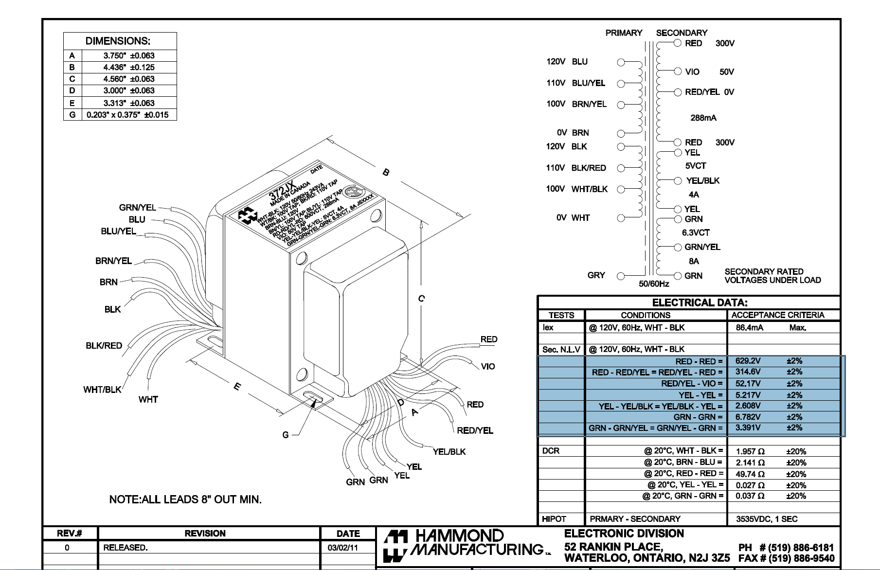

First checks done.
No valves inserted as a precaution.
Mains supply is this morning as high as 246 and not 240!
Checked 6.3VAC, it was at 6.8, bad news....
Checked 5VAC, it was at 5.6, again bad news.
Checked the 300-0-300 and as can be expected it was too high, actually being close to 325-0-325.
I'll now rewire the mains transformer not to 240VAC but use the tap +10 being 250VAC

Ok, i've now got the Mains Tx wired to 250VAC.
And with the light bulb wired in series with the live (brown) cable i have these voltages.
T1-RED-1 }
T1-RED-3 } 490VAC
T1-GRN-1}
T1-GRN-2} 5.1VAC
T1-YEL-1}
T1-YEL-2} 4.2VAC
Might now insert the valve rectifier Sovtek 5AR4 and check what D.C. output i get.

I've managed to quickly changed back to the 240V tap.
The bulb is still connected, so considering results, i'll now remove the bulb.
With the ECC81's and EL84 inserted i have: -
T1-GRN-1}
T1-GRN-2} 6VAC
Without the valve rectifier Sovtek 5AR4 i have: -
T1-YEL-1}
T1-YEL-2} 5.2VAC
And the 600VAC I have: -
T1-RED-1 }
T1-RED-3 } 602V
Things are looking good
T1-GRN-1}
T1-GRN-2} 6VAC
T1-YEL-1}
T1-YEL-2} 5.2VAC
T1-RED-1 }
T1-RED-3 } 602V
Just checked voltages again, without the in series light bulb.
ECC81's and EL84's inserted i have: -
T1-GRN-1}
T1-GRN-2} 6.4 VAC
T1-YEL-1}
T1-YEL-2} 5.5 VAC
And at: -
T1-RED-1 }
T1-RED-3 } 640 VAC
I think i need to reduce the 6.4 VAC down to a safe 6.3 VAC, i don't want to over work them.

If you look at the data sheet I sent you will see the limits for the heater voltage are 5.7...7V. You are very safe with 6.4V.
I'm more interested on the B+ when you plug the rectifier tube. 640 CT unloaded may result in B+ a bit high when loaded, depending on the power transformer wattage.

I have my 100 watt bulb connected and can report these voltages: -
6.3V = 3.7 VAC
5V = 3.2VAC
B+ = 203 D.C.
Remove bulb and get out the fire extinguisher? 🙂🙂
Or maybe a kick up the rear and get on with it!.............. don't answer that....
6.3V = 3.7 VAC
5V = 3.2VAC
B+ = 203 D.C.
