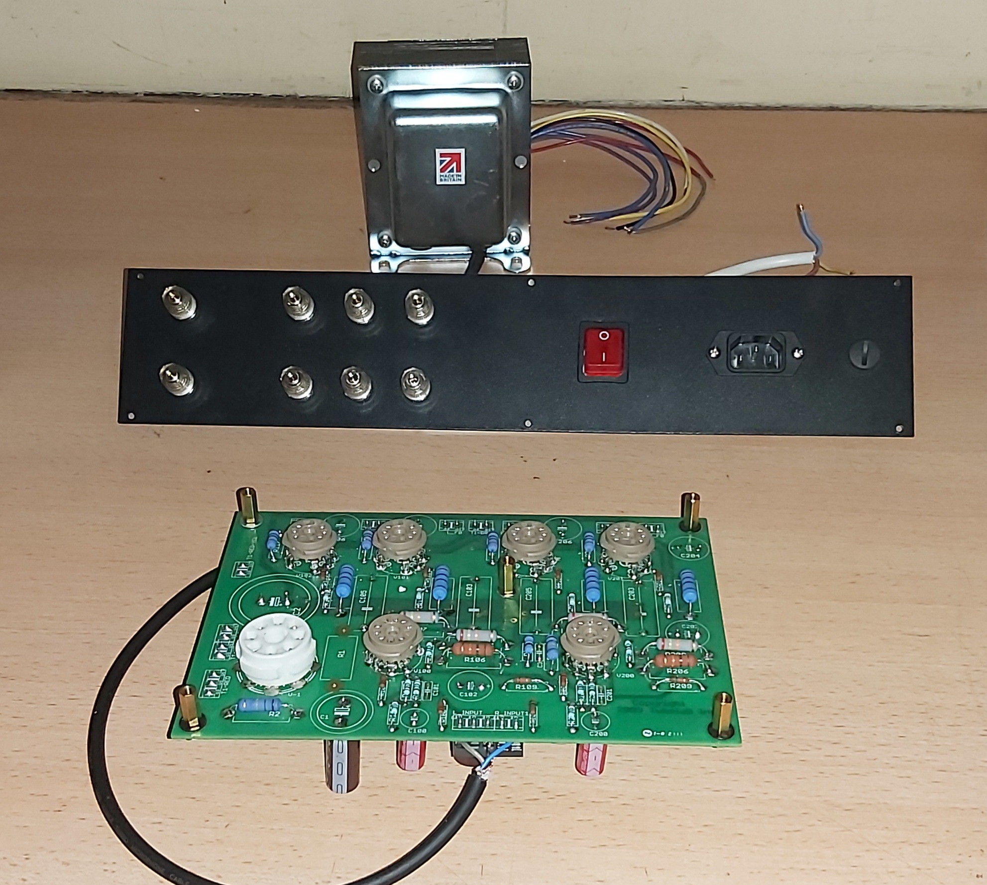

Assembly has at last began.
I'll be fitting the CL90 once wiring begins.
I'm a bit hesitant to mount the PCB and wire everything as a precaution.

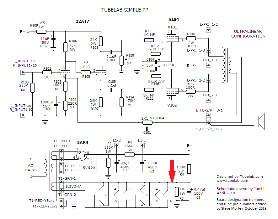

Resistors R112, 212, 116 & 216 are presently 270Ω, so i'll be changing them to 300Ω and take things from there.

Calpe,
Are you thinking of firing it up before mounting in the chassis? Probably safer to do it rather than have things floating about. Be sure to connect the power inlet ground terminal to the chassis. Use the light bulb limiter trick if you are hesitant. It has to be a conventional bulb, NOT a LED or compact fluorescent.
S.

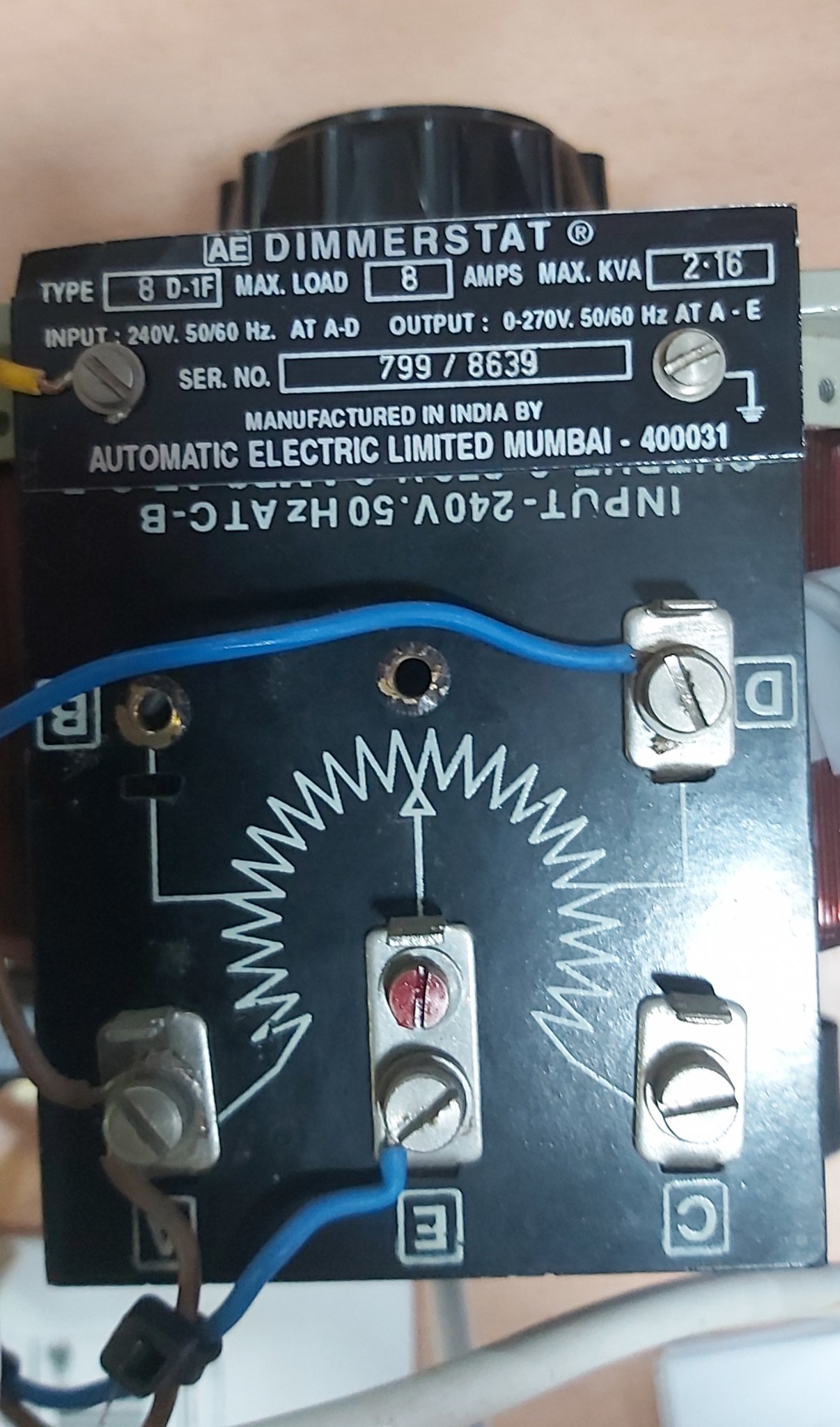

Steve, i dug our an old variac, damn thing wasn't working. It appeared the brush on the rotary slider had worn away, thus no output from the slider A.C. output. I rotated the brush and obtained an output and i'm sure it'll work for the tests. I'll need to look for a brush from somewhere.

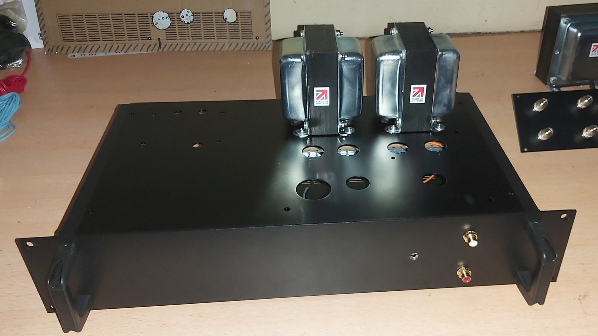

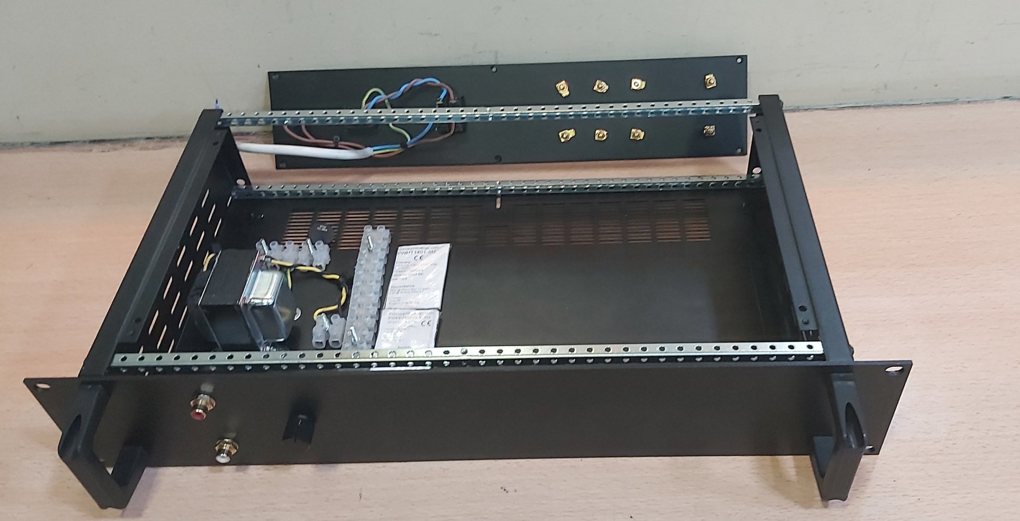

All the transformers are now all mounted.
Rear panel has all the needed items i wanted to fit.
Mains socket, mains switch, chassis mounted fuse holder, all to the rear right (looking from the back).
Speaker posts for 4, 8 and 16 ohms (my choice), mounted on the rear left.
Front panel i have left and right audio input sockets and a volume control.
I took note from Skunkie Designs as she stated if placing a 100K Vol. pot. then resistor R100 could be changed from 220K up to 1M, which i'v now done.
As mentioned resisitors R112/212 R116/216 are now 300R.

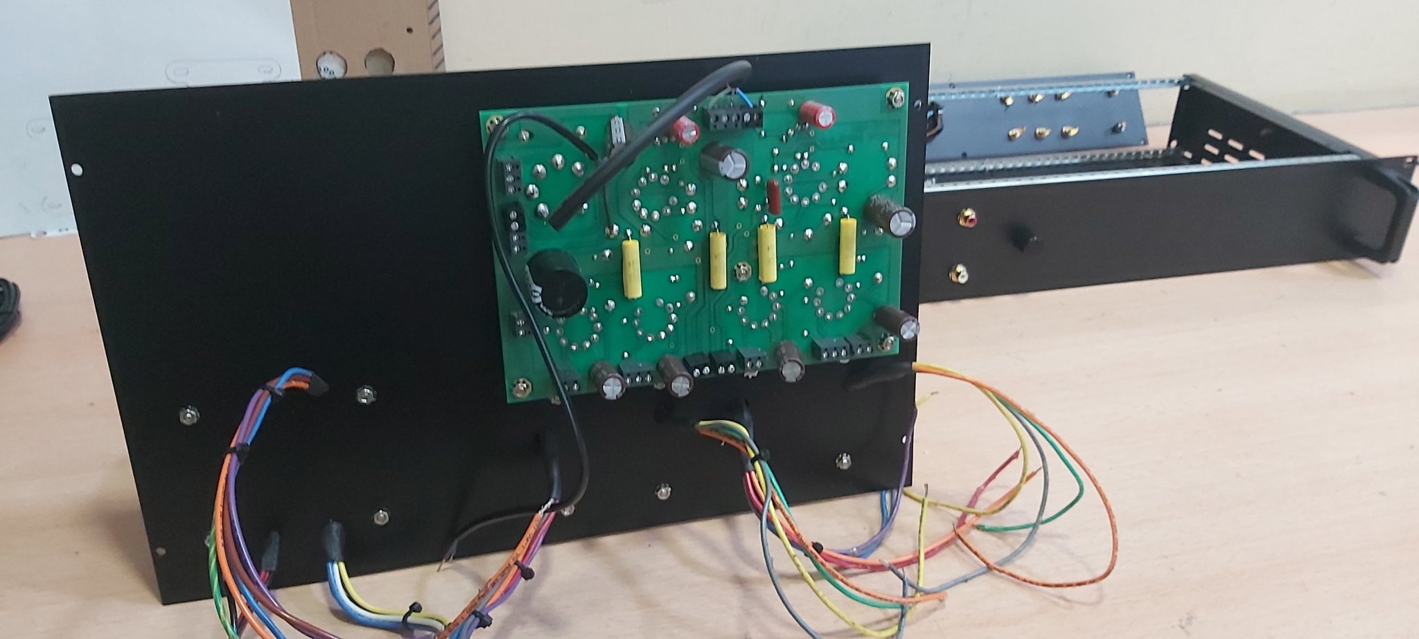

I'll probably choose to 'fire up' with the PCB not fitted to the top plate.
Just need to sort out all the wonderful coloured cables and to what PCB connections they go to😕

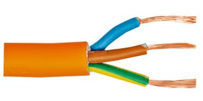

I did:
Blue, Brown, and Green & Yellow.​
Answered by Dave, Electrical Safety Expert​
Blue - This is the neutral wire (in older installations it may be black).
Brown - This is the live wire (in older installations it may be red).
Green & Yellow - This is the earth wire (in older installations it may be green).
I did:
Definitely - Blue is neutral. Brown is live and Green/Yellow is earth

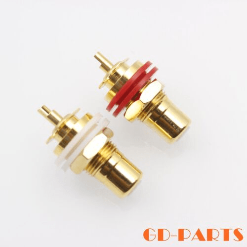

I'll have to double check the input RCA sockets. Can anyone recommend a type?

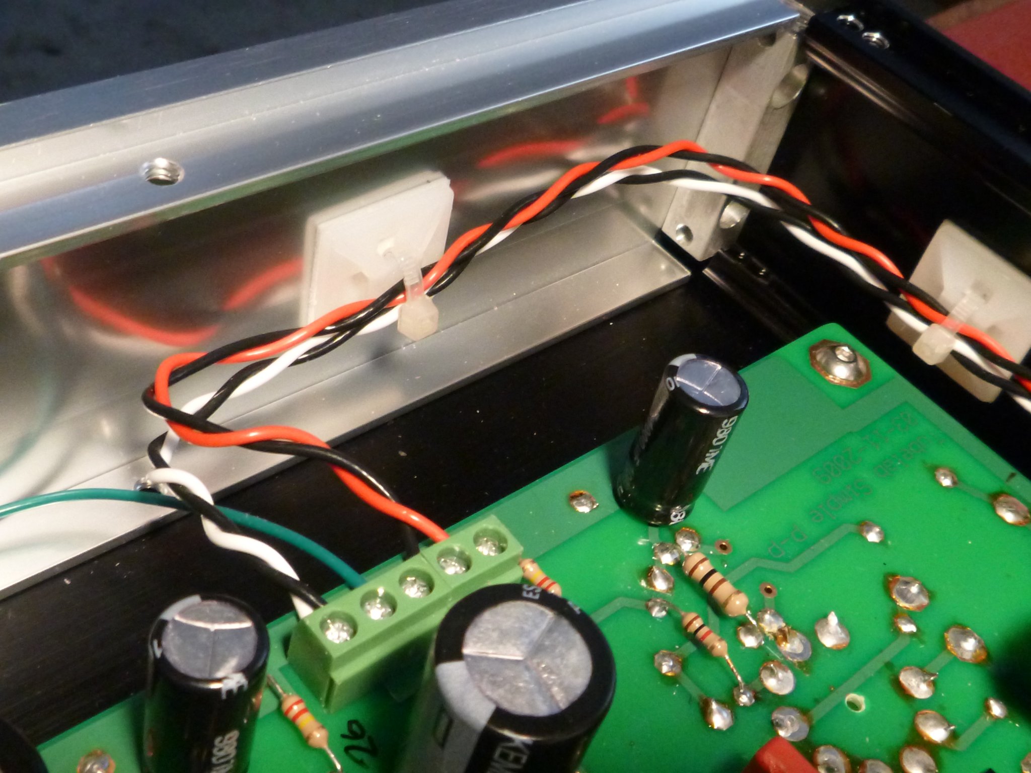

Sometimes the trickiest bit, as far as minimizing hum is concerned, is connecting the amplifier (read circuit) ground to the earth ground. The earth ground being the earth lead on the AC line cord that is also connected directly to your chassis. You only want to do this at one point hence the need for insulated RCA jacks. My SPP builds worked fine when I connected the circuit ground on the board at the inputs to the chassis earth. The green lead in the picture below.
RCAs: Something like this perhaps?

As per today, slowly does it..... trying to fit all other home matters in too.
Pictures speak for themselves/
Variac, now with a temp fixed on the wiper brush.
I wonder from where i could obtain a new or suitable brush?
Chassis putting it together.
Screws joints i'm having to remove in hidden areas the black covering so there is continuity throughout the case.
Phono input sockets replaced with chassis isolated types.
There's so many bits and bobs to check.
Final task is to work out where all the cables correctly go.
