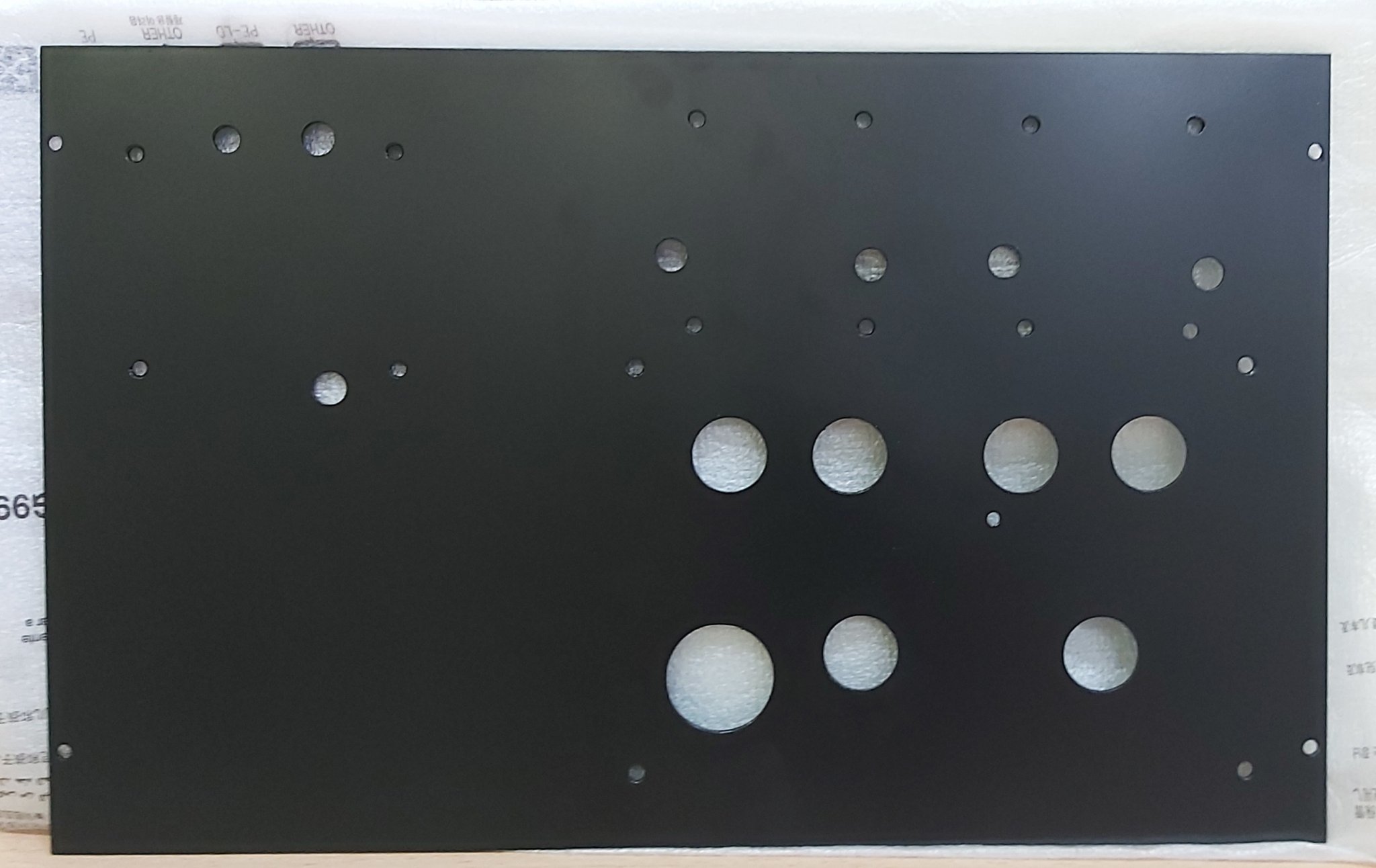

Top plate ready, drilled and sprayed
Looks like a great job! Well done. Did you use an etching primer for aluminium?
Francois, its actually a steel sheet done locally, holes drilled and sprayed black.
I used the template from the Tubelab web site, carrying out the printing correctly and its exactly prints the same size as the actual PCB.
As i now have all the required holes drilled, i hope to begin mounting and wiring after the weekend.
Front panel - input sockets and volume control, i will fit a small led 'on' indicator later.
Rear panel - mains input socket, mains switch, chassis fuse socket and speaker connections.
Top plate - All holes drilled for the PCB to hang under the top plate, holes for Transformers and their wires and of course holes for the Valves.
In the build i have made sure to keep the A.C. side i.e. mains transformer, choke to one side.
Audio input/output the the right side.
Very careful planning taking your time is needed, i made templates for the transformers & choke as well as the PCB holes (Valves and mounting).
Placing things to places you personally prefer (remembering AC & Audio seperation), measuring up carefully, marking holes,.
A centre punch can be used to enable the drill bit not to slip.
I actually used a 3" wood screw, these having a nice sharp point, with gentle tap it worked great, marking the holes.

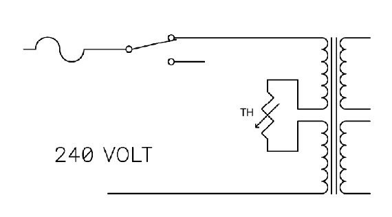

My query is about what appears in the Wall of Sound write up.
A CL90 Inrush Limiter was used and perhaps considering the surge on switch on, makes sense to use.
But where electrically is this connected? What kind of limitation does it do?
Electrically it is in series with the hot lead of the A/C side, after the fuse & power switch (in the WoS build)
I put mine in series with the high voltage center tap
It limits the voltage at initial turn-on until it heats up. Basically it keeps the power supply caps, especially the first one, from sucking in a lot of current as they charge up from empty.
Tube rectifiers like this.

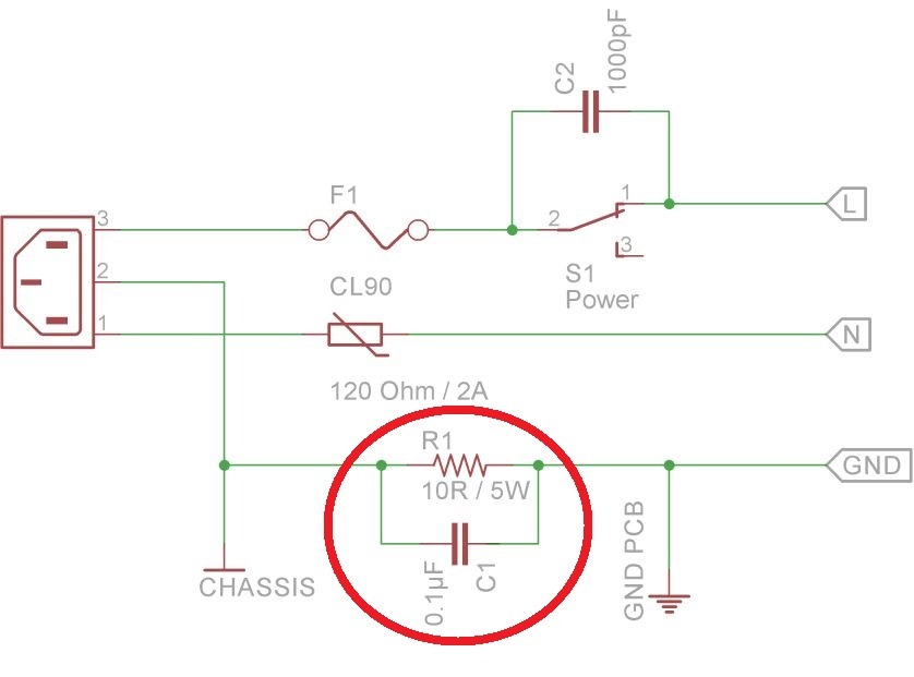

Also a 10Ω 5W Grounding resistor was used. Why?
Where electrically is this connected?
It's actually a resistor and a capacitor wired in parallel with each other & then put in the ground line.
The purpose is to avoid potential hum reduction due to ground loops.
Were it me I would not bother with it at first & build the SPP as is. It's trivial to add in after the fact if needed.

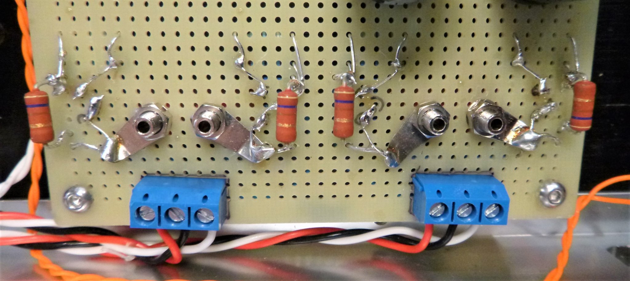

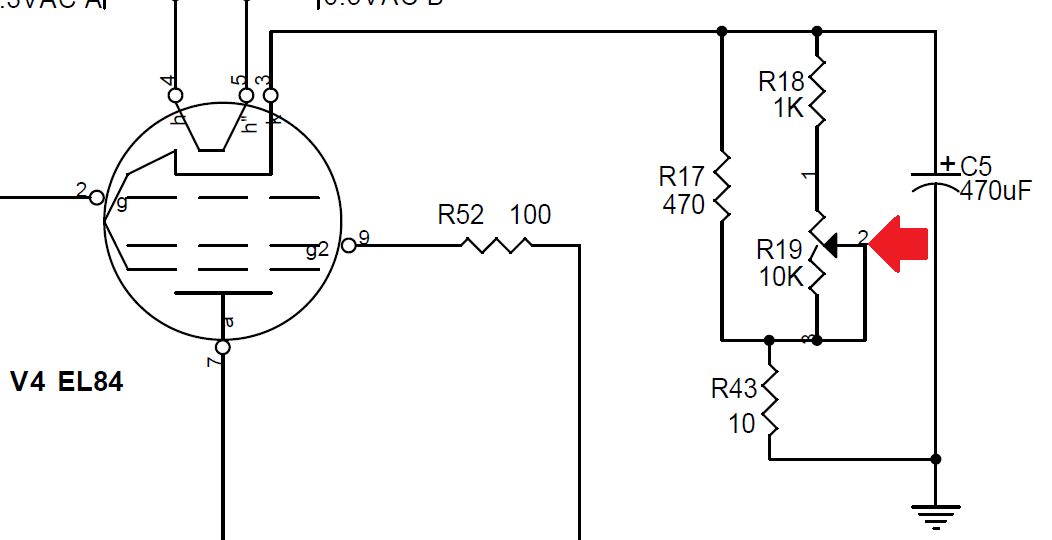

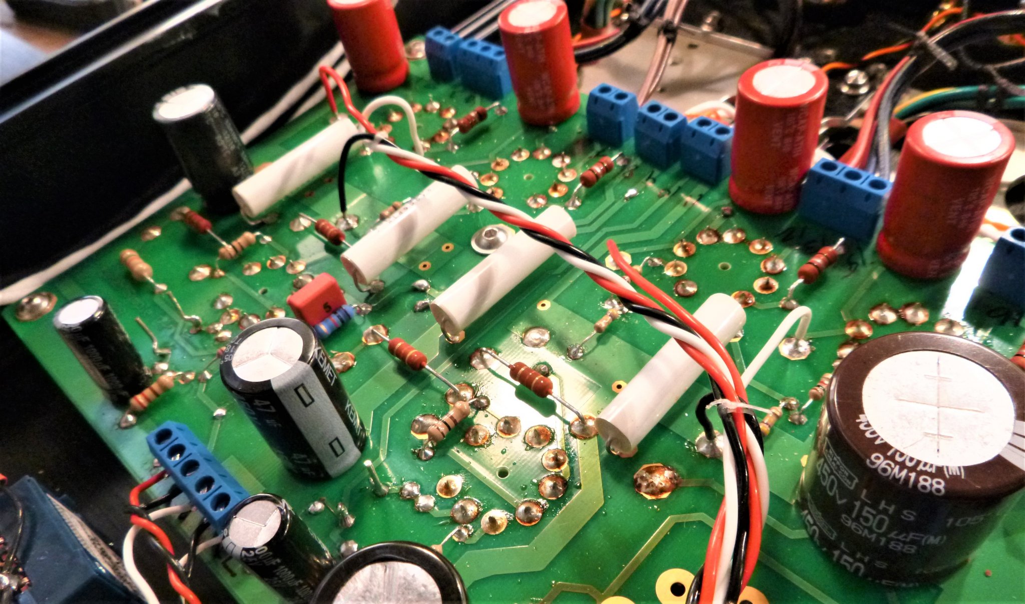

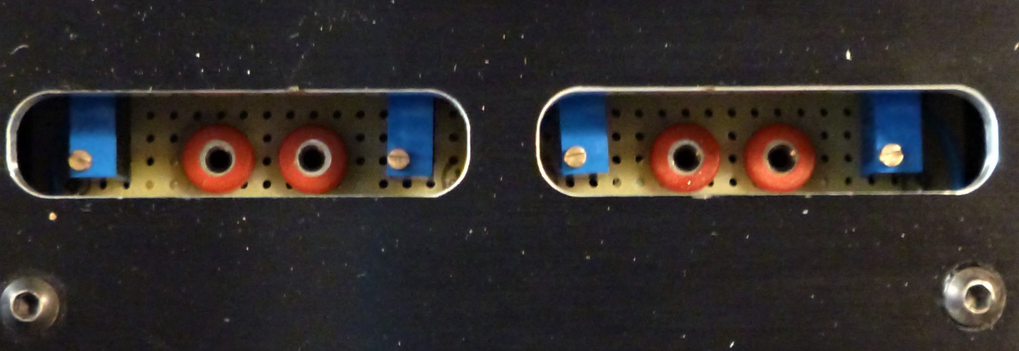

On my personal SPP I implemented an adjustable bias circuit copied from the no longer available DIYtube.com Dynaclone EL84 amp. Each tube gets its own adjustable bias trim pot. No board hacking required. Just don't install the 270, 300 or whatever ohm resistor on the board. Run wires out from the cathodes to a small perfboard with the other components. Start the amp up with the with trim pots adjusted for maximum resistance of the "stack" then tune to the EL84 dissipation desired. This also allows for perfect balance on both sides of the OPT and permits adjustment as the tubes age.

Over here, I set up the SPP with stabilised screen supply for the EL84s, and used some 1% 3 watt 330ohm Vishay parts for the cathode resistors. Makes for easy tube matching, and some immunity to mains voltage variation. And I prefer the sound of pentode operation to UL. OPTs are 7600ohm Hammond 1650FA.
About the EL84 being pushing hard, you got Sovtek EL84, which I believe, after looking at Sovtek's datasheet, are just re-badged Soviet 6P14P, which have a maximum anode dissipation of 14W. 270 ohm will result in around 12W anode dissipation, which, for an original EL84 (12W max Pa) is borderline, but perfectly fine for the Sovtek one.
Edit: This is valid assuming B+ is up to 330V. If higher, then I would recommend starting with a 300 ohm resistor instead of 270, measure the voltage accross it and the EL84 anode voltage, calculate the power and tune the resistor if necessary to keep Pa in check.

Ok, as its happens i purchased one of these and i will now connect it in series with the Live A.C. (brown) cable as you've said after the switch and i/p fuse.

I've open the #Post175 in WoS.
In Post #267 (this thread) and #273 the CL90 circuit position is clear i.e. wired in series with the live (brown U.K.) cable.
But in your Post #195 you've thankfully drawn where these components go. Cheers.
Thanks Steve for this.
I'll take it on board and if i see its needed then out comes some Veroboard i have, trimmer pots i'll have to order
