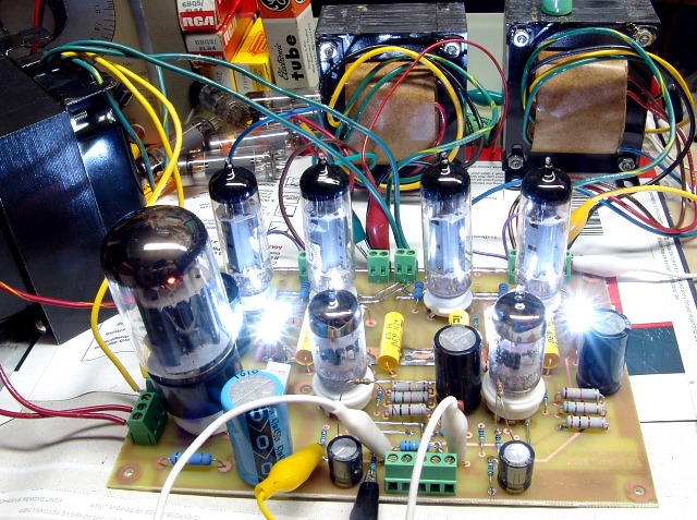

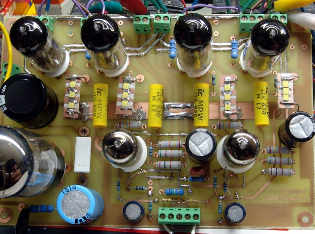

The SPP design is very conventional and there are at least two very similar designs found in these forums. These designs simulate very well depending on the tube models.
SY's RLD amp is quite similar, and I did build one with adjustable screen regulators and white LED's from the flash in a camera phone, the WLD version. Note that this is a DIY prototype PC board made before real SPP boards were available.

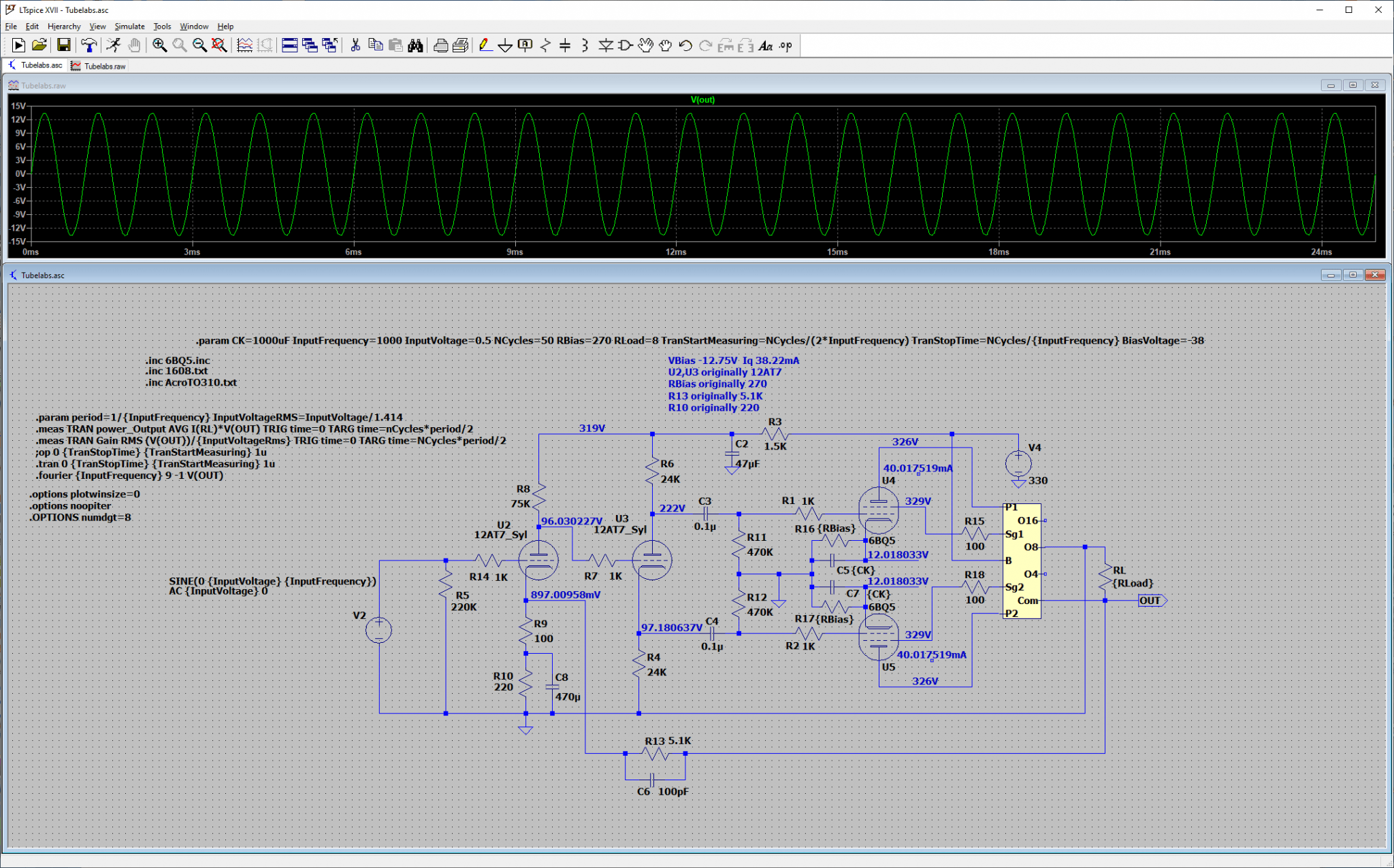

Here you are. I use the Ayumi models, there are many, many more models around.

Would it be possible for you to provide the LTspice files with all the include?
Many Thanks
Explanation please about this?Here you are. I use the Ayumi models, there are many, many more models around.
Edit: remove .txt from the output transformer symbol file.
I posted in #221 simulated DC values for different points. Those are quite reasonable. I was asked for the LTspice file, I shared it. Sorry if that polluted a bit the thread.Explanation please about this?

Looks like a good idea, i might try it, thanks<LTspice> is free electronic circuit simulation software.
For example, the voltage values can be queried here.
The files offered by jcalvarez contain the circuit of the SPP.
I was missing the definition of the OTP, so I asked for the files.

Yes. The .asc file is the schematic, which is almost self-contained. The .asy file is the OPT symbol.In post 226 are those 2 files for the LTspice program?
I did look around for the Valves and chose Sovtek's from https://watfordvalves.com/products.asp?main=ValvesThose DC voltage numbers look realistic. Unfortunately, there have been many "things" sold as "12AT7" and even more called "EL84." Few are likely to be close to the model used in the sim. The 12AT7 circuit is DC coupled so a little variance in the Mu or Gm in the first triode will cause the DC voltages on the second stage to be different. I did most of my initial testing during the development of the SPP with two sets of Sylvania 6BQ5's pulled from working amps, and about a dozen JJ EL84's. I rolled through a bunch of 12AT7's, 6201's, and a few others whose numbers I can't remember now. The component values were chosen based on an average of real measured data on all the tubes I tested. They have been fine over the years with the possible exception of the 270 ohm cathode resistors for the output tubes. These are greatly dependent on the tubes used and the actual B+ voltage.
You should have a bit over 1/3 of the voltage seen across C2 across R4 and R6 and a bit more across the tube, as seen here. Minor variations (+/- 10 to 20%) are OK, a gross difference indicates a problem. The screen and plate voltages on the EL84's is determined by the OPT and the power supply voltage. The cathode voltage is determined by the cathode resistors and the tube itself. The value of the cathode resistors R16 and R17 should be adjusted to keep the tube dissipation at a safe value. Neither the plate or the screen grid should show any redness when observed in a dark room. Some EL84's can handle 12 to 14 watts without objection (my old Sylvania 6BQ5's) but some will object to anything over 10 watts. I got two different batches of "EL84 Russian equivalent" from two different Ebay sellers many years ago and I think two or three out of about 20 tubes would work at 10 watts of dissipation.

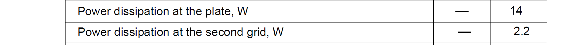

The EL84 can handle 14W of total power (all values based on the EL84 Mullard datasheet), is 12W for the anode and 2W for G2. I would consider that a safe working point. In addition, the maximum anode-cathode voltage is 300V. In the schematic supplied, the tubes are set at 40mA idle current, and a Va-Vk=326V-12V=314V, therefore an idle anode power of 12.5W. Both values are slightly above datasheet values, but as Tubelab explains here (http://tubelab.com/designs/tubelab-spp/applications/) virtually every EL84 he tested worked flawlessly with those settings.I did look around for the Valves and chose Sovtek's from https://watfordvalves.com/products.asp?main=Valves

PS: Just checked the Sovtek EL84 datasheet, it looks like a soviet 6P14P design:
You are very safe with 12.5W anode dissipation.
