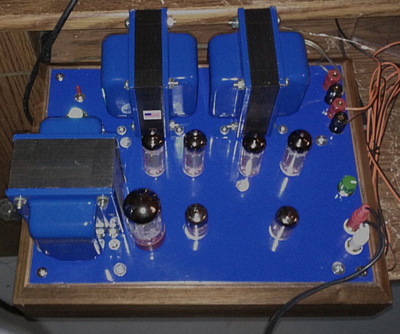

I finally put everything together.
This is a SPP connected in UL. PT is Edcor XPWR008 and OT's are Edcor CXPP25-MS-8K with a 23% tap. The enclosure is an Hammond with walnut. I wish I had gone metal. The enclosure is very is a bit small for this...
As luck would have it, I had on hand a blue spray paint that matches the Edcor bells. I also added a green 6.3 V jewel light. Looks like a old-timey guitar amp. I am waiting for a better pot (I have a Alps 50 on order).
Everything seems to work ok. The PT is barely warm after 1/2 hour, and so are the OT. I cannot say the same with the tubes 🙂

Hello everyone:
I will have to make some measurements before I do anything, but here are my observations: my build is rather compact, but the tubes do stick out of the amp top plate well. The transformers run cool, initially, but after about 1-2 hours, the amp top plate gets hot and so everything, including the transformers, gets hot.
It seems as if the EL84 are really heating up the works.
Is this normal or (as the measurements I have to make will answer for sure) is the B+ a bit high? Or could be simply a result of tight spaces around the tubes? I have posted a picture of the build a few posts back. In the build I use 5ar4 but I have handy several other rectifier tubes (5u4gt and 5y3). I know that the 5u4 will lower the B+ by adding "sag". Is this advisable?

How hot is hot? Mine gets fairly toasty as well but works fine. How long can you hold your hand in the power transformer and top plate? R1 dissipates about 7W, so look out for that.

I actually think that the transformed are not getting hot by themselves. The are heated by the sheet on top of the amp, which in turn is heated by the tubes. I am not really familiar with tube amps, so I don't know what "Hot" is really hot. The transformers are actually cool initially and stay so for 1/2 hour easily. It is when the metal sheet gets hot, that everything gets toasty.
I have checked a few voltages.
Line voltage here is a bit high, at 125 Volts (Not much I can do, unless I add a variac)
The output of the power transformer are 315-0-315 (5% higher than spec, probably due to the high line voltage).
B+ with the Chinese brand 5AR4 is 343V.
B+ with the American made but vintage 5U4GB is much lower, at 303V.
B+ with a vintage American made 5y3GT is only 282V (not good, I think)!
Out of completeness I checked the filament voltages: 7.0 V for the 6.3 tap and 4.9 for the 5.0 ( bit low. Probably due to the large current drain of the rectifier).
All measurements were made with volume at the halfway point, no input and my speakers connected to the 8 Ohm taps of the OPTs.
I am going to try the 5U4gb for a while (inrush voltage problems and all) and see how I like the amp with lower B+.

If you can keep your hand on the transformer for as long as you want, it's running at a safe temperature. If you can't hold it there for more than 5 or 6 seconds, it's something to be concerned about. The temperature of the plate is pro ably not that important as long as the chassis has some internal ventilation of some sort.
The amp is doing fine. It gets a bit toasty after about 2 hours, but I have come to the conclusion is because the footprint of my build is rather small, and I have got 7 tube heating up the works. No problems it looks like.
