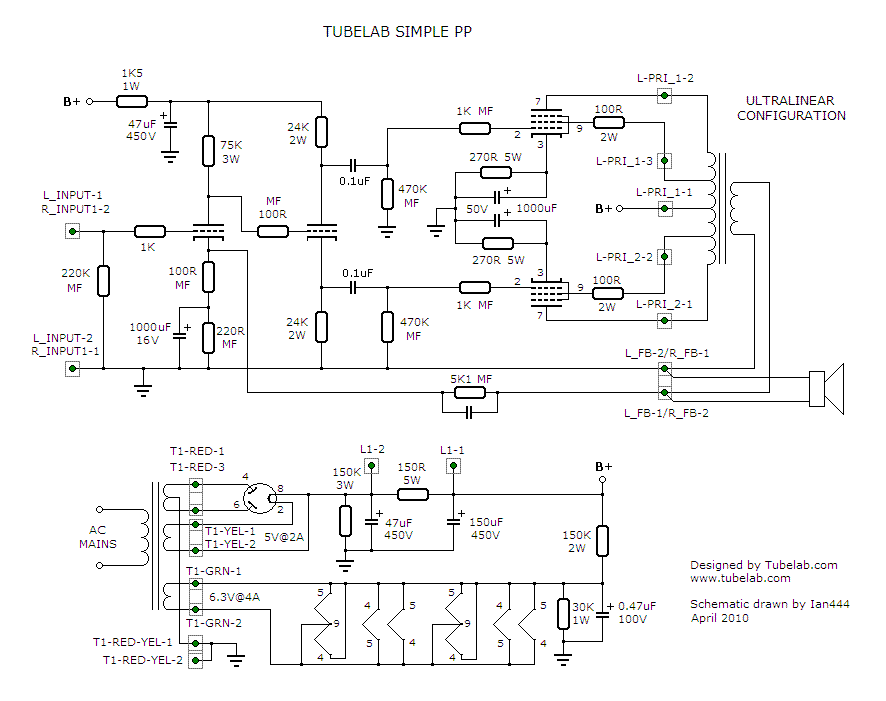

First Amp Build!
Well, after reading about valve amplifiers and looking over many kits, I've decided on the Tubelab SPP. I've waded through all 63 pages of this thread and hopefully gleaned the most important info for my planned build.
This is my first diy amp, so I'm a definite noob, but I have done a few kits - a mate & I designed, sourced and kitted 100 aquarium controllers a few years back - 10x240VAC outlets for temp. control, timers (lights, pumps, dosing), SMS alarms, etc based around a simple pic - kitting them up was quite a process, then everyone wanted us to solder their components to the PC boards for them. But on amp building I've got a lot to learn!
Anyways, I'm hoping between the good folk here, George's detailed manual, a few ol' mates and the resources of the greater interweb, I can cobble together something functional!
The board and parts kit arrived from George today (thanks George!) and as soon as the new tips for my soldering iron turn up, I will start on that.
Transformers from Edcor (XPWR066 & CXPP25-MS-8K/23%) – built to order, so I'm waiting patiently for those to ship.
I've gone with JJ tubes – 4 x EL84, 2 x 12AT7/ECC81 and a GZ34/5AR4 Rectifier tube. Chassis will be 2.5mm Aluminium plate for the top and rear panels with a basic black finish, mounted in a simple box made from recycled Huon Pine with a clear finish. RCA and Jack Inputs, Source Switch, Power/Mode Switch and Volume Pot will all be mounted through the top plate, with IEC power inlet/switch/fuseholder and 4, 8 and 16ohm speaker terminals mounted through the rear panel.
I've got my head around the wiring notes between the OPT's and board by Russ on p58 in post #579: http://www.diyaudio.com/forums/tubelab/148694-tubelab-simple-p-p-58.html#post3482585
I plan on installing 470pf (mid range) capacitors for C101/C102 for feedback – is this the correct part?:
CD15FD471FO3F Cornell Dubilier Electronics (CDE) | Capacitors | DigiKey
I was going to use a 4DPT 3pos. toggle switch with 'middle off' to switch between Pentode and ultralinear. I've looked at the schematics by Ian444 on p36 post #353: http://www.diyaudio.com/forums/tubelab/148694-tubelab-simple-p-p-36.html#post2568175
but I'm still getting my head around how to correctly wire the switch and am leaning towards just setting it up as ultralinear for now. If I follow Russ's wiring setup linked to above, will that have the amp setup for ultralinear mode? Sorry for such a noob question, but my head is hurting a little over this...
I intend using the following key components:
Edcor XPWR066 (240VAC - I'm in Oz) 300-0-300, 200mA
https://www.edcorusa.com/xpwr066
Edcor CXPP25-MS-8K/23%
https://www.edcorusa.com/cxpp25-ms-8k-23
Volume Pot.: DACT 21step 50k,
Dact Type 21 Stepped Attenuator Potentiometer 50K 300B | eBay
Mode Switch – Pentode/Power Off/Ultralinear - 4DPT 3 pos. on/off/on toggle:
10A 380VAC 15A 250VAC 3 Position 4PDT on Off on 12 Pin Toggle Switch | eBay
Source Switch - RCA/Jack - 4DPT 2 pos. on/on toggle:
On on 2 Position 4PDT Latching Toggle Switch AC 15A 250V 10A 380V | eBay
Power inlet/switch/fuseholder:
IEC Fuse Chassis Male Power Plug with Switch | Moulded Leads | Distribution & Interconnect | Power Products Electrical | PRODUCTS | PP4003 | Jaycar Electronics
I'm not much a draftsman, but here's a pic of the planned layout (310Wx300D) for the top plate:
If anyone can advise me on the Pentode/Ultralinear conundrum please do, or if you think I've got anything wrong or am missing something, feel free to let me know!
Rob

Rob,
G'Day!
One observation - your layout has the power transformer on the right side of the board; the PCB's connections to the power transformer are on the left side. It is better to place the PT on the side of the PCB power connections.

I agree with zman01. Another benefit is, that the power transformer moves farer away from the input jacks.

Thanks for the feedback! I had originally had the layout on the opposite 'hand' with the PT on the left and board on the right. But my concern was the large Rectifier tube was a bit close to the controls. Physically I'll have space to route the PT wires to access the board, but yes, it is the longest run. I'll give it some more thought - Cheers!One observation - your layout has the power transformer on the right side of the board; the PCB's connections to the power transformer are on the left side. It is better to place the PT on the side of the PCB power connections.
Thanks! I had been mindful to keep the input jacks well separated from OPT, but it looks like another draft of the layout might be in order!I agree with zman01. Another benefit is, that the power transformer moves farer away from the input jacks.

Neat, compact build Marco!
Are your connections for Ultralinear the same as outlined by Russ on p58 in post #579?:
That colour match is amazing - what brand/colour was that?

The connections I have were found in a post on the Tubelab simple P-P thread (I don't remember which page, sorry) but I downloaded the schematic which I have attached. The author is identified so it should be ok.
The color was pure luck. I checked my basement to see what spray paint I had on had and this can of Krylon Patriotic Blue #2329 (bought who knows when for who knows what project) was sitting on a shelf. The match is very good.

I found the original(I think) post 353 page 36:Neat, compact build Marco!
Marco
Thanks Marco! I have a copy of that schematic, I probably should have studied it more closely - will do now! 😉I found the original(I think) post 353 page 36:
This is the connection list by Russ (on p58 in post #579) that I've been talking about:
I've spent a bit more time studying and finally worked out the difference bewtwen the Pentode and Ultralinear Schematic's that Ian444 linked on p36, post #353:

I've edited the pics to more clearly show the diff for any other newb:
Pentode:
Ultralinear:
So I'm pretty sure I've confirmed to myself that Russ's connection list is for Ultralinear with feedback (if C101/201 installed) - Apologies to those (most) of you who got their head around it all years ago! ;-)
Rob
Well, this is the wiring diagram for the Hammond 1650FA OPT:
Each channel on the SPP has 3 sets of terminals for the OPTs. So for example, from left to right along the back of PCB:
Left Channel
- L-PRI_2
- 2 - V102 screen - primary blue/yellow wire
- 1 - V102 plate - primary blue wire
- L-PRI_1
- 3 - V101 screen - primary brown/yellow wire
- 2 - V101 plate - primary brown wire
- 1 - primary red wire
- L_FB
- 2 - Ground - secondary black wire
- 1 - Feedback - secondary (green, yellow, or white)
Right Channel
Please note that L_FB and R_FB are mirrored! Also note that if you do decide to use feedback (by installing C101/201), you may need to swap the PRI_1 and PRI_2 secondary connections on each channel to get the right phasing (leave the red wire where it is). I can't remember if I had to or not. You'll know if it's wrong if you get loud squealing out of your speakers with feedback connected.
- R-PRI_2
- 2 - V202 screen - primary blue/yellow wire
- 1 - V202 plate - primary blue wire
- R-PRI_1
- 3 - V201 screen - primary brown/yellow wire
- 2 - V201 plate - primary brown wire
- R_FB
- 2 - Feedback - secondary (green, yellow, or white)
- 1 - Ground - secondary black wire
