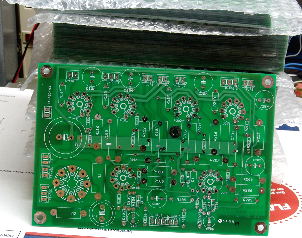

Has the layout changed since the prototype?
The general layout of all of the components is similar to that amp, but the board layout has changed. I moved several parts around to make assembly easier. I rerouted most of the traces to make the amp a little quieter.
I have a new prototype that exactly matches the board that was sent out for duplication. I will post a photo when I have some time at home. That's likely Saturday evening or Sunday morning.

Picture of proto board.
