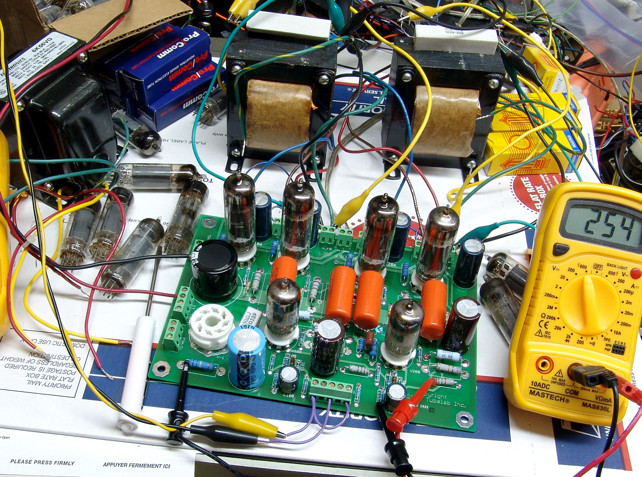

Today I got about 1 1/2 hours to do some testing. I removed the power transformer and connected an external power supply so I could find the best operating point for several tube / transformer combination.
The data sheet for the 6BQ5 claims 17 watts for a pair with an 8000 ohm load. I found no combinations of voltage, current, and load imperance that produced 17 watts without screen grid glow. Best case here was 15 watts.
The Russian 6P14P did a little better, and the EI 7189A (which looked like the EI 7189A) was flirting with 17 watts.
I swapped in some surplus guitar amp OPT's, and installed 4 X 6CW5's. They have a 250 volt max, and at that max 20 watts is available. I listened to them through the much bigger OPT's. This setup rocks! 20 watts is still available at 20 Hz.

The original 6BQ5 has no connection made to pins 1, 6, or 8. The 7189A uses these pins as connections. There are dozens of variations of the 6BQ5, 6BQ5A, EL84, 7189, 7189A, SV83, SV84, 6P14P and more, that may use one, two, or all 3 of these pins. If the socket is wired for a 6BQ5 and no connection is made to the "extra" pins, all of these tubes should be pinout compatible with the socket. The Simple P-P is wired in this manner. There is a wide variety of power and voltage handling capability among all of the variants and for this reason they are not all electrically interchangeable. This is particularly true with some of the Russian tubes being sold on Ebay as 7189A compatible.

This does not come without a fairly steep price though. The 6CW5 likes current, and lots of it, at a low B+ voltage like 250 volts. I am seing average current in the 380 mA range for the complete amp. Peaks go to almost 500 mA when you crank some Metallica! This is too much current for any common rectifier tube, and the board was not set up for solid state diodes. Power transformers with ratings to support this aren't common either.
Dumb blonde moment:
The current drawn by this board with 6CW5's is more than my old Fluke power supply likes to put out (current meter is pegged). I got this brilliant idea to wire two power supplies in parallel. Dumb idea. They fight each other and the current meters look like windshield wipers!

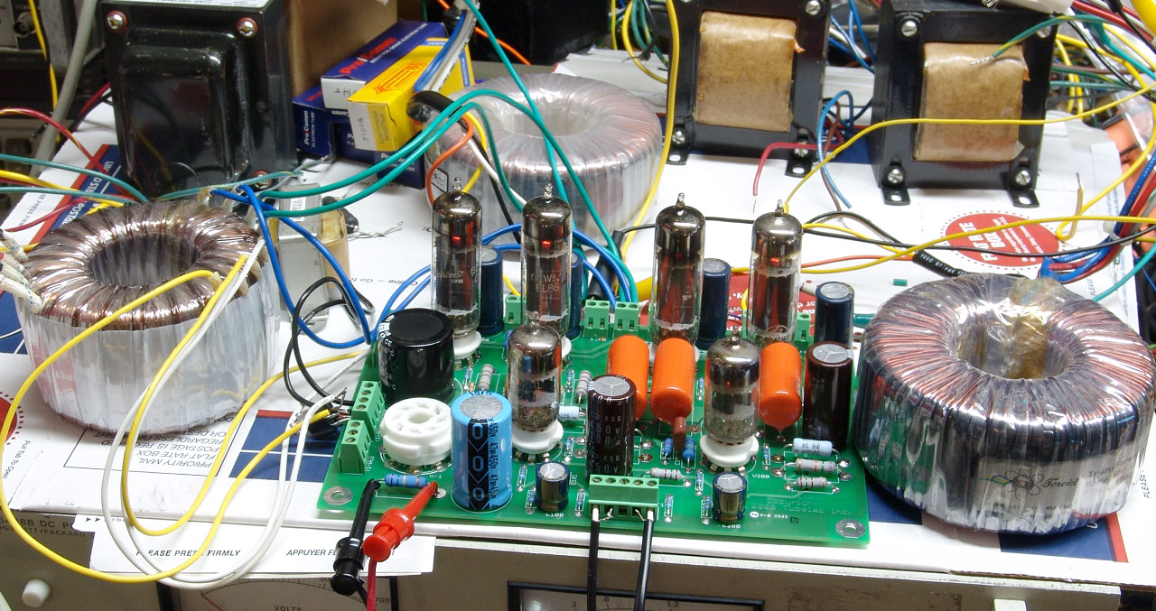

I wired a good size (maybe 300VA) power toroid in place of one of the OPT's and did some testing. The max power dropped by a watt or two. The distortion is low, and the frequency response is 6 Hz to 69 KHz. I am in the process of connecting up the second one, and I will do some listening.

It's rather convenient that a well balanced push/pull amp is virtually immune from problems arising from core saturation. Let's you do all sorts of things that flat out don't work in SE.
OK I got an amp running with no conventional transformers. The choke is a $7 EI choke, but the power and OPT's are toroids and this thing sounds good. I tried using a 5U4 for a rextifier, but it didn't work well at all. I wired in a couple of FRED's and they work fine. More experiments later.
All of the conventional transfornmers in the photo are not connected.
