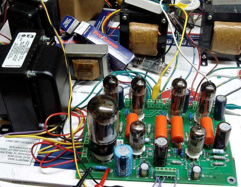

At this time I have two boards built and operational. The parts for the build photos will all be here by wednesday.

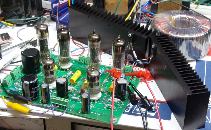

This weekend I did some experiments with a hybrid configuration using the board to drive mosfets. I have succesfully done this in the past, but this time I made some smoke. I didn't have the time to figure out why it fried.
Count me in on a parts kit. This beautiful PC board is ready for parts! Any word on the appropriate iron?
I am posting a picture of my second board. It is seen here being used in a failed hybrid amp experiment. It is built pretty much like the first board except that there is no rectifier tube. There are two 1N5408 diodes where the tube should be. This looks like the best path to chose with 6CW5's due to their high current demands, more than a 5AR4 can make and a 5U4 drops too much voltage.
For 6BQ5's, EL84's, 7189A's and the Russian equivalents:
Funny you should ask that. There was a box containing a Hammond 372HX delivered today while I was at work. Of course I hooked it up when I got home. I put in some Russian 6P14P tubes (cheap on Ebay) and cranked it up. At idle the B+ is 358 volts and at a fully cliped 18 WPC the B+ is 347 volts. At a more reasonable 15 WPC the B+ is 350 volts and the distortion is 2.2% in one channel and 2.4% in the other. At 10 WPC the distortion is 0.5%. Some 7189A's may be able to handle more B+ than this, but the Russian tubes, some EI 7189A's and several NOS or used 6BQ5's are on the verge of screen or plate glow at continued full power operation, so 350V looks like a good place to go.
I made a deal on the Hammond 372HX, so I used it. A 272HX would probably work OK for less money (in 120 volt countries).
For OPT's I am using some surplus guitar amp OPT's that I bought a bunch of 10 years ago. They work excellent for this amp, so I doubt that I will try anything else. They are "80 watt" (really about 25 watt) 6600 ohm to 4,8, 16 ohm without UL taps. I have taken one apart and found low cost construction with zero interleaving, wound on power transformer cores, but they measure good, and sound better. I have tried the lowest cost Edcor XPP10-8-8K OPT's with mixed results. They sound great at low volume but distort at a few watts or so. After all they are only 10 watt transformers.
I would look for something with a 6K to 8K ohm primary, at least a real 20 watt rating more would be better but too big (over 50 watts) will cost some power and sonic detail.

I am still looking for the optimum power transformer. I will report further as I get to look at more transformers, but I am currently using an Antek 1T200.
For an OPT look for a 3K to 4K ohm primary, and similar ratings to the EL84 transformers. I am using the same guitat amp OPT wirh a 8 ohm load on the 16 ohm tap to give a 3300 ohm primary.

Here is a photo of the 3 boards currently under construction. Note the diodes in place of the rectifier tube on one board. This is required with 6CW5 tubes. Also note the tube socket on "stilts" on another board. This lets you mount the parts on the top of the board and raise the tubes up to the deck. I used this method on a Tubelab SE with a Lexan deck for show off purposes. Astute observers will notice that in my rush, I put the tall socket on the wrong board. It should be on the board behind the one it is on. Now I get to take it off.
I got to crank the Simple P-P to eleven last night (Sherri wasn't home). It is running cheap Ebay sourced Russian 6P14P tubes, a Hammond 372HX power transformer and some surplus OPT's. The Tubelab SE likes detail and music like Norah and Diana Krall, The Simple SE is a good all around performer, but this amp likes to ROCK. It does justice to Norah and Diana, but it LIKES Pink Floyd, Ozzie, Santana, Metallica, and all sorts of vintage rock. I even enjoyed cranking some Billy Idol. Some of the punch and dynamics that I like so much in my old 300Beast are present in this amp. The only thing this amp has in common with the Beast is the surplus OPT's, could it be the OPT?
