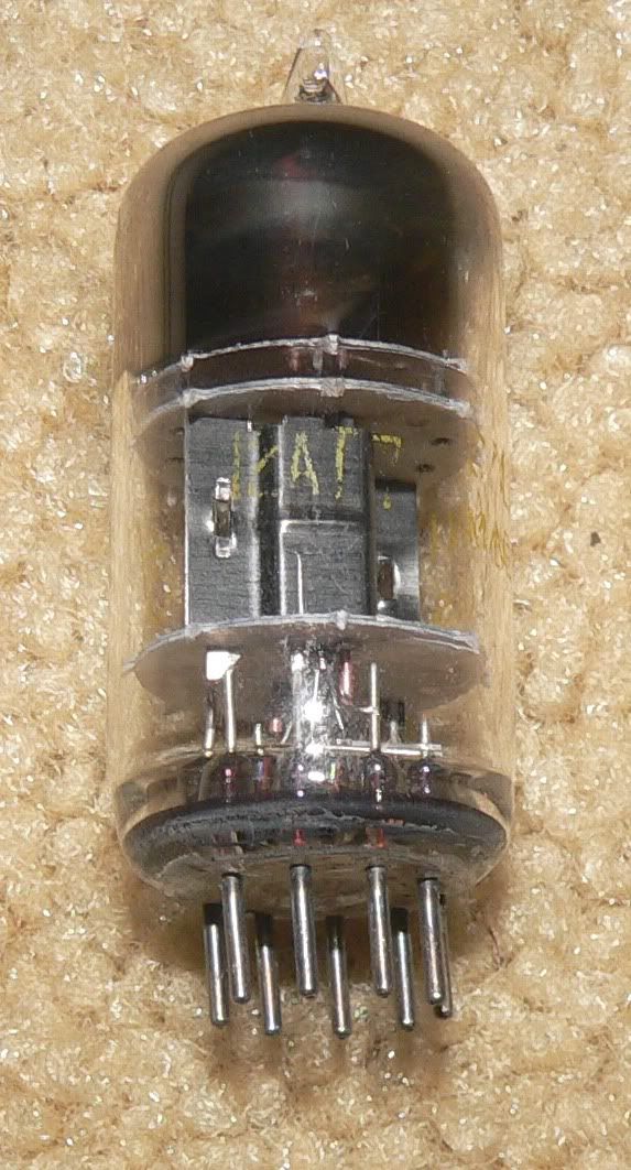

-GE 5-star 6201's (triple mica gray plates)
I looked over at the Simple P-P that is currently playing and the two 6201's are indeed GE 5 star tubes. I looked into the box that is full of loose 6201 tubes and they are mostly Sylvania but about 1/3 of them are GE 6201WA. Some of the Sylvania's are 6201GB (Gold Bond). I guess this must be their answer to the GE 5 star. All seem to work good.
If I recall correctly, the Simple P-P will require 12AT7's in the front end. Any suggestions for brands to look for?
I've been using 12AU7 tubes in my Simple SE (it's been working fine, any input George?) and my favourite by far is the used (old stock) Tung Sol that I picked up cheap. I have a few (also used) Cifte tubes that sound good as well. Fo some reason, the two Electro Harmonix 12AU7's I have sound pretty ordinary, if not just plain bad. I've got some NOS Tung Sol, RCA and GE 12AT7's on the way, and just as many NOS 12AU7's and 12AV7's.
I'm not George, but I'll add my two cents anyway. If you like the sound, then I'd say go for it. The 12AU7 should be just fine. Keep an eye on the heatsinks attached to the IXCP10M45S (the CCS). I'd expect they will be getting hotter with a 12AU7 than they would with the 12AT7 as the watts dissipated in the CCS will be higher (roughly 2.5 watts, vs. 1.5 watts).
Don't try touching them with your finger to check the temperature. They've got 400 volts on them!
