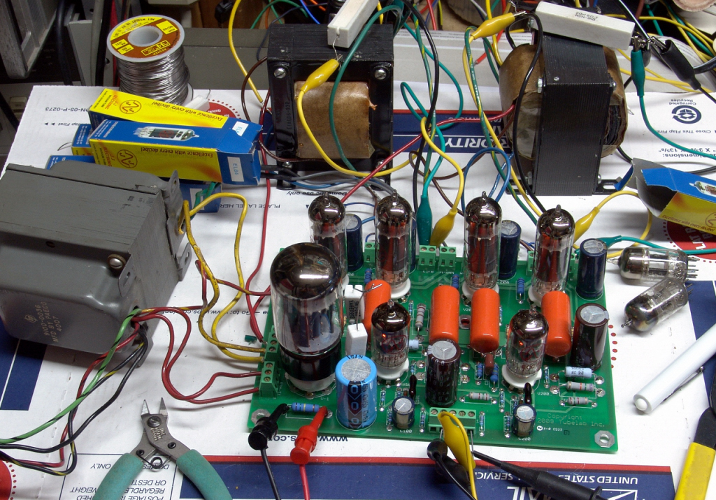

OK, running an amp on bench type power supplies is needed to figure out what voltages you need, but it doesn't make for a good stand alone amp. I now know that I need about 400 volts on the plates and 300 volts on the screen. How do we get there using the existing PC board?
The answer turns out to be rather simple. We use a power transformer that produces about 400 volts of B+, and use rather large resistor for R1 so thet the board gets 300 volts. Then we connect the red wires from the OPT's to the input terminal on choke connector, so that they receive the 400 volts from before R1. NO choke can be used in this configuration.
I am sure that the experts can say that this unregulated screen supply will cause a lot of distortion, and the fairly poor filtering on the plate supply of the output tubes could cause hum, especially with unmatched tubes. I had these conerns too......until I fired this thing up.
There has been this crusty old power transformer sitting on my bench for about 10 years. It came from an old HP audio oscillator. I use it for experiments like this. In this amp it gave me 393 volts at idle and 389 volts with both channels driven to full power. It gets rather hot after 8 hours (yes I really "tested" this one) of continuous use.
Look carefully at the photo. You can see the red wires from the OPT going to the side of the board near the power transformer connections. You can see two 1.3 K ohm 5 watt resistors wired in series where R1 should be (on the right side of the 5AR4).

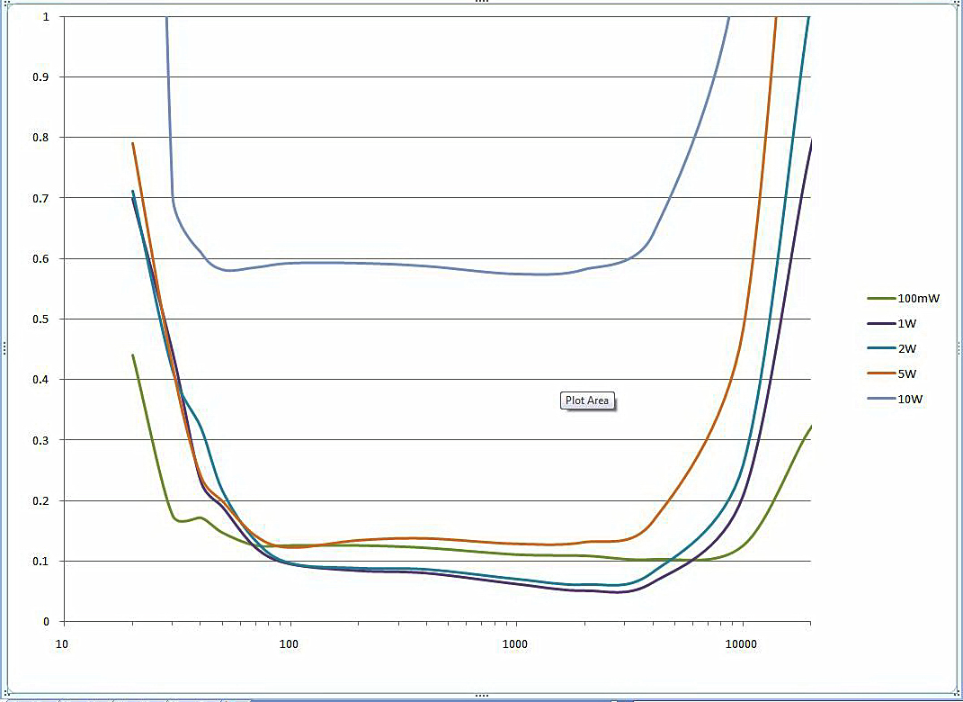

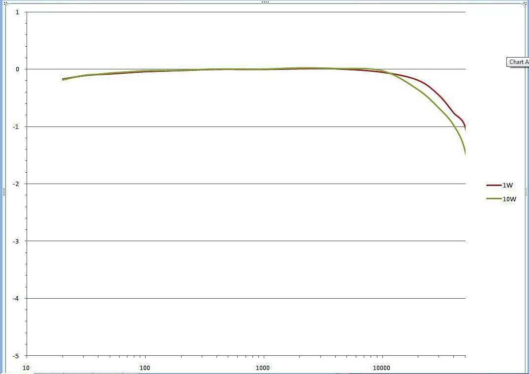

The measured results are almost unbelievable. I verified that they are real and even re tested my old Simple SE for a reality check. Tube amps with cheap transformers and very little GNFB aren't supposed to measure like this. It measures better than some sand amps that I have created, but there is no silicon in this design, none.
The frequency response is +/- 0.4 db 20 Hz to 20KHz at 10 watts. 0.2 db at 1 watt. The 3db point is 60+ KHz.
The measured THD is 0.06 % at 1 watt and 1KHz, but well under 1% for all output powers and frequencies used in normal listening. The upturn in distortion at the frequency extremes can be atributed to my Ebay OPT's.

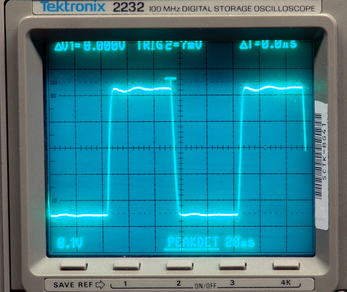

The GNFB compensation cap was tweaked for best square wave response at 10 KHz. This resulted in a gentle drop off in the HF response instead of the peaked response seen without a cap. This also removed the harshness from some of the high frequencies.
