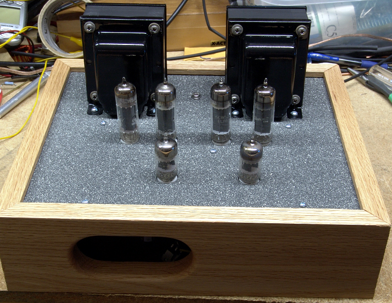

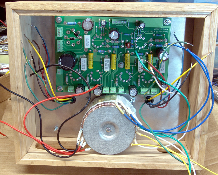

We had out first winter cold front blow through yesterday resulting in perfect amp building weather today (65 degrees and sunny). I spent the day outside completing the chassis work for Simple P-P amp number 1. The top plate and transformers are freshly painted and presently baking in the Florida sun. The wood pieces are sanded and oiled and will be glued up tomorrow.
You know I couldn't wait that long. The paint was dry in an hour so I glued up the box and left it outside until dark. After dinner I started putting it all together. Here is two pictures of the progress so far. It has been almost two years since I have completed an amplifier. There are several half finished projects stashed here and there, but it looks like this one might really get finished.
Your woodworking is improving.
Thanks. After 3 years of woodworking classes I have built a chassis without sheetrock screws or butt joints. 3 more years and I may be able to do dovetail joints.

This amp uses 6CW5 tubes. They require less voltage and a lot more current than the typical rectifier tube can handle. This particular amp will be replacing my Industrial Simple SE for daily use. To keep it cool the B+ voltage is about 220 volts but the current meter hits 1/2 an amp when the amp is clipped. The usual 5AR4 will not work here, so it gets replaced with sand. The EL84 versions of the Simple P-P use the 5AR4 rectifier.
There are two tube sets that can be used in this amp. There are two different "builds" with each tube:
The 6CW5 / EL86 is a low voltage version of the EL84. It was designed for use in OTL audio circuits using an SRPP design and a 600 ohm speaker. It has been used as the audio output tube and the vertical (frame) output tube in TV sets. It is not being currently made, but they are widely available for low cost. It works well in conventional P-P circuits such as this one, but a low voltage high current power supply is needed.
The Antek power toroid used in this build is $29 and it is 120 or 240 volt capable. Solid state rectification is used. This allows for a good low cost amplifier. The maximum specified plate voltage is 250 volts and the screen grid spec is 200 volts in most data sheets. The amp shown here will be documented in the construction plans. It is a conservative design that operates the tubes within the published ratings and makes about 14 WPC.
