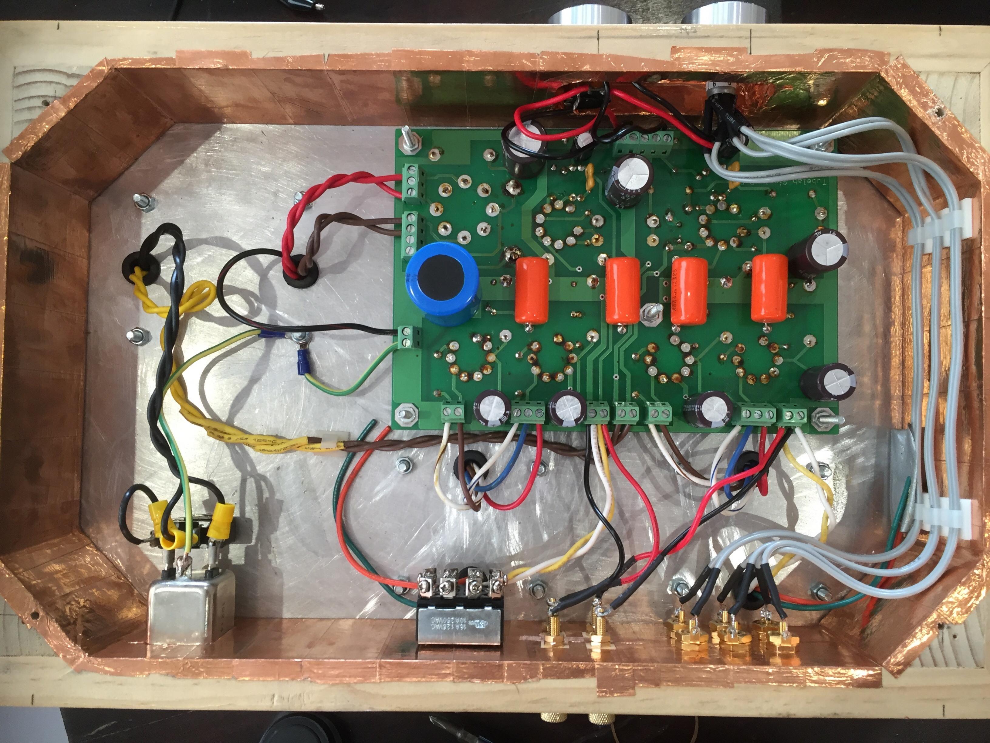

My experience is, that the ideal value of the cap across the feadback resistor depends in a high amount to the specific output transformer.
Did you connect the wires on the transformer in the same way they were before after experimenting. Reversing will result in positive feedback and thus to oscillation.
I didn't remove any wiring to install the feedback caps - just soldered them in from below the board. I've attached a picture of the amp with caps installed. Given that I've been running without the caps for a year or so, I wouldn't have thought I could have the phase wrong.
Your picture appears to show R104 & R204 installed next to your feedback caps. If they've been installed the previous year and it ran, your phasing is not reversed. And simply adding the feedback caps would not have changed that.

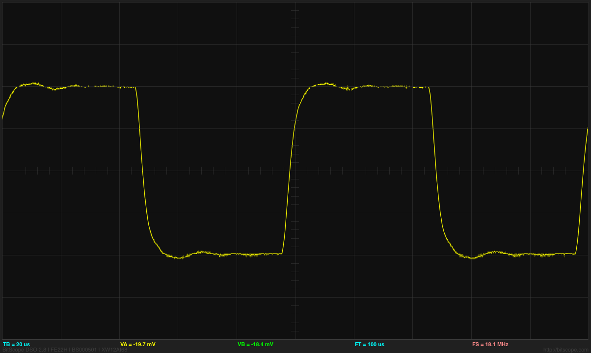

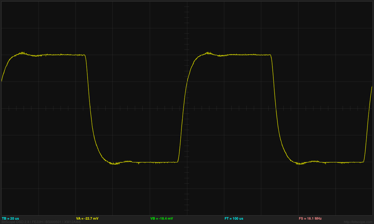

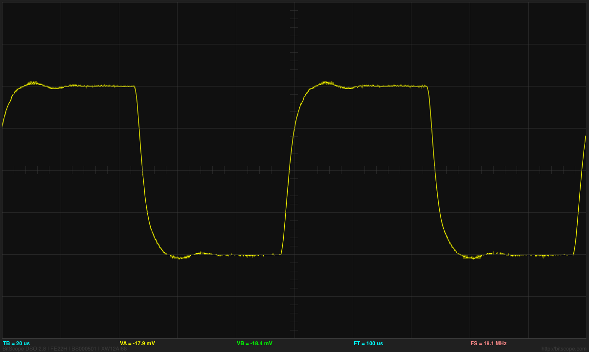

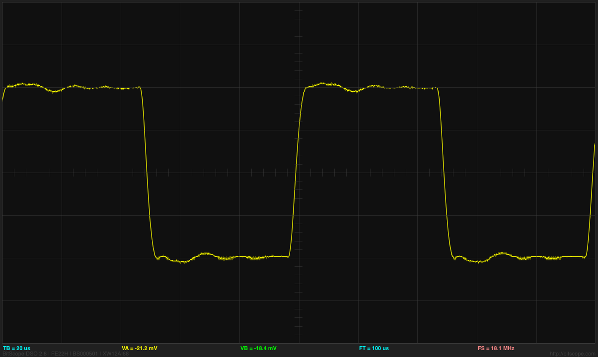

Here are my scope traces from testing with a variety of cap values (none, 270pF, 390pF, and 500pF.) The input is a 10KHz square wave. The traces show 200mv divisions.
