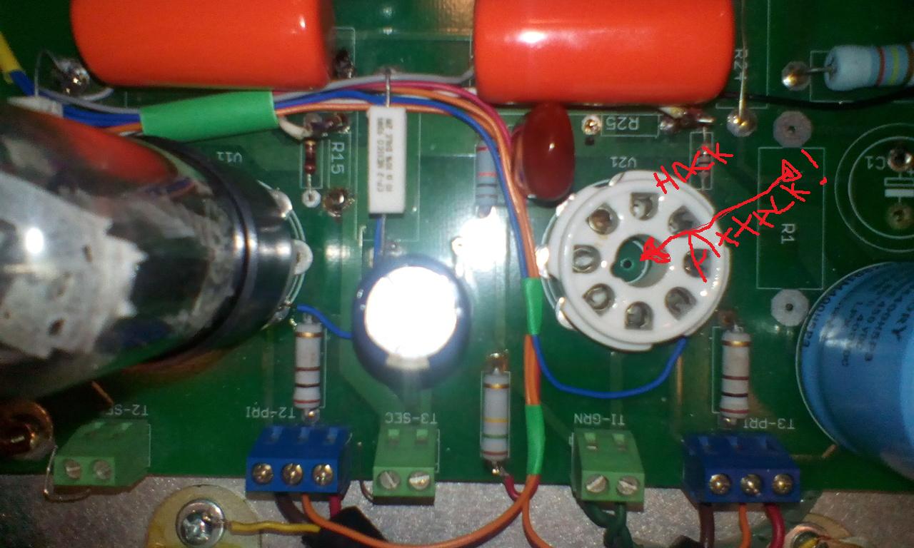

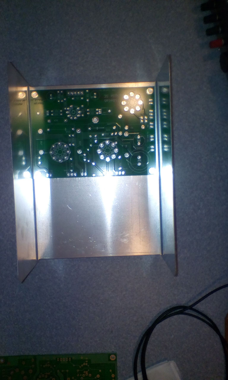

If I find them I have a bunch of cheap tubes to try that will require some W5JAG style board hacking. I'm thinking an aluminum L bracket for the odd tube sockets rather than a hole in the board though.
LOL. Hmmm, I wonder if one could deftly punch a hole large enough for a seven pin socket, but still small enough to leave the nine pin traces intact?
I can't help but notice some tube sockets have a small hole through them, dead center. Presumably for the cheesy LED light ( which I kind of like, actually ). I'm thinking of drilling a small hole through the center of the pcb socket pad, then rigging some kind of a post to stick up vertically, may be as simple as screws and nuts, then mount the new socket on the vertical post.
Connect the wires from the new socket to the appropriate point on the pcb.
Might work. Been meaning to try this on an SSE, and if you look close at some of the pictures of my child resistant SSE, you can see the pilot holes drilled in the pcb under the power tube keyslot, to try this out. Thought I might try nine pin tubes in the SSE. Just haven't got around to it yet, got distracted by four and five pins .......

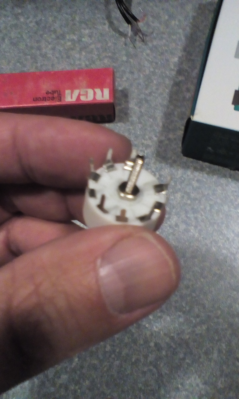

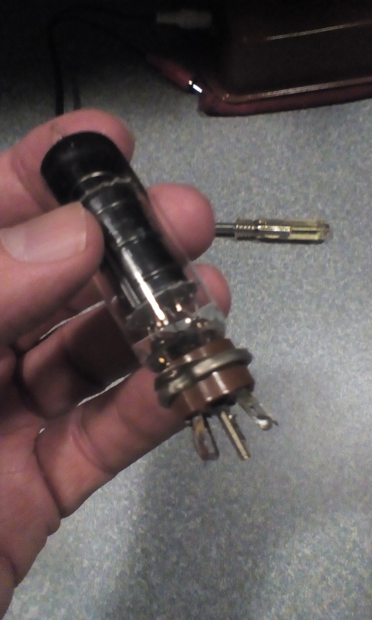

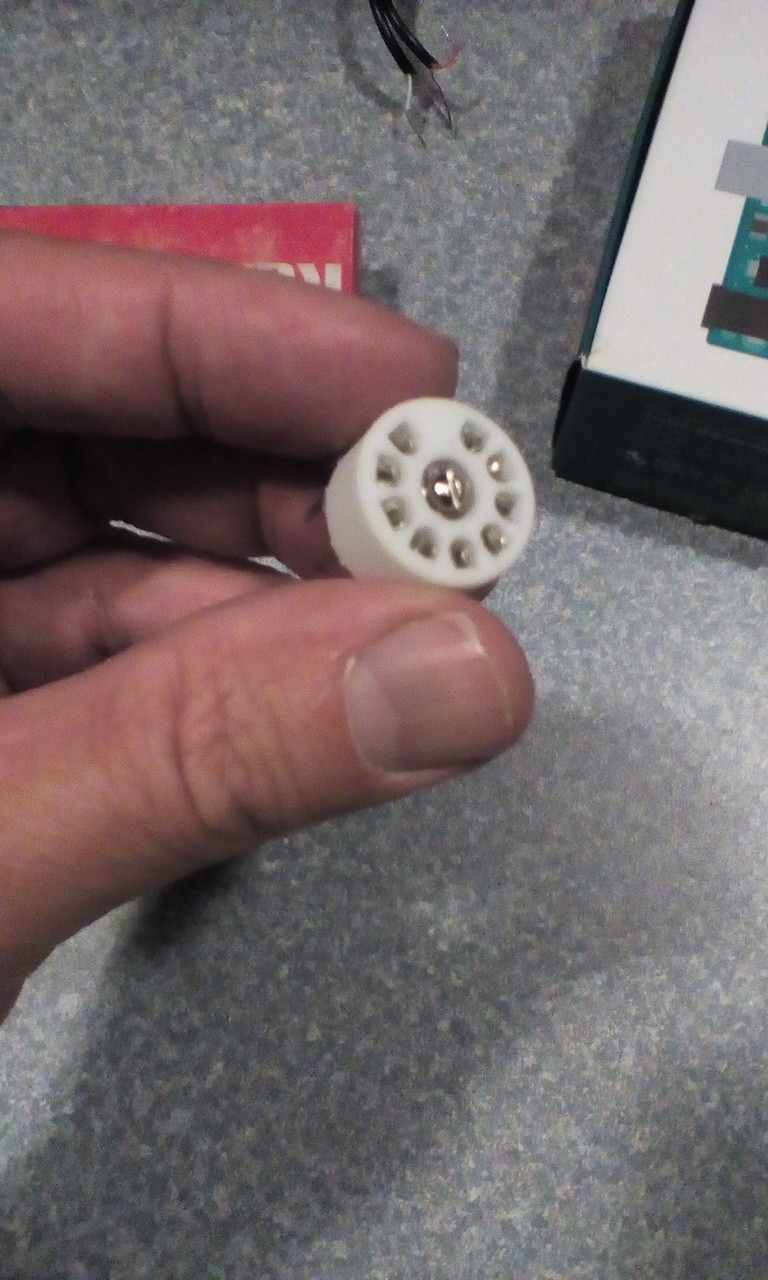

Some tubes have the evacuation stem in the center of the base instead of on the top of the tube. I have only seen this on compactrons, but it is in the outline spec for 7 and 9 pin miniature tubes, so the sockets should accommodate it. Many old tube sockets had a metal insert in the center hole that was usually connected to chassis ground, and often used as a tie point for bypass caps on RF and IF amps that were wired point to point.
There were a very few 10 pin tubes with a pin in the center. Again, I have never seen one, but I ran across a data sheet somewhere.
I have a little P-P guitar amp that coincidentally uses a 70 volt line transformer for an OPT. I wired a pair of orange LED's in series with the screen supply resistor of the output tubes. It makes the tubes glow orange when you crank it even though the amp doesn't run the tubes hard enough to do that. The whole amp has about $40 worth of parts in it and the power supply can't melt the $1 tubes.

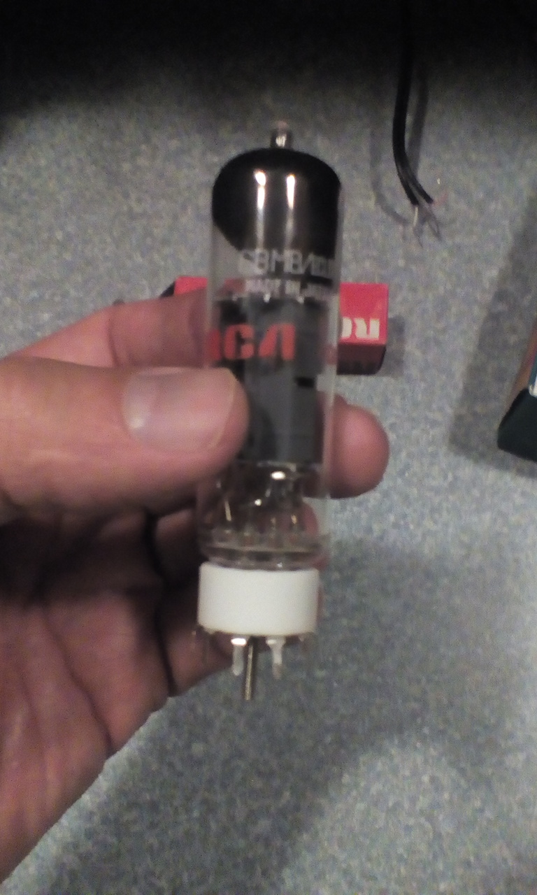

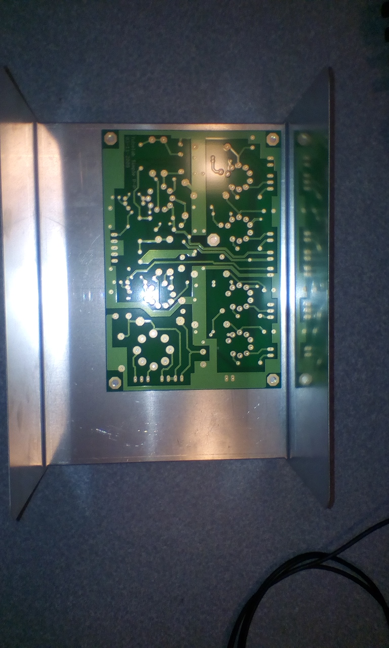

Looks like with the right hardware, it could work. This was just a trial fit with some 2-56 hardware I had on hand, not necessarily optimum for the task.
The 6BM8 is sitting in a modern Chinese socket. The 6AQ5 is an old U.S. seven pin socket. Both tubes seat fully in the socket, without obstruction from the center "post".

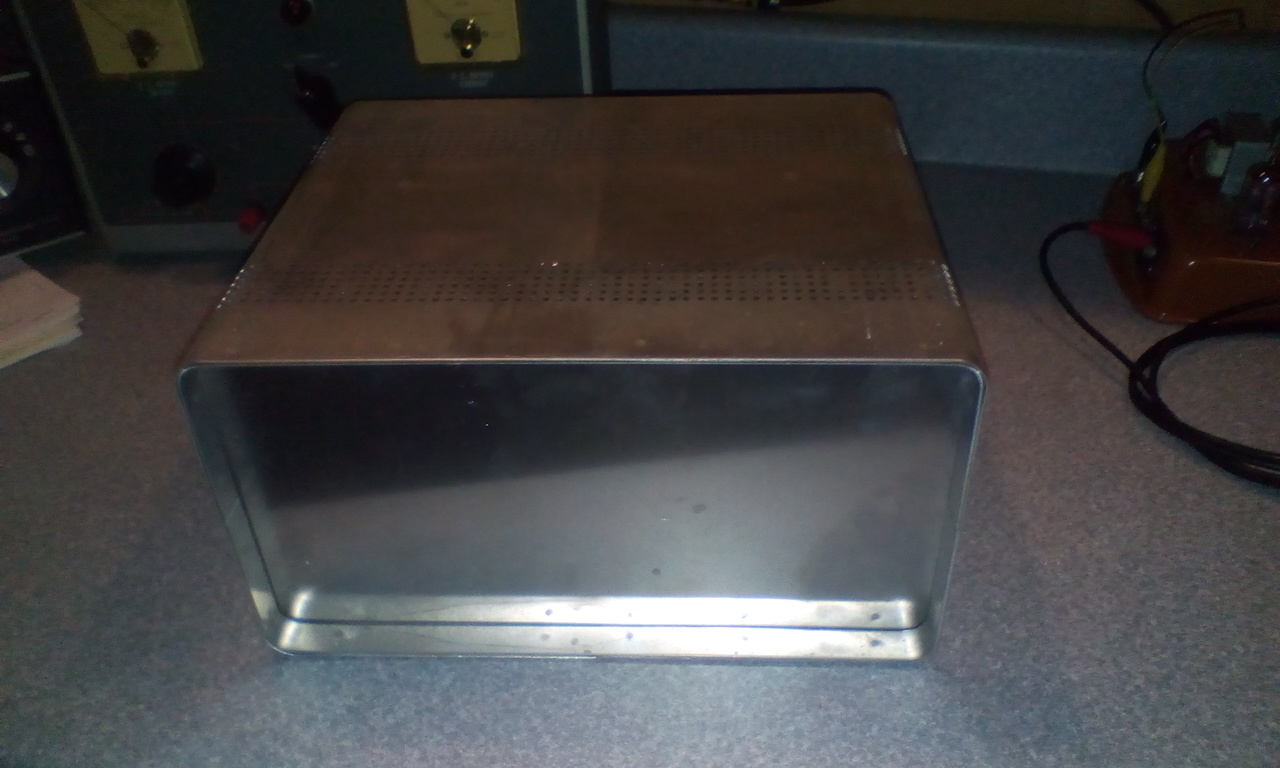

I'm thinking low power for my SPP build. I want to make a complete FM receiver, and I have this LMB Heeger cabinet in stock. The bottom chassis has plenty of room for the solid state stuff, most of which still needs to be built, but top side will be tight. An SSE board will just fit transversely, but the little bit of extra width on the SPP makes it longitudinal only. I've had this in the back of my mind for a while, which is why 6G6 went immediately into the push pull test mule with the psuedo SPP front end. I'm thinking 6AK6 for the power tubes - should be able to get 2-3 watts without a lot of heat to dissipate.
Getting a power supply into the cabinet, OPT's, etc., and dealing with the generated heat will be challenging. I have some ideas, unconventional, don't know if they will work. I want to use a one box solution - no external power supply, if possible.

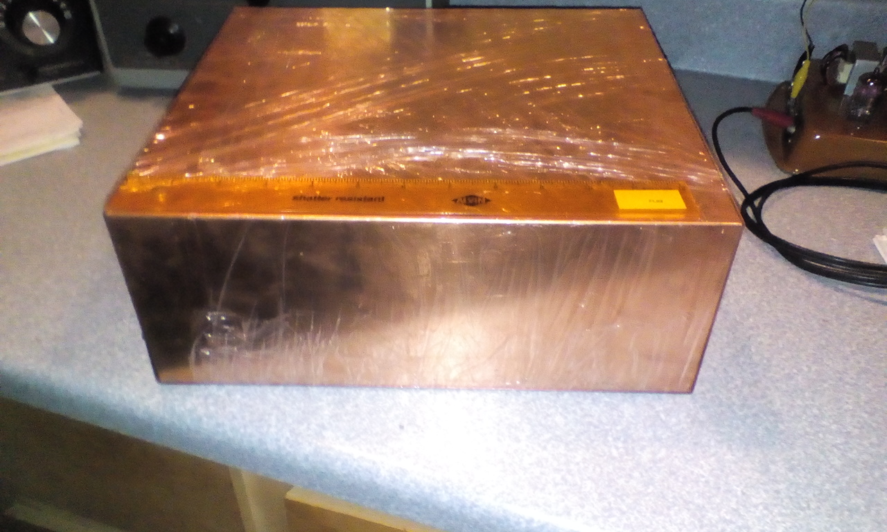

Where did you get that copper box?
You know, I hadn't looked at that bad boy in more than a decade.
But sitting here at my desk over lunch, looking at the picture of it, I bet it would hold a couple of SSE boards modified for push pull with 6146's, independent power supplies for each board, room for the fm tuner / preamps / tone controls, etc., and more than ample front panel space for meters, frequency display, etc .....
And I pretty much have all the major parts on hand, including OPT's with a third winding for the screen grids or cathodes .....
It might even fit in the small space where the child resistant SSE now sits. Width and height would be OK, I think, not certain about the depth, but I think it would fit ....
I've never tried to work copper sheet metal. I assume it is softer than aluminum or steel?

A lot of the old "copper" chassis from the 60's were really copper plated steel. A magnet will tell the truth.
I ripped apart some old RF sweep generators for their tubes and power transformer. The nice copper chassis turned out to be plated steel, but I saved one anyway. It didn't make the move up here though.
A lot of the old "copper" chassis from the 60's were really copper plated steel. A magnet will tell the truth. ....
A PM speaker wouldn't stick to it at the time, and I just had a known good refrigerator magnet slide right off it, so it could be copper plated something, but I don't think it is steel ....
Best I recall the fellow had several of them, and said it was copper, but that was a lot of hamfests ago. I believe the early R.L. Drake tube type radio chassis are copper, rather than copper over steel, but I haven't put a magnet to one.

I have never seen copper plated aluminum so it may indeed be solid copper. Weight could be a clue too.
I vaguely remember seeing some copper looking chassis in my younger days, but most copper looking consumer chassis were steel based for economics reasons. Some old TV sets (Zenith maybe) had selectively plated areas where component leads were soldered directly to tabs on the chassis.
Somebody's old HiFi chassis were copper, but I can't remember who. Don't think it was Fisher, maybe Pilot? The Pilot Stereo 70 watt amp that I had in the early 70's was gold painted steel as was the cage.
I believe it is solid copper. It feels like copper, and I pulled one of the screws out, and it looks like copper all the way through.
