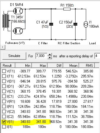

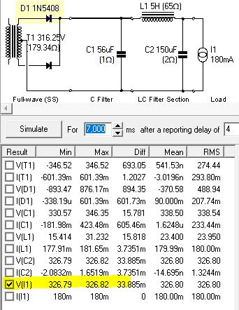

For an EL84 build, I really like the look of the 4 power tubes with 2 input tubes in front.
The rectifier seems out of place for me visually so I'm I'm going to try a slightly different approach for B+.
SS diodes instead of the tube rectifier, with a Hammond 370HX (550VCT) PT and 193H (65ohm) choke.
Based on PSUD, I think this combo should get me in the same ballpark as the design B+ of 310-330 VDC.
Question, perhaps I can use 2A diodes in this case to fit better in the tube socket?
The 1N5408 diodes are fine. That's what I used in my 6CW5 version of this amp since it eats more current than the 6BQ5 / EL84 version.

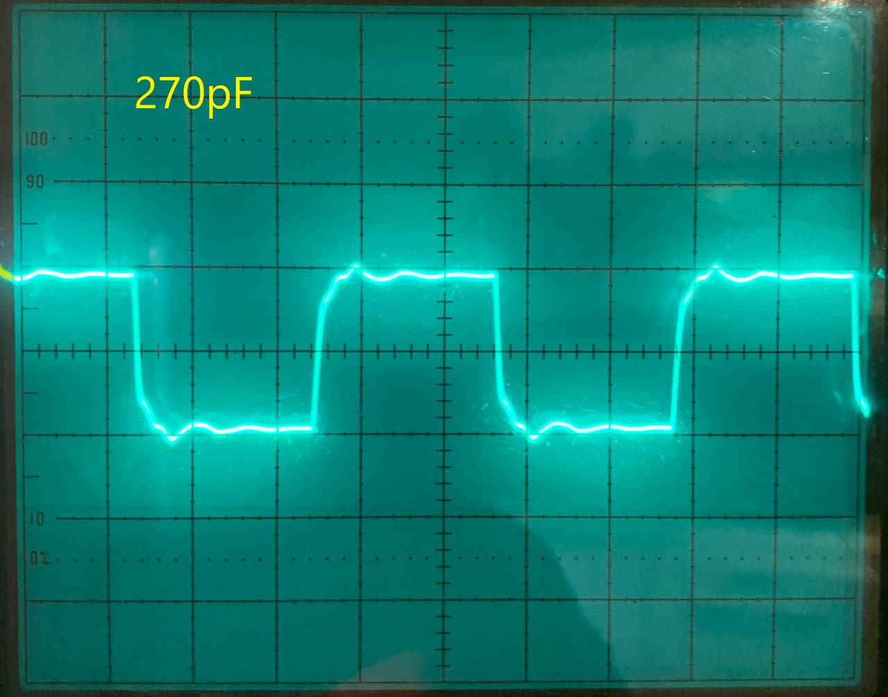

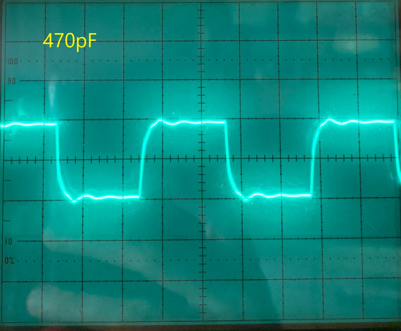

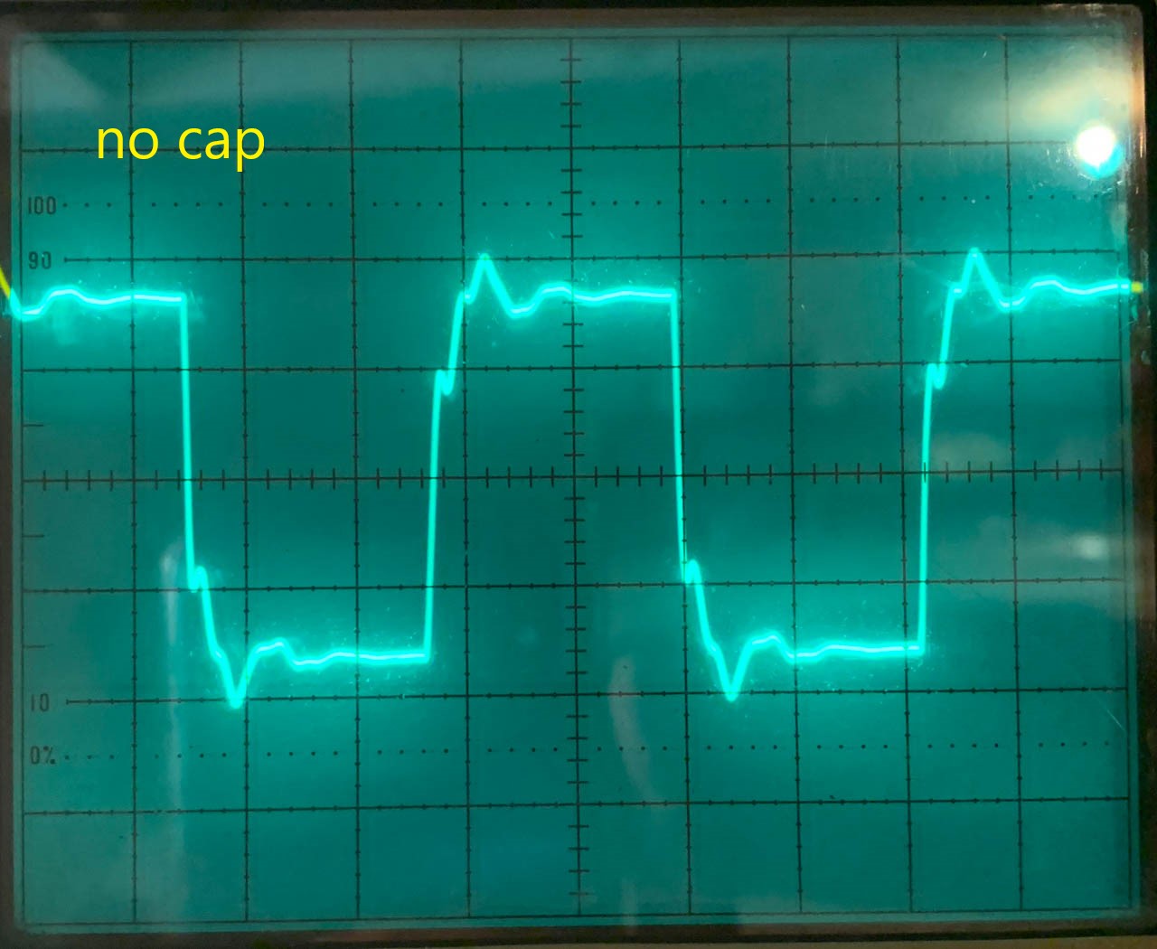

I've made progress with my build and need some help with final tweaks.
(You can ignore the question above regarding off-board sockets as I've went with all of them PCB mounted).
1. Feedback compenstation cap -- I bought 120pF, 270pF and 470pF caps to experiment. 10Khz squarewave was ugly without the cap. It got incrementally better up to 470pF.
Is this good enough or is it worth trying some higher values like 560pF ? (pics attached). OPT is Hammond 1650FA as FYI.
