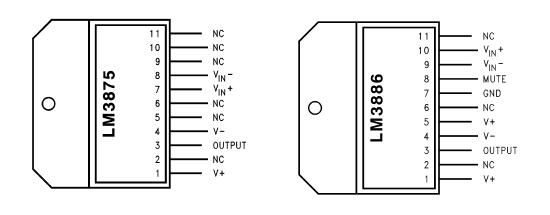

Could you be so kind to advise me how to use/replace LM 3875 with LM 3886 in Mr. Joe Rasmussen IGC tube hybrid schematic ?
This is the only chip available in this part of the world ,unfortunattely .
After reading all your excelent posts ( yeah I become a fan of this forum ) I'm still not sure what should I have to change in order to fit 3886 instead 3875
Mr.Vix wrote something about using 3886 and ECC88 or 83 which is my case too. Can I hope for a helping hand ?

Once you deal with the mute the 3886 should connect pretty much the same as 3875... the ECC88 = 6922 = 6DJ8 = 6H23pi
dave
Quite right on both counts. You will need two additional components as shown in application notes:
http://www1.jaycar.com.au/images_uploaded/LM3886.PDF
This shows Mute, pin 8, a 100uF cap to ground and Rm resistor to the negative rail. If this is -35V then make RM 22K. This should draw current out of pin 8 and should be 0.5mA.
I have not yet used 3886, but I have a project comming up and the above is what I have in mind to use. You may get away with smaller than 100uF for the mute cap, but since I use 1000uF main caps I don't want the 'sag' on the negative rail to partly trigger the mute (this can cause dynamic compression) when the amp is pushed hard. The 100uF (one hundred) cap minimum should help keep pin 8 stable and prevent it.

Just occurred to me, pin 8 needs 0.5mA to be drawn to de-activate mute state, so the obvious is a current source set at 1mA. This would only need to dissipate about 30-35mW, so find a small fet that handle 40V to do the job. I will be trying that and report it back here, not promising a date/time.

Gentlemans,
Thank you for your answers.
As far as I understood from your kindly posts is sufficient ( and neccesarry ) to add the mute cap to pin 8 , to increase the value of RM for compatibility with 35V and that's all. !?!
Beside those, 3886 is 'pin compatible' with 3875 and the schematic of Mr. Rasmussen !?!
ECC88 will be used instead of 6922 with same voltage .
Funny - I do have ECC88 so the amp will be started ASAP
That if I'm not mistaking anything above - else I'll have some nice fireworks in my office :firefite:
Thank you
No! You should do yourself a favour and read the datasheet at national.com
Thank you leadbelly
I'm sorry but my english is not so good .By 'pin compatible' I wasn't meaning the pin order/arrangement but the aplication schematic which may use different components than 3875.
But, as far as I understood, other than the mute cap and the resistor ( some people got rid of the cap ) nothing else is changed in the schematic and I can try confident the schematic proposed by Mr. J.R.
